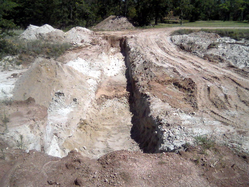

Rons post above made me check my latest photos. I've finished the core trench and have started filling it with compacted clay. I considered renting a compactor for this job, but my backhoe weighs almost 14,000 lb and seems to be doing quite well. When I fill the bucket full of dirt and roll with the front tires, it does a good job of compaction. It's just a very boring and tedious job. Here are a couple of pictures of the core trench completed except for loose material removal. After removing the loose dirt, I wet the trench down well and started filling with clay. The lowest part of the trench has been built up about 3' with clay and I'm happy with the result. I'll try to get some photos of the filling in progress soon. I've had a lot of distractions this last week and haven't made as much progress as I'd like to. The 102-104 degree heat hasn't helped either.

   / The gully to pond project #125
Looks good Jim.
Do you have any moisture in your clay so it will compact? I found that my front tires worked great for compacting my soil, especially with a full load in the bucket, but if the soil is dry, it will never compact no matter how much weight you put on it.

Eddie, I'm lucky that the trench is close enough to the house that I can string a hose down and put a sprinkler on the clay as needed. So far, the fresh-dug clay is moist, but some of my clay from my piles needs some moisture added. You are sure right that dry clay does not compact. So far, so good. I'll try to get up a picture of the trench being filled soon.
