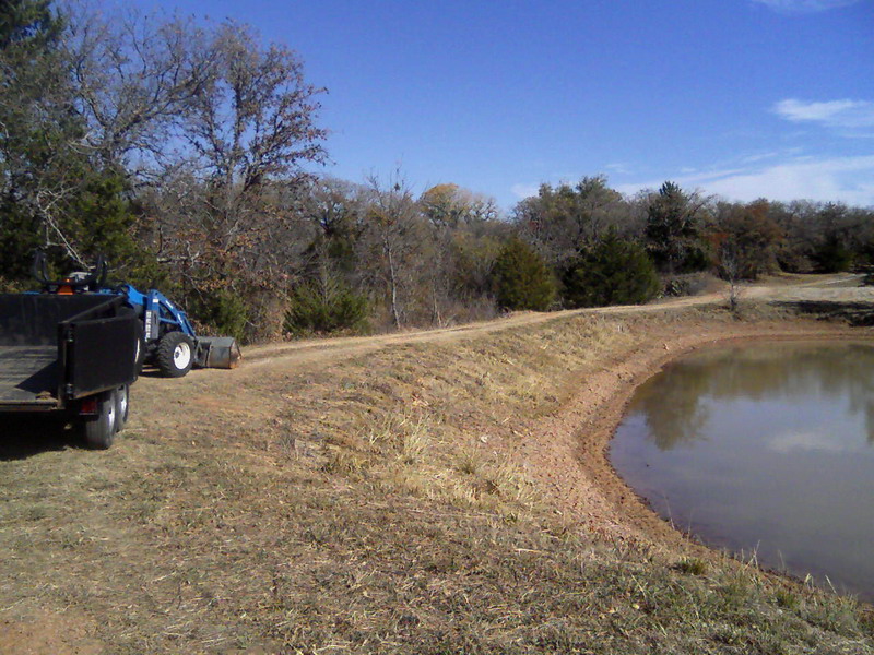

I'll take a guess that his pond surface froze, & of course expanded, which pushed his spillway pipe around enough to loosen the soil around it, & then water below the ice layer started washing the dirt from around the pipe ? ... & then all heck breaks loose: No fix can be done until the water is done washing out.
Now that makes sense:thumbsup:
The deep gully land looks much more usable also. When you are through with the business function of the road it looks like it could be the beginning of a good trail bicycle racing course.:thumbsup:
Jim my bluebonnet is up and blooming. Yes you read that right bluebonnet, no - s, one, singular.:D
One?? More than I've seen anywhere?? Since Jim brought it up, I've been looking along the roads and highways and nothing. With this rain, it should be an awesome bloom.
   / The gully to pond project #242
Now you got it:thumbsup:
This didn't happen until the 3rd year when we had a long cold spell. The ice was about 4"-6" thick. When water freezes it expands. There was about 6" of the pipe sticking out at water level and of course more at the top because of the slope of the dam. The reason ( dumb), I put it there is behind the dam that is where the original ravine continues on, so I ran the culvert down to it.
The clay ground was well compacted over the pipe with a Dozer, but the power of the ice on the culvert stub was greater.
When I fixed it I put the culvert clear to one end of the dam about 160 feet from the center and made a vertical riser. 16 years and counting, it is still holding.
Another big advantage of a vertical riser is to be able to adjust the pond level rather easily if you want to for cleaning out muck etc.
Let's get back to Jim's project now. I just had to answer the freeze/heave jokes.

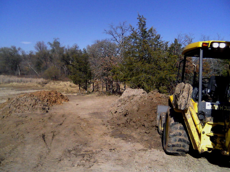

Don, the problem with the clay highway is it will be under water when I build my BIG dam. If you look at the first picture, you can see where the gully goes between two hills. That is where my big pond's dam will go. I'll soon be able to drive from my house all the way over where we had the TBN picnic without going through a single gully. It will open up all kinds of possibilities that have been cut off by that mud-filled gully.:D

Interesting, but not sure how that works? I guess you remove a piece of the pipe to allow water to flow out - but is the pipe under a lot of pressure? Do you swim out to the pipe?!! (and try not to get sucked into the pipe?!) :laughing: Or take a boat to it?! Or is the pressure low enough at the depths we're talking about that a piece of the pipe is easily removed?
Or is there another way altogether? (valve?)
   / The gully to pond project #246
My 6" overflow drain is about 3' from the bottom of the pond (held in place by 2 steel post) and goes through the lower part of the dam and then goes up behind the dam at a T. At every 2 feet there is a T with a screw in cap that can be opened to drain to any level. The top T is open. Water flows out of it right before it goes over the spillway.
#247
Yep, if your overflow pipe and vertical section are a big culvert, you get tremendous lift from flotation. Changing water level also gives changing lift. You can use small pipe and mitigate the lift issue somewhat, but you lose maximum flow. A big culvert would require a huge concrete anchor to hold it in place. Putting the pipe well below the pond bottom and covering it with dirt will help some, but the vertical section is still a big buoy constantly pulling upwards.
   / The gully to pond project #248
OK I get it. Adjust pond level from outside the pond :thumbsup:
Do you happen to have a picture of that setup?
Yes, Let the wife do it:laughing:
Actually, my vertical overflow is at one end of the dam with some hunks of concrete on the shore side so I can get to it even when there is flow into it and surrounding it. That is just to clean any debris off the grate I have over top of it when the water level is high enough to have water running into it. It really doesn't take much of a pipe diameter to control overflow as TxDon explains below with his 6" pipe and Tee set up. That is a neat idea! Would be a good place to shower after a long run:D
As Jim explained to a prospective home pond builder in Washington State, there are many variables to consider for ponds that are mainly filled by rain and field run off.
I am lucky [ if ] I have a full pond most of the year for many reasons.
Usually in late summer my pond is naturally down 2-4 feet or more depending on the rainfall. That is when I would adjust the level or clean out muck if needed. The Texas guys had ponds/tanks go completely dry last summer and lost a lot of fish. Some used the opportunity to improve the ponds.
Vertical contraptions have been used to control water height for thousands of years. A simple one is a method called "flashboard risers."
I think you can even get them in plastic these days, but home made ones can last a long time even made out of wood.
Ron

No, sorry, I did not take any pictures during the install and now the only part visible is the 6" vertical piece of PVC with the Ts on the back side of the dam.
There is one disadvantage to this: if the vertical piece is damaged the pond will drain to the level of the damage. I have a 3'x3' metal culvert at the base of the 6" PVC so the cows won't rub on it. The 6" PVC is about 8' in height.
Inside the pond, the last 4' is capped and I drilled about 2000 1/2" holes to act as a strainer.
Jim, I did not know the culverts you are using floated.
