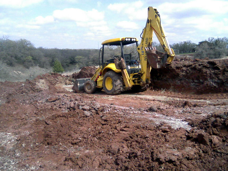

Yesterday, I posted photos of my clay highway. Today, I have some photos of my clay mine. I first excavated with the backhoe, but the area is now so big that I can drive the tractor down and fill the bucket with clay while saving the backhoe step. I took pictures of my tractor so you could see the proportions of the mine. I guess I'm a strip miner on a very small scale.:D

good pictures Jinman, looks like you're moving a little clay :D. Can't do anything around here with all the rain and melting snow.
