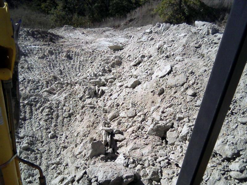

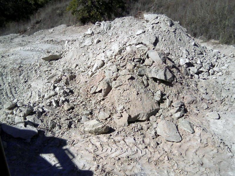

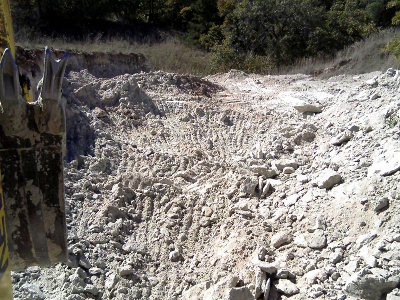

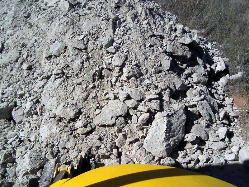

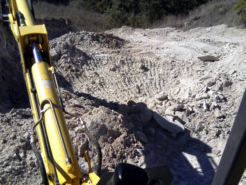

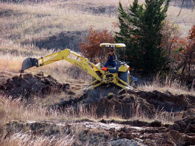

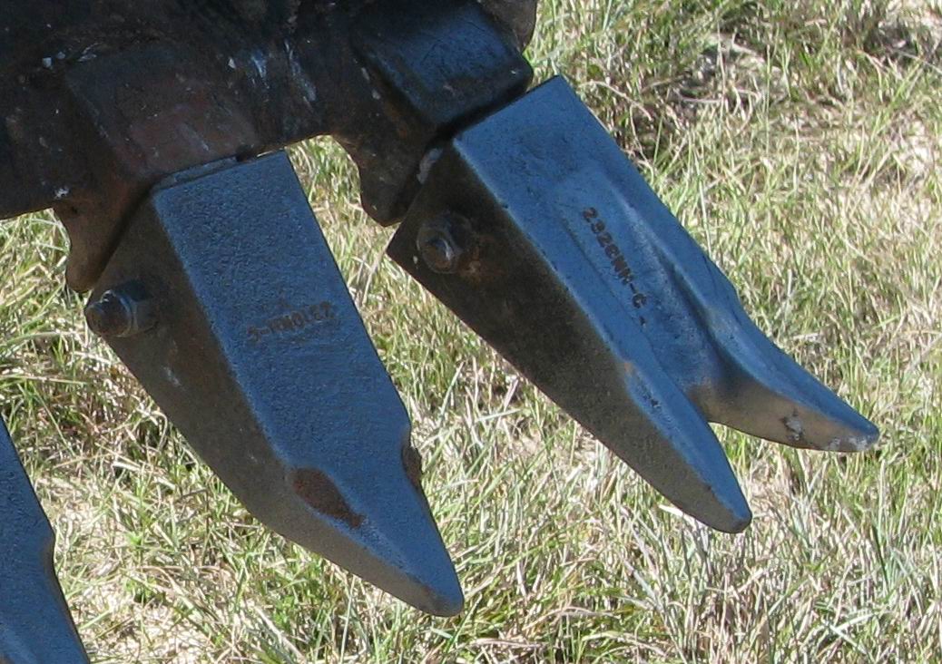

I got back to digging on my pond basin yesterday. I'm into a layer of caliche that is tough going. It took me all afternoon to dig out about 50 yards of material. Where normally I can loosen dirt very rapidly with the hoe and then scoop it up with the loader for removal, yesterday it was a fight scraping through this tough caliche semi-hard layer. I found that rather than digging in a conventional way, if I could undercut a layer and lift upwards, I can peel off big chunks of caliche and then it just crumbles. Fun stuff!:rolleyes: Here are some pictures.

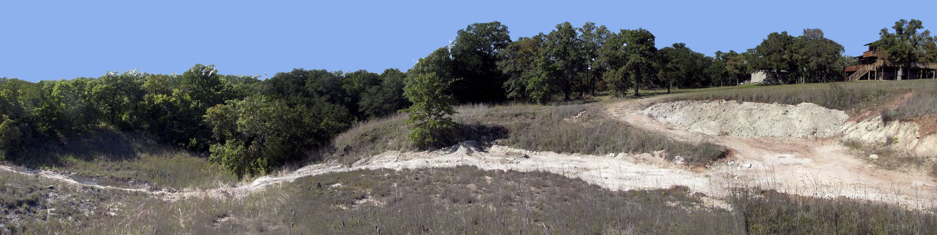

Jim, here's another pano without white sky.
Keep on diggin!

:laughing::laughing::laughing: The way I was bouncing around, I felt like I was on a Moon Rover for sure. You are sure right that it looks like the lunar surface.

Eddie: This caliche is not hard enough to crush for gravel. It pulverizes into dust under pressure. I can run over a big "rock" with a tractor wheel and it just crumbles. When it is in a solid layer, it requires the rock teeth on the bucket to scrape off chunks, but once the chunks are unsupported, they pulverize under minimum pressure. It would make good filler for road base, but you'd want a good layer of crushed rock on top to mix with the caliche.

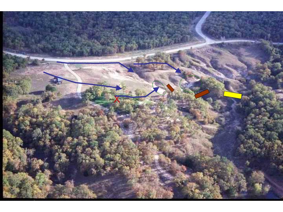

Norris: You are working much too hard on this, but doing a beautiful job. Thanks! I have moved probably another 100 yards of material and will take some updated photos this weekend. I think the bottom of my ponds is going to be solid caliche rock. I sure hope it will hold water, but if it seeps out, that will be fine. These ponds are designed to catch and hold water so that my other ponds don't flood and overflow with big rains. If they slowly leak out and keep the other ponds full, I can live with that, but I suspect the hard caliche will end up giving me a very clear blue pond. We'll see.
