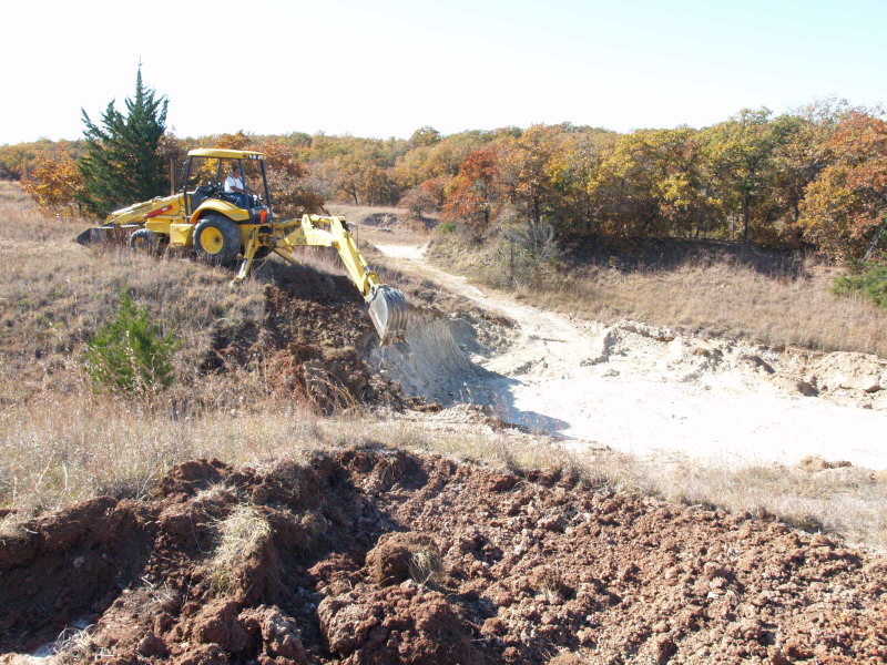

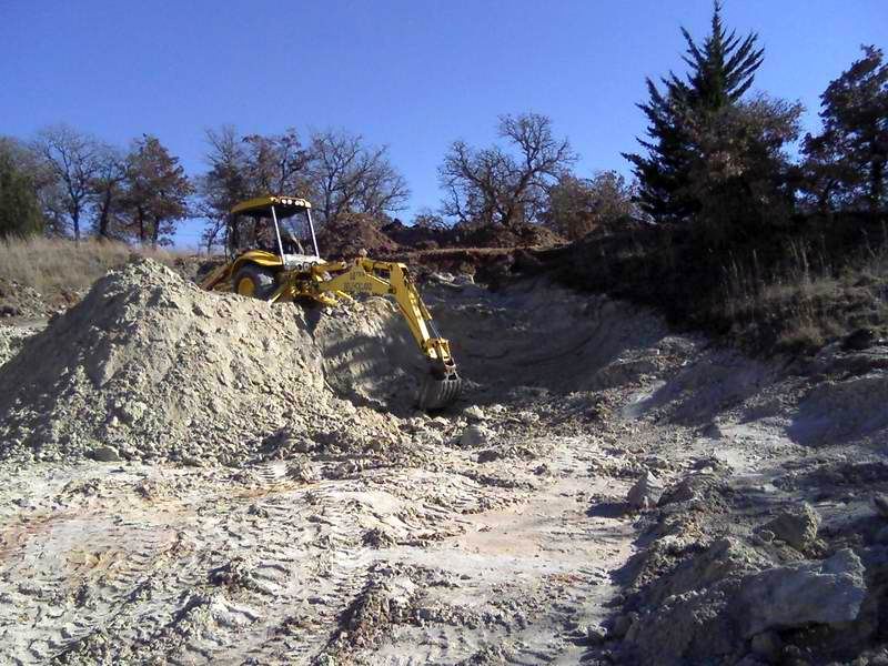

Here are a couple of pictures thanks to my neighbor, Mike.
