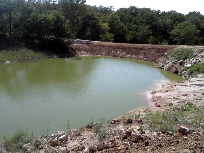

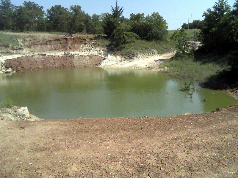

I recently pumped all the water out of one pond into the next. A couple of weeks ago, I fertilized my 1st pond and posted photos of how green it was. After about 2 weeks, it went from being green to sort of muddy looking with no rain or nothing to stir up the mud.:confused: The water wasn't really muddy, but it had lost almost all of the green color. As you can see in the 1st photo below, it sure isn't green. In the 2nd photo, you can see that the pond where I transferred the water is a bit muddy looking also. In the two attachments, just look at the dramatic greening that has happened in the 2nd pond where I transferred the water. I think pumping the water over probably oxygenated it and caused another rapid growth of plankton. I don't know how else to explain the sudden greening. It sure looks different from the inline photos below.

I bet your right Jim, along with the oxygen you maybe released some of the fertilizer that may have settled. Has the recent rains made any impact on the ponds and the clarity?

Dennis, I don't think the rain has added much to the pond depth nor had much to do with the color. The photos were yesterday between rain storms, so I'd say the rain has hardly had any effect on what is going on.

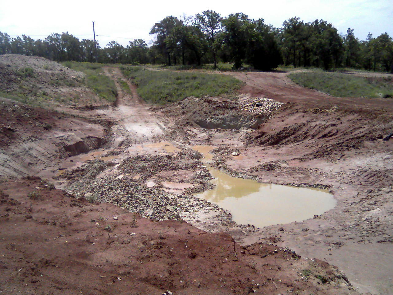

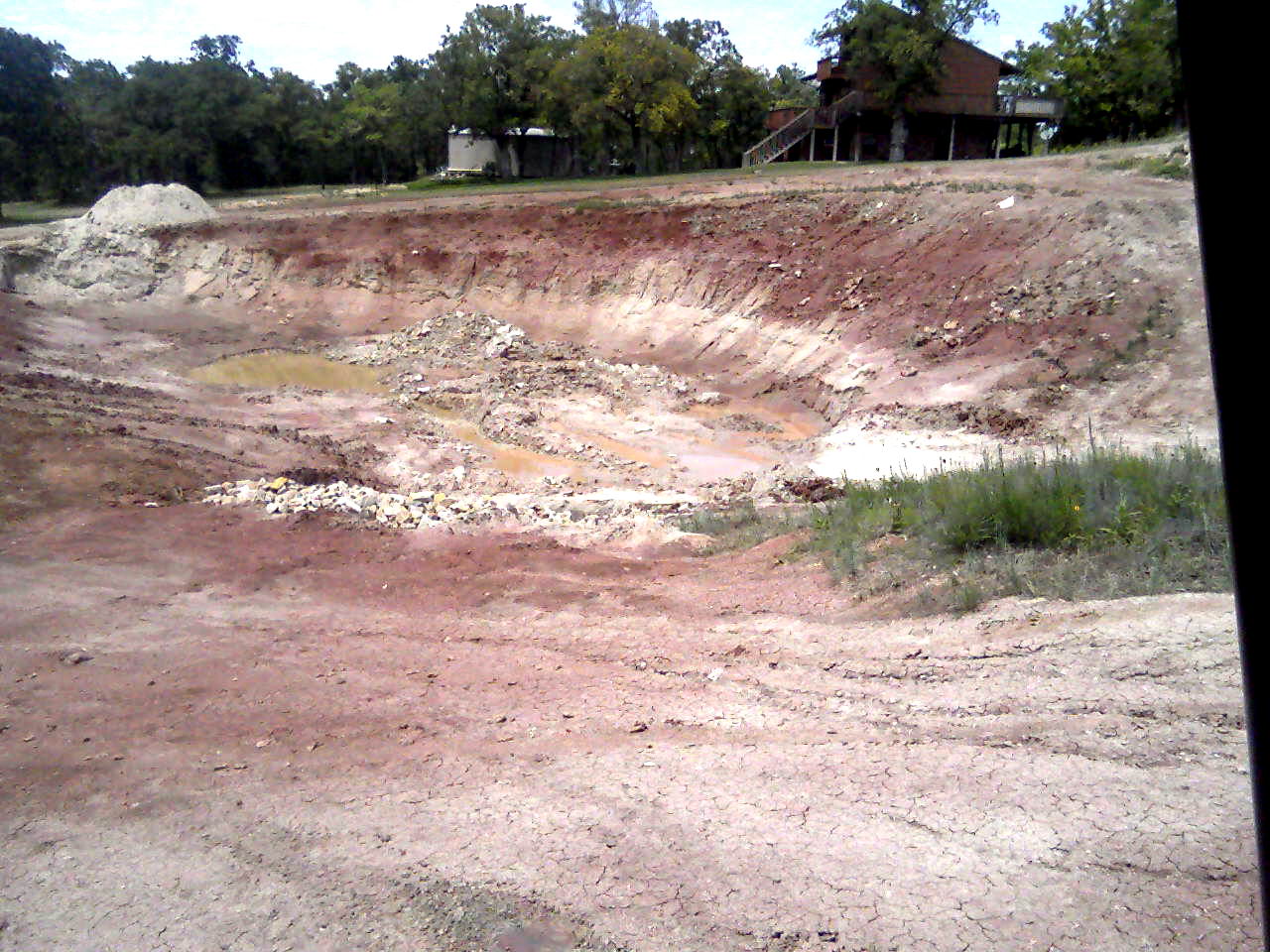

I went out and took some photos of the little pond. You can see it's a mess, but the bottom is hard as a rock (It IS a rock. . . caliche). I dug a basin near to the edge of the pond about 3' deep. I can put my trash pump into this basin to pump out all the water. Most all the water will drain into the basin. The first two photos below are views from opposite ends of the pond.

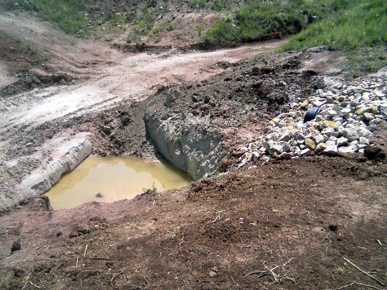

Last photo. . . Before the rain, I was digging around the edges to see where and how much water is seeping out/in. I found out that the leaking layer is right above the caliche. I can dig down to hard caliche and then watch as water fills in the hole slowly from the sand on the outside edge of the hole. The last picture shows a hole I dug below the pond overflow. It's about 8' to 9' down from the overflow. Except for the direct rainfall (no more than 1") this foot of water all seeped back into this hole from the side away from the pond.:confused2: I'm going to have to clean the whole pond perimeter down to this level and then bring in enough clay to make a sealing ring. I have plenty of clay, it's just a matter of time where I'd rather be doing other things. I may never get a perfect seal, but I think I can reduce it to a decent level. Once the larger pond fills, I can backpump to keep this pond mostly full if it leaks. My gumbo clay is very sticky, so I'm hoping to fix the problem with a 1' thick layer that's compacted very tightly. Right now, things sure look messy.:eek:

I feel your pain Jim. Mine just went from that aqua green you commented about to a muddyish green color, then algae broke out on the surface until I put enough dye in to turn the water a blue-green and block sunlight. The algae broke up and turned the algae brownish (dead?), then the rains yesterday washed it all out of sight. I think it is a combination of what you state above and water temperature changes.
