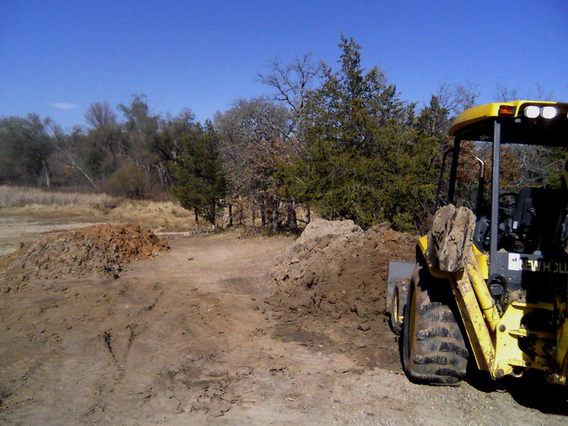

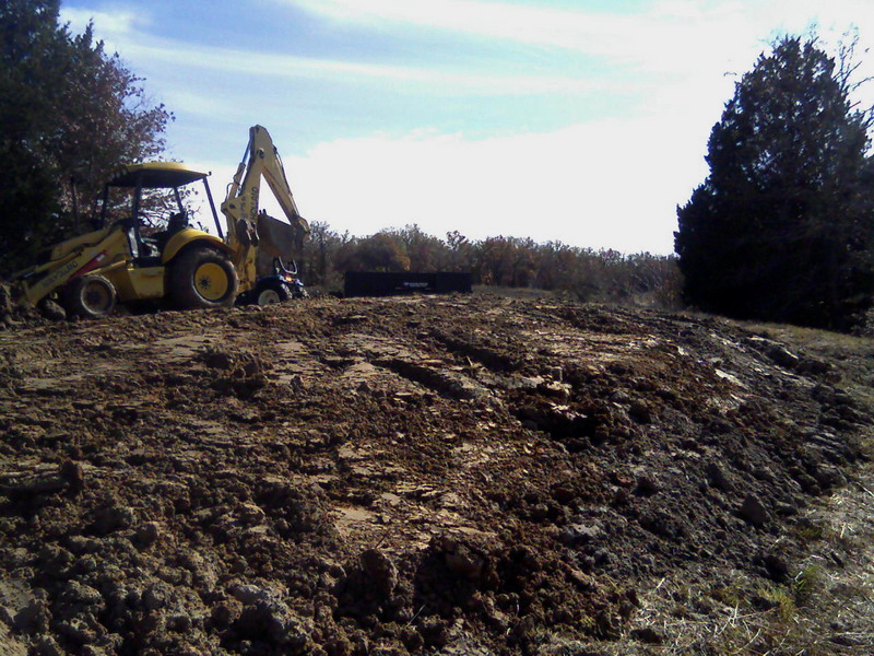

Right after I took the last photo, I turned to my left and took another photo of the area where I've been collecting topsoil. This really is a challenge with a backhoe because you can't turn 180 degrees like an excavator. I have a line of trees along my shoreline here, so I left an area about 10' wide to make a pile with the hoe and then use the loader to relocate materials. It's a lot of work, but it goes fast because I don't have to transport very far.

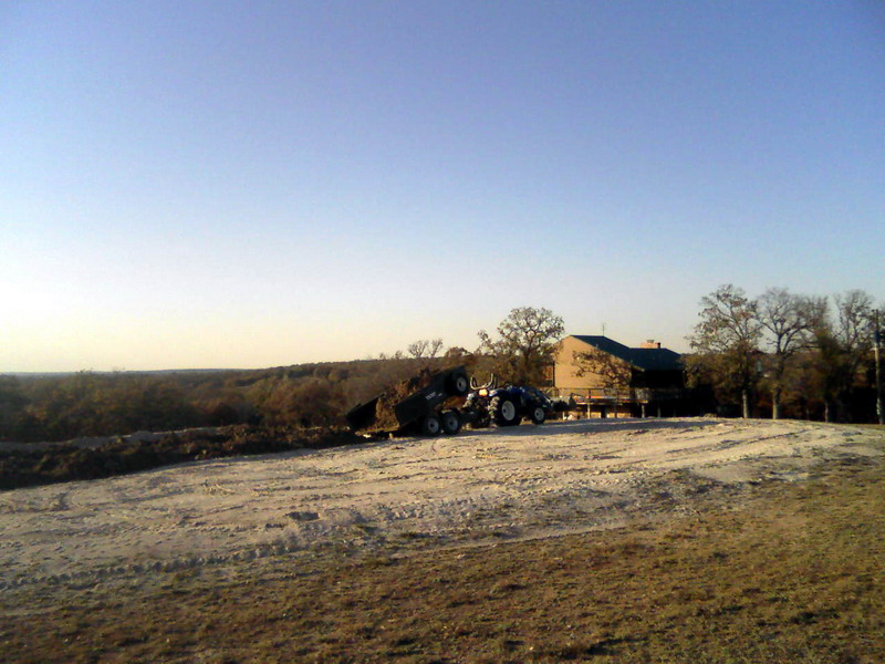

After using up most of my shoreline to make piles of dirt, I brought my other tractor and dump trailer to haul the dirt back up to the top of the hill.
I also took the opportunity to fill in one low spot so I'll have a larger turning/parking area above the lake level.

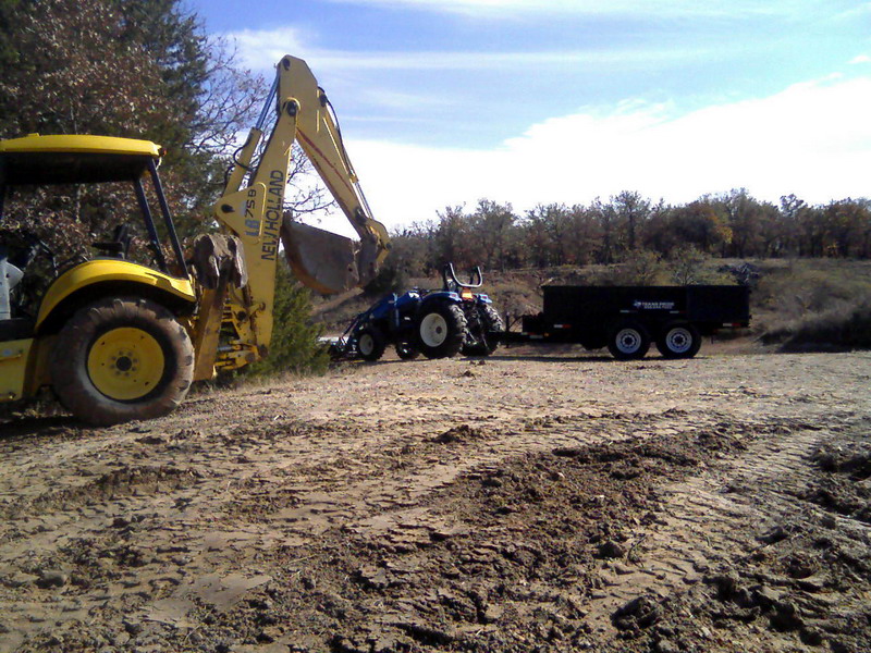

I found that I could just leave the gates open on the back of my dump trailer while hauling. I can fill the dump trailer to its maximum towable load and not have to fool with the doors while loading/dumping. This saves me getting on/off the tractor a couple of times per load and really makes thing run smoothly. as you can see in the photo below, the road goes uphill. If I get the trailer too heavy, my tractor will spin tires trying to pull the load uphill. The trailer will hold 7.5 yards, but I try to keep it around 4.5 to 5 yards per trip. That amount of wet soil is REALLY heavy.
Looking at the soil in the photo below, you can really see the soils difference. The soil on the left contains red clay while the silt I recovered in another spot is mostly sandy loam. The organics content is very high as evidenced by the odor.:p

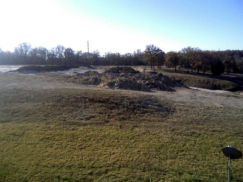

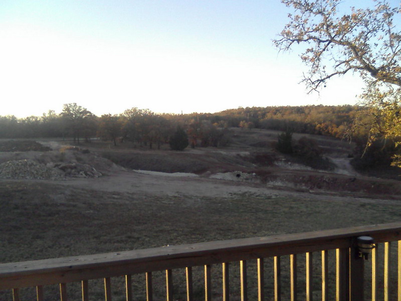

When I get to the top of the hill, I'm putting the topsoil onto the fill dirt I dug out of my ponds. After the soil drys a little, I'll spread it all over this area and then seed in grass. The dump trailer attached to the tractor is just a dream to use to spread the materials for drying. It's working just as I expected when I first got the trailer.
I'm leaving one spot open where the water drains. I've sloped the filled area so water will not go over the edge, but moves to the center swale and then flows off over rip-rap and ends up in my first pond.
One of these days, we'll get some rain and I can go back to showing some ponds instead of just all the dry land around them. Until then, I'm just 'stuck on stupid' while waiting for rain.:D

Ron: I filled and hauled 18 trailer loads in 2-1/2 hours. That's not too bad. Since the dirt was piled up, loading and doing a turn-around went very fast. The time consuming thing was driving the tractor with the load. With only one trailer, I would have to wait between trips anyhow, so I might as well have been driving. With an excavator, I could dig and load the trailer by turning 180 degrees, but with the TLB, getting dirt to the trailer is a multi-step process.
I could pull in next to lowest range (low rabbit) for most of the road up the hill, but in a couple of places I had to shift down to low/turtle range. Using my GPS, I measured the change in elevation at 75' of rise over 1200 feet of run. That's a bit over a 6% grade on the average with some spots being a 10% grade and others a bit less than 6%. A smaller tractor would not have been able to pull the trailer. I got some wheel slip even on my gravel road.
