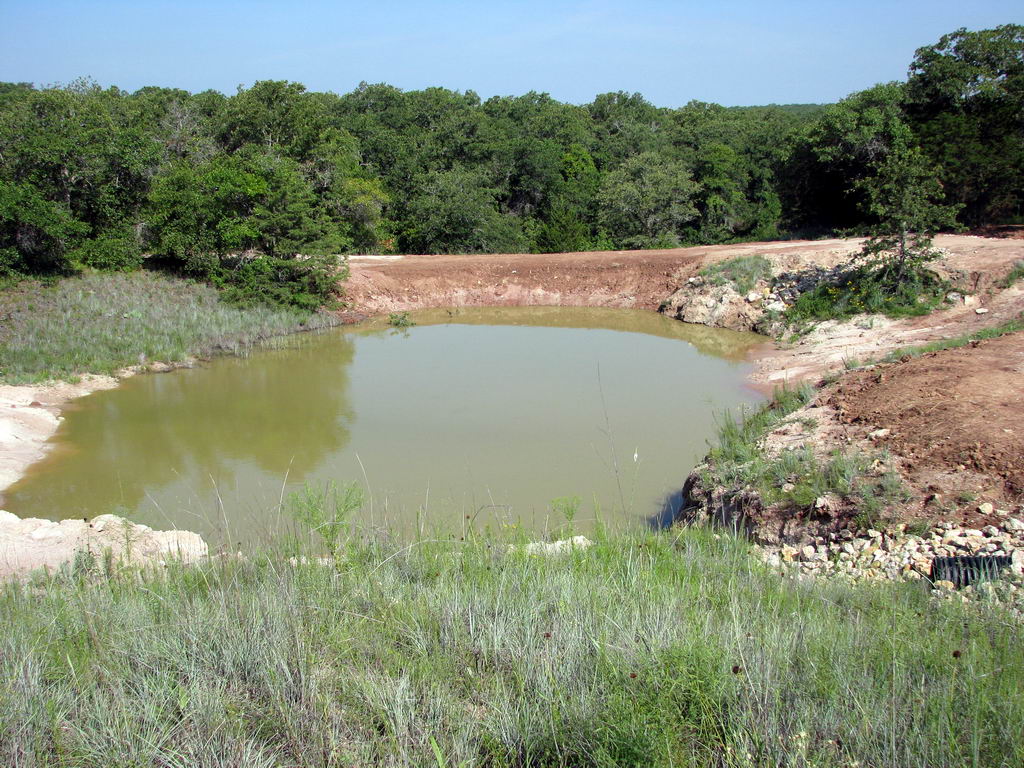

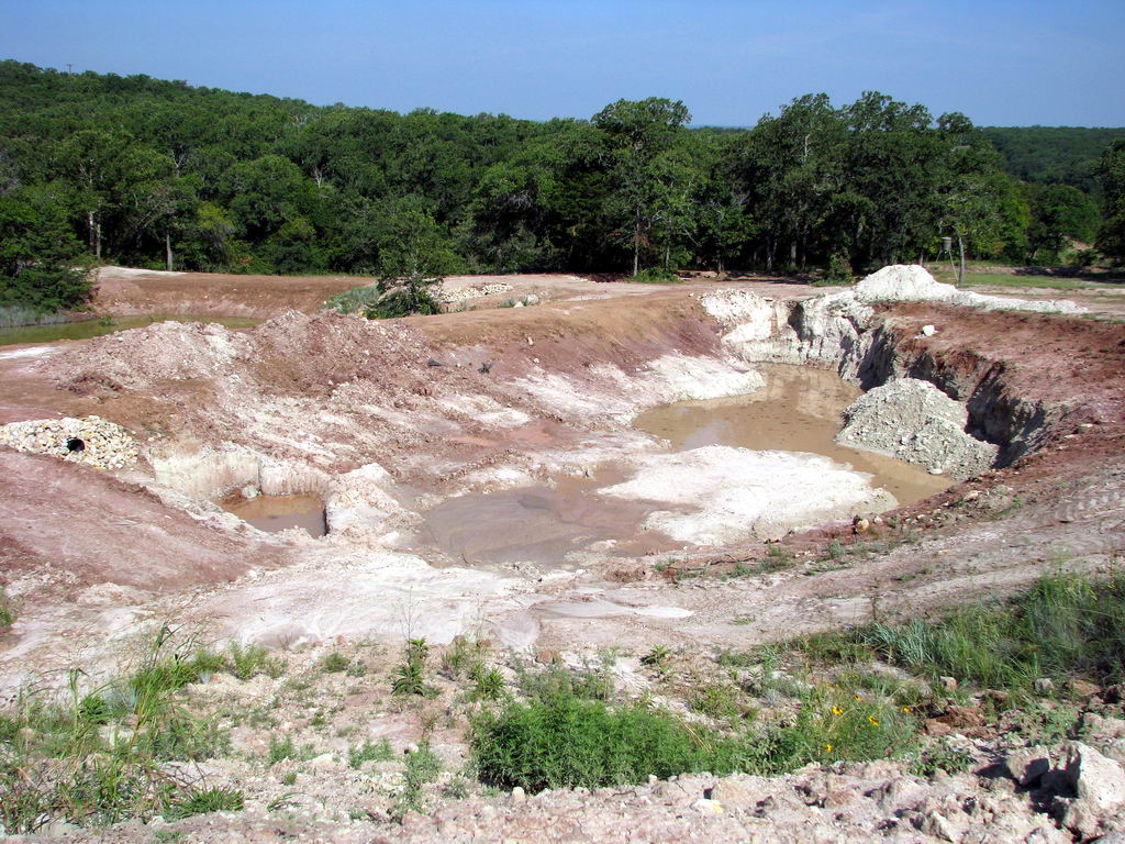

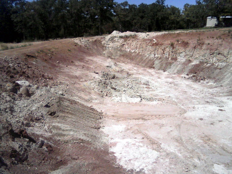

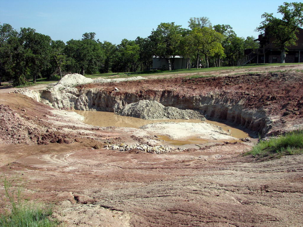

I spent several days last week digging my one pond deeper and getting ready to line it with clay. When the rain came, it filled up one end of the pond about 18" deep. It's been too muddy to get down there with my pump to pump out the water, but maybe by tomorrow I can get it pumped out and continue excavation. Without my trash pump, this would be hassle, but the pump makes clearing the water easy and the caliche beneath the water only has a couple inches of mud on it. The first two photos were taken this morning.
The 2nd pond is up about 4" after the 1-1/2" rain. It actually caught a little runoff. It just keeps on slowly rising. As much as I want it full, it will probably be late next winter or early spring before it fills up. The third photo shows its current level.

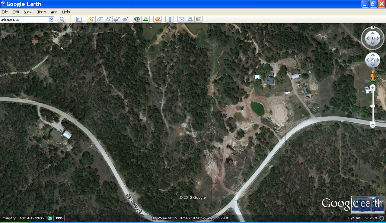

Last night, for no reason at all except boredom, I logged onto Google Earth. I was shocked :shocked: to find that they have just updated their aerial photos in this area and they are superb. :thumbsup: The photo of my place now includeds both of my new ponds and even caught Ron Hall's motorhome sitting on its pad when they came to visit in April. The date on the photo is April 17, 2012. It was right before I pumped all the water out of the 1st pond into the 2nd pond. You can see the small amount of water in the 2nd pond. I've attached a screen shot.

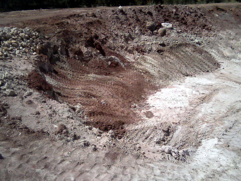

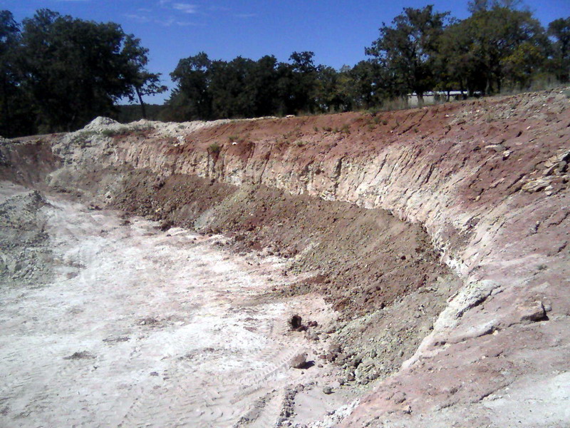

This last weekend, I got a little clay hauled to make my pond "apron" seal. It's 3/4 done with only some compacting left and final excavation and lining the last few feet of the perimeter where my ramp is built down into the pond. I could have got more done this weekend, but I have three grandkids who had birthdays and my wife's birthday is today. Those kinds of this always take precedence over working in the pond.
In the photos you can see that everything looks nice a dry. That's only because I've repeatedly pumped out the basin at the bottom of the pond. It's been a process of pumping out the water and then waiting for a week to dry up before I can get back into the pond. If there is even 4-6 inches of mud, it's like trying to drive on banana peels. Even with 4WD and the differential locked, my backhoe just spins tires and refuses to climb out of the pond with a load in the bucket. I have to scrape away the wet mud and then traction is fine. Anyhow, these photos show the apron over the area where the sand layer is located. It will seal the off the sand and keep my water from seeping out. If I had a lot of rain, I wouldn't even worry about the small seeps, but even my ponds that are water tight are down 1/3 to 1/2 their total volume. Here are some photos to show what I'm doing.

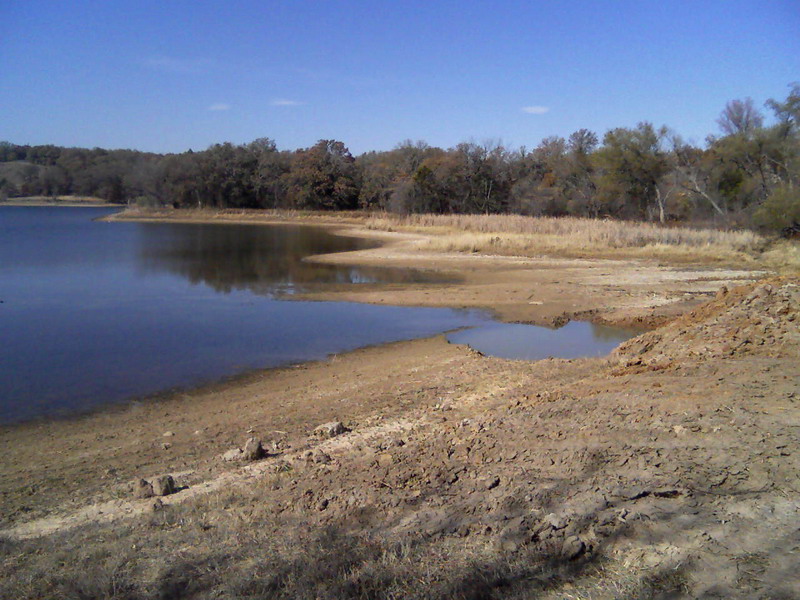

Waiting for rain to fill my ponds makes me feel sad. I keep hoping for a significant rain storm, but most are only 1/4" with the rare storm dropping 1". Some days I feel like that reporter who kept asking silly questions to Lt. General Honore about preparations for Hurricane Rita. Waiting for rain is "being stuck on stupid.":confused2::ashamed:

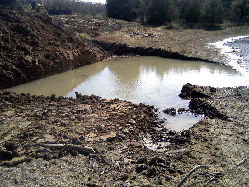

Of course, we will eventually get some good rains, but I've decided to make the best use of my time by recovering topsoil silt that is exposed by the receding shoreline on our little lake. I've actually seen the lake level lower, but I don't want anything like the drought that almost dried up our lake about 7 years ago. Below is a photo of what the lake looks like today. Water normally covers the grass and cattails in the background. The lake level is down at least 5' from overflow level.
Drought has exposed a lot of very firm shoreline and made access to the silted topsoil for easy removal. Sand seems to precipitate in a different spot with the silt around my shoreline being primarily topsoil and black mud that grows weeds quite well during the summer. Launching a boat from my shoreline in mid-summer is a tale of trying to navigate the heavy thick patches of weeds and also getting a boat to the shoreline for easy boarding. What I'd like to do is build a small boat dock, but first I need to cut down the shoreline so I have deep water under and around the dock. Digging with my backhoe, I got started and rapidly accumulated huge piles of silt spoils and even clay along my shoreline.
Of course, driving a 20k lb TLB along the sloping shoreline takes a bit of faith and possibly a bit of stupidity. Thank goodness for 4WD. There's no way I could do this without 4WD. The extra traction keeps things from getting out of control if I stay near the normal shoreline and just use the backhoe to pile up materials onto the firm bank. So far I have not even been close to stuck. I've been able to create a minimum-sized boat launch basin about 25' wide. My plan is to make this 50' to 75' wide along the shoreline. If it stays dry, I may get a deep shoreline all along my bank.

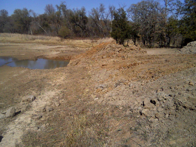

Here's a closer photo of the basin.
