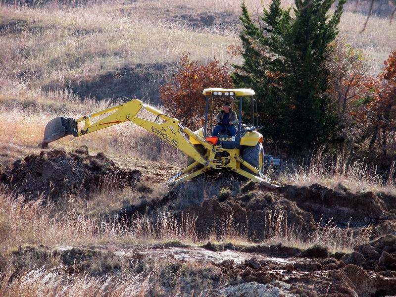

Jim,
Wondering what's the problem with digging from above? Looks like the hoe is doing a fine job of it.
Are you moving around from the hoe and pulling yourself around?
Why is your bucket in that position? It looks like it couldn't be very stable that way. I've seen it in the down positon a few times, but when I tried it, it was too squirrely for me. I like the bucket flat, and down as far as it will go to get the tires in the air.
I also put the outriggers down so the tires are in the air. One inch in the air is the same as a foot, so height isn't important, just getting the weight of the tractor on the outriggers is all that matters.
How are you digging? Are you curling and pulling? Or are you lifting in an upward motion?

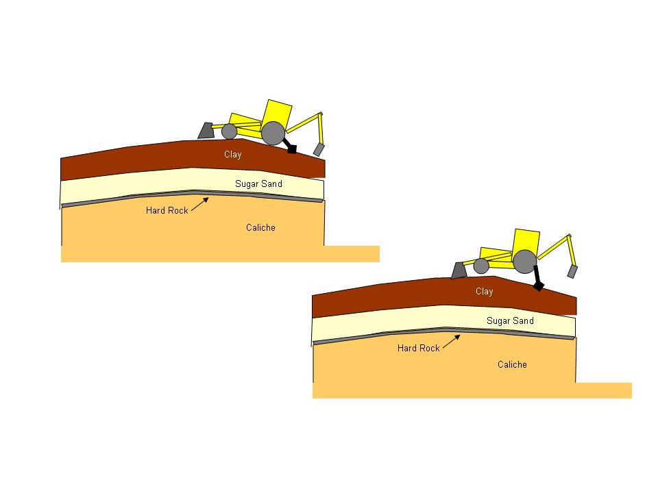

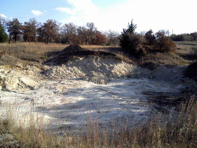

Eddie, the hoe works great from above. It does everything you'd expect and even digs into the caliche much better than from below. I suppose the biggest problem is how far down I have to go to get to the caliche. I have to remove a layer of clay, find a place to pile the spoils for later use, and then dig through a 3' layer of sugar sand. By the time I get all the clay and sand removed, I'm sitting on a 6' dropoff and reaching down to chip up the caliche with the backhoe teeth. If I were sitting just on top of the caliche layer, it wouldn't unnerve me so much.
The reason I bury the cutting edge of my loader bucket is because the back of my tractor is quite a ways below the front and wants to roll off the hill backwards. Even though I turn around, set the brakes, and put the transmission into gear before I move the tractor, when I drop down off the outriggers, it's a bit disconcerting. With the bucket firmly buried in that position, I can power forward/up and lift the bucket at the same time. If my bucket was flat on the ground, it could just slip/slide backwards. As you can see in my diagram, I need to get the outriggers all the way down to get my tractor level. I not only get the wheels into the air, but I level up my work platform with the outriggers and bucket. The diagram is exaggerated, but it's not that far off.
In the photos, you can see what I did yesterday. One of my biggest problems is figuring out the best place to put my spoils from digging with the backhoe. For soft materials like the clay and sand, I can put my tractor at 90 degrees to the dig site and rotate around 180 degrees to make a pile. Then, I can use the loader to move the pile. Sometimes I have to move a pile twice with the backhoe to get access to it. It's not the most efficient, but it's the only way my pea brain can figure out how to get the material where I need it. As you have pointed out many times in your lake thread, it's not only figuring how to dig, but what to do with the spoils that is so tough. In my case, I know exactly where I want the spoils, but I just can't reach that spot with just one dig. I'm glad I'm not payin' me to do this.:D;)
I've made a decision on how I'll proceed from here on out. (last attachment) First, I'm going to get the whole clay layer off and stockpiled for my dams. Next, I'll dig down and remove the sugar sand until I get to the hard caliche layer. Finally, I'll drive out on the hard caliche and dig it away. My strategy is "divide and concur."

Cyril, at this point, it's the only way that makes sense. Working from above in layers allows me to keep the material types segregated. When digging from below, I always ended up with sand mixed in the clay or didn't get all the clay. Working from above, I can scrape that clay away right down to the sand and have a clear view of my work at all times.
