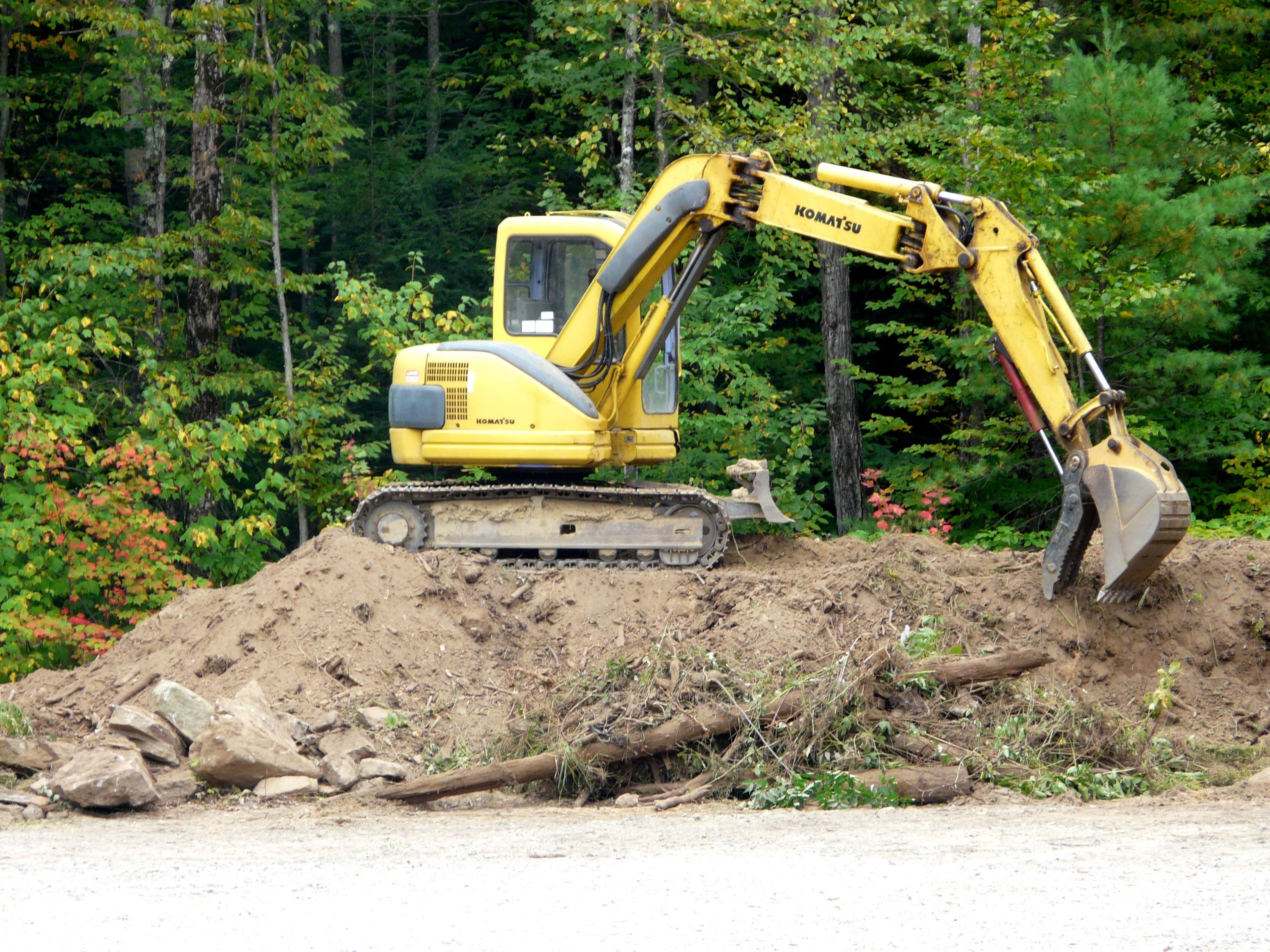

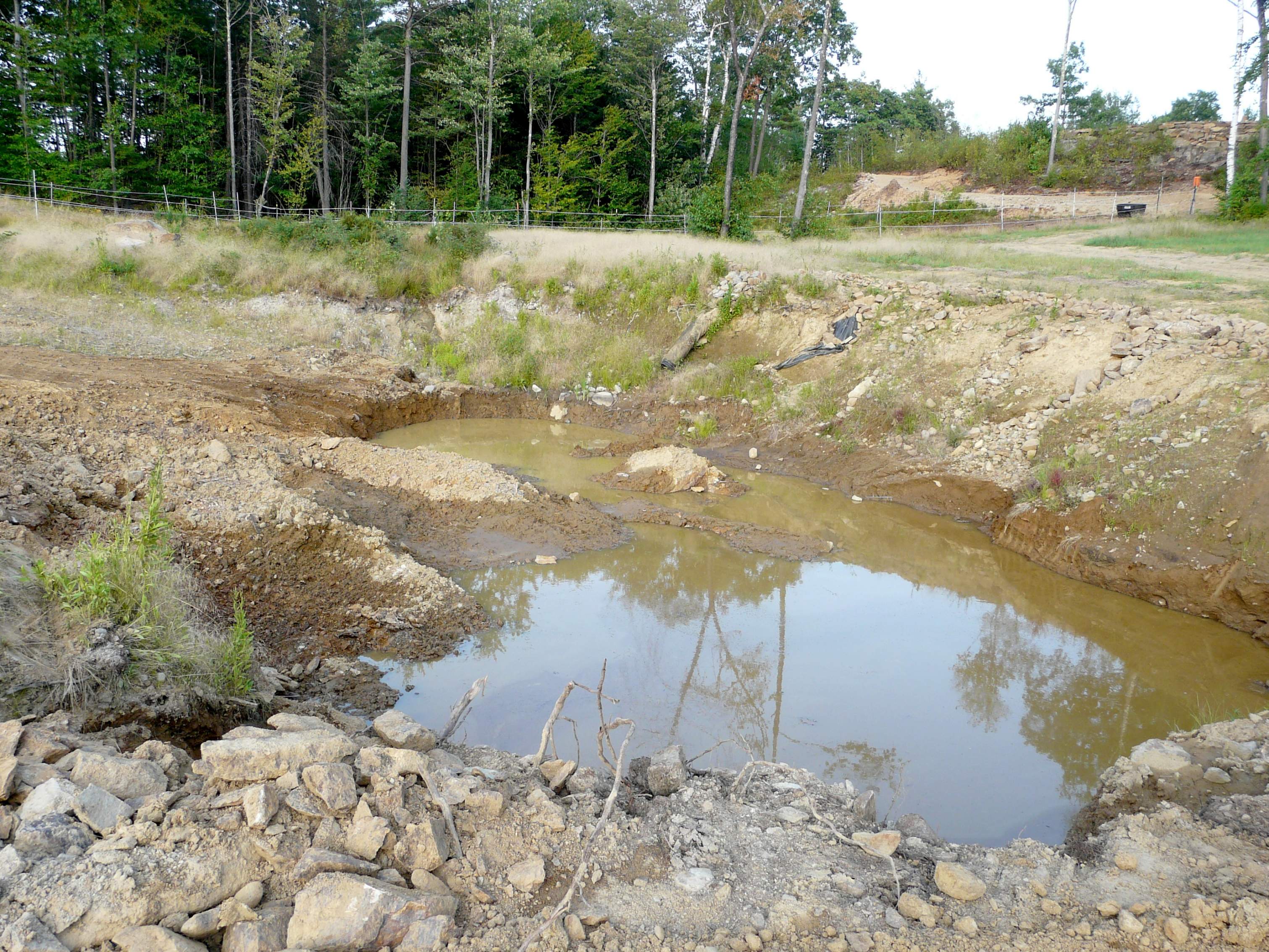

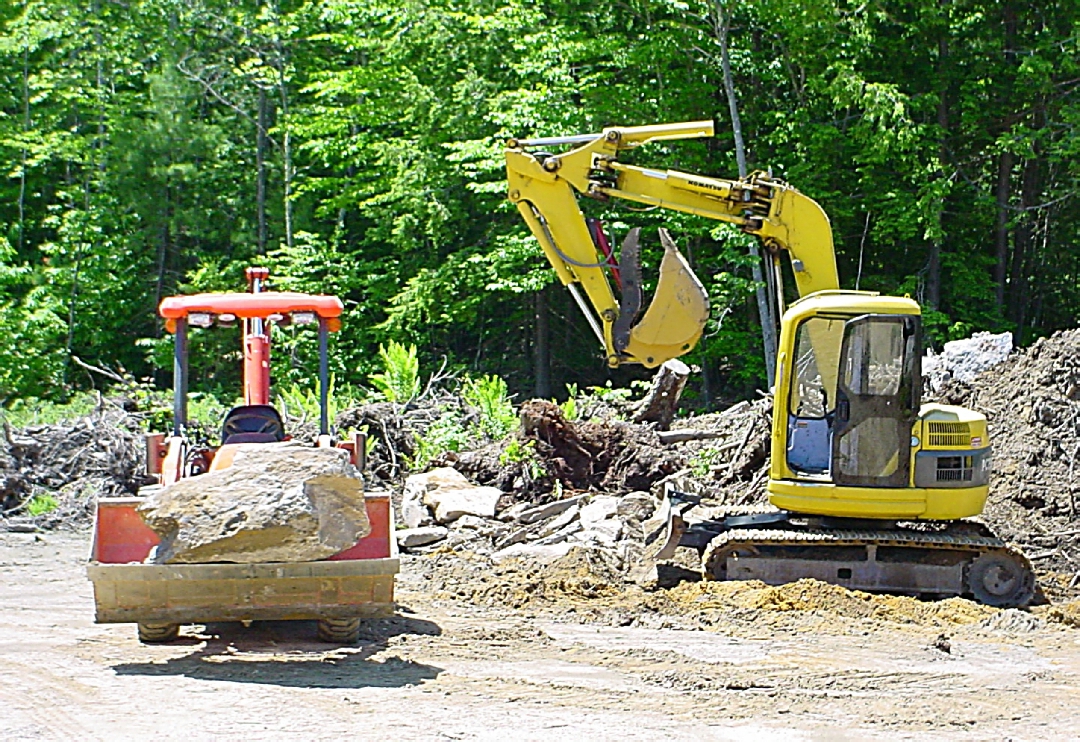

Actually
That is not much of a problem for an excavator, even if surrounded by a bit of water, you can move yourself and the spoils to solid ground.
Also working off a bench is easy digging.
Moving that 250 Yard pile of loam I'm sitting on ( starterd with 600 Yards) with my Kubota L39 TLB and moving each bucket 1/4 mile is SLOW, Very Slow work. My tweaked L39 may have 30-40 % over that TC, but it's about 1/3 a real Backhoe.

Actually
Mike, it looks like you got lots of seat time for sure. I'm lucky in that until I build my dams, every drop of water will run off because of the lay of the land. I will make sure both of my pond basins are complete and all dam materials are stockpiled before starting the dams. Then, I'll scramble as fast as I can go to get the higher dam built and finally the lower dam. Being able to move 1-1/2 yd or slightly more per bucket full is a huge advantage over my CUT's loader that tops out under 1/2 yard. Not only is the TLB a beast in size, but it handles a bucket full of dirt without getting squirrely at all. My 'pucker muscle' gets a lot more rest with the TLB. However, the loader sure works alot better on the downslope than the upslope. With the backhoe on the rear, trying to drive up a slope and backdrag down with the loader bucket can get exciting. The front of the tractor gets very light and goes airborne with ease.:eek:
