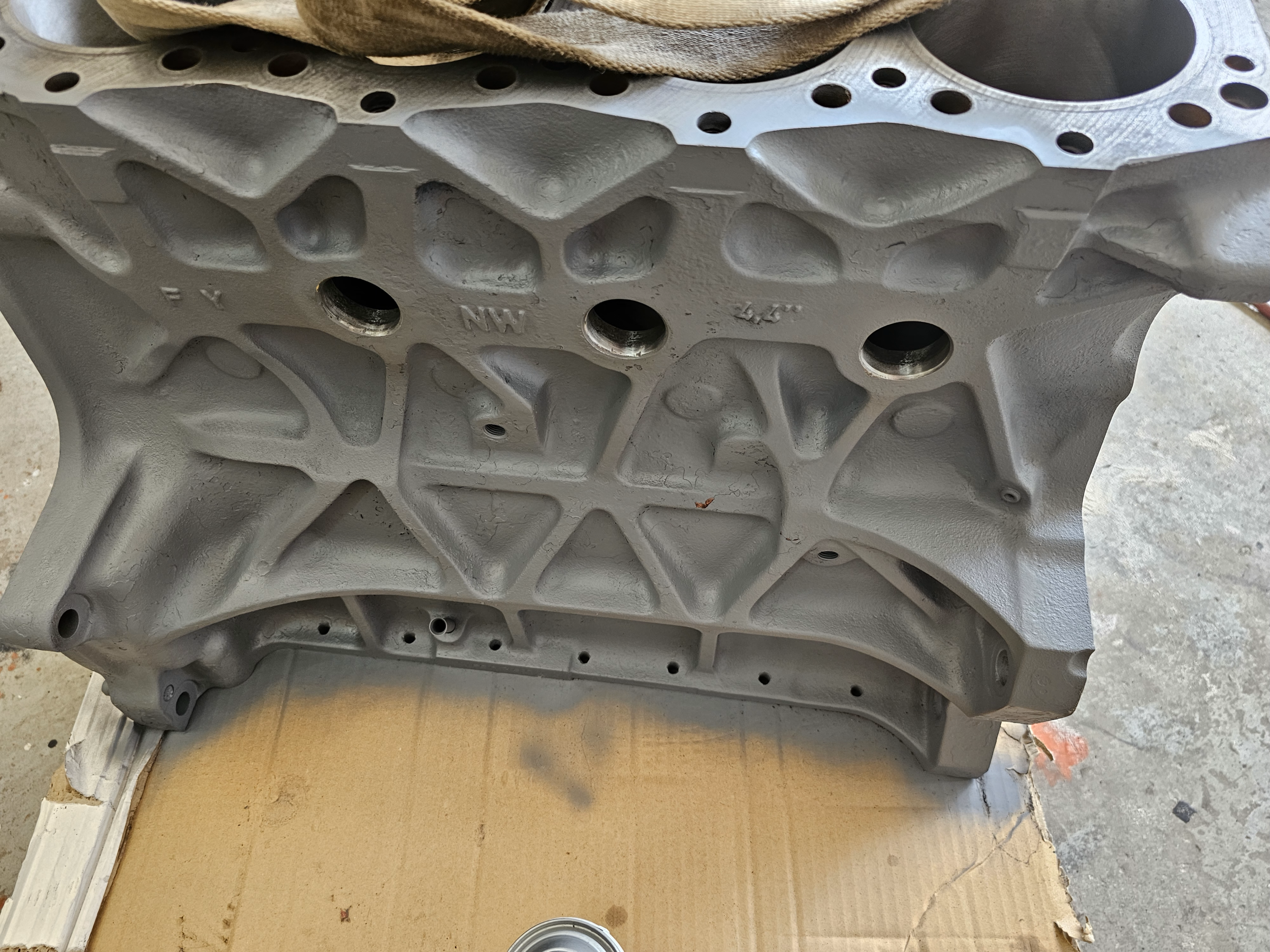

Do you have a list of everything that was done to the engine?
Bored? Honed? New Sleeves? New Pistons? New Rings? New (or rebuilt) injectors? Valves? Valve Guides? etc.
The photo you included of the cylinders looks like it has some rust spots, and I'd be most comfortable if those were bored or honed out.
That picture was before I sent the block out.
Sorry I should have included that information from the beginning.

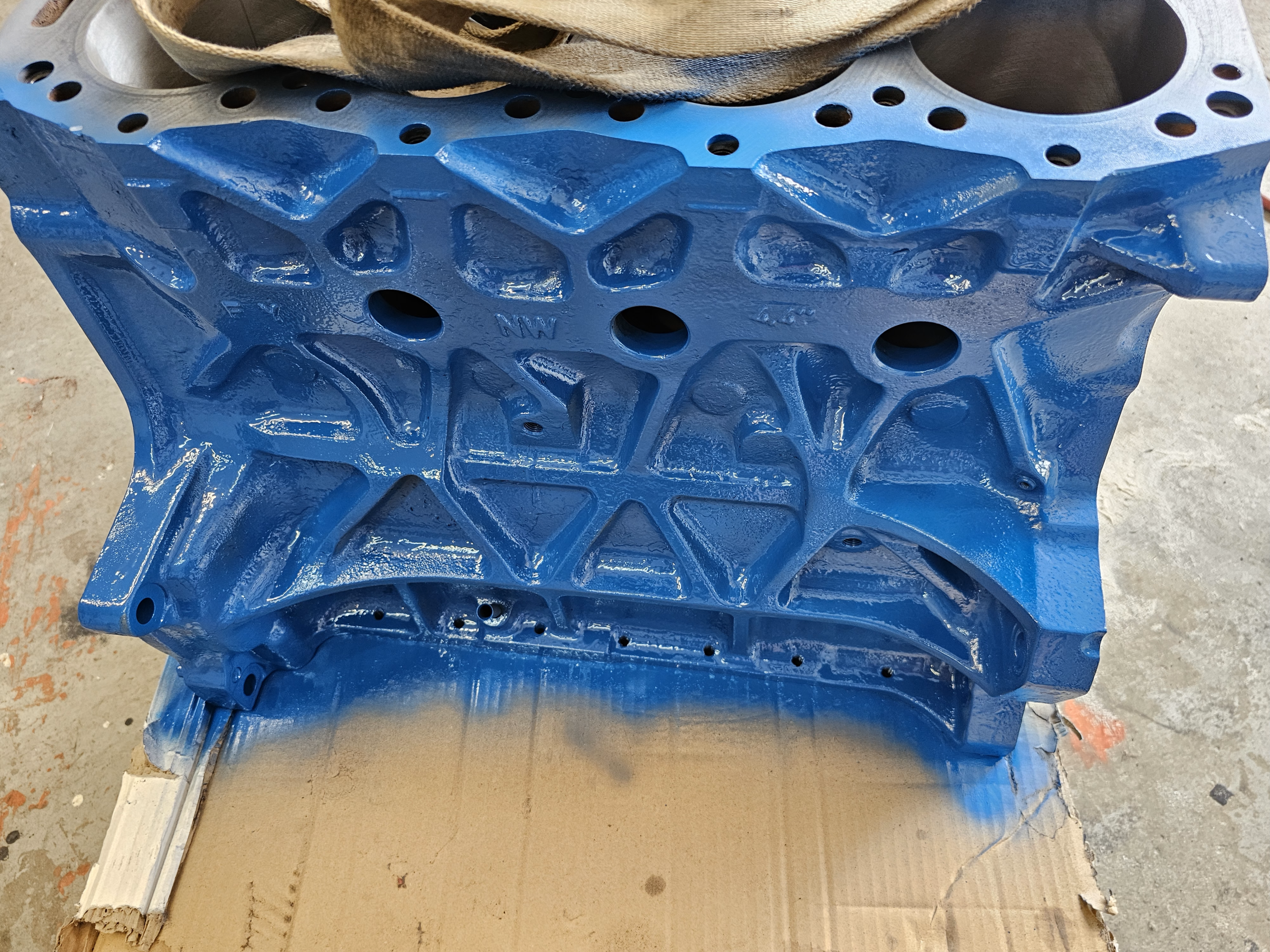

I dealt with the machine shop dropped and picked up. The machine shop got the Reliant rebuild kit and did the cam bearings, the rings were installed when I got the pistons in the boxes. They said everything was correct and ready for assembly. I have done mechanical work since I can remember and do pretty well on any project BUT, I wanted an experience builder to actually put it together. I have put engines together but I am NOT "The Engine Guy"
The guy that put the internals together came to my shop with his father and put it together. I had everything cleaned, labeled, and laid out on a table like a surgery before the doctor gets there. I watched them and waited on his every request (tools, bolts, supplies...etc). He seemed to know what he was doing. No big red flags on the build.
The owner had it at a repair shop for 3 months. It is a dirty mess to say the least with unfinished tractors sitting everywhere. The shop was probably good 20 years ago. The owner is in his 80's now. . It was never going to get done. The owner wants it done completely and correct. I volunteered to take the project. (not my best decision ever...lol) The owner is a friend of mine with no engine experience and was overwhelmed. He plans on keeping for the long haul and using it on his ranch for baling, and general work after adding a loader.
