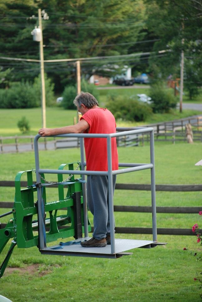

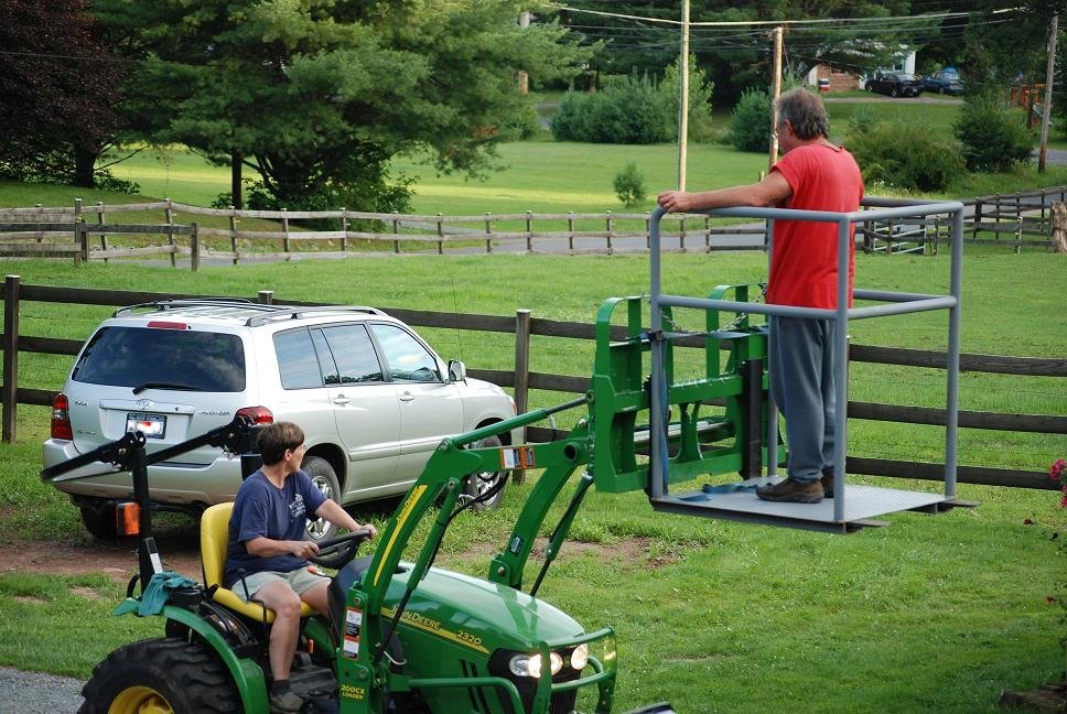

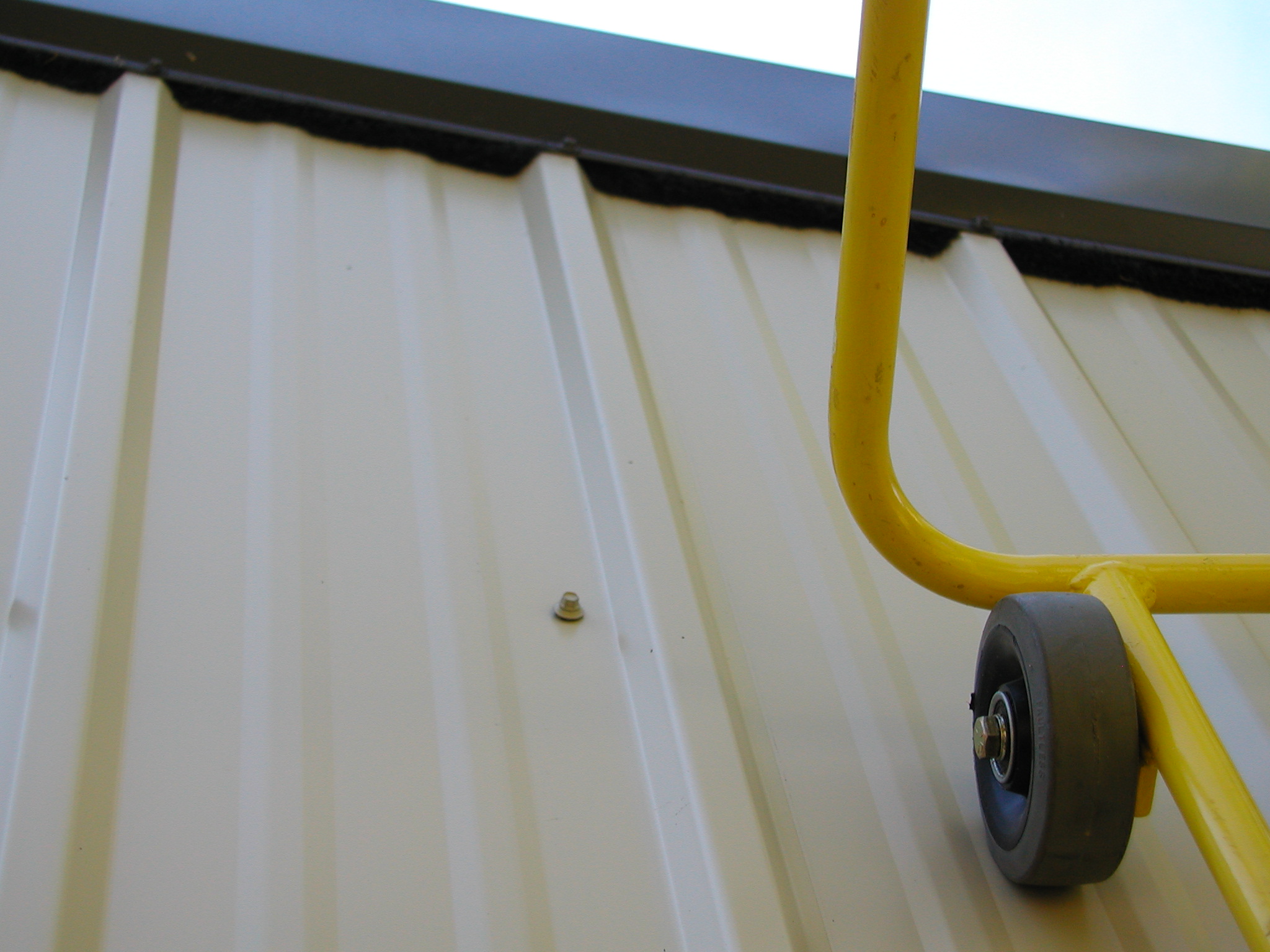

I built a wife lift too. Then a few years later I figured out that it could reach two feet higher with a simple design change. So attached is the result. Note: when it is acutally being used, there is plenty of ballast on the back of the tractor. I can reach to 18 feet now, pretty good for a loader that only reaches six feet high by itself. Notice the small grey rubber (non-marking) wheels on there. The final version has four wheels, two at the cage floor level, and two mounted at the corners of the cage railing. When the loader settles slowly, the wheels keep the cage from marking the building you are working next to. There is a 2.5 inch raised lip all around the floor edge for safety, and it keeps handtools from rolling out too. Now, if only I had a self-leveling loader...
Nice work Jim, and that's similar to how I would build one. I see you have a partial ladder attached to the manlift. I've thought about doing the same thing; but adding an extension ladder arrangement that would allow me to use the manlift solo, and also act as a safety stop in case the hydraulics failed.
I assume your 18' reach means your outstretched hand.

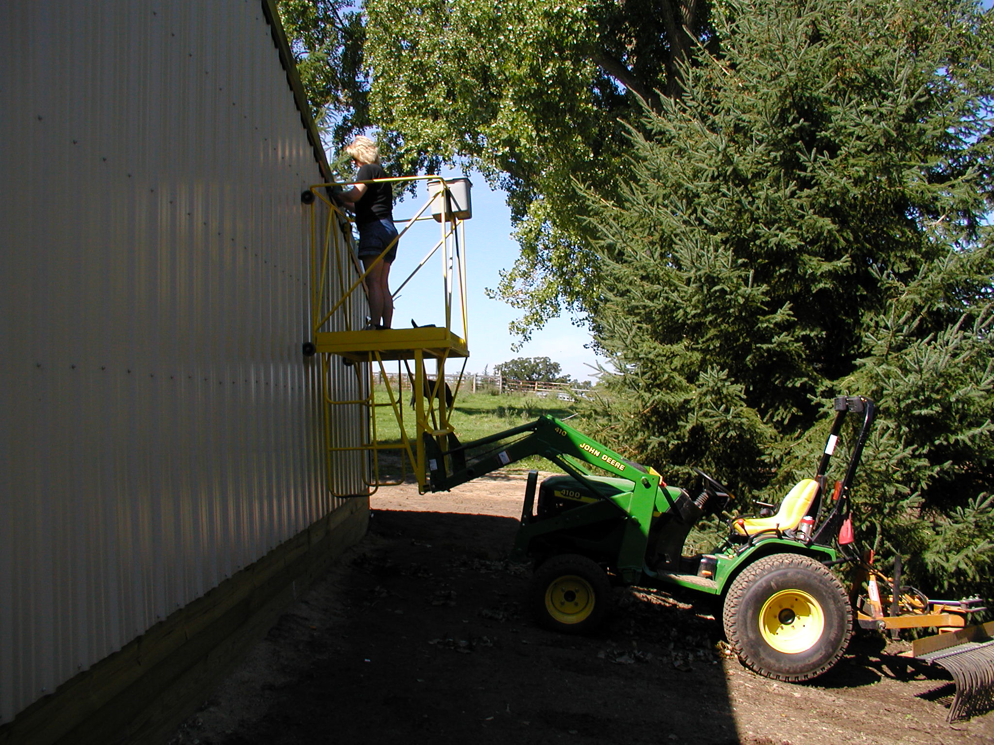

Yea, I can reach 18 feet. Loader reaches 6 feet, basket floor is 4 above that, I am six feet tall, my arms reach 2 feet over my head. Stabilty is great, once the basket is placed where you want it, you lower the boxblade just to touch the ground. It sure aint going to tip over, but I wouldnt use it on a sidehill either.
Extension ladder of some kind would be a great idea. Maybe a rope ladder or chain ladder or something flexible.
Here's an action shot, and a closeup of the caster wheel idea.
