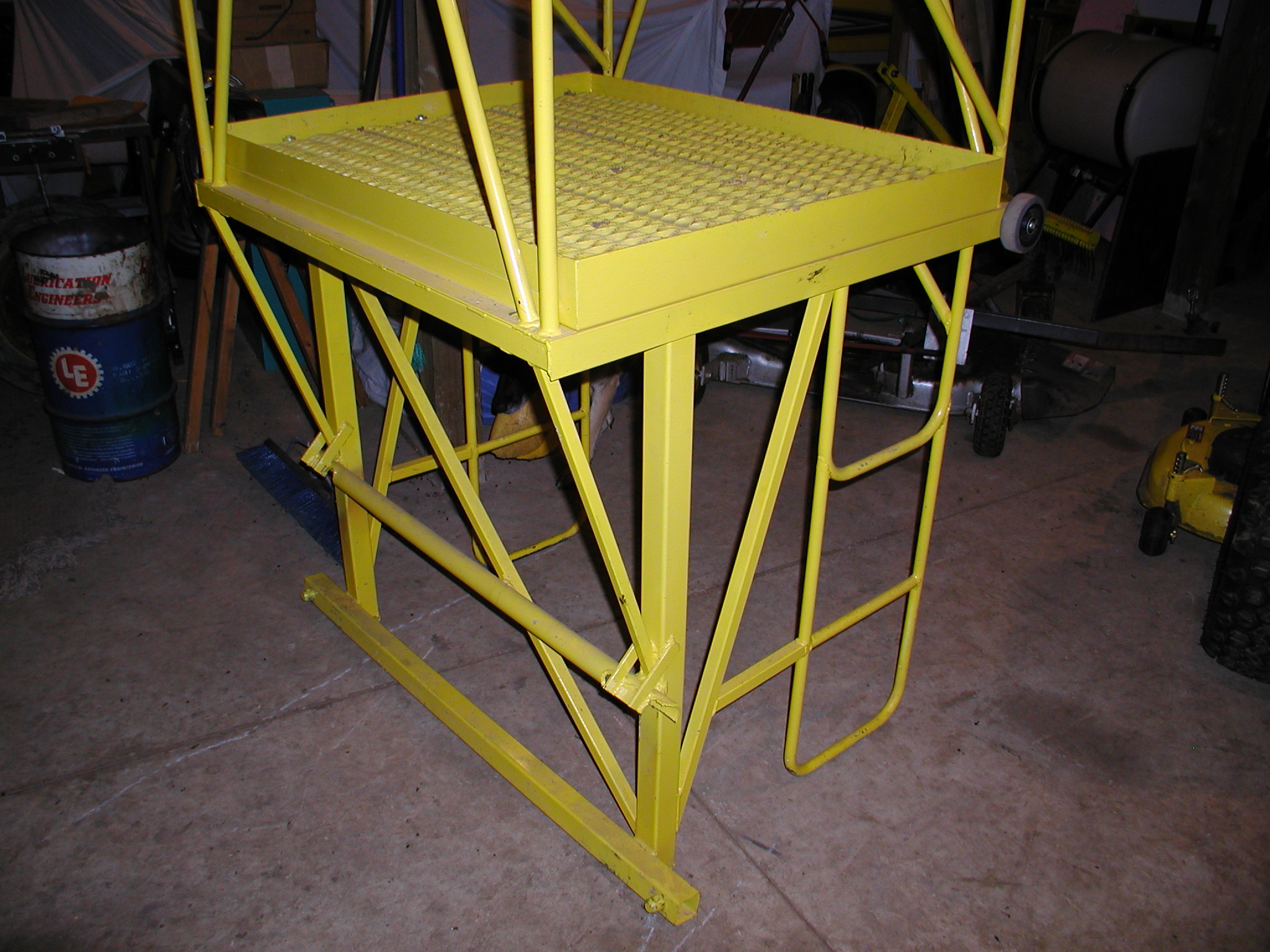

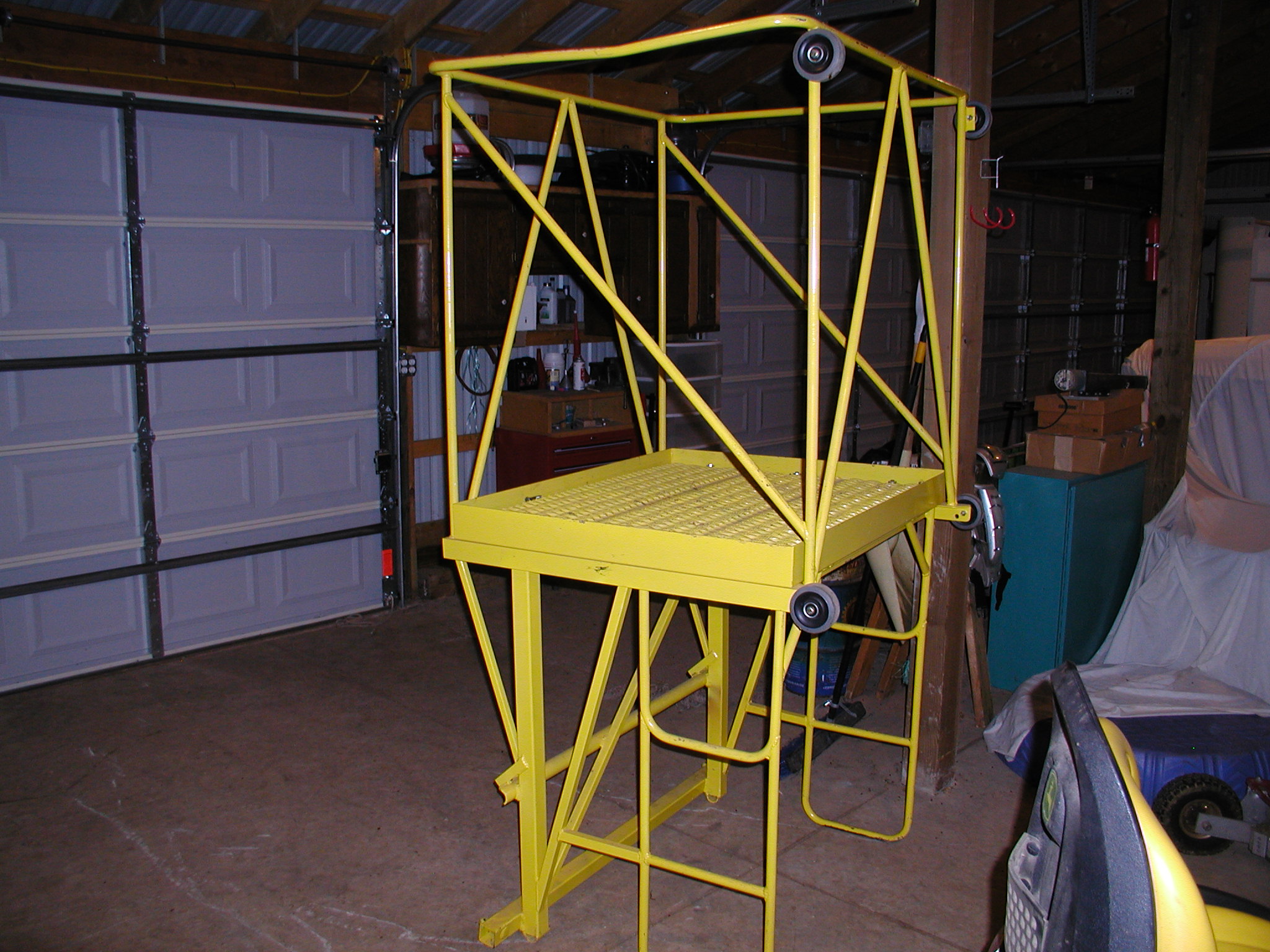

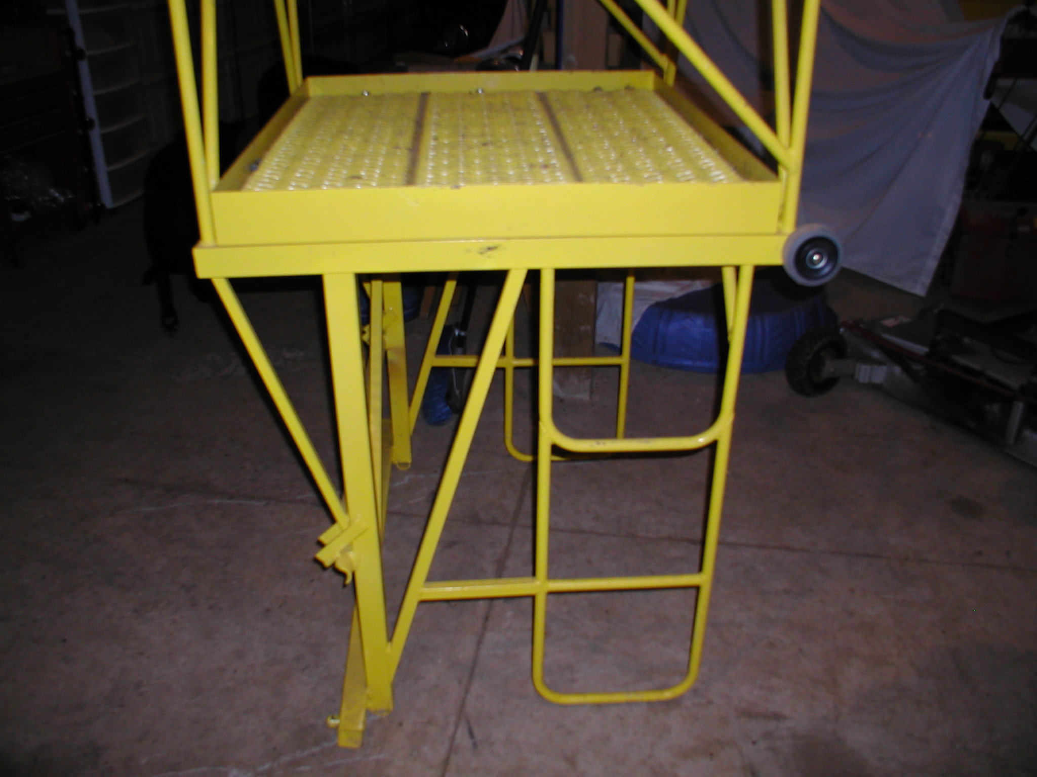

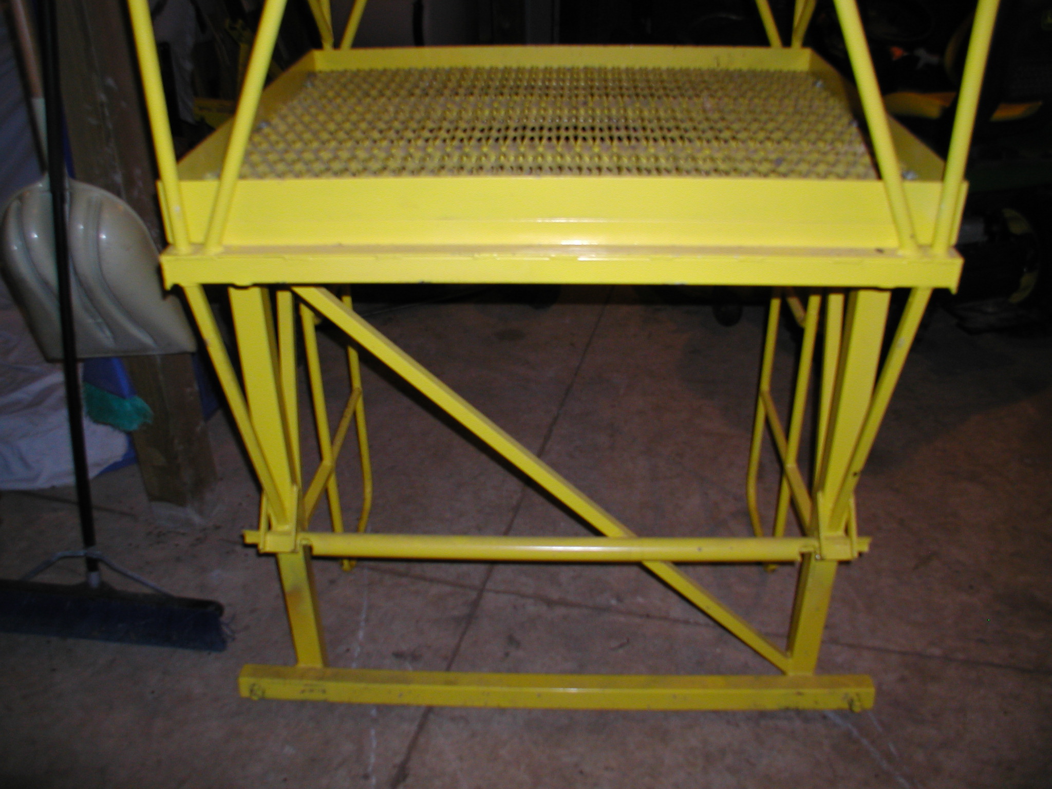

FINALLY I have a few detail pics. Currently the quick attach fittings on this man lift need a bit of attention. The upper hook features need to have an added new super-gusset added to make escape impossible, and the lower pins are a bit too short for the 300CX loader, so the linch pins won't quite go in (I've been using 3/8 bolts instead). Maybe I will straighten up the bent upper rail tube too.
