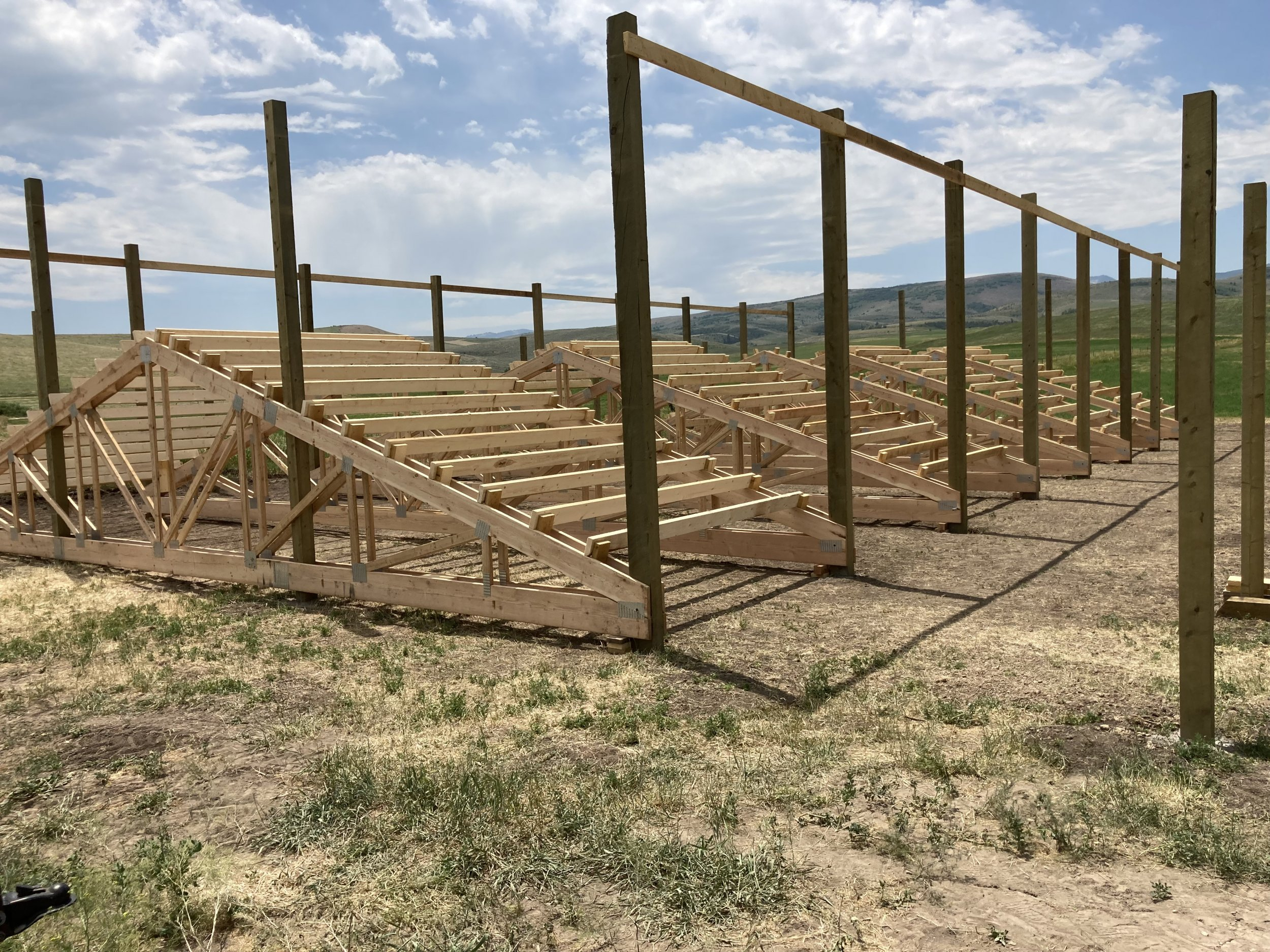

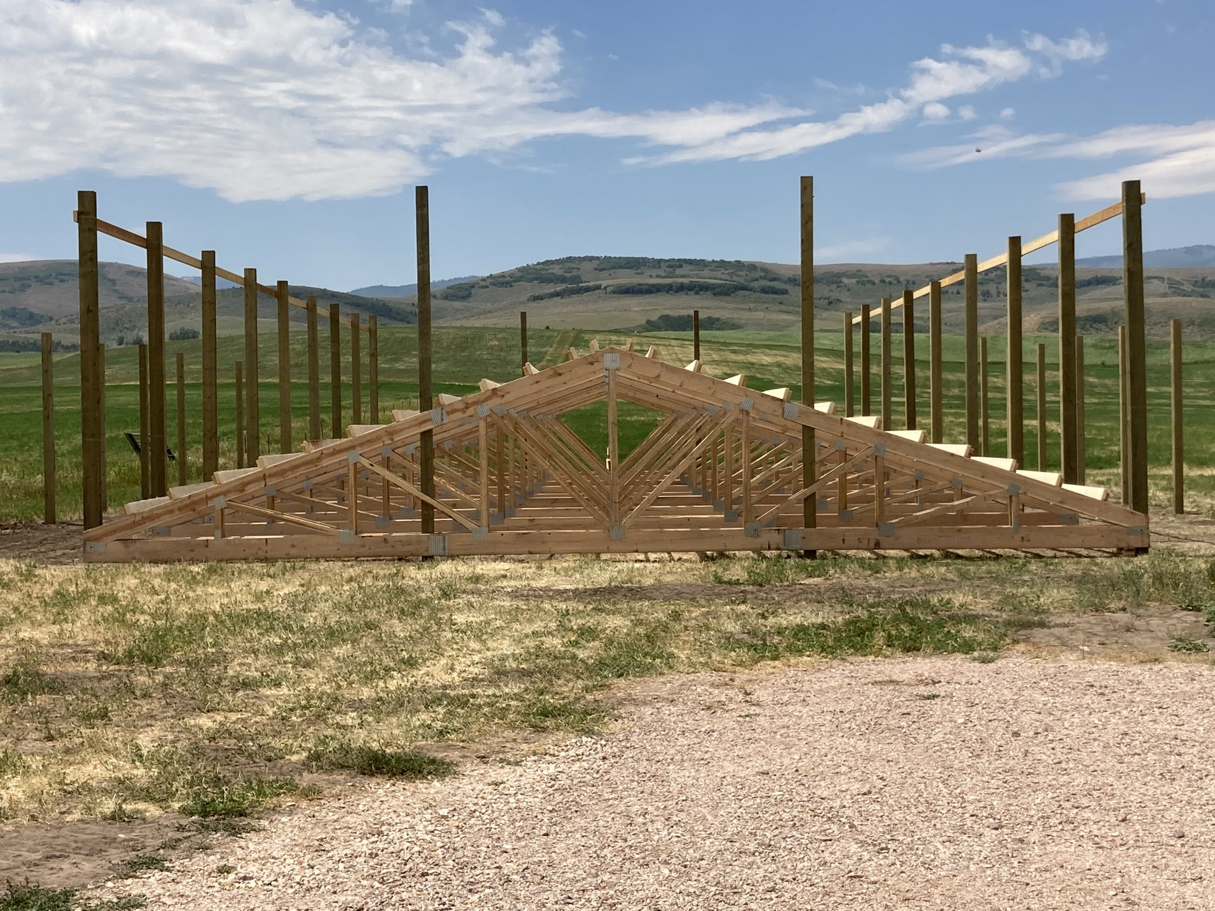

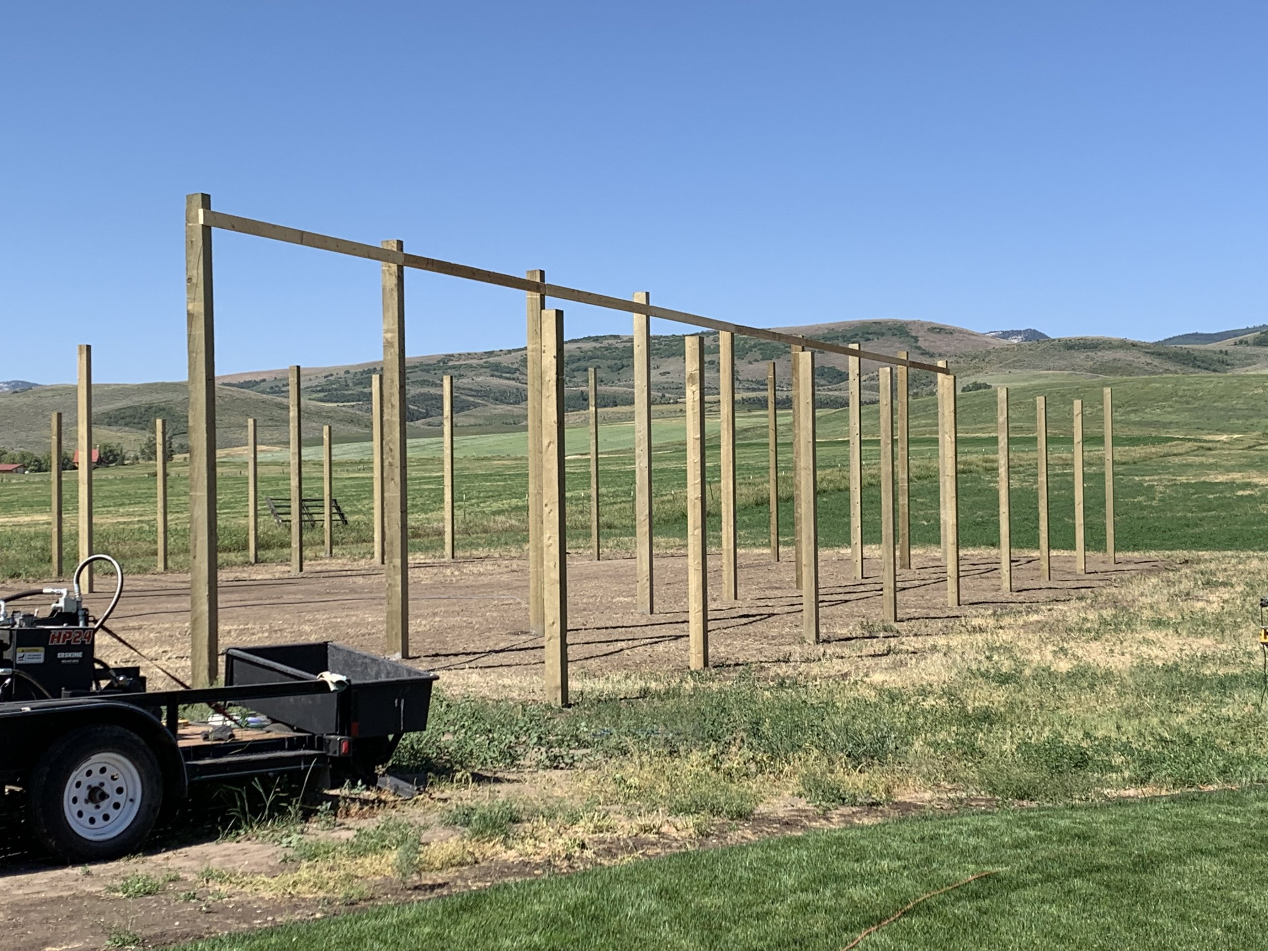

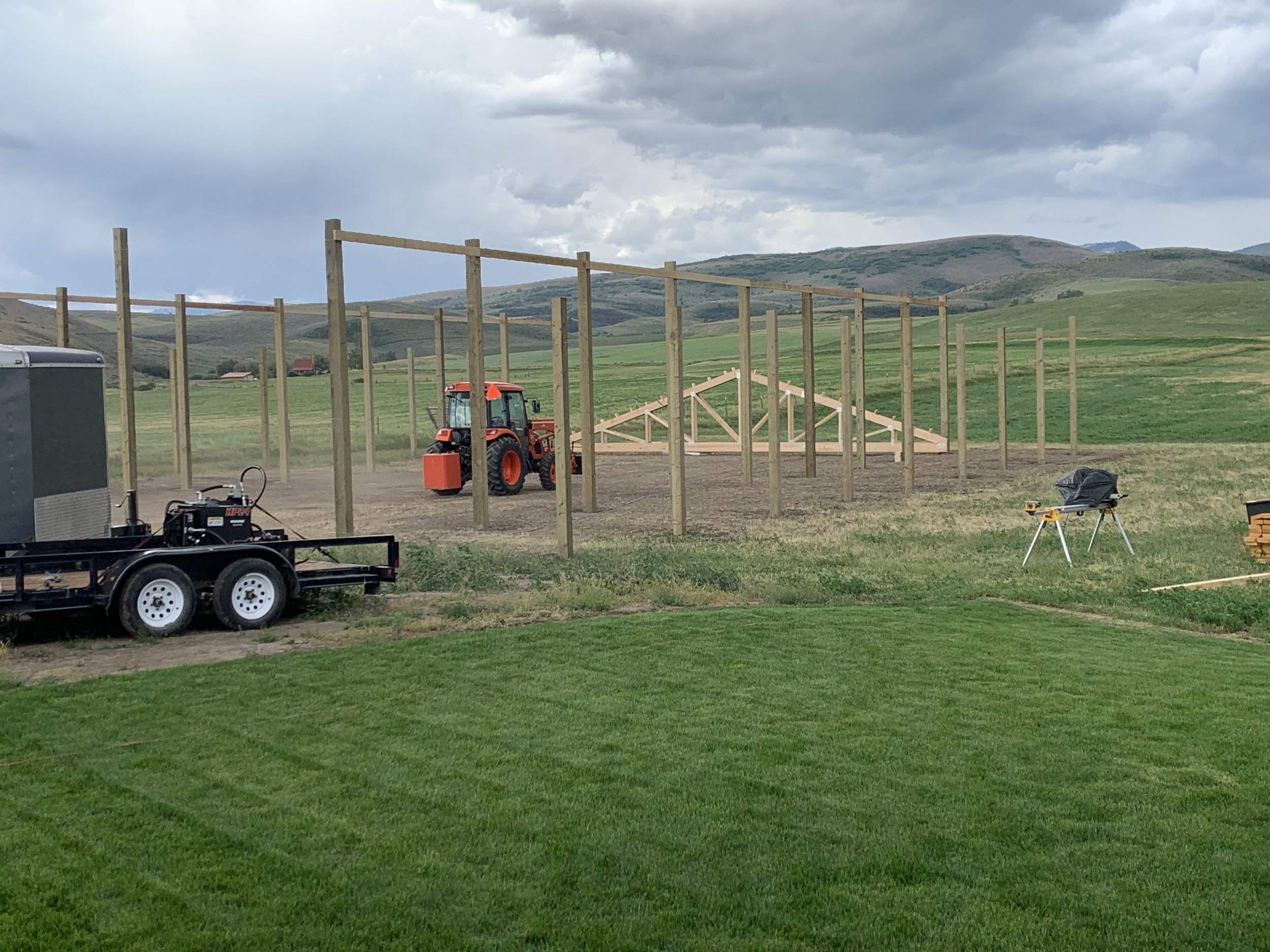

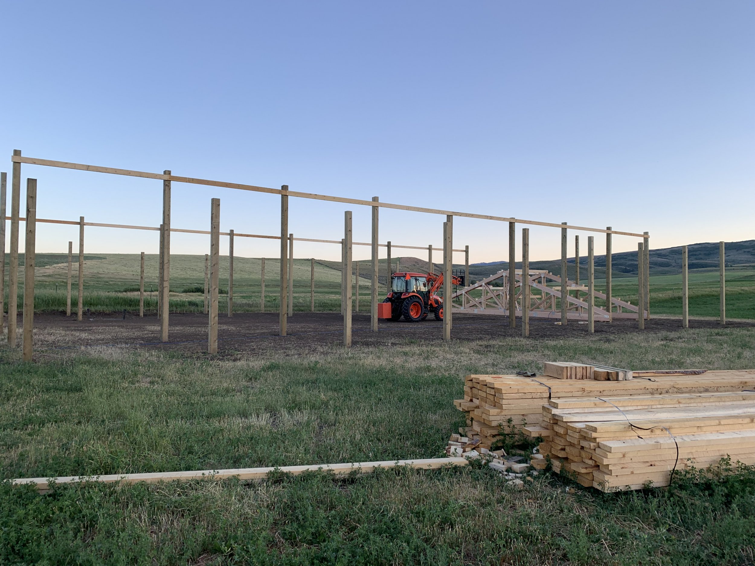

Whoa! 70 feet wide and 96 feet long.... thats nuts. Where's all the "stuff" you need to store in there? Concrete slab bill is gonna be insane.
SO! How did you raise those huge roof truss sections?
/ The last Barn. (maybe)
#22

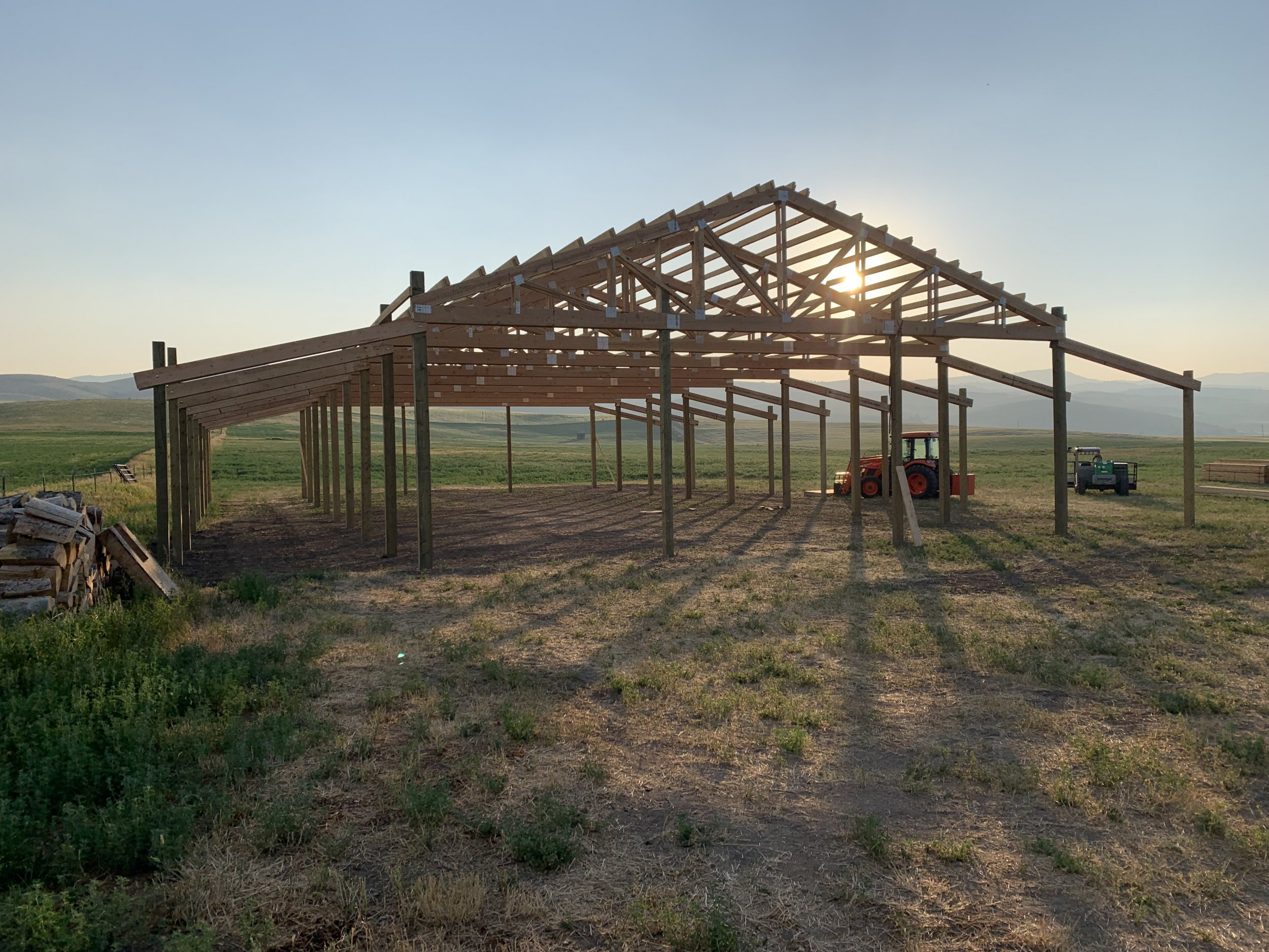

Later on I'll have pictures of the "stuff" inside. Concrete was expensive but the metal was the most costly thing in the whole build.
We used a boom truck to raise the truss sections. It was scary lifting that big of object that high but we did it without incident. I'll add I would never do it that way again. Too much twisting and the boom truck barely had the power to lift them. Although it did go fast, all trusses were up and bolted in about 3.5 hours.

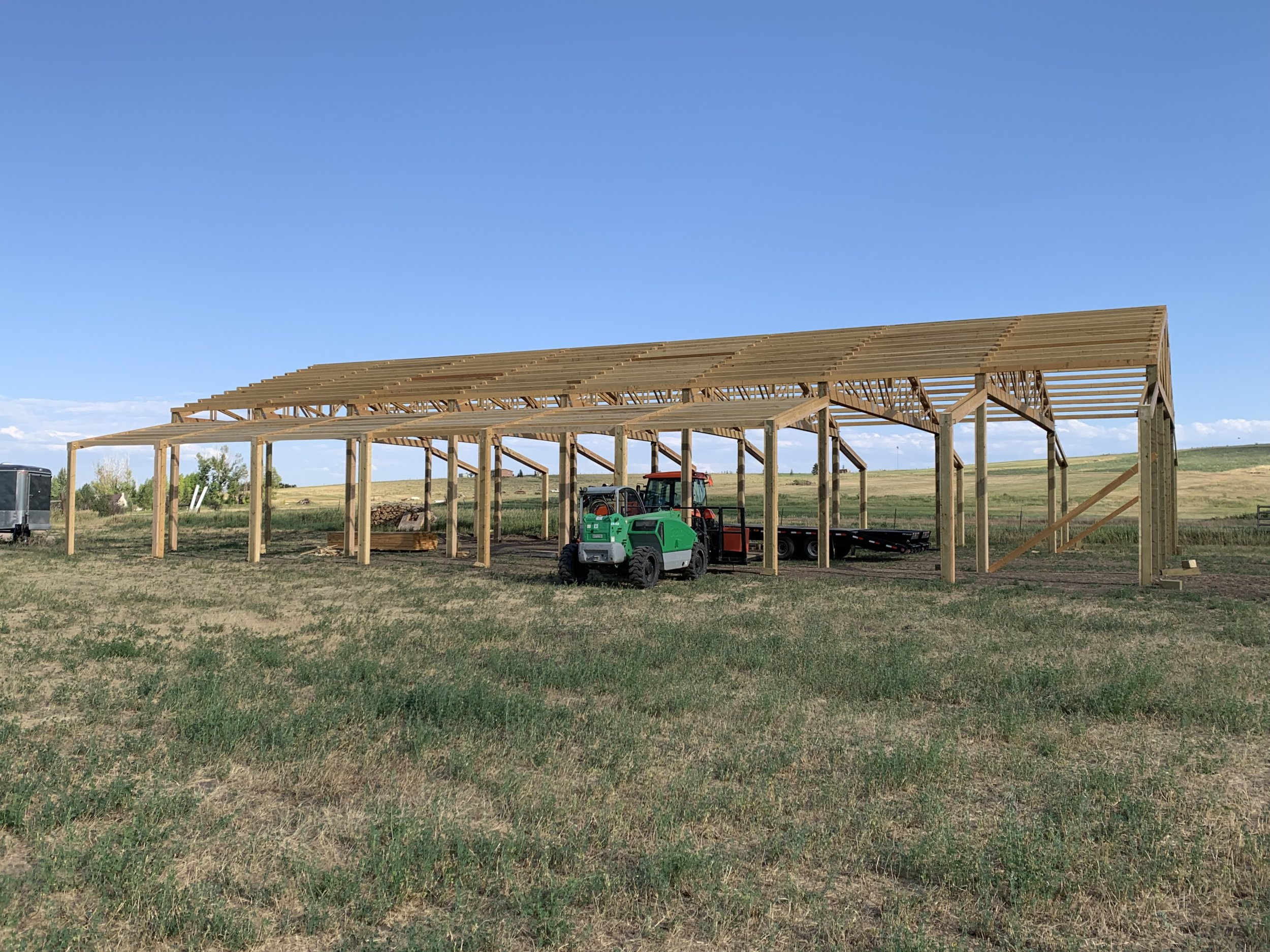

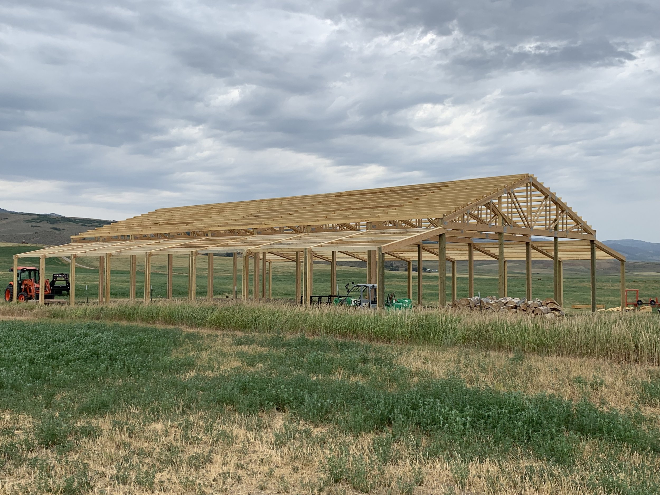

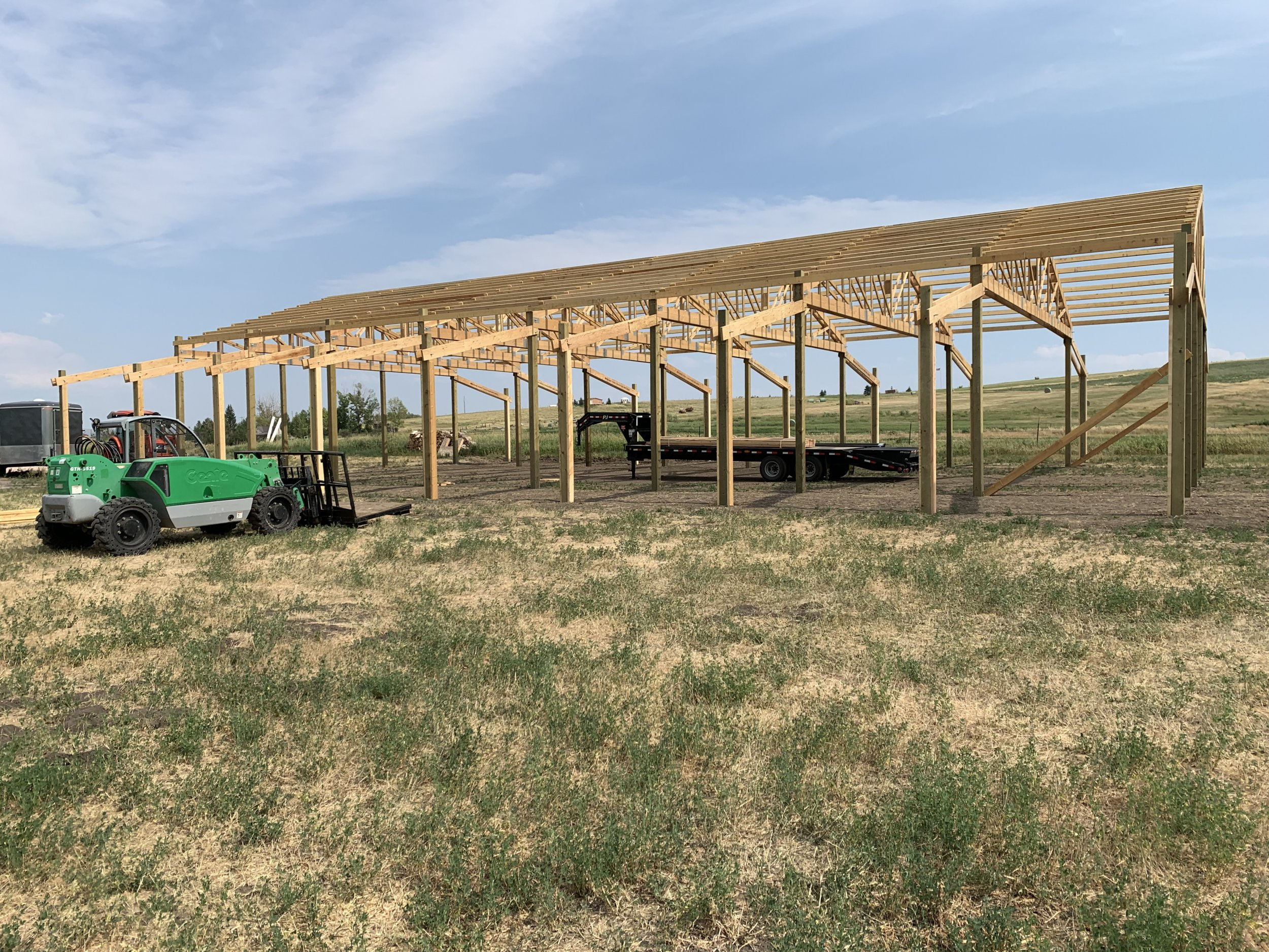

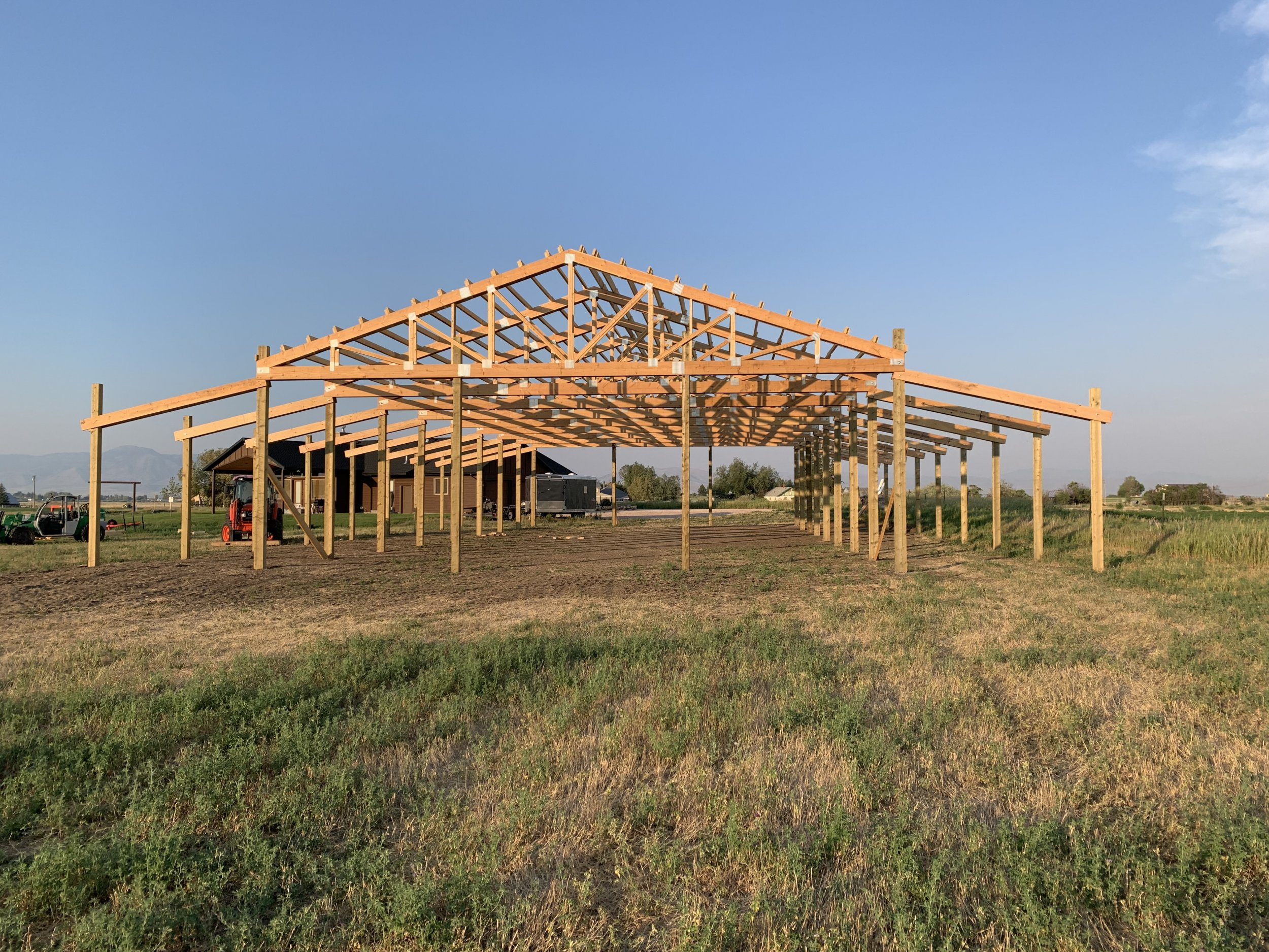

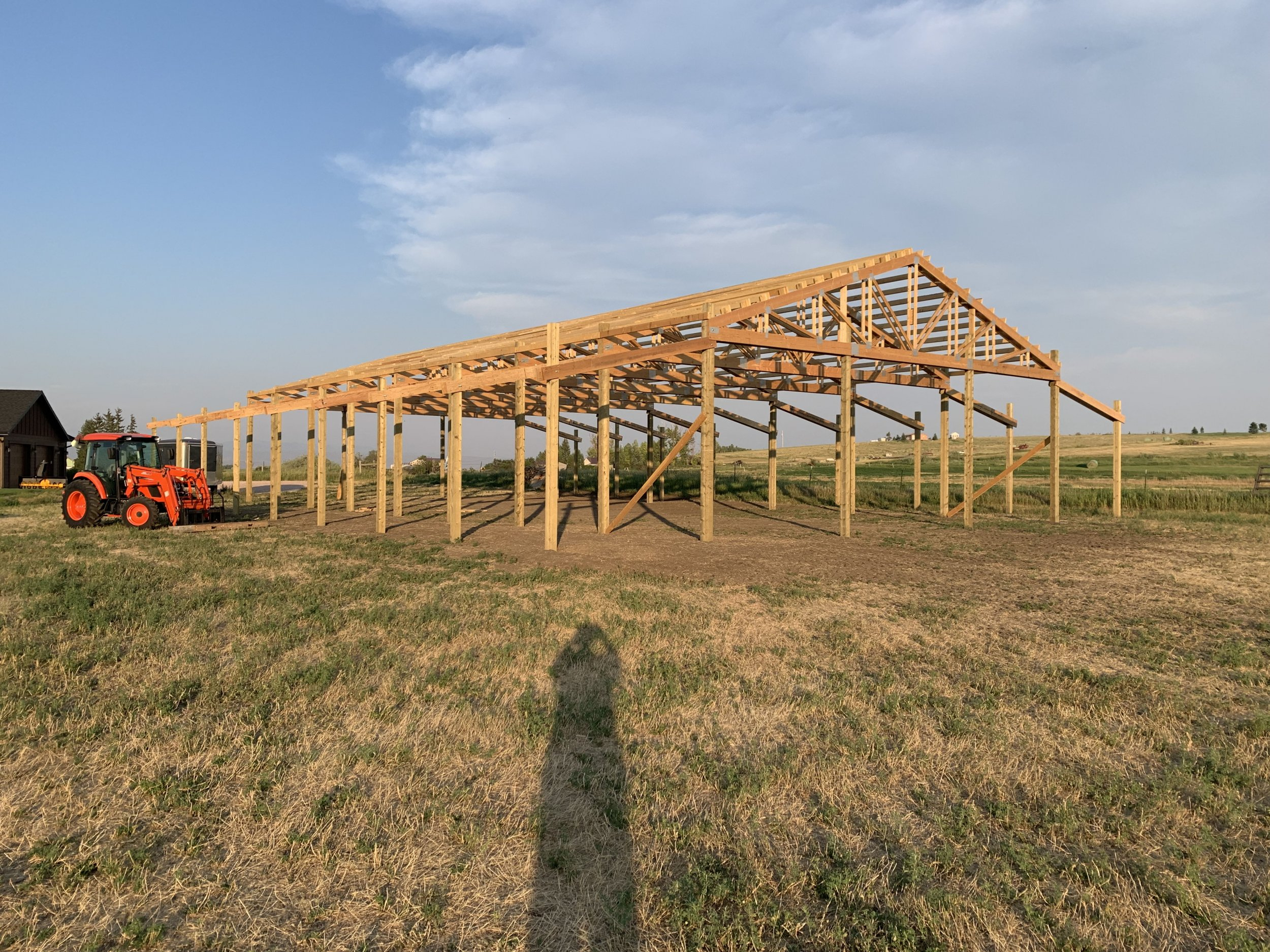

Huge change seeing those trusses in place!!!
#24
For sure. The neighbor helping me raise the trusses would like to build basically the same middle section. (no awnings) After seeing it and how easy it was he is ready. He has some big equipment and would like a place to work on it during the winter. He farms several hundred acres and has lots of "stuff".
#25

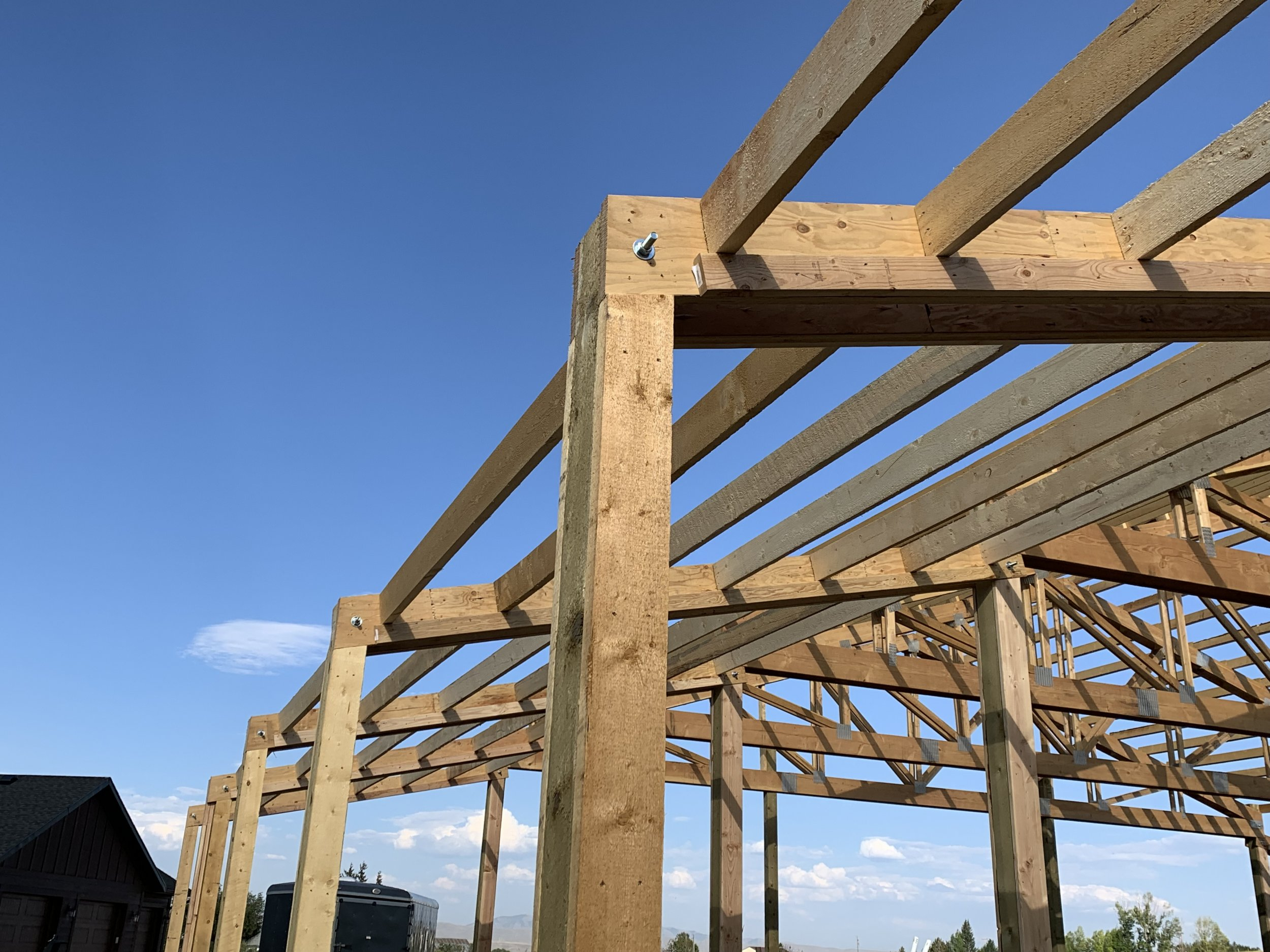

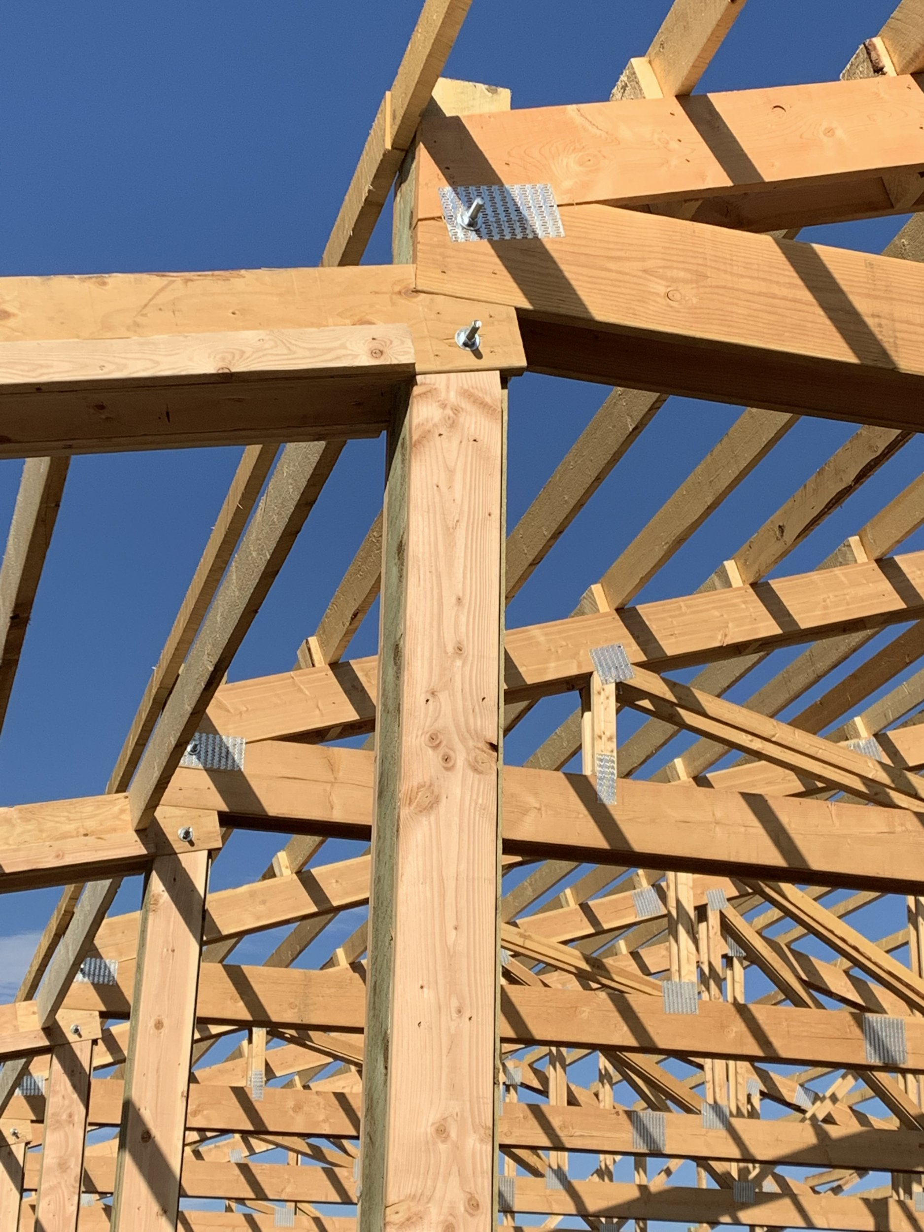

Here's the LVL's going on hooking the awning posts to the truss posts. FYI truss posts are 6X8X20, awning posts are 6X6X16.

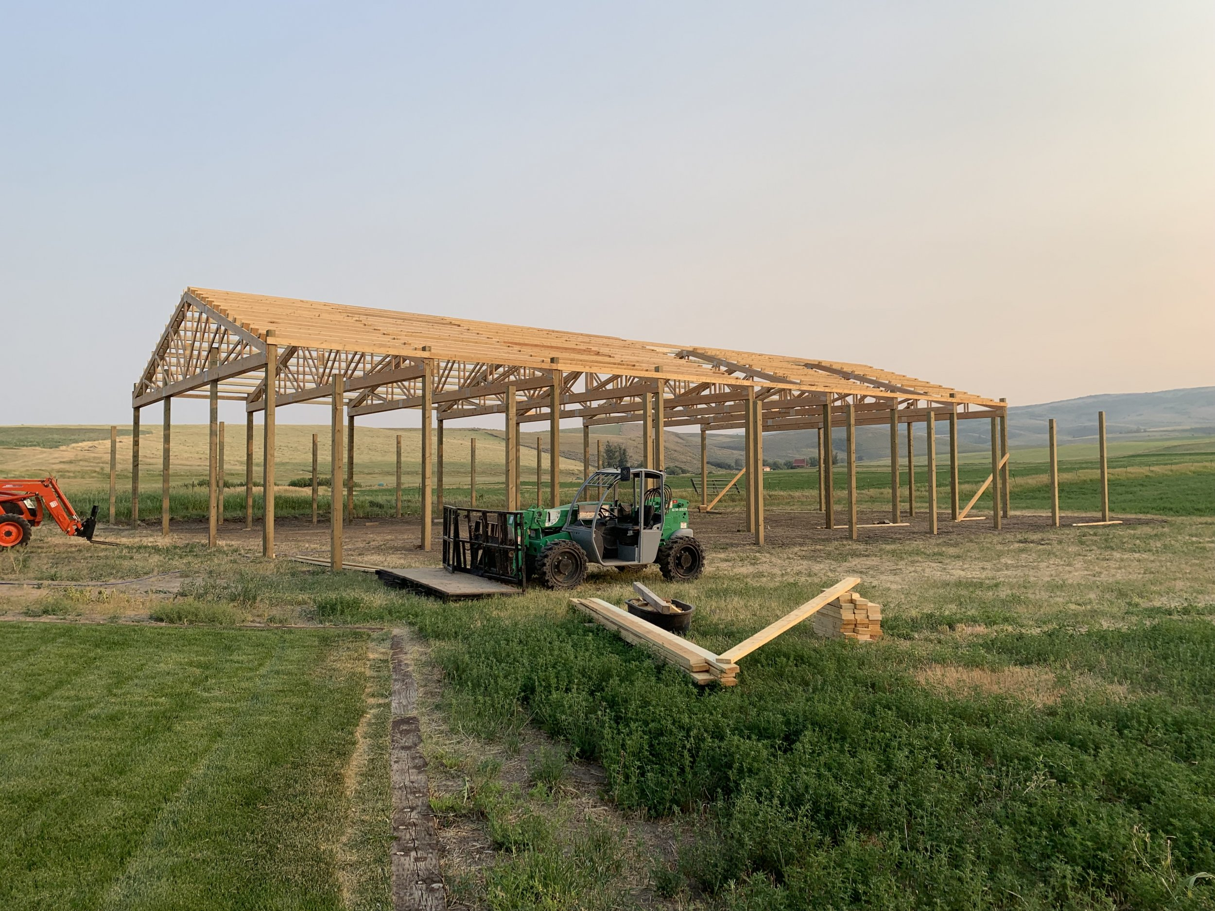

Time for metal. A buddy and I got all the roof done in 2 days. I did have to go back and put all the screws in, we just put enough to hold the metal so we could get it all up while my buddy was helping. I haven't done it before but I added a steel brace to all 4 outside truss posts. We do get some high winds when a storm is coming and I didn't want to see the whole building come down dominos style.
