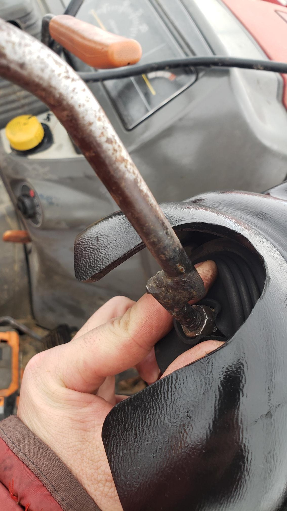

@Tinhack I called the previus owner and he told me he never replace the valve and he did not know what Float was. He told me it hapen to him once. He had and accident wth the tractor and falled and try to hold on on the stick and broke it. when he did that the loader was stuck in float he did not know what was going on. Somone showed him how to remouved it from float with a pair of vise grip bebause he had broken the leaver. He then welded the lever stick. I'll take picture. and never event try to used float he did not know what it was used for....

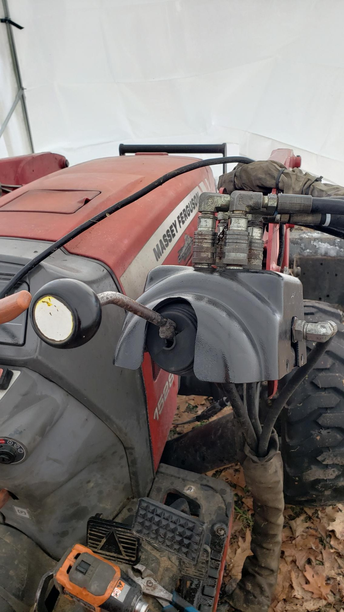

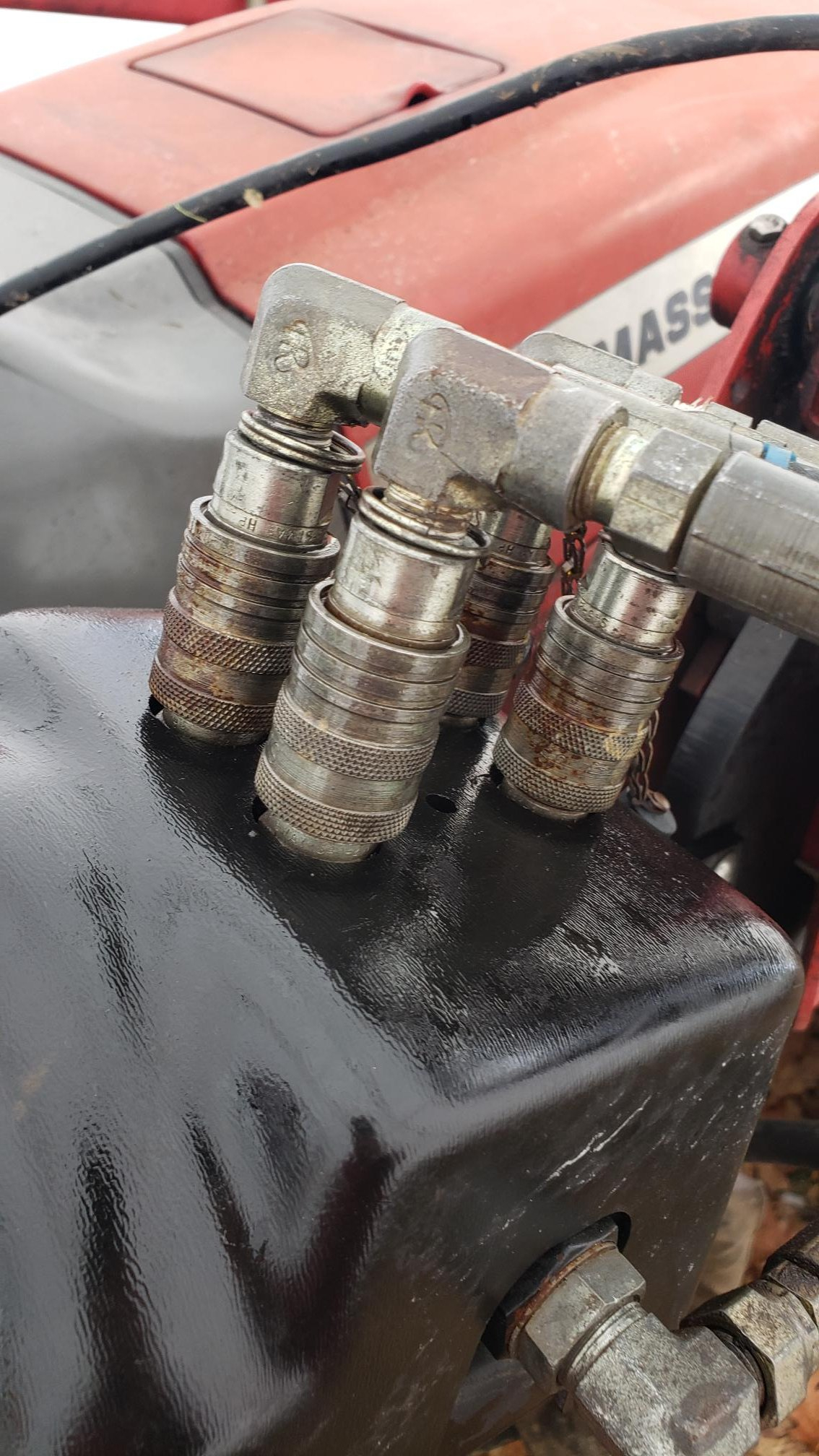

Here is what it look like. Some how I can't disconnect the quick connect Couplers. I have triend to put penetring oil into them witout luck so far. Those have probably never been disconnected.... Any trick on how to disconnect those? I have to disconnected them in order to be able to pulled the plastic cover

Oh Dear... Well easy part first: those connectors don't need penetrating oil. Rotate the collars until a little notch in the collar is at the place of a pin in the connector below them. You should be able to slide the collar downward with it's notch over than pin & that should release the connection. HOWEVER, you first need to release all the internal hydraulic pressure & then they should come apart. It should not matter how long they have been connected. Since your are having issues with the loader valve you might not have been able to release that pressure by simply rocking the control in all possible directions (??) Anyway, the hyd pressure is probably why they are difficult to get apart once you pull the collar down to release them mechanically.

I have wiglet the stick in all possible direction multiple time. I believed there should not be any presure left. The collar do not slide down at all. I have try to put a flat screwdriver and to gently tap the collar down without luck. All 4 collar do not slide down. They also do not rotate.
I just tried to disconnect the backhoe hose and it worked find. I was able to pull the collar backward and it did disconnect. I had forget to removed all the hydro presure before doing it. so I had to use a screw driver to push on the pin to release the presure. I was able to reconnect it.
But the loader no luck all all

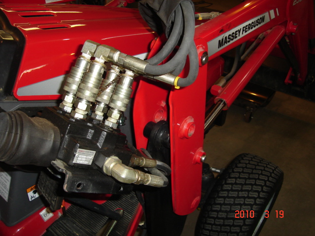

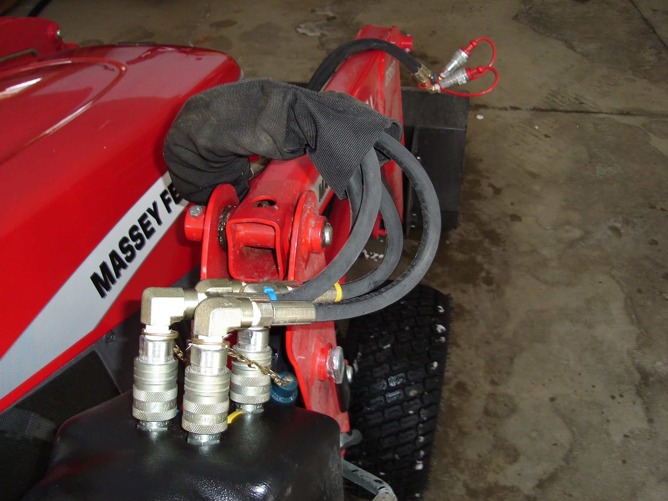

Try pushing down on the top of the elbow as you pull up on the locking collar. I find I need to do that on my 2310, which uses the same connectors. It seems to relieve internal spring pressure in the connector.

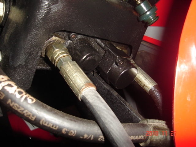

As far as the float, that's a plunger that pushes down into a release valve on the underside of the control valve (that large black thing on the right in the pic, held by two socket-head screws). It also has a split ring that's supposed to "pop" into place and be hold the plunger there, although on most tractors they will easily and quickly pop back out by themselves. (I have to hold mine in float with my right hand.)

I have a 1528 with same loader. Only use the float feature for back dragging with the bottom side of the bucket. First I tilt and drop the bottom of the bucket to the ground. Then starting with the bucket lever in the neutral position I quickly push the lever forward past the normal stop and it “pops” into the float position and stays. No great amount of effort required but it does take one fluid positive push past the normal stop to “pop” it into float. To get out of float I simply tap the lever back with my hand and it “pops” out of float and the lever returns to neutral. It will be early January before I am where I can look at my loader lever. Looking at your photos, has the lever been welded in a position that restricts the forward motion so it does not go far enough forward for float?

I tought about that as well the guys did weld the pied on the top and it could prevent from punching forward but when I push it slowly it does not touch the plastic. I want a removed that plastic cover to have a better look at it. I just can' disconnect those stupid hose. Some have sugested to lose and hydrilic conection to release pressure. It's my next option but I don't want a do this at the moment. Winter started here. we got 2 foot in the beginning of the week. Normaly I have a polaris sportman 850 with track to move my snow arond. it's a mini bulldozer. but it does not start anymore. I think it's the starter. the sucker did let me down in the midel of the wood. I was lucky enuf that I could still get to it with a truck. So I pulled it back to the cotage. I have to fix it before I break my tractor...With covid parts are hard to get..
