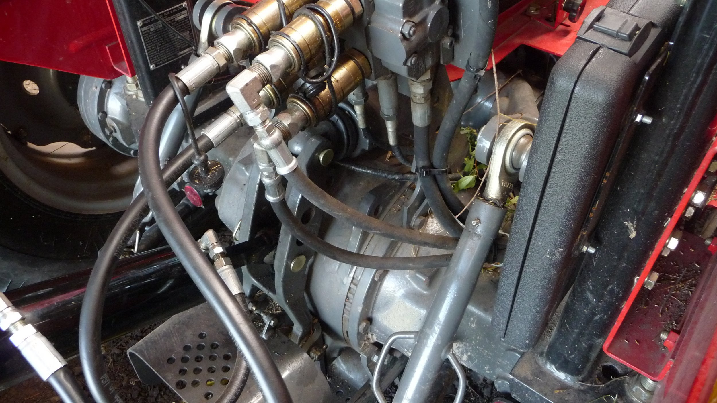

OK, hope the video attaches. Notice the collar is anchored to the bracket, and ALL the other parts move. Exact opposite of older, 2-hand disconnects.
NUTS! I can't get the video to show up when I click the paper clip to attach. But it IS in my photo library. A bunch of older pics show up, but not the video I just shot.
For now, if you want to see the "just yank em" style being unhooked and rehooked, furnish an email address. Meanwhile, I'll try some other things, like emailing the video to myself.....

irving, the video by Mike? Did not show my style. On mine, the collar is anchored solidly and the hoses do the moving. If you want, send me a PM with your email address. I think I can attach that video I shot around noon demonstrating how mine work.
Yes, as I said in post #60 above there are at least two kinds of Pioneer or "AG" connectors. Mine like yours have solid non-moving collars. Pictured here.
The other type, with knurling on the collars, do utilize moving collars for release. But apparently are Pioneer and not flat face as Mike's video shows.

I have wiglet the stick in all possible direction multiple time. I believed there should not be any presure left. The collar do not slide down at all. I have try to put a flat screwdriver and to gently tap the collar down without luck. All 4 collar do not slide down. They also do not rotate.
I just tried to disconnect the backhoe hose and it worked find. I was able to pull the collar backward and it did disconnect. I had forget to removed all the hydro presure before doing it. so I had to use a screw driver to push on the pin to release the presure. I was able to reconnect it.
But the loader no luck all all
Gotta get the collar to rotate. Then line the notch on the collar with the nub on the rest of the connector before pushing collar down toward nub. If the collar won't rotate, is frozen.
