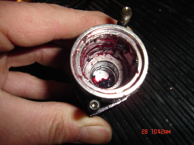

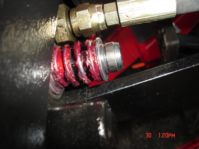

If you're interested, here's a close-up of the inside of the control valve. When you push the joystick forward, past the "GO UP" portion, a plunger will go down into that socket; the grooved end of it is supposed to click into that snap-ring and stay there (though they often don't). That is the float position, where any device on the front end (FEL, blower, broom) will stay down only by its own weight but still be free to rise if the ground does.
First pic shows the end of the float control plunger, with the groove on the end. Second pic is looking down inside the float control socket, showing the split ring at the bottom. A good idea to take that apart --when you can get to it-- and clean & lubricate it.

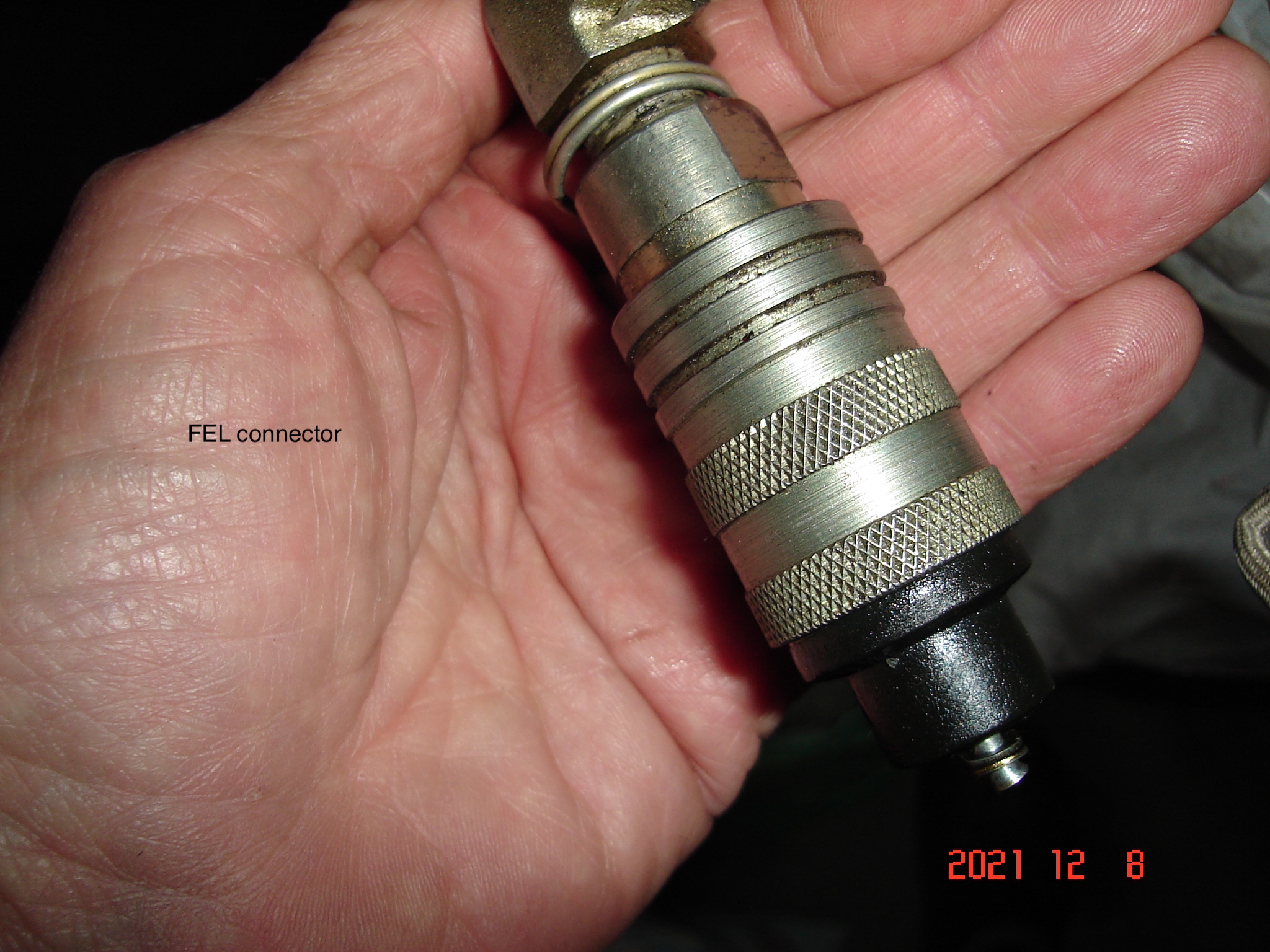

So I just went out to my tractor to confirm above -- I now have the blower attached, and apparently that has slightly different connectors, which do NOT go either up or down to release. My FEL connectors, however, DO release in either direction. Your FEL connectors do look like my FEL connectors.

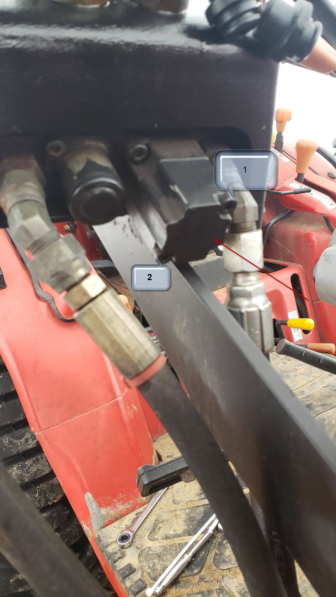

So if I understand the Float valve is behind the control valve. I have to unscrew 1 and 2 and grease the spring?
So you collar mouve up or down on yours. Sound they have sand or rust inside that prevent the collar from mouving.
