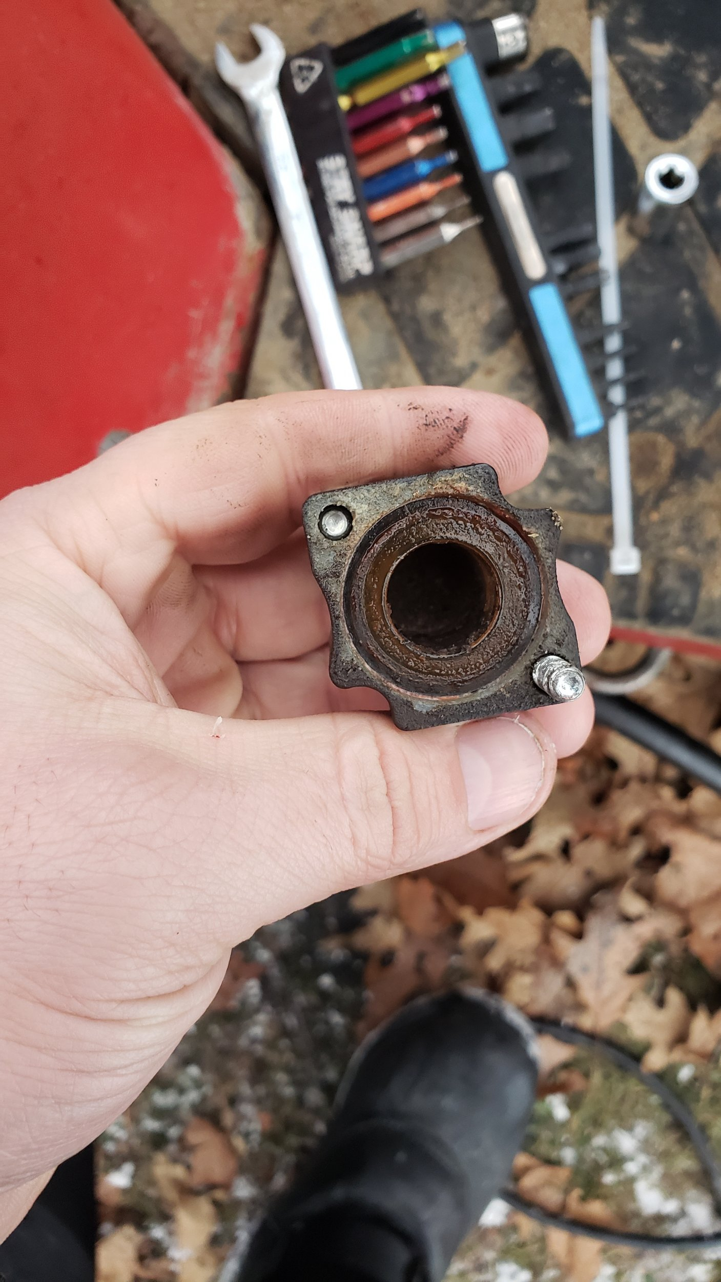

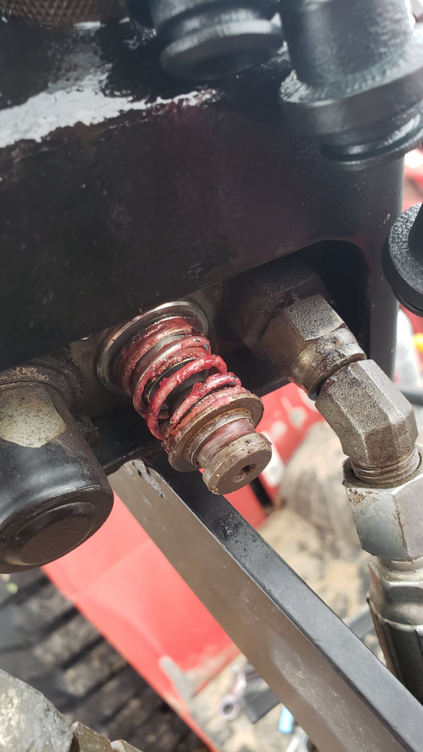

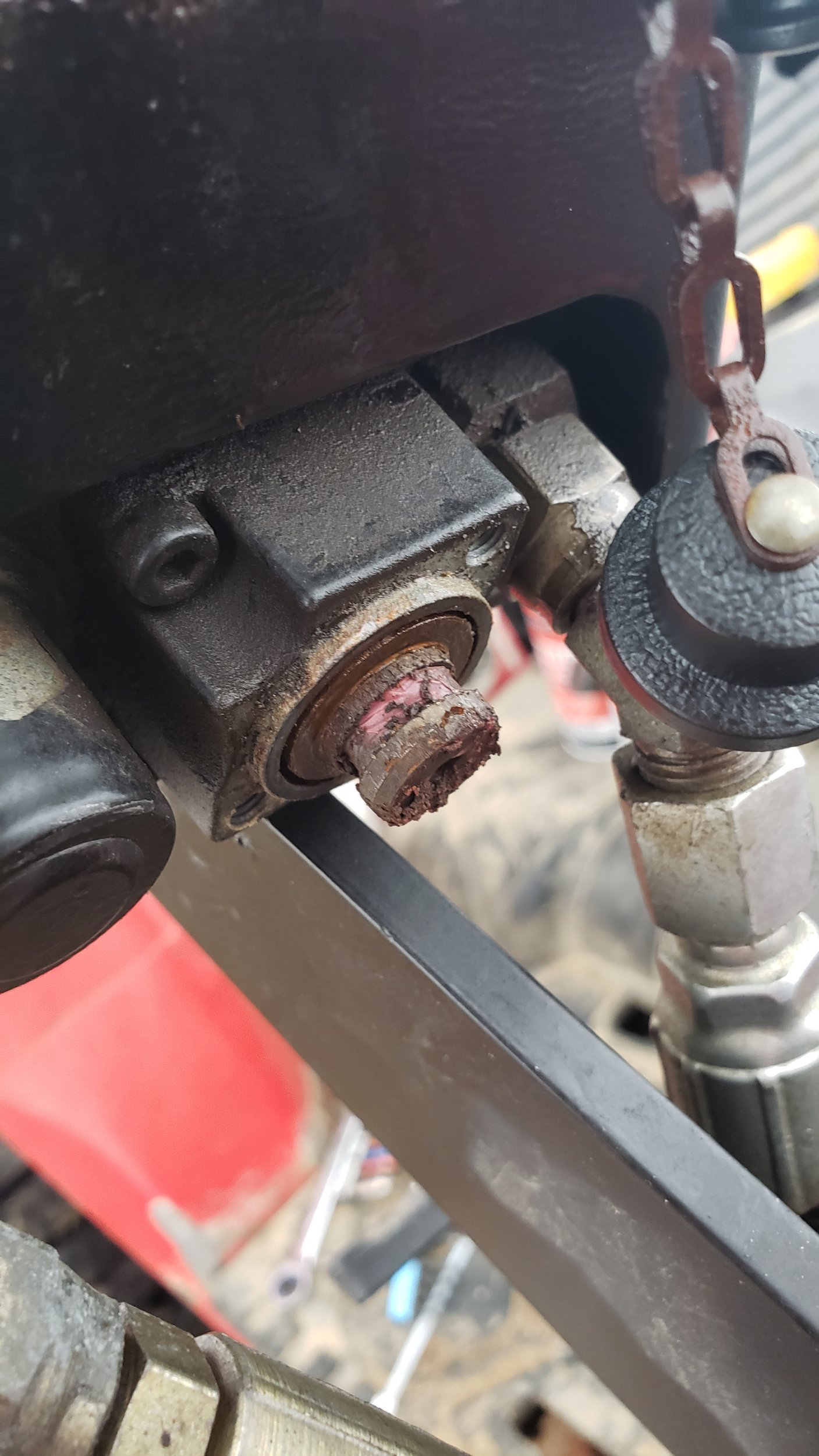

And an observation on his "float" problem. All the spool valves I've seen with a float feature have that mechanism attached to the valve body on the opposite end of the spool from the handle, attached to the body by 4 small screws or bolts. If he can access that area, he should remove that "assembly" from the end of the valve body, take it to a warm workspace and take a look in there. I would recommend a large towel or blanket spread underneath the work area, to collect any springs, balls, loose or broken parts, just in case something has come apart in there. After removing that assembly, (and it, too, could be full of rust or dust or junk so that it doesn't want to come off the end of the spool) there will probably be some sort of grooved or hourglass shaped piece that is bolted to or is screwed directly into the end of spool, so that it moves with the stroke of the spool. The spool will usually rotate in its bore, round and round, easily, so make sure you don't use the valve handle as the other wrench to hold the spool while unscrewing this part from the spool. Usually, you can remove the handle and grab the two flats with an adjustable wrench to hold it. CAUTION: the spool will easily pull out from the body, but reinserting it can be a problem. Many times, an O ring will get a small piece nicked out of it, which can cause a leak in the spool or worse, the rubber piece will move around in the hydraulic system and plug up some small metering oriface or pilot circuit. Make sure the spool stays in its bore, within its usual range of travel.

I have dissemble the valve. it had almost no geese in there. So I have grease it all and jingle the the stick to make it move. no luck it does not go into float... I'll have to dissemble the plastic and the couplers
