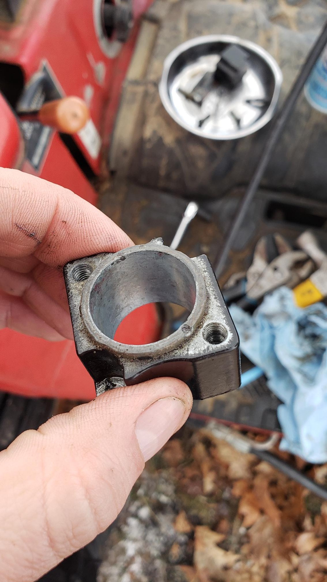

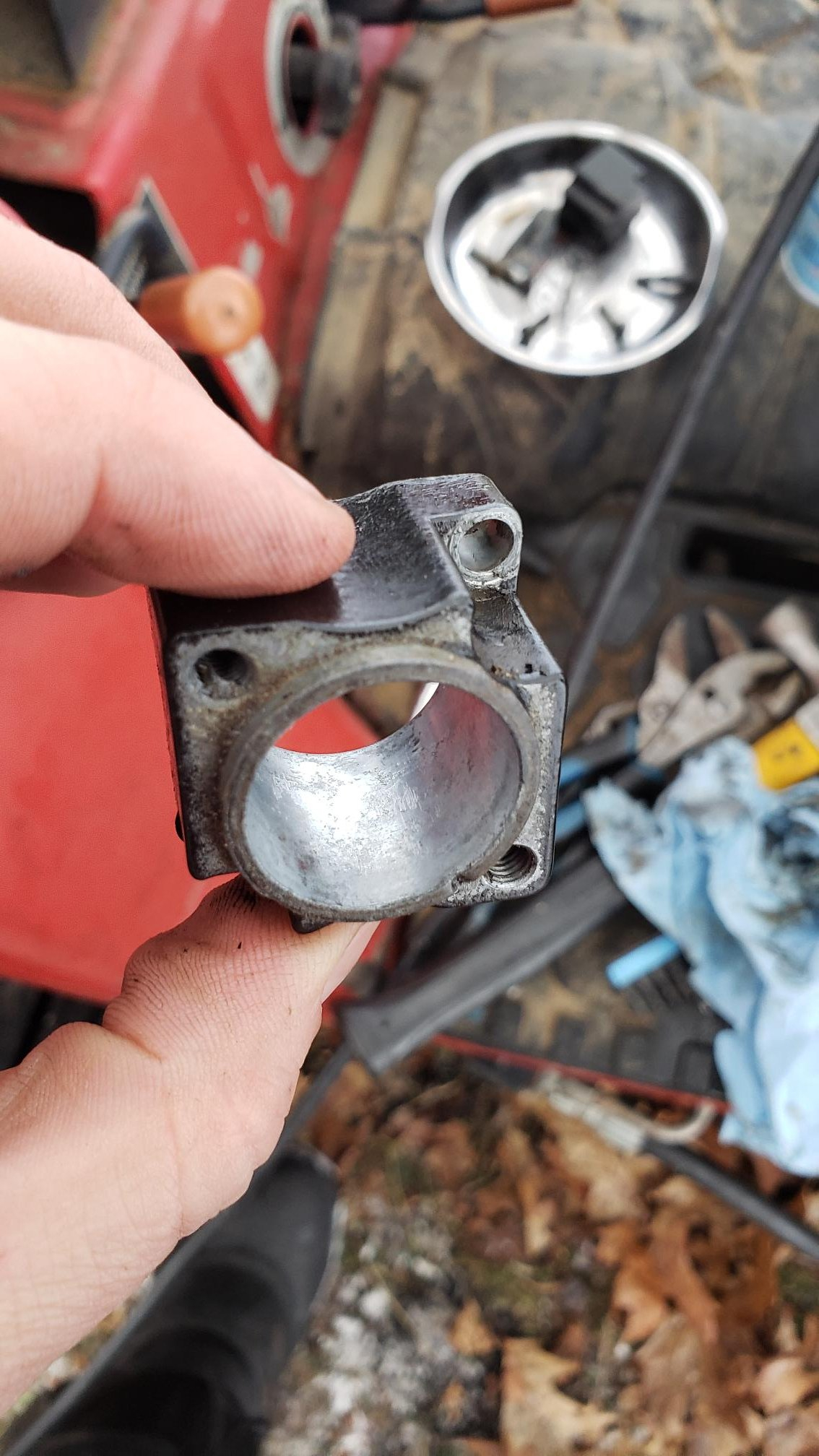

Yeah, you need to clean up all the rust and junk on those parts. Look inside the cap you're holding in picture 144201. Is is pitted or rough? It's possible you'll need a new cap, if that one can't be refurbished.
Look into the bottom of that cap. Is there something in there preventing the spool from entering and traveiling all the way to the bottom?
There is no reason to look further, as all the parts to give you float are there, on the end of the spool or in that cap.

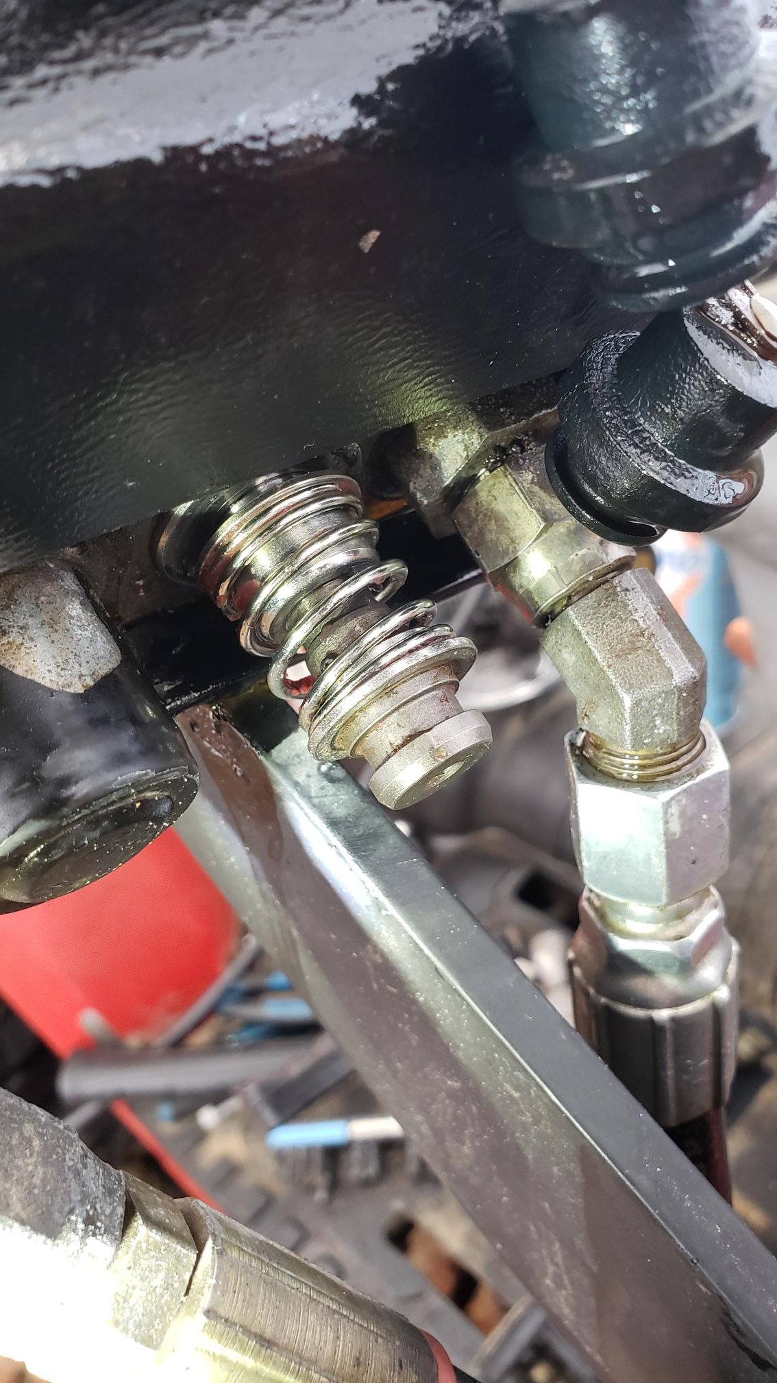

And actually, I don't see any sign of detent balls or other mechanism to hold the valve in float. What I see is just the spring that returns the spool to "hold" (centered) which is described as "spring centered to neutral" in catalogs such as Surplus Center, in their hydraulic valve section. They describe other valves as "with detent on forward stroke and spring centered on the retract stroke" or "detent in both positions"
Is it possible that this spool simply does not have the "float" function?
If it never was designed to have float, it's also possible that the parts to convert it to float might be available in the parts book. Those parts might consist of a different cap and a different end on your spool.
If you're adventurous, you might leave that end cap off, start the tractor and raise the loader up, then lower it, note the position of the spool, then see if the spool will move further yet and would it still allow the loader to continue moving down. That "might" indicate if the valve body and spool are compatible with a "float" function.

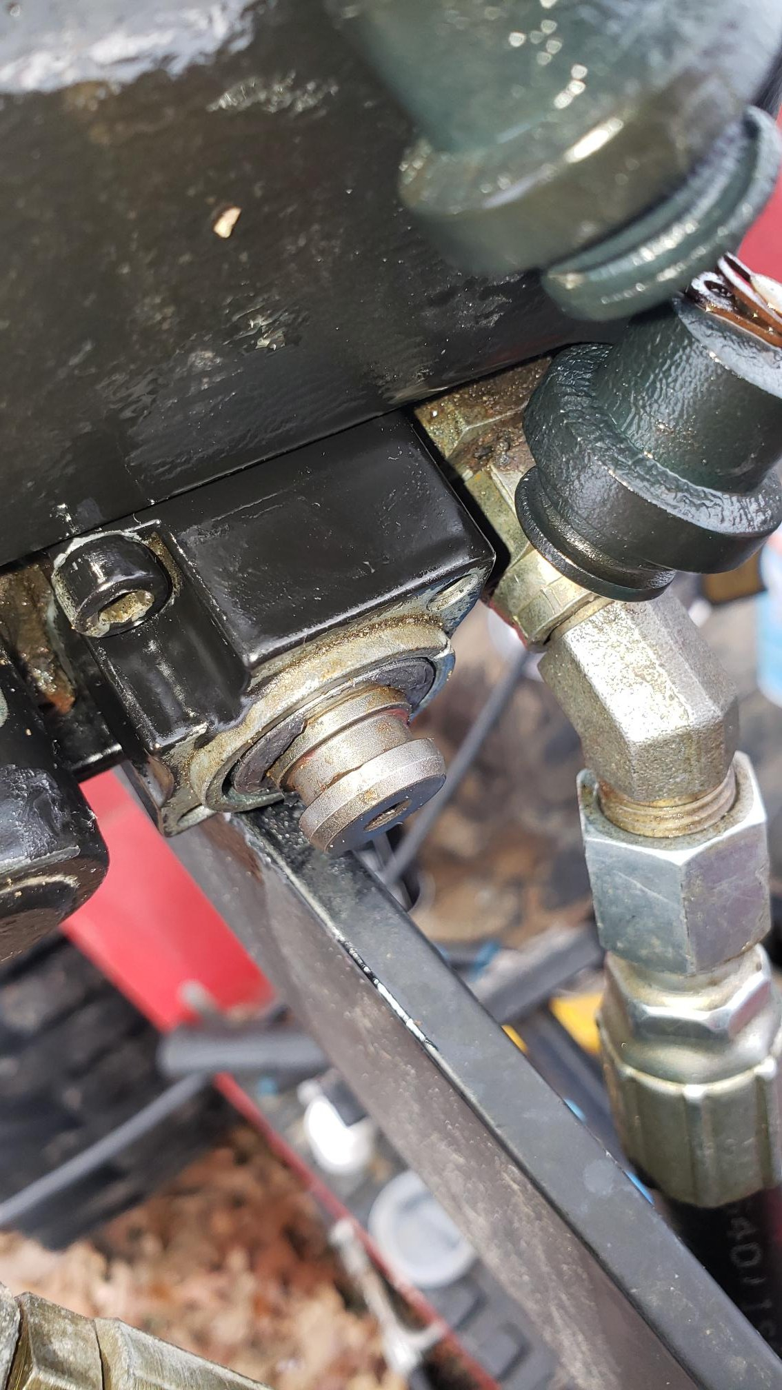

Looking closer at picture 213, I see another short section bolted to the end of the valve body, with 2 Allen head bolts. See if you can find float with the cap off, in picture 201. Then explore that next section in picture 213. Carefully remove it, that could be the float/detent mechanism. You could loosen it, then move the control handle and see what happens. Or replace the 2 Allen head cap screws with longer ones, one at a time, and see what effect that has on spool movement.
   / The loader on my 1528 (FL1520) can't find the float position #52
No, he's got it. In the bottom of that cap he's holding is where the c-clip is (split ring) that's supposed to hold the plunger in the float position -- that groove at the end of the plunger is supposed to pop into that split ring.

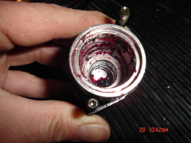

My guess is that with everything as dry as it is, it won't go into the split ring. Unfortunately, he didn't use a flash so we can't see what's in the bottom of that cap. Take a look at my earlier pic (post #36, second pic) of the float detent business. That was taken after I had thoroughly cleaned it out and re-greased it; mine was almost as dry & dirty as his when I started.

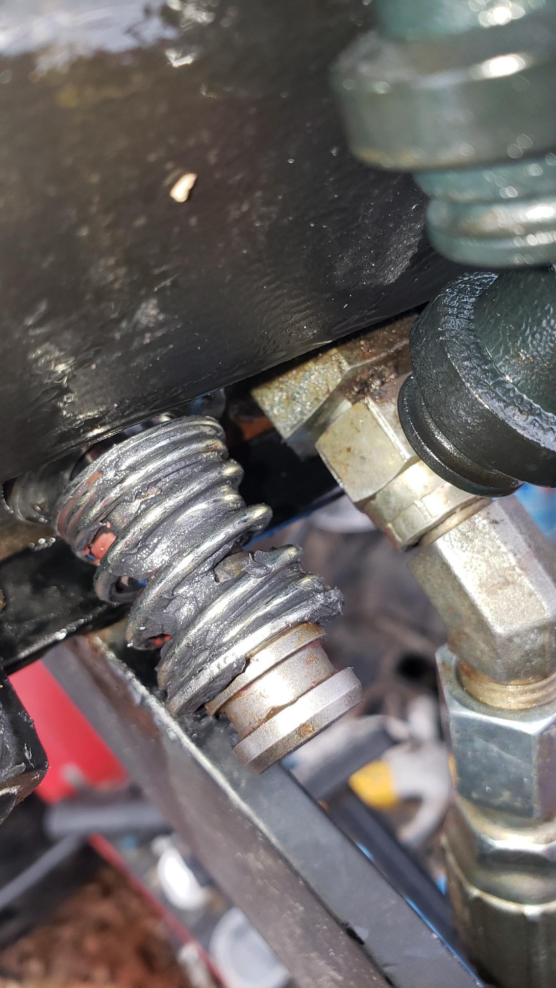

It's also interesting that his plunger is almost flush with the bottom of the valve body, where mine --and I think it was in the neutral position, but not positive about that-- sticks out a fair bit, with the plunger spring clearly visible, in that second pic on page 4. It may also be that his entire plunger is rusted into the valve body there....?

Oops.. my bad! I see in his 3rd pic where the plunger --and its spring-- is sticking out, just like mine. I guess there are two parts to that assembly; inner section removed in 3rd pic but not in 2nd one.

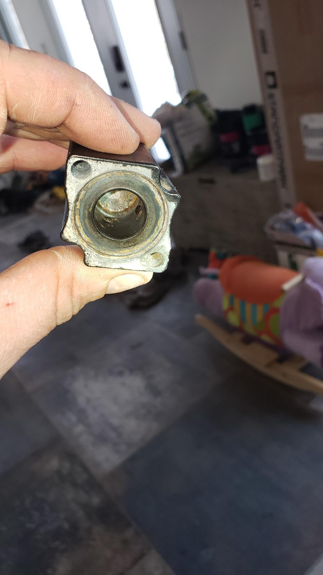

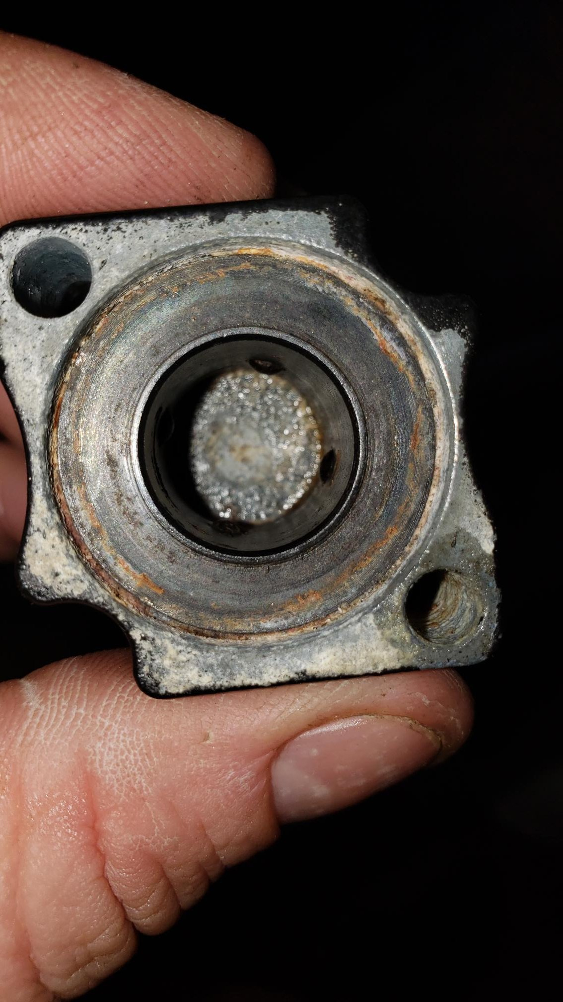

OK so I clean it this time before greasing it. The end cap was full of sand /dust. I can Now see there are 4 ball in there that should be holding the Other piece when it goes into float. I have try with only the spring grease it did not work. when I push the leave forward I can't feel if it's engaging over the small 4 ball. I then tried it with grease. not sure if that piece should be grease or not. well it still does not engage. I feel like when I'm pushing forward it stooped and hang on the ball but at the same time does not feel like it want a go over it.
I have dissemble it again and I'll let the parts sit in oil.
are the 4 ball supposed to be moving?
Example: when the other parts push aigained it the ball should retract to let the parts go faward then when you pull back it should release?
Or the 4 ball are not suppose to moved at all?

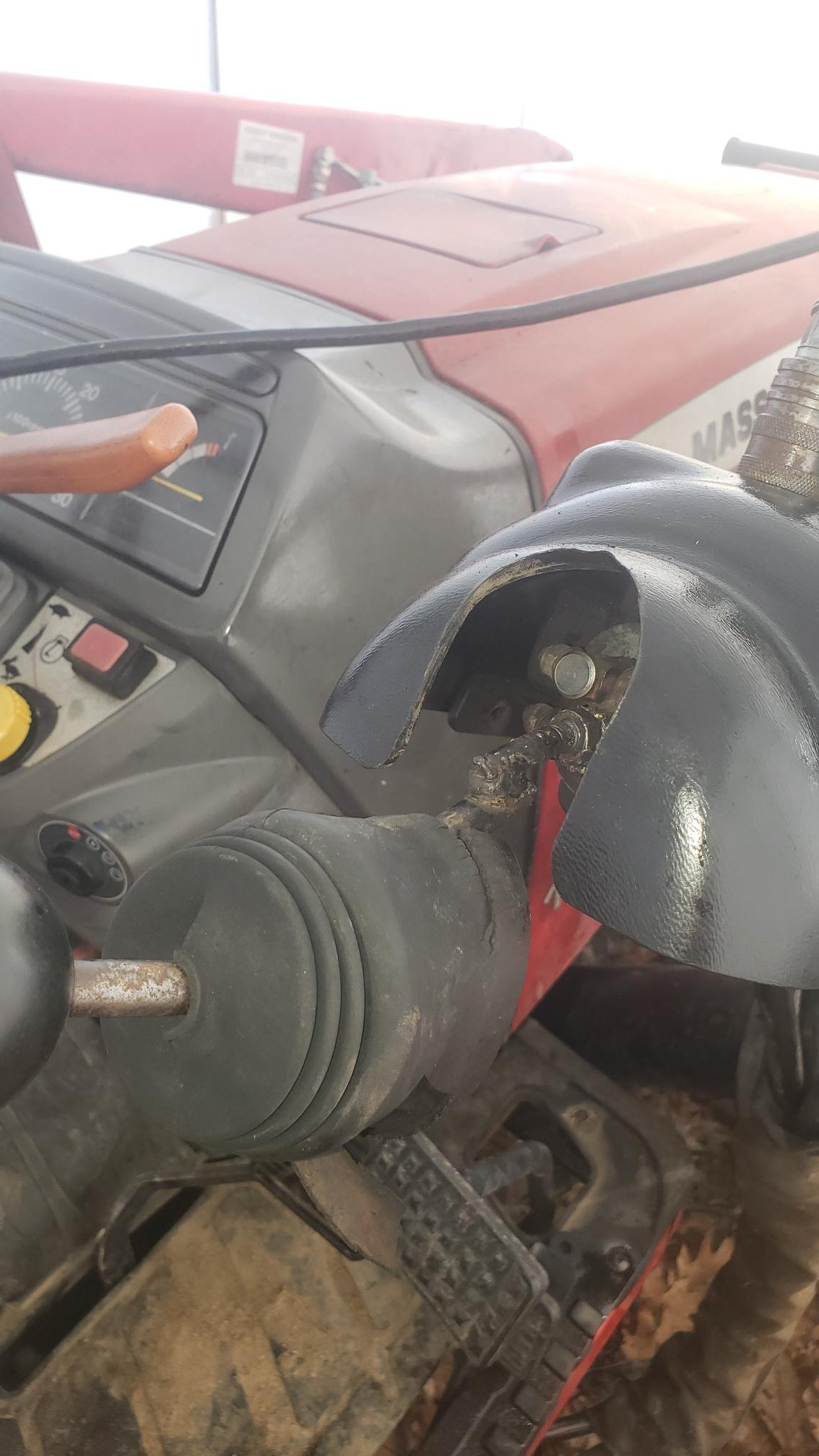

WOW Thanks guys for-the Help I figured it out!!! Dam I love forum....

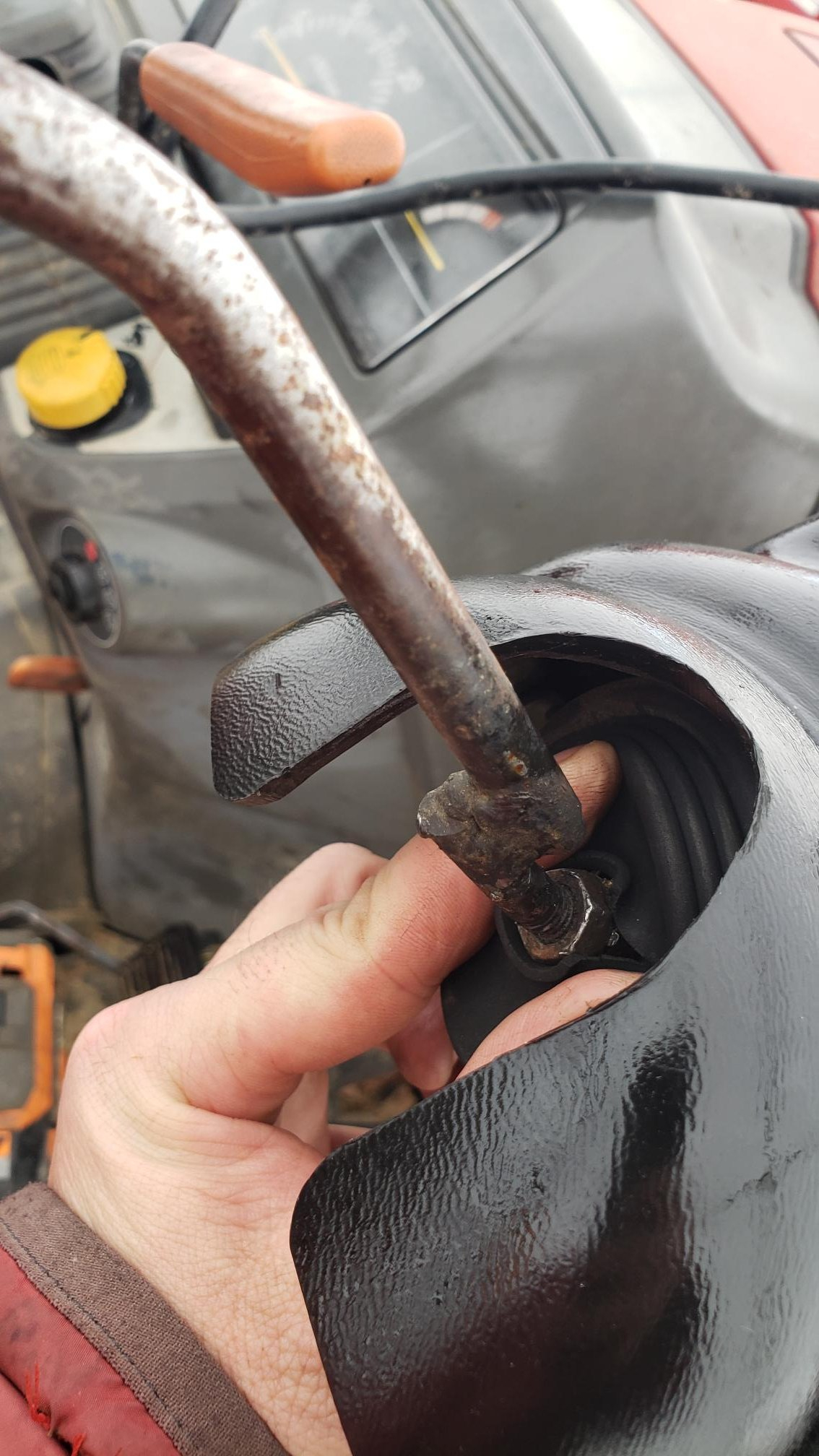

After cleaning the valve. I realized that with the broken/welded Stick it was now touching the plastic. So I unscrews the Lever and I flipped it they other way. now Everything is working as it should! See 125902 before it was like 123600. See video of How it work now:
I'll check with the dealer how much is a rubber boot and a leaver stick. and I'll have to figure a way to fix those Hydrolic Coupler.

Fantastic! I just now looked at your posts (nice job cleaning it up, BTW!) and noticed that your "cap" assembly has FOUR screws to remove it, in TWO sections, correct? Mine has just two long screws and is only one piece -- so yours is, in fact, different than mine.
Same principle, but yours apparently uses the balls, where mine uses that split ring. I bet your set-up works better! Very glad you were able to get it to work -- you're making progress!
And thanks very much for teaching us all a bit more with your pics!
