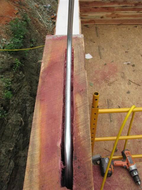

Wood, I am going to use single wire 14 gauge for lights/fans and 12 for outlets...I hope I can squeeze them all in there....no romex in the emt.
I am laying the logs over the windows and doors now. Had to do a little fancy work on the conduit to route it around a stained glass transom that we picked up on sale the other day. It will go over the front door and is 67" long.
I'm wondering if Woodlandfarms is correct in how cozy the wiring might get. Maybe you should do a dry run on running a few wires through the emt to make sure everything fits. You can always get larger emt to make life easier for you. And too this is not a criticism! You are doing a great job and your place will be beautiful when done. Stanley

I had a electrician here today installing my 200 amp service panel in the basement. This will double as my temp service. I had him take a look at the 3 gangs & 1/2" emt. He said, yes it would be tight depending on how may things I want to run. Interior light, celing fan and exterior light should all fit. But, he did point out a silly code that says that all entry doors(I have 4) on the same floor have to all have a common switch to control the same light. Who comes up with these things? This is my house, I am not building it for someone else, so I will never understand how things like this get into the "code". Really, if I want the main floor entry door switch to turn a light on in my dogs house that should be my choice. I have to say if I had the $ I would be installing solar w/a battery bank....not tied to the grid...no fees and inspections.
I am still on a generator and it looks like at least two more weeks before the power company gets two poles set and hangs a transformer. I did have quite the discussion with them over them wanting to cut a 40' swath of trees to run power diagonally across my pasture & up the ridge(1200'). When I pointed out a straight line run from the road(1/2 in distance shorter than their proposal) and asked if they could run an insulated service line requiring only a 10' swath the guy said, "Oh, why yes I guess that would work too" :confused: ......... I should not complain too much all of this including about 100' of underground into the house is only going to cost me $256.
SRS it's too late to change to 3/4 emt, but looking back it would have been a better choice...............{sigh}

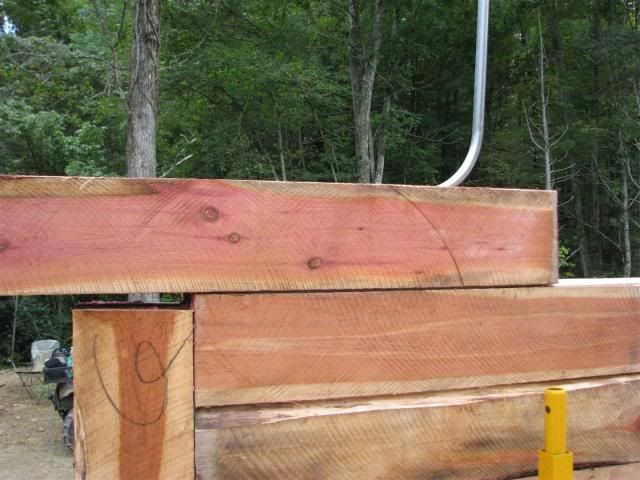

67" long.
How are you going to deal with shrinkage of the logs with your emt?
I did some repairs on a log home that had shrunk and moved about 1/4" per log unless you leave room for that you might have problems.
I used ent for the additions I added .

Tom I cut a over sized hole/channel for the emt. If there is any substantial settling, the logs will be free to move down around the emt.
I have the first course above all the windows and doors up. I was only 1/2" low 4' off one corner of the house, all other walls were within 1/4". For a log house at 8' this is not bad. I have 4 more courses to go to get to 9'3"-5" high and that will be the final hight.

I think you are going to wish you had used larger conduit to your switch boxes. Besides being a bit*ch to pull the NEC addresses conduit fill to prevent mechanical damage to the conductors and to prevent overheating. Hopefully the inspector will not be hard line on it.
