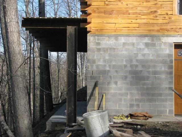

I put the auger on and hauled the 13' I beam up to the house.
Drilled a hole:
Hooked a strap to the beam so it would not slide off the forks & raised it:

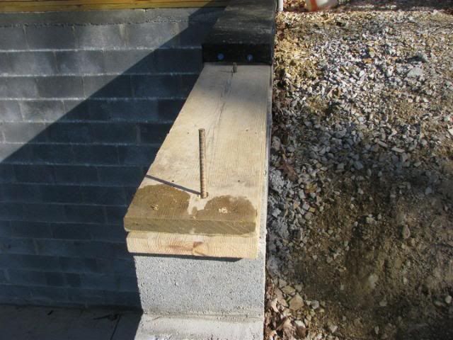

Sackrete:
I need more 'crete , but it will stand until tomorrow:

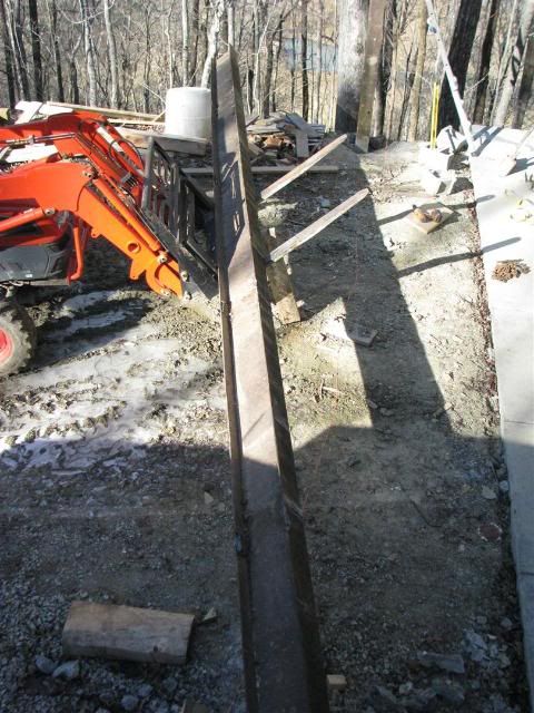

Well the weather broke after a little snow and the ground froze solid(which is a good thing) so I got the 32'x12"x1/4" I-beam up. I know the "Safety Police" are going to go into de-fib, but I used the FEL to lift the entire beam up....hey when working alone sometimes ya gotta do what ya gotta do.
I needed about 3.5" on each end to get the height I needed and decent attachment point:
The Kioti would now lift the entire thing...it wouldn't when it was 44' long"
   / The Log house Project begins........
#710
I needed to roll it and could not do it by hand so I stuck a 4x6 under it and lowered the FEL which turned the beam upright:
