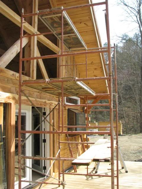

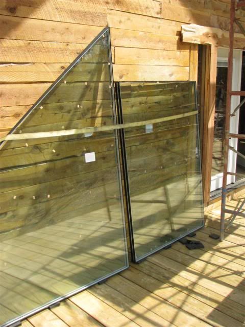

Glass done!!
ready to go up:
Stops in:
3 bucks of scaffold ready:

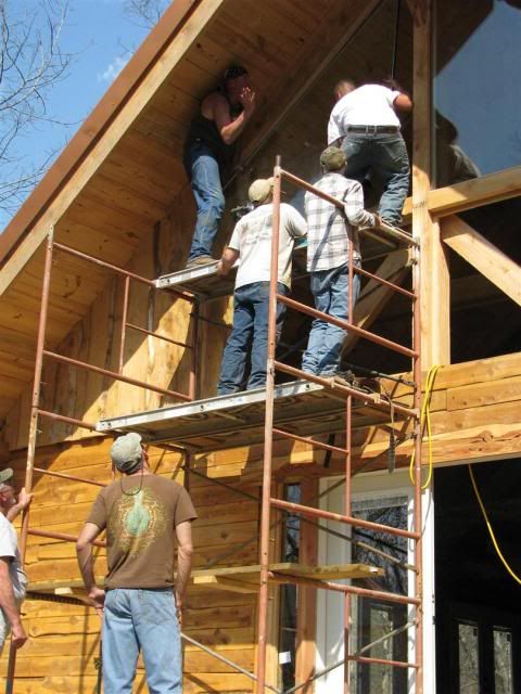

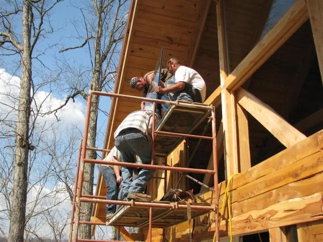

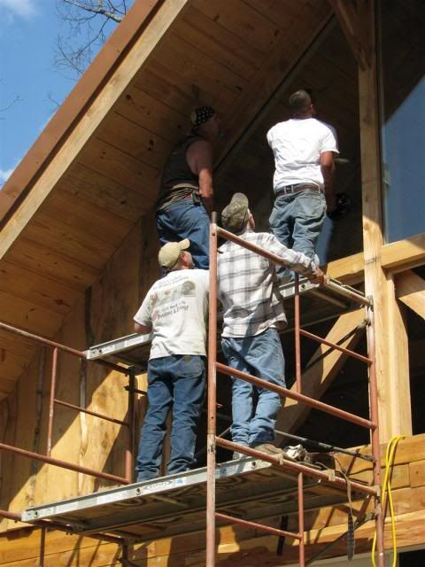

Raising the top glass:
Setting it in place:
The "crew" is focused:
   / The Log house Project begins........
#894
All done:
I put in the top and bottom outside stops, and will go back tomorrow to cut and fit the side stops. It was real tight but all in all it went well. I saved $500 by doing this myself instead of having the glass company do it.............

Thanks and same here GB, I researched and read for years. Seeing what others accomplish helped me decide which parts of my house to tackle myself. Occasionally us doityiourself-ers stumble and make mistakes{me}, but generally even after a mistake you are still ahead of the game from hiring it out. For example: the glass company wanted $600 to install. I hired my neighbors construction crew for two hours - 3 guys @ $15 and hr, so a hundred bucks. I bought two used 8" professional glass suction cups on ebay for $50. If the glass company made a mistake and broke one they would cover it. If I made a mistake and broke one(they averaged $400 a panel), I could buy another one and still be close to the same "installed" price. So to me the risk was worth the gamble. Plus, I keep learning things as I go and that makes it interesting.
