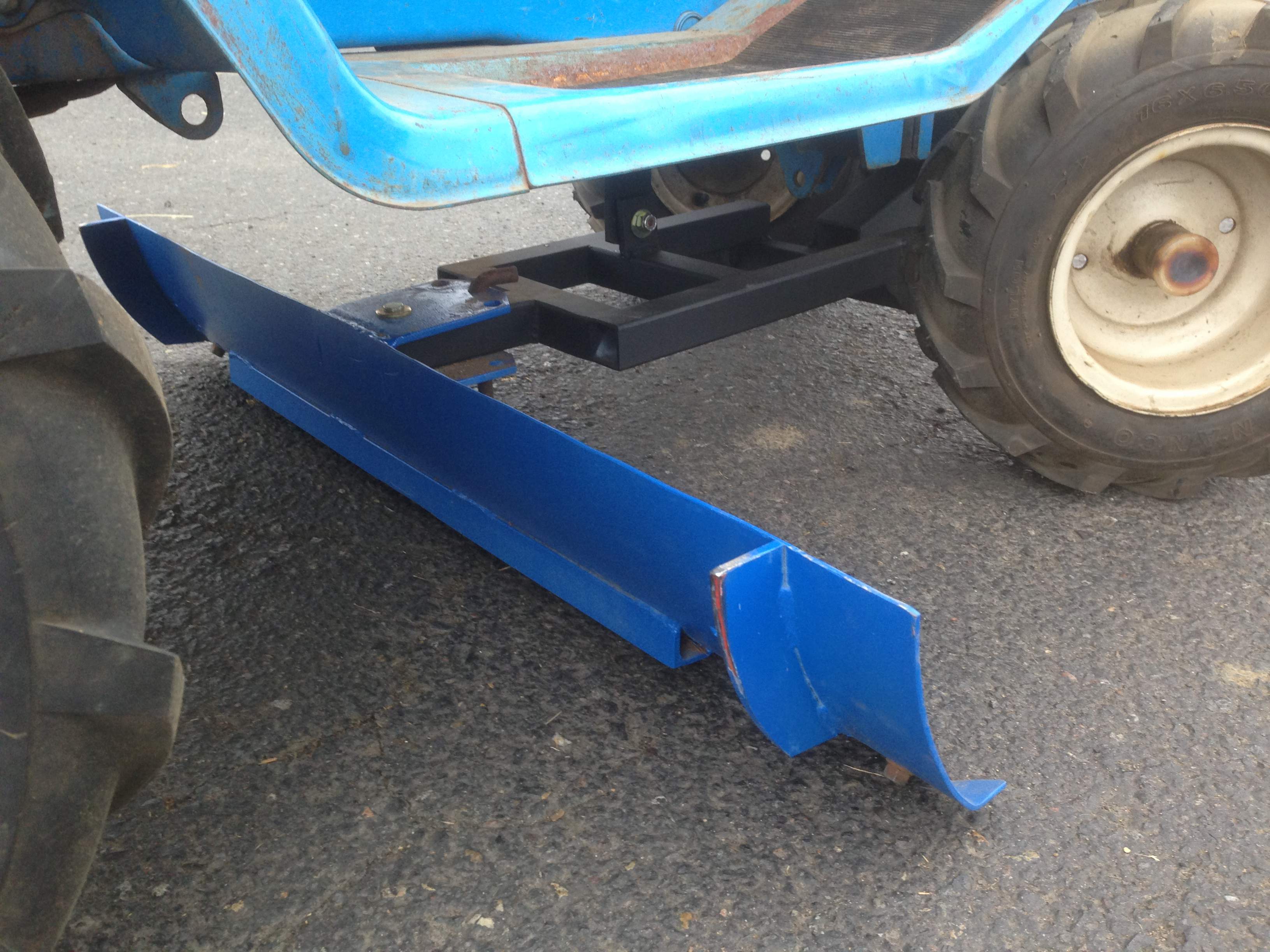

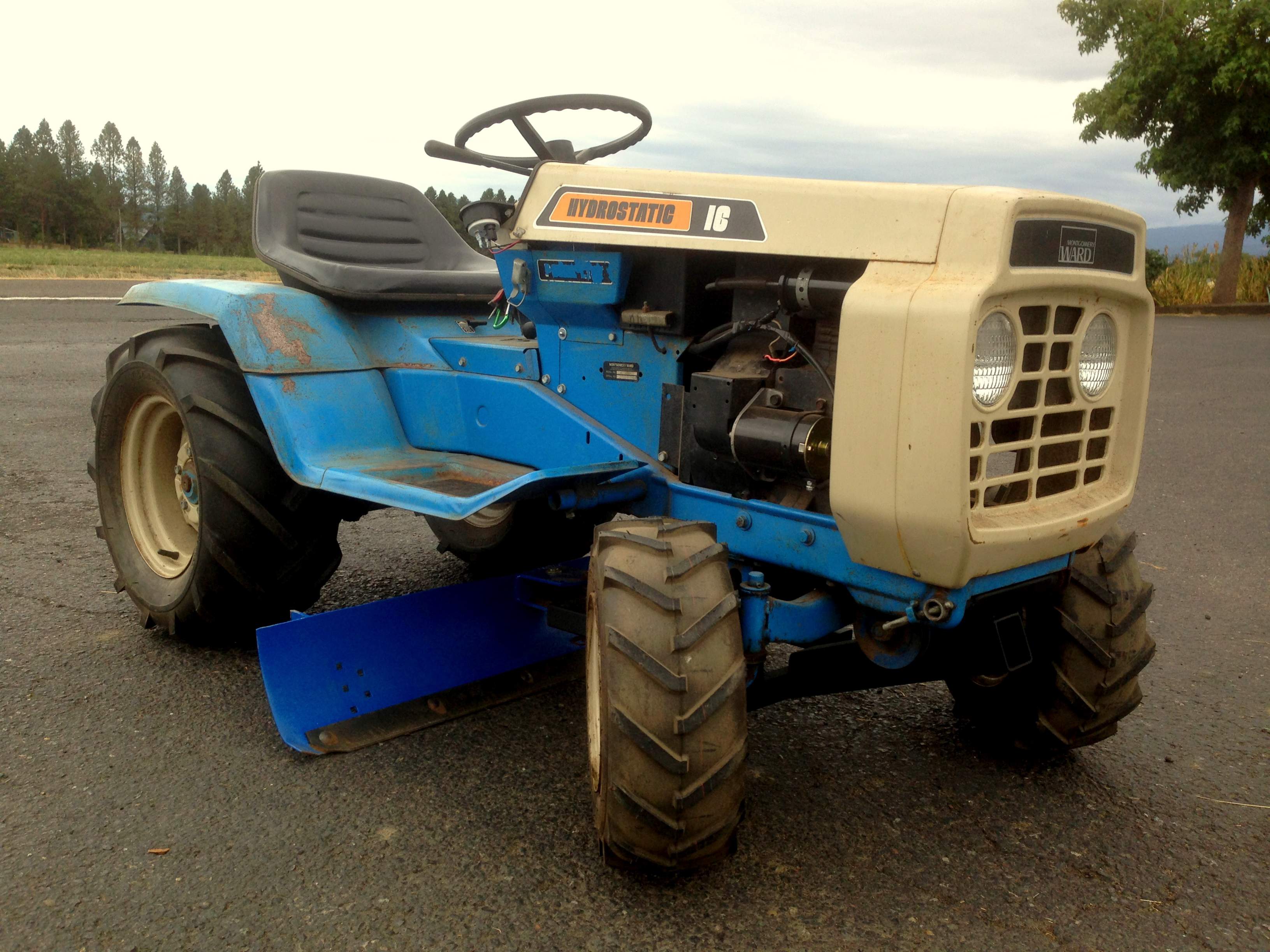

Thanks Jinman!
I picked up a set of new R1's for the front Saturday afternoon, i'm really liking the look them. I also built a 42" belly mount blade made from an old Simplicity front mount blade that I cut down to size. My new blade also has hydraulic down pressure which is really gonna come in handy for the hard packed gravel driveway. I still have a few more mods to do before I put it to work but it is really coming along well so far. :thumbsup:
