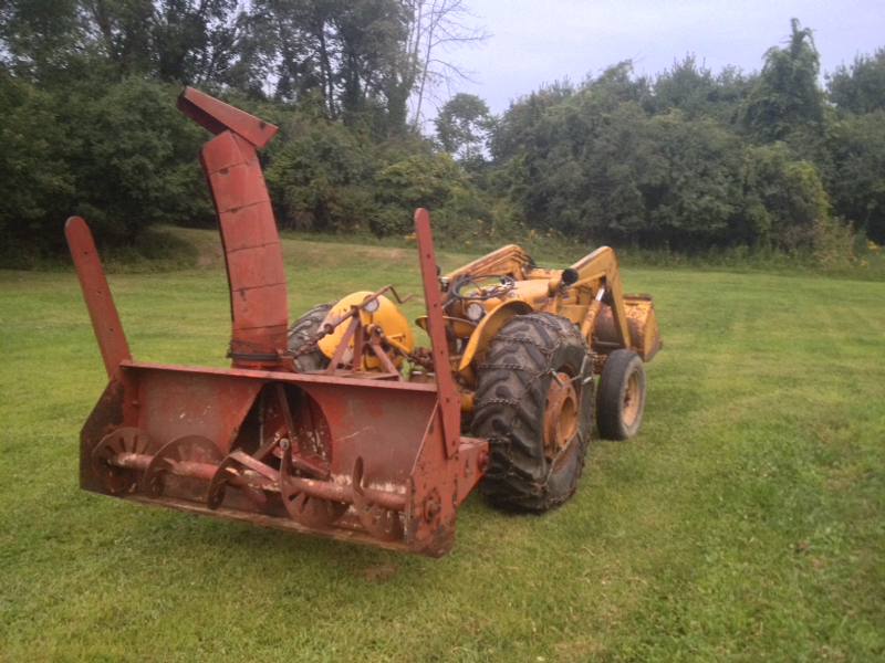

It's only late August, but I got caught off guard by winter last year (well, the last storm we got). Got a new to me blower, all serviced and ready to rock!

Shaeff- That's a serious snow thrower you have there ! The principal of removing the snow before you try to drive through it is a key !
I had the chance to buy a similar rear mounted snow thrower ( but perhaps a bit smaller) at an auction many years ago, before I found out how the snow tends to collect in my below grade 400 ft. long driveway !

It sure is! I've got my machine all ready for winter, blower serviced, chains checked and snugged. I'd rather not have to use it at all, but if we get any drifts, this thing should take care of them! I'll post back some pictures this winter after giving it a shakedown run!
I'm actually looking forward to trying it out, odd as that may seem.
I did pretty well with a rear mounted snow plow last winter, but when we got a foot of heavy wet stuff, I really wished I had a ballast box (or my flail mounted) for extra traction and a front mounted snow plow!
I also have an Economy Power King with ice chains and a 4' wide blower for the lighter storms. Hoping to get that one ready to rock before this winter, too! Just got it from my father.
