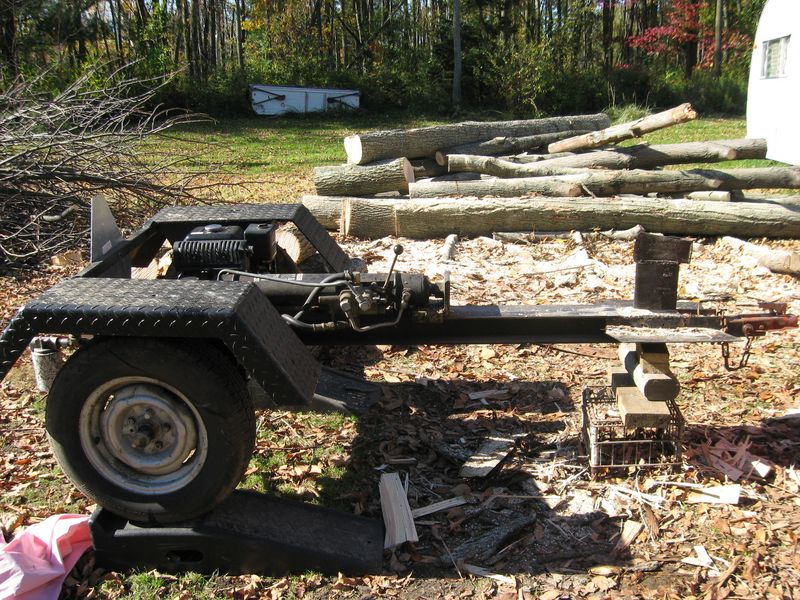

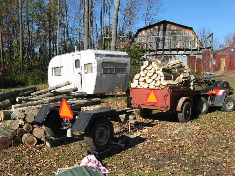

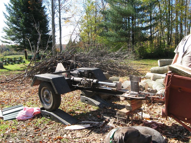

I see some of you guys added pictures of your setup so I decided I wold post mine.
It is an old agway model that use to have small wheel barrow tires and a 2 gallon hydraulic tank that wasn't big enough.
About 8 years ago we but a new axle under it and put the larger tires on it so that it would be more road worthy and stood up higher so you didnt have to be constantly bent over to use it.
I built the fenders out of a sheet of dimond plate and I think they turned out nice. We strap the saws and gas cans on them when out in the woods and also use them to hold chuncks of wood while you are splitting them.
Also welded another ax head on top of the original to help with larger blocks of wood. Eventually I would like to put a 4-way splitting head on it.
Last year we finally broke down and bought a new motor for it as the old one just was to worn out. While we where at it we added alot larger oil tank and filter setup on it. This keeps the oil cooler and plus we have more so we can use the ram to the full extent.
Added the wings on each side to hold the wood when working by yourself. Works but they need to be redesigned.
This winter I plan on extending the pole out father so I can turn easier when towing and redesign the wings. Might even put the hydraulic lift on it if have the money to help lift the larger blocks.
In the pics I used some car ramps to raise it off the ground even more because the little big of bending over was killing my back.:(

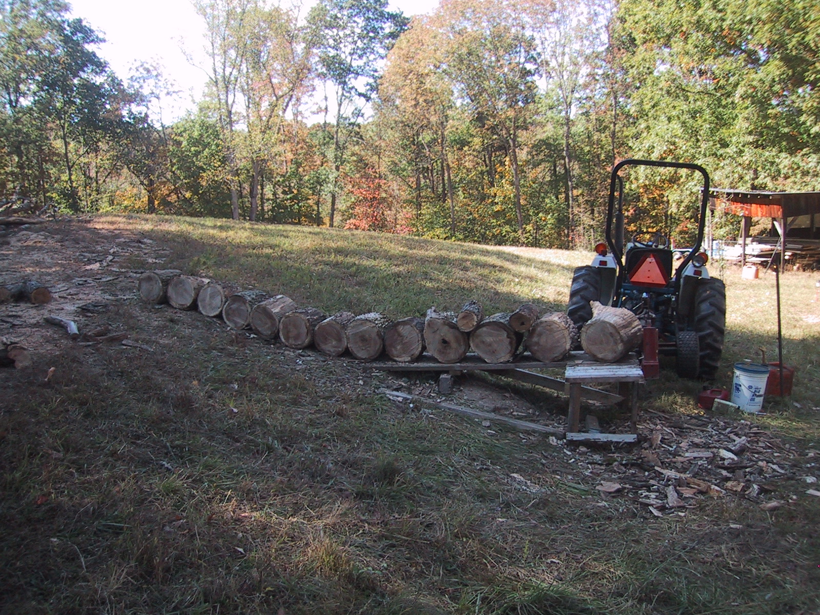

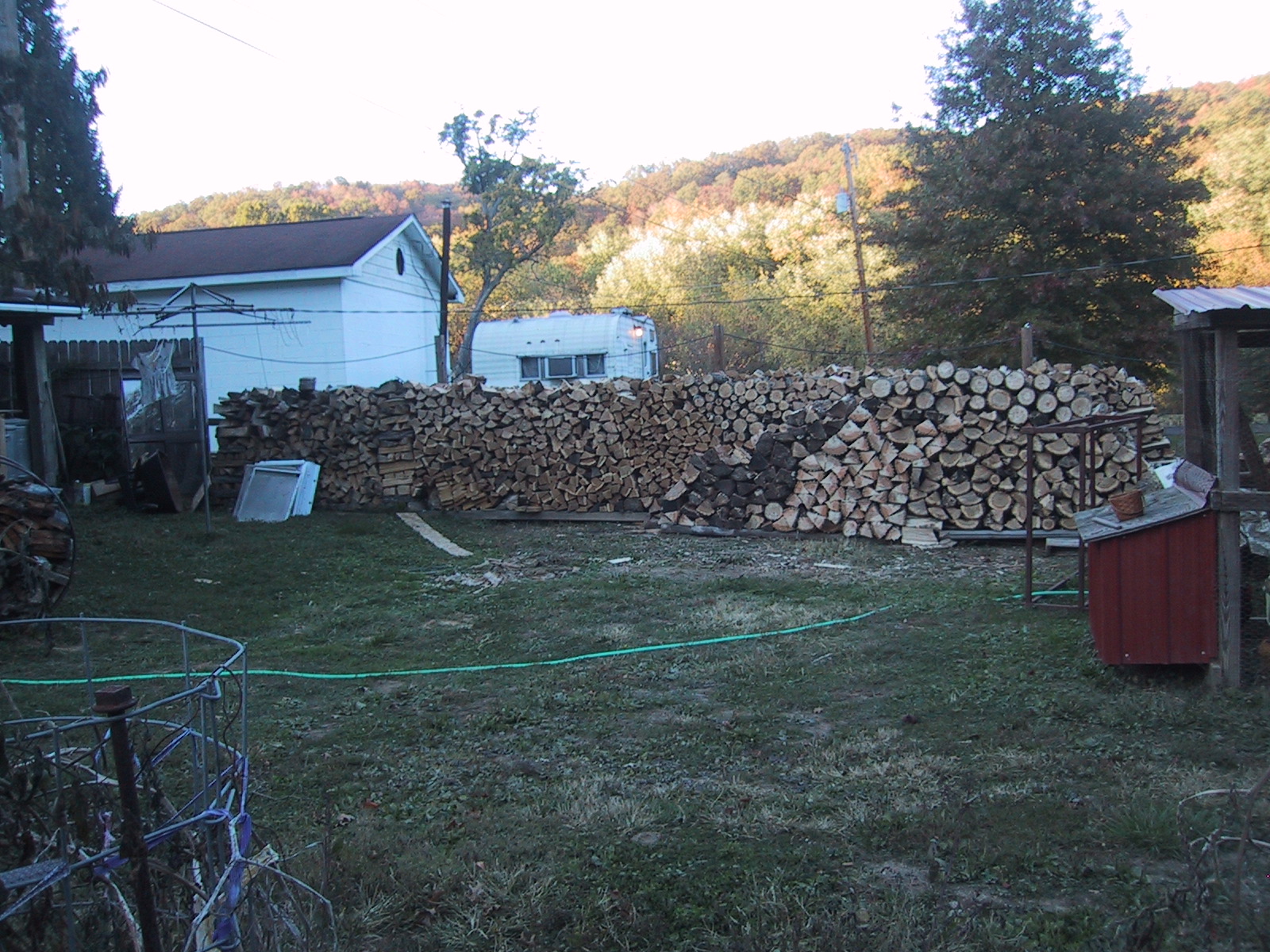

You don't need all that fancy junk . Here is my set up . I build a ramp down hill from where I cut up logs and roll to ramp, back truck up to spliter and load on truck when split . saves picking up off ground both to put on spliter & truck . I just split 32 loads the last two weeks that way. With little or no help . Last picture is part of wood I split.
