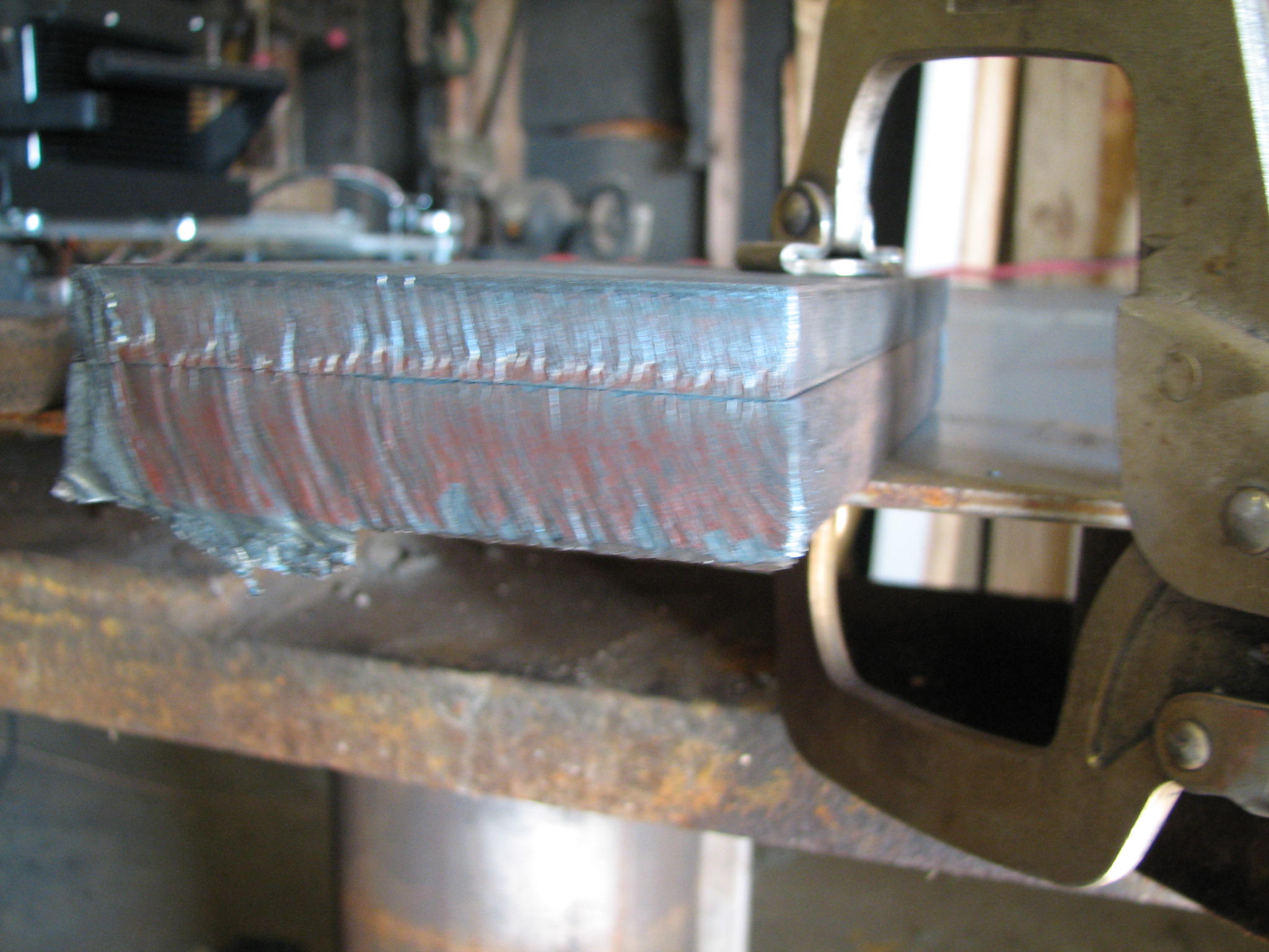

Hypertherm ships same day to distributors....so if they do not have it in stock and you call before 3PM, they will have the parts next day. Attached is severance shot with a Powermax45 cutting 1-1/4" thick steel (1/2" and 3/4" stacked) I have severed 1-5/8" with it....pretty slow, but the Power supply has the capability to produce some high arc voltage. Not bad for 45 amps.
Torch technology plays a big part of the cut process. Some manufcaturers like to stay with their 10 year old torch technology (less research and development investment!) Hypertherm chooses to continuously improve theirs. If you are ever in the Hanover NH area, give me a call....I'd be happy to tour you through Hypertherm's plants (all 8 of them) to show you why our plasma systems are different.
Some specification comparisons:
T-D Cutmaster 52....43 lbs, duty cycle 40% @60 amps, rated Kw 6.2 @103 volts
Hypertherm Powermax45...37lbs (with torch), duty cycle 50% @ 45 amps, rated kW 6.0 @ 132 volts.
So, similar kW output, Hypertherm has higher output voltage rating (longer arc promotes better drop cuts), Hypertherm is a little lighter. Check out the pic for a 1-1/4" drop cut.

Stacking Steel...Does it make any difference? What I'm getting at is if I had 2 3/8" plates I wanted to make exactly the same, does it act like a 3/4" piece of steel or does the tiny air-gap inbetween make a difference?

Stacking is a little tougher....better if stacked tightly...note the clamp!
