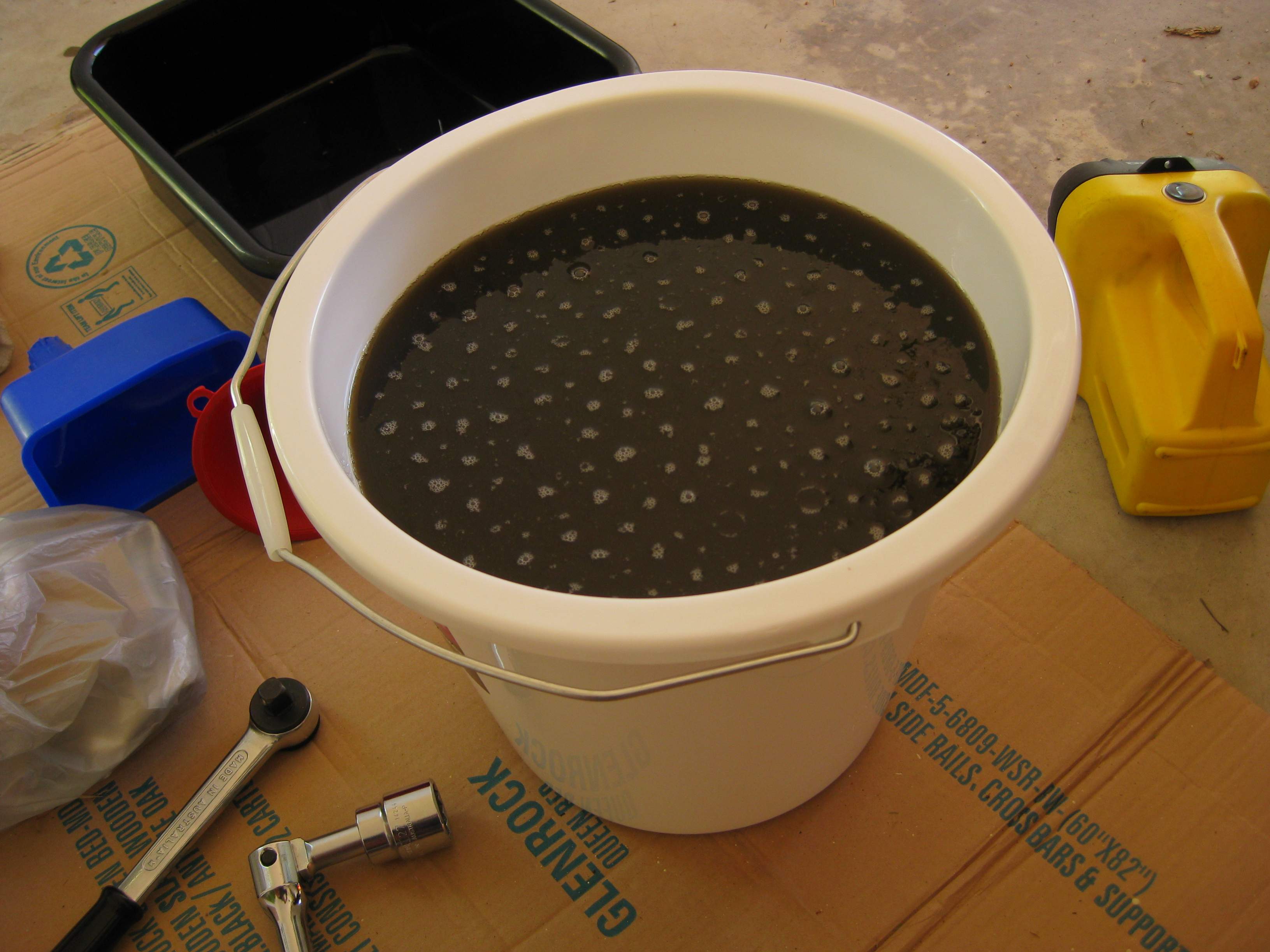

My BX2360 , like all Kubota products imported to Australia , arrived "dry".
Why , I really don't understand , but that's how it is.
This was manufactured in January , arrived at the Dealer in June ( when
it was PD'ed ) and I bought it this month . Had 1 hour on the clock , and
now has 3 hours ..........
Now , SUDT is NOT imported by Kubota Australia ( only UDT ) , so my
transmission-fill is not the 10w/20 SUDT , but a 20w Fuchs UTTO ( these
Dealers use whatever's cheap ! ). I wasn't happy about this situation , so
after some considerable research I bought John Deere 10w/30 Hy-Gard
low viscosity yesterday. I changed out the 11.something liters of oil
and replaced it with the more suitable product . Just look at the state
of this 3 hour oil . It was very black for trans oil . I've seen this symptom
before in dry-shipped small engines to Oz , but vehicle trans & diffs are
factory-filled . I'm SO glad to have acted immediately ! 5 months oxidation.
Today I'm changing the engine oil and the front axle too ( 20w to EP80ish ).

OrangeRidge...
You have the CLEANEST tools and drain pans I have ever seen around a tractor...
and that stuff in the drain pail is nasty looking... But it would sure show up on a sight glass... I use UDT but it is almost water clear with a slight honey color... KennyV

All the plastic-wear is new and I got it just for this job :laughing:
That 27mm 1/2" socket had never been used ; big drain plug ;)
The JD low visc is a slight honey/orange colour too , so you can
imagine the shock when I saw the state of this bucket full !
