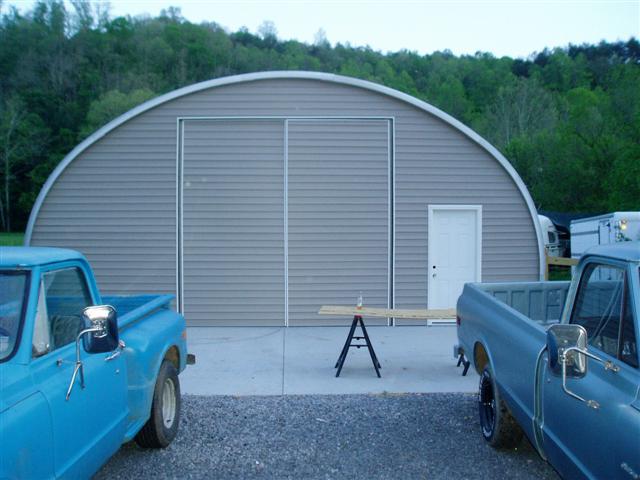

Outside is Done!.....now working on the interior walls for the apt......

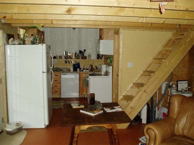

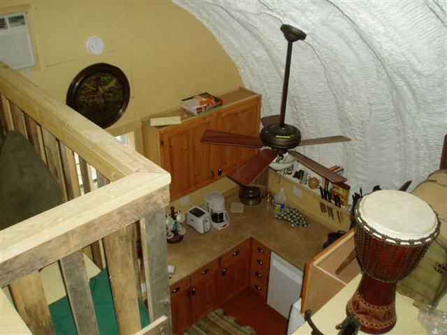

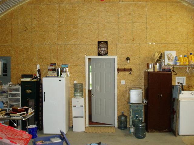

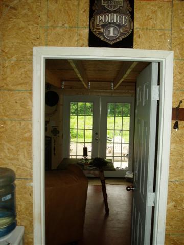

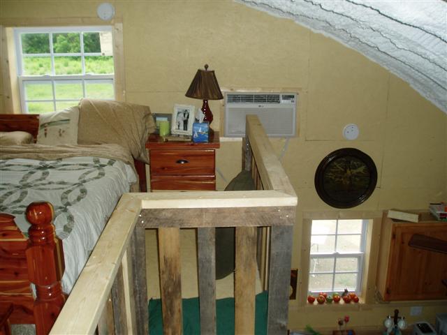

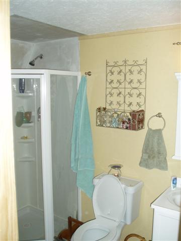

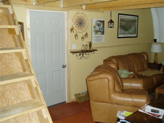

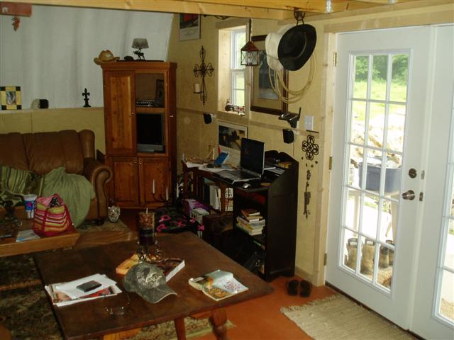

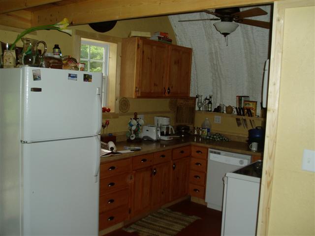

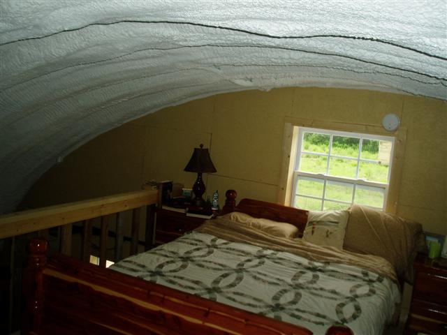

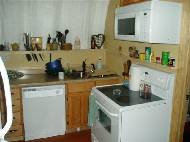

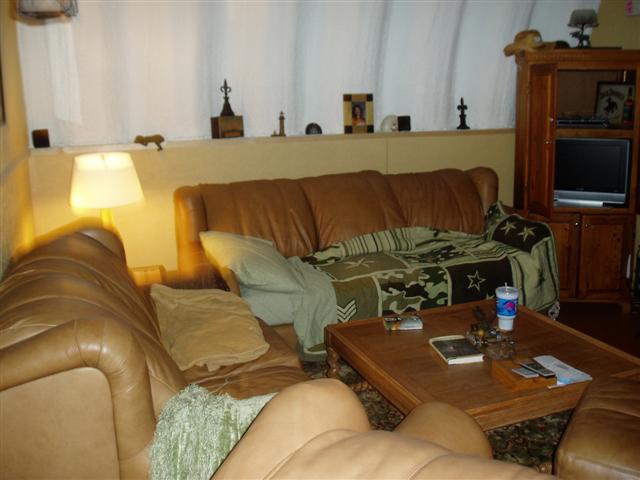

Got it done....well almost & close enough!
   / The truth about Arched Steel Buildings... #45
Looks good. Have you put a heating source in? If so, what type?

   / The truth about Arched Steel Buildings... #47

   / The truth about Arched Steel Buildings... #49
MotorSeven
I see you used some form of sprayed insulation. What is it? Did you do it yourself?
#50
Dog,I think we are going to wedge an electric fire place in there someplace. Originally i wanted a wood stove, but we decided against it. The space is so small, it would be hard to regulate the temp with wood.
Erik,Yep, similar to a Granberg. Try woodbug.com (no www.) They seem to be outa business but the web site is still there to give you an idea.
Lev, i wish i had gone 2' taller, the loft is a little low for me @ 6'4". I have seen a few on footers & it looks fine.
Psj, i was gonna do it myself, but a local guy did it for the same price($1,200). It's about 2 inches thick & is rated around an R-17. The difference it made was amazing. I wish i could afford to do the shop side, but that will have to wait.
