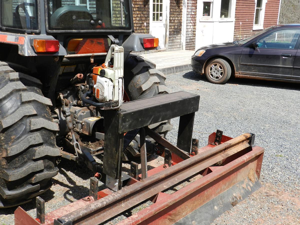

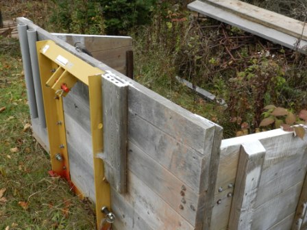

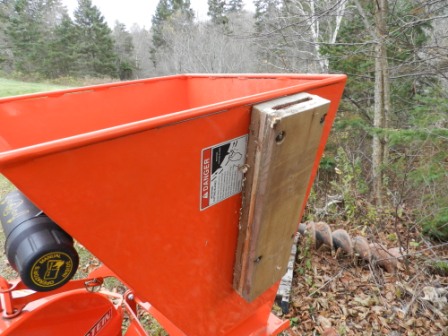

By some miracle, I managed to remember to take pictures of my chainsaw scabbards. Here is the one on the chipper chute:
And here is the one on my carryall:
I also have one mounted on my box blade:
They are easy to make and attach and work very well.
