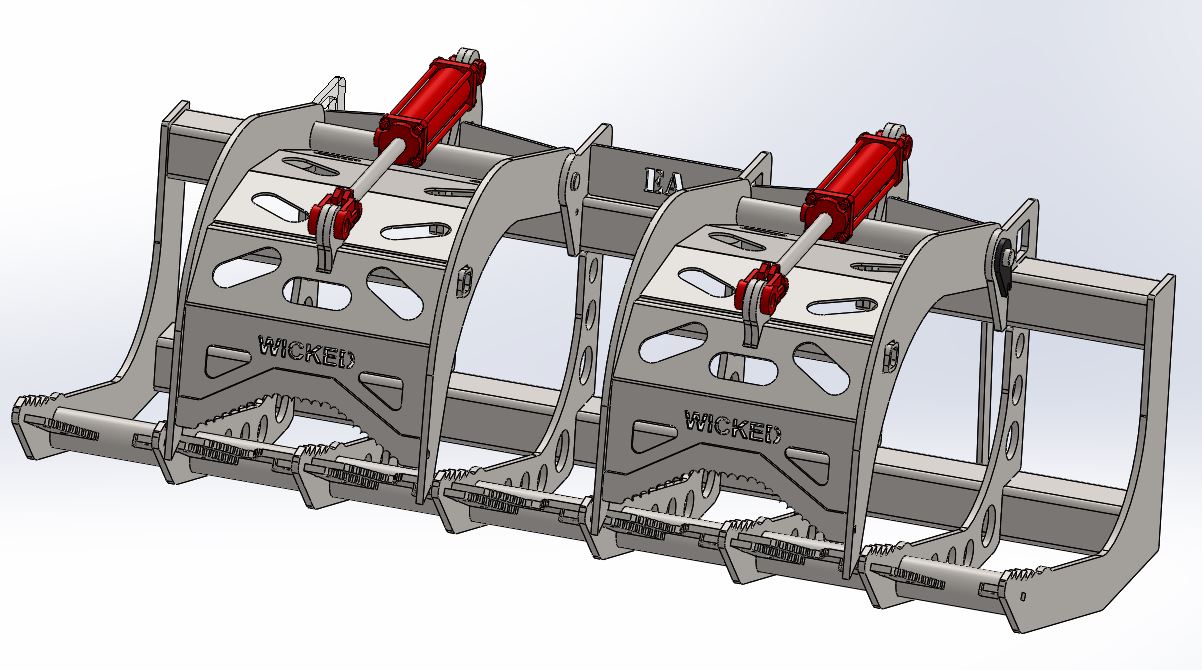

Here's the newest image, now dressed with the sheet metal.
   / The WICKED GRAPPLE for UTILITY TRACTORS!!!!!!! #15
And by sheet metal you mean plate steel? Least 3/16"???? Sheet metal is measured in gauges, thin stuff.

It's just a heavier duty grapple than the original. Still a flat bottomed grapple that has a limited opening that gets smaller the more you tip it forward. Ok if your brush piles are less than 3' high. It's still handicapped for handling logs and carrying them close to the pins or stacking them at a landing or on a trailer. Logs roll around way too much and are much harder to pick up with that design. It wouldn't make a very good root rake for that matter either and looks like many of the larger flat bottomed grapples already on the market.
I do like the red hydraulic cylinders though!
A heavy grapple on a utility tractor is a completely different animal than a narrow/light grapple on a SCUT or CUT. I can dig more by mistake with my setup now than I could on purpose with my CUT. With my 70" opening and 84" width I can tackle 5' plus high windrows of brush without having stuff spill over the top or get caught under the tractor. (WR Long RBG2 grapple)
The problem on here is the highly vocal people who have owned and operated exactly one narrow flat bottomed grapple on one SCUT or CUT tractor and don't know any better.
It's true ANY grapple is better than nothing and you probably sell 10-1 flat bottomed narrow grapples versus the others, especially for SCUTS and CUTS. My contention is that is not the most efficient design, doubley so for a larger utility tractor.
You DO sell the WR Long line of Grapples, why don't you put one on your new big tractor and learn this for yourself?

This wasn't directed at trying to find other members who have used different style grapples on different size tractors. Most people won't have that luxury. It was directed at you as a manufacturer/dealer who should know what works best versus selling on what you believe to be a "consensus".
My point is this: Don't take my word for it, fire up your own big tractor and have at it. (When you actually make one of your new grapples of course.) Instead of theory, conjecture or in spite of what you read on the Internet make a good honest decision on what actually works best.
Understand that those large jaws you're touting will let a pretty sizable log flop around in there. Pick up a log and load them on a trailer with each style and let us know what you think and if you had to do a bunch of them which would be faster? See which one carries more brush more effectively and clears out roots and vines better and quicker and report back, will you please?
I would be real interested to look at the "chatter" after those exercises were completed.
