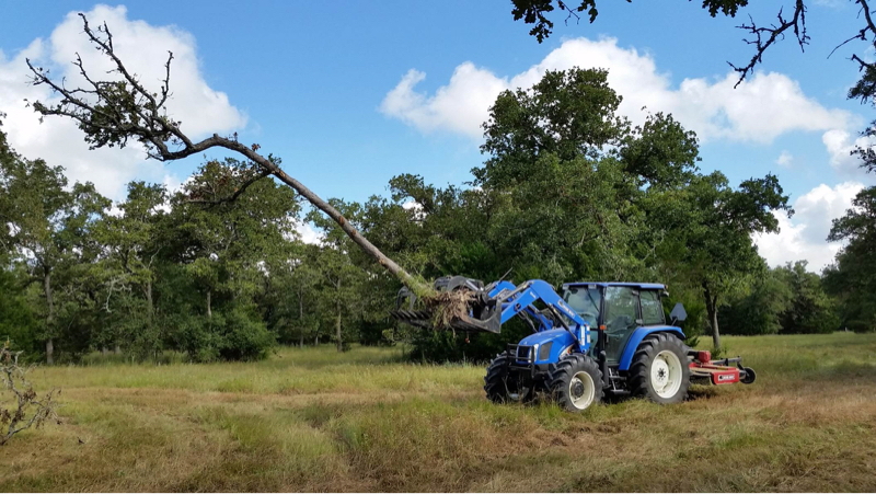

Brett, unless you're looking at maximum payload of lighter material, the original wicked grapple in 72" size can take what your tractor is likely to dish out all day. The new version 2 version with the 37" opening is a definite improvement over the original's 30" opening, like I have.
An issue to consider is that with longer lower tines on the forthcoming larger utility grapple, you have less leverage for prying stuff up and out with your loader (a thing I do constantly), but you can physically carry more material in the larger utility grapple's longer tines and larger jaws.
Travis, Ted: I offered this suggestion in the original wicked root grapple thread as well, but I suggest not putting teeth on the tine support brackets because they will allow twiggy brush more places to hang onto the grapple when dumping material. I don't see the need for those particular teeth since those teeth will not be able to "saw" against any material and are not in the direct clamping portion for nabbing something like in my photo below and pinching it between the top lid teeth and the lower teeth cut into the top of each tine.
I agree. I wish my stump grapple didn't have those serrated "teeth" on the side plates. I suppose they serve a purpose on the stump grapple, but I find they impede dumping all the material sometimes, especially when I'm dumping into a tall pile and can't completely dump the grapple straight down.

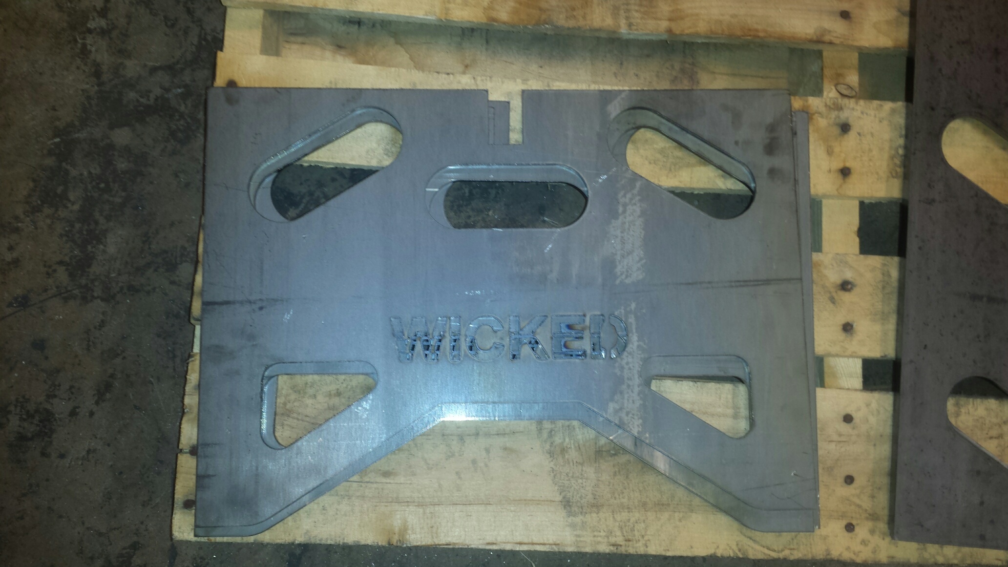

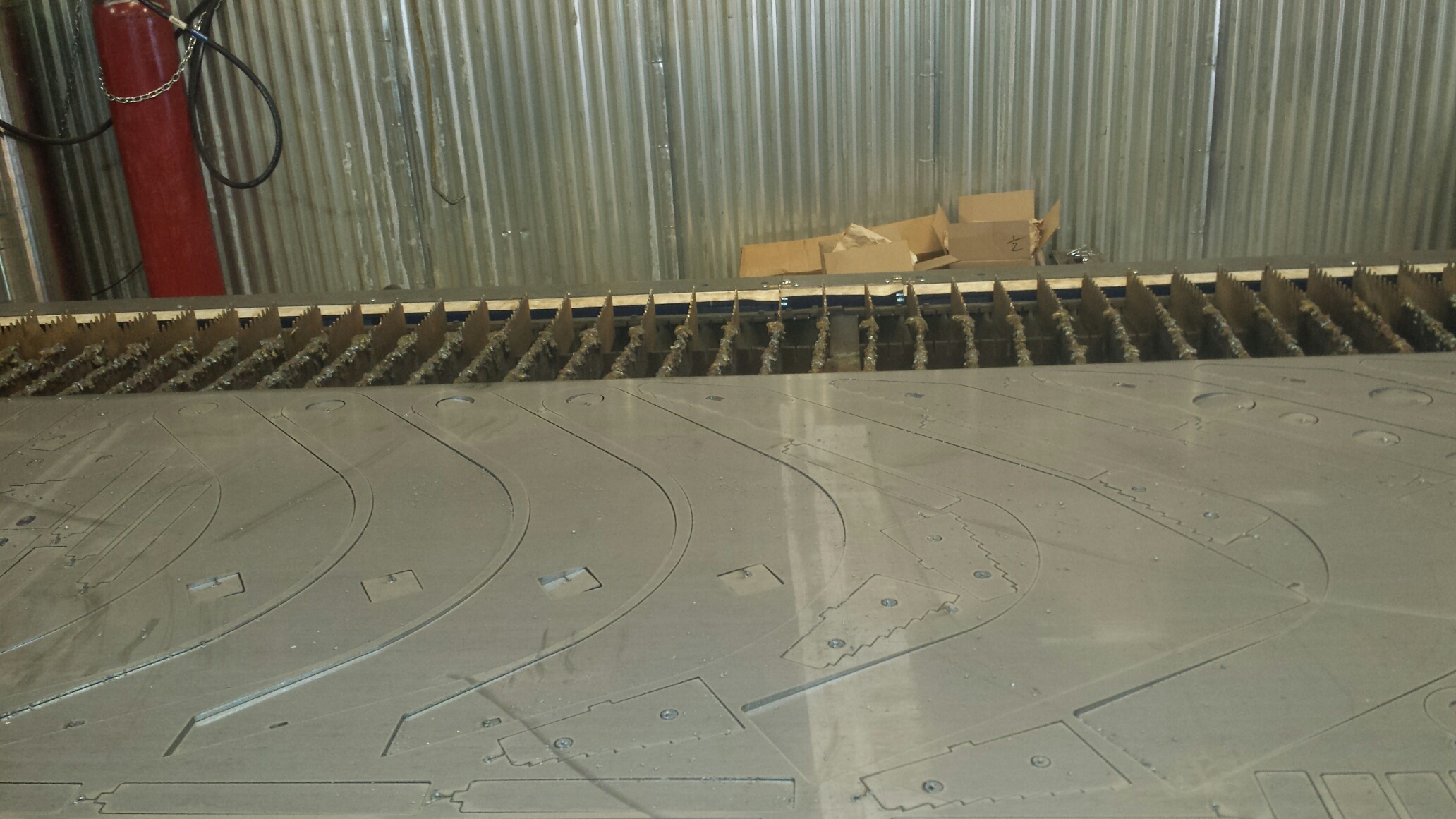

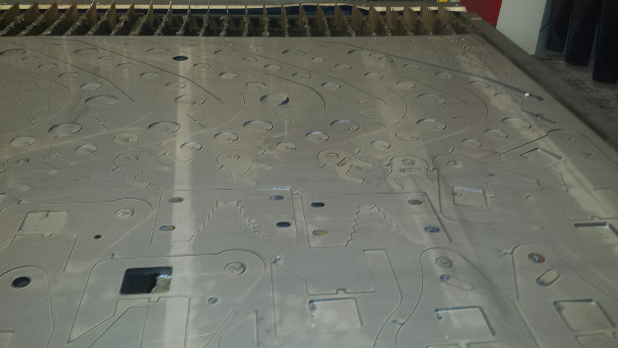

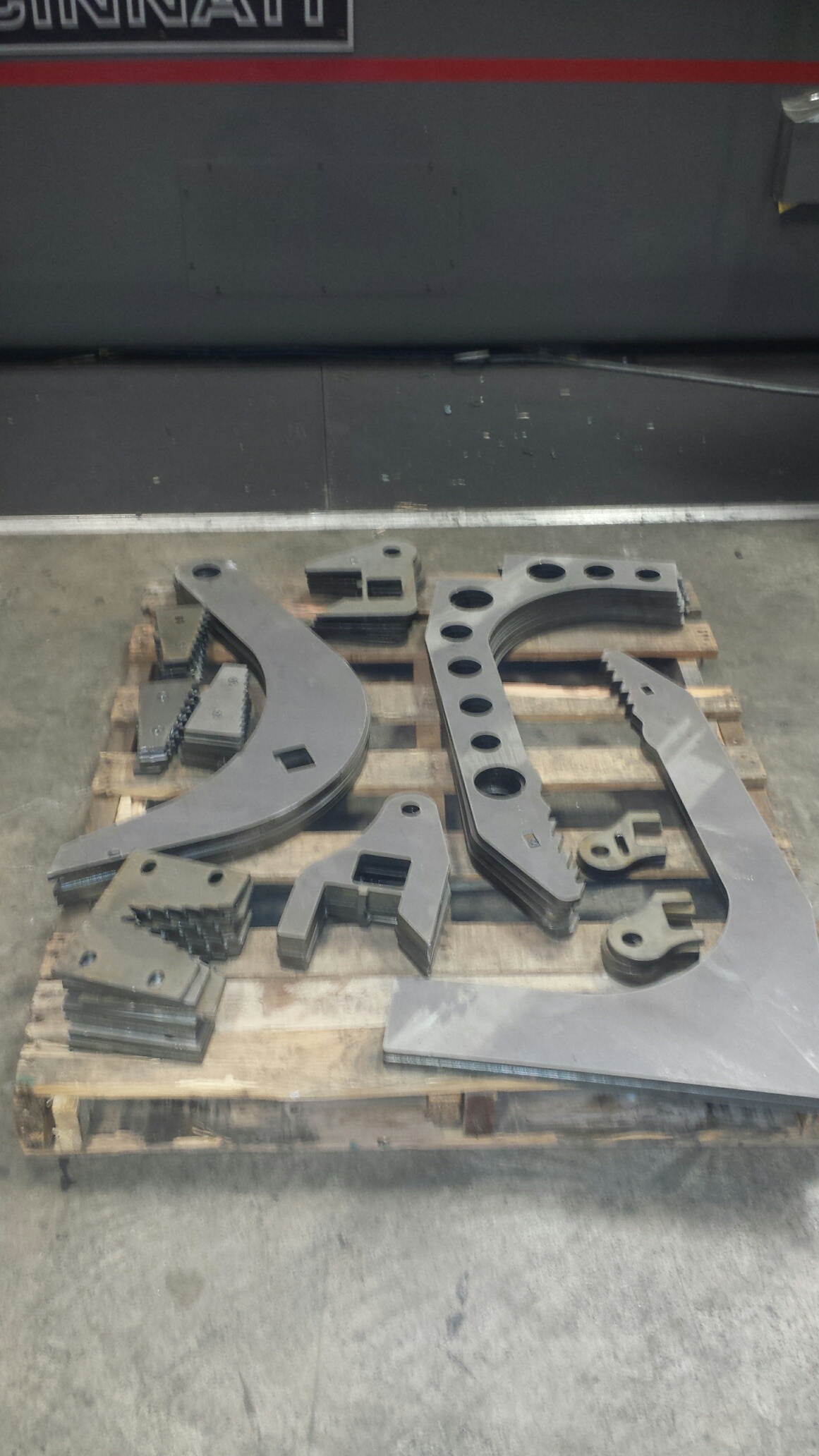

We're getting closer! I'm told it should start going together in the next day or so!!

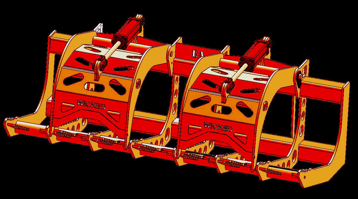

The Wicked Utility Grapple will be black, but I added some color to the original drawing to dress it up a little!

I really think the teeth cut in on the support brackets will cause problems with brush and twiggy material.
For customer lake shore clearing I bring a ground man to clear the grapple of twiggy material that hangs onto the existing grapple or my production falls to low. Low production is fine on my own project, but not when I'm billing $80 or $100 and hour.
