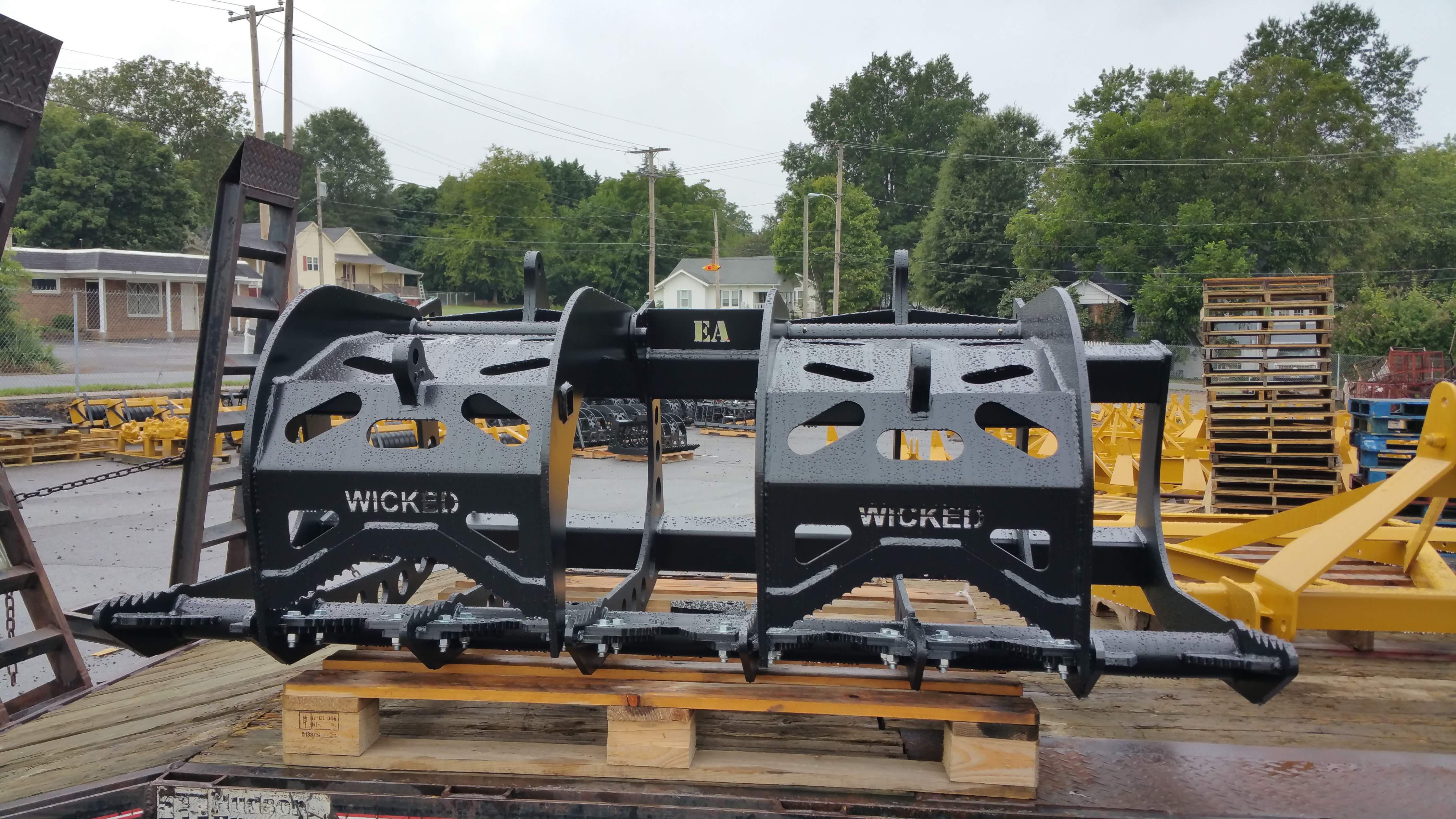

I really think the teeth cut in on the support brackets will cause problems with brush and twiggy material.
For customer lake shore clearing I bring a ground man to clear the grapple of twiggy material that hangs onto the existing grapple or my production falls to low. Low production is fine on my own project, but not when I'm billing $80 or $100 and hour.
We'll test it like that. I do not think it will be a problem because the angle of the blades promotes the shedding of material, rather than holding it in.
If it is a problem, we know the right people with the ability to change it in a jiffy!!
Travis

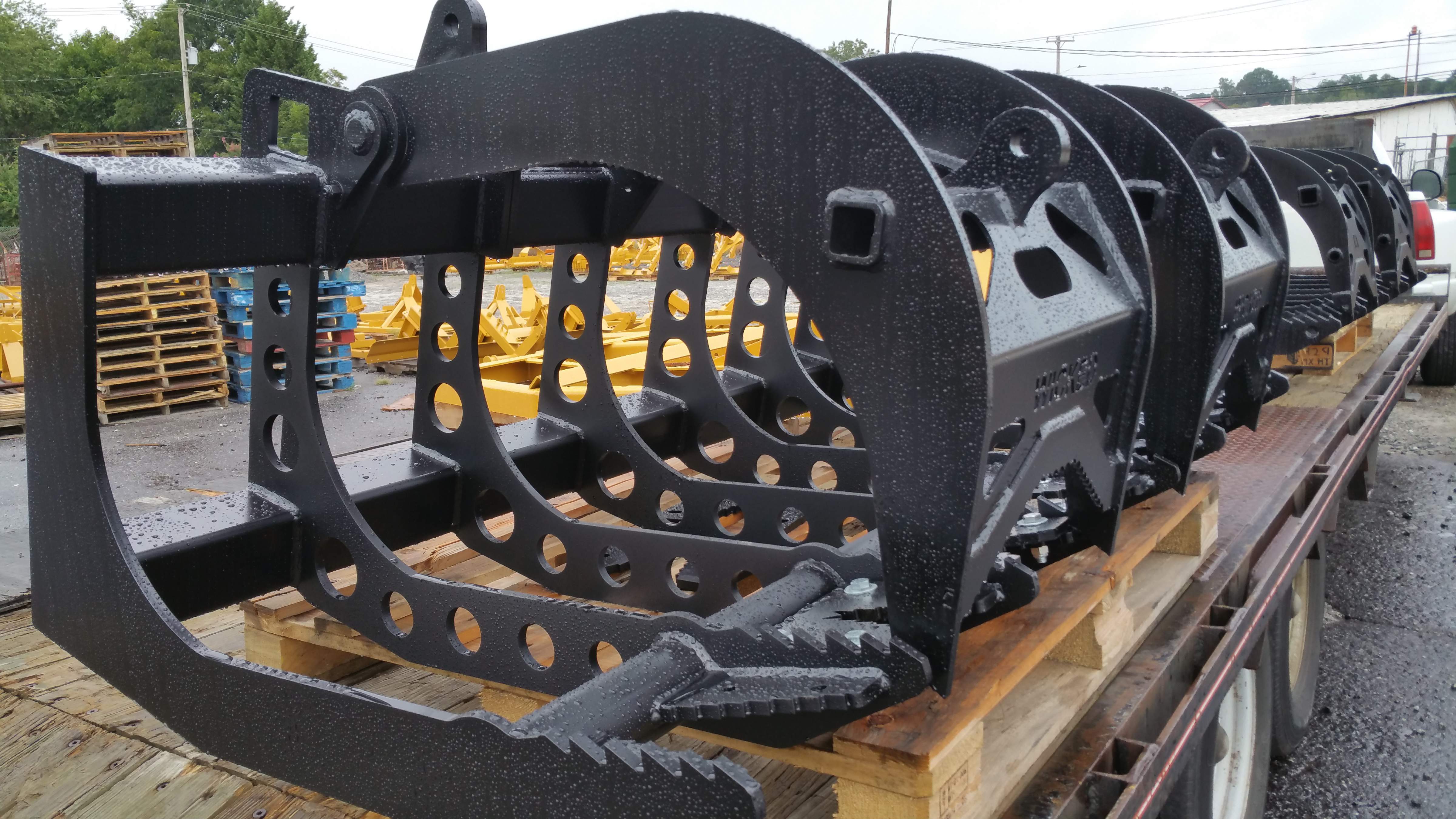

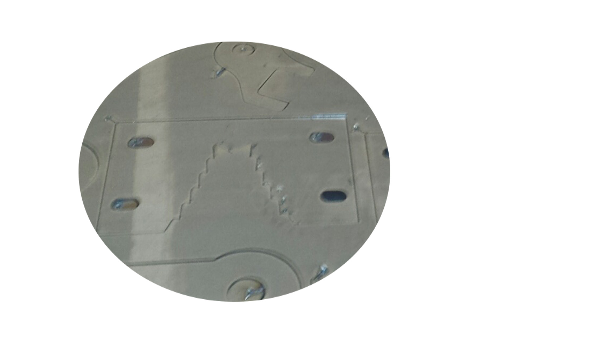

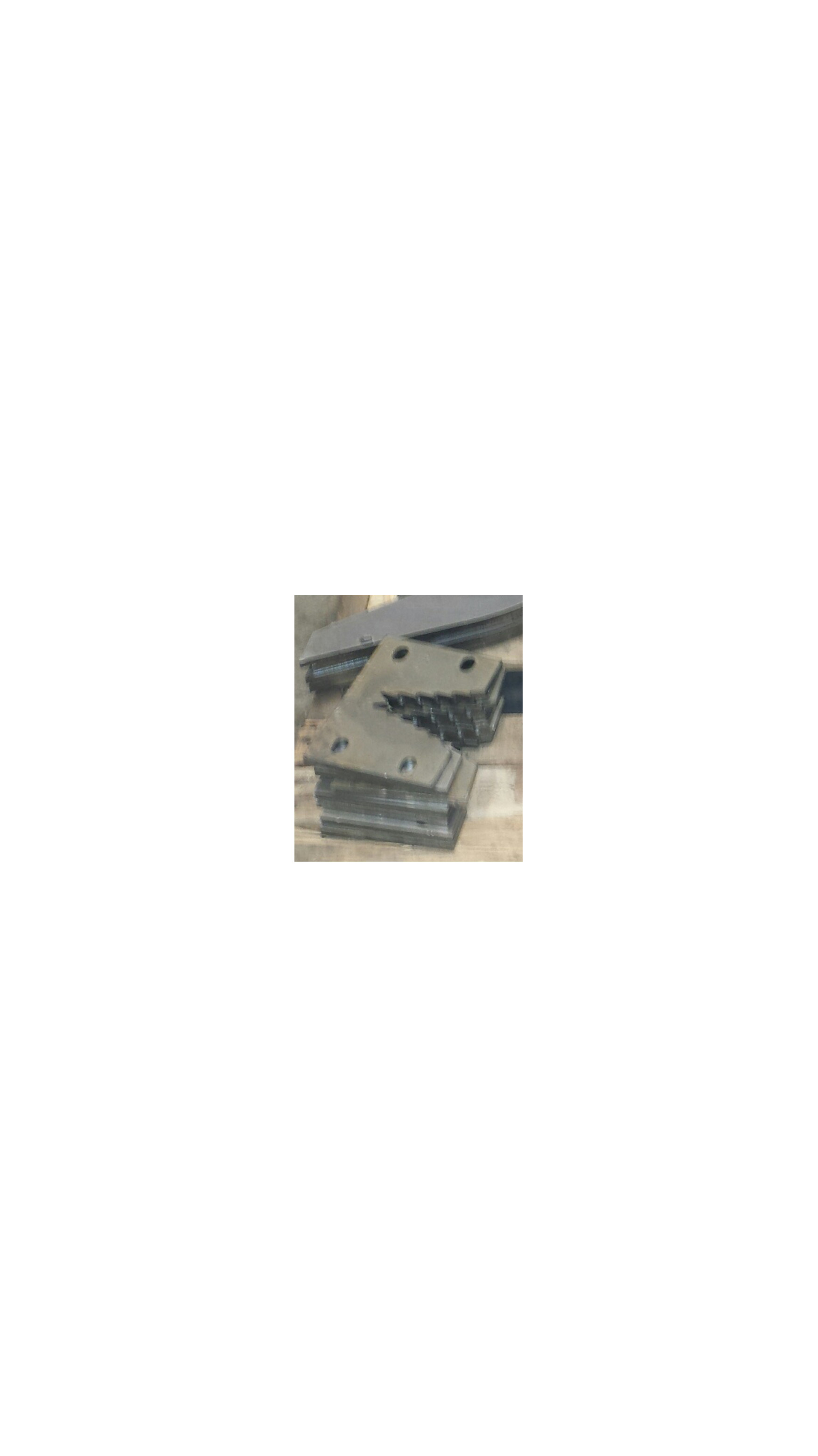

The inserts that will come bolted in are sharper and more aggressive, but they can be easily removed. Just a little icing on the Wicked Cake.

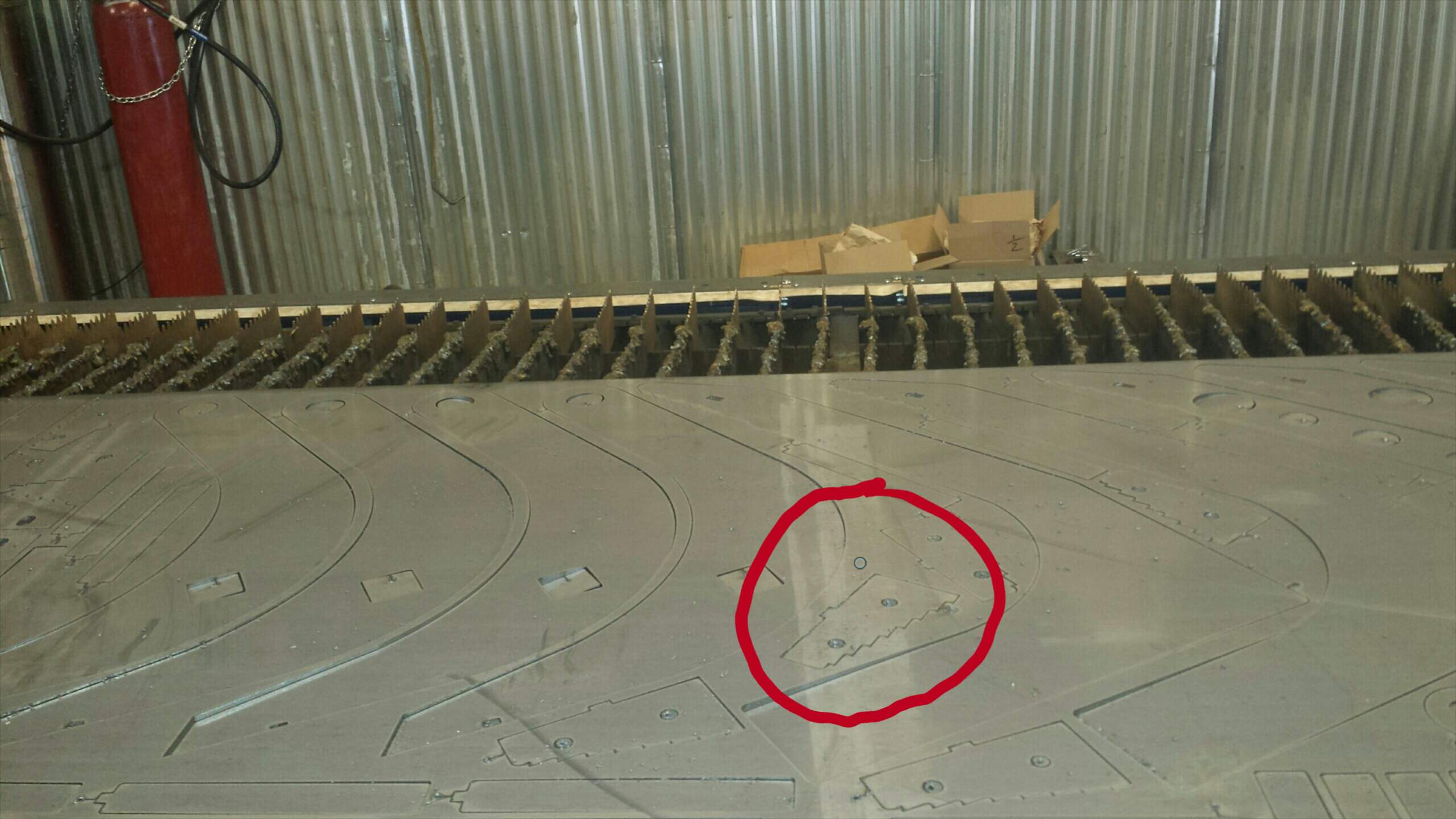

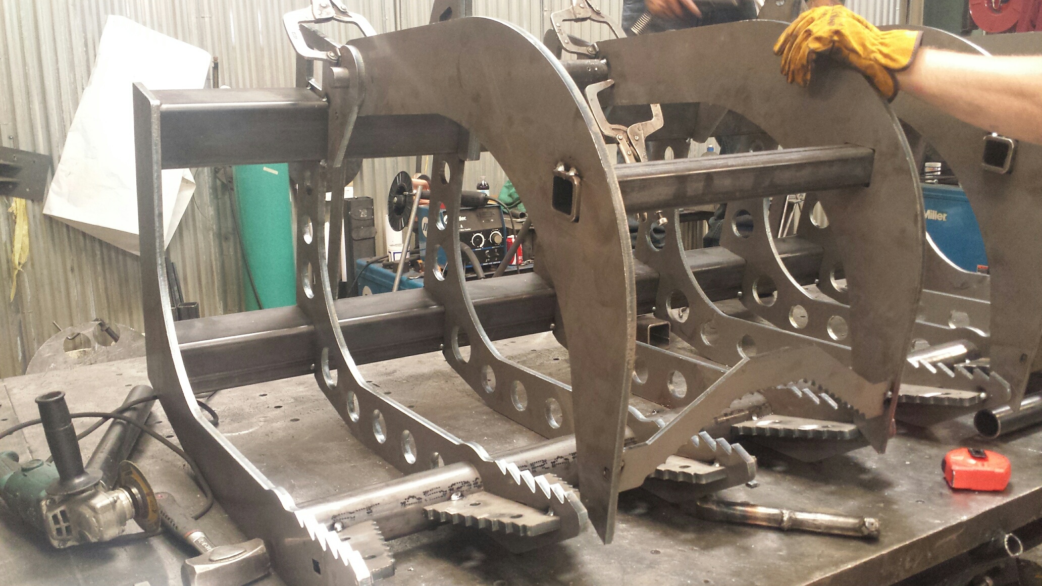

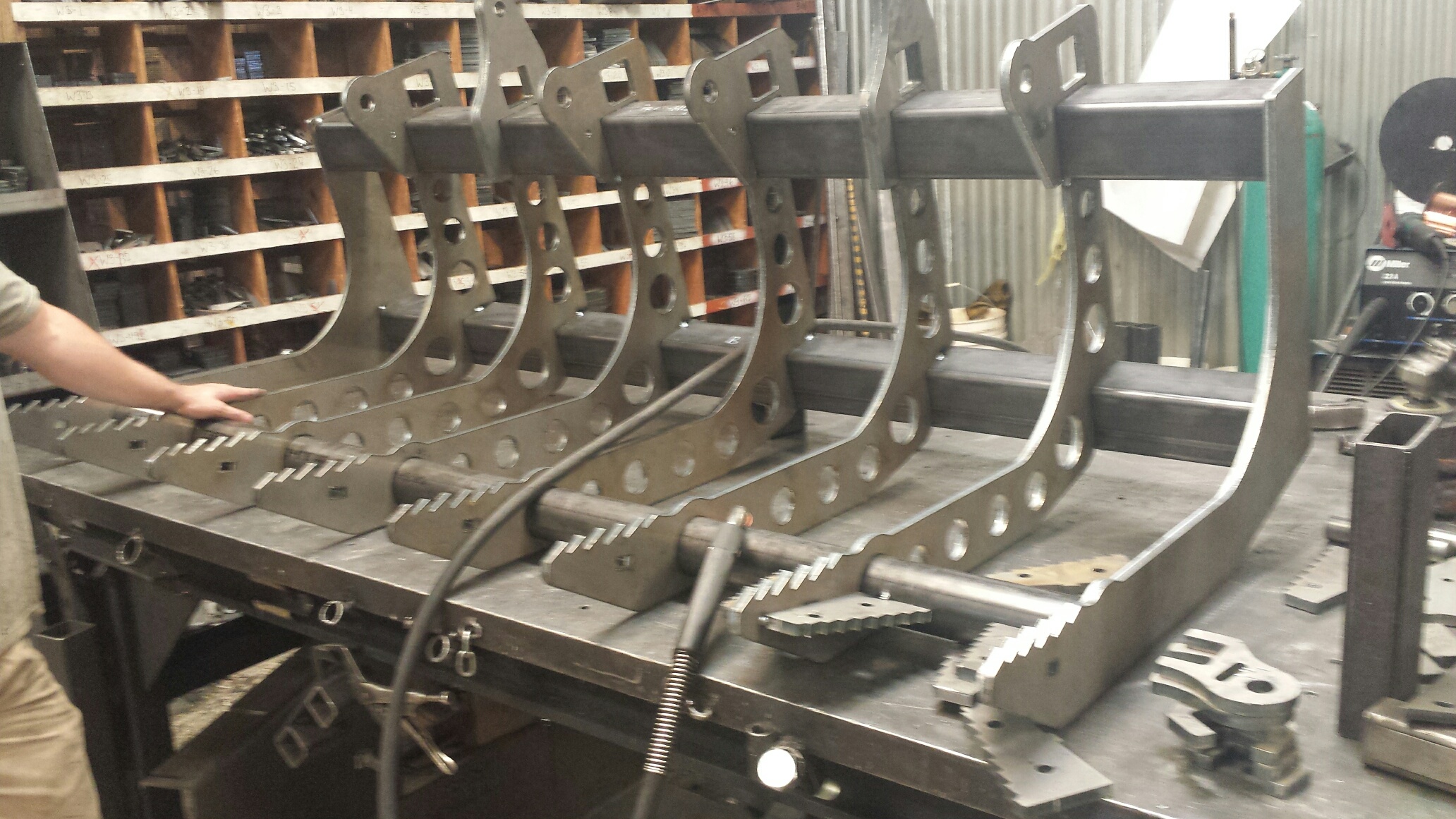

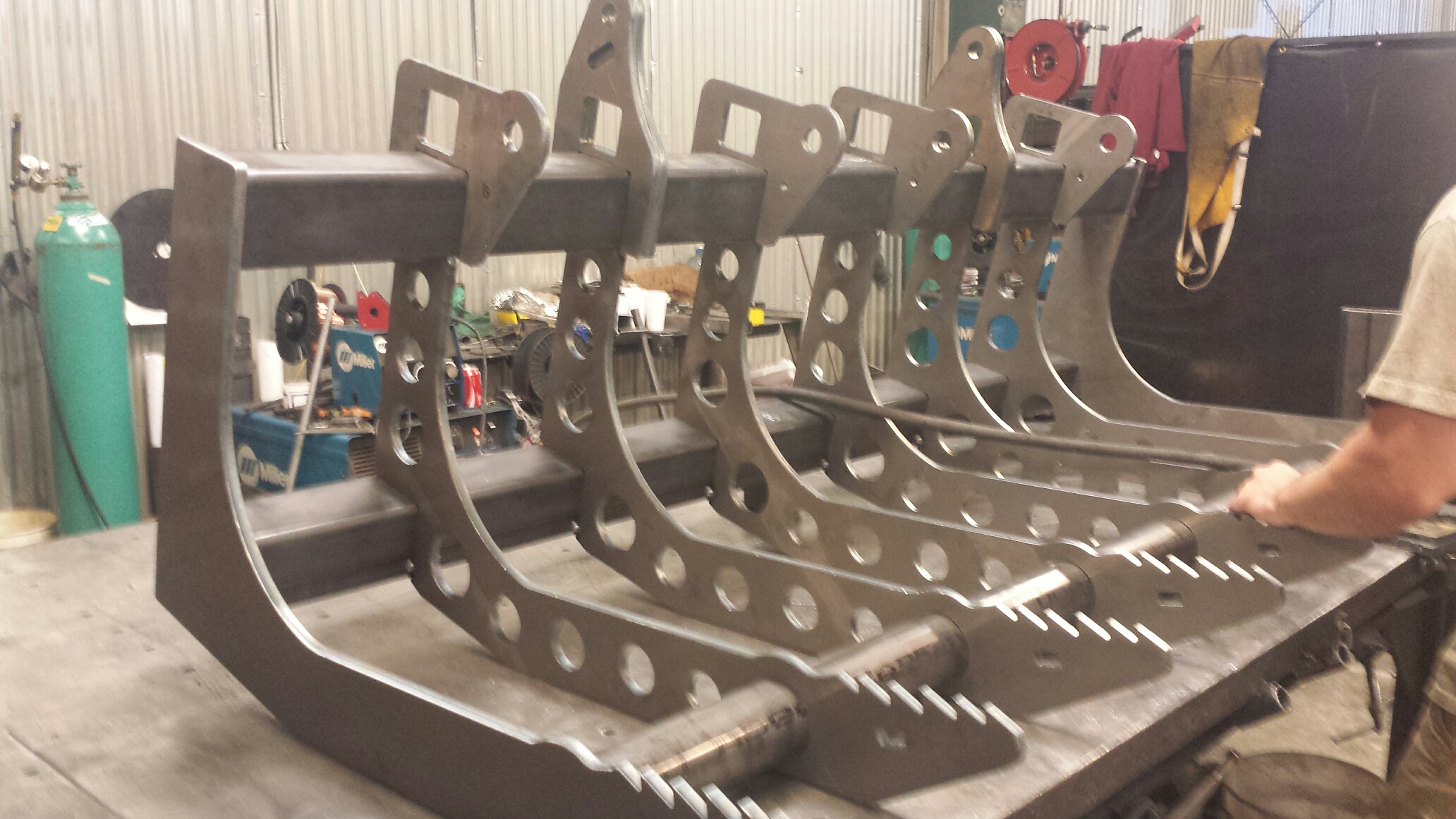

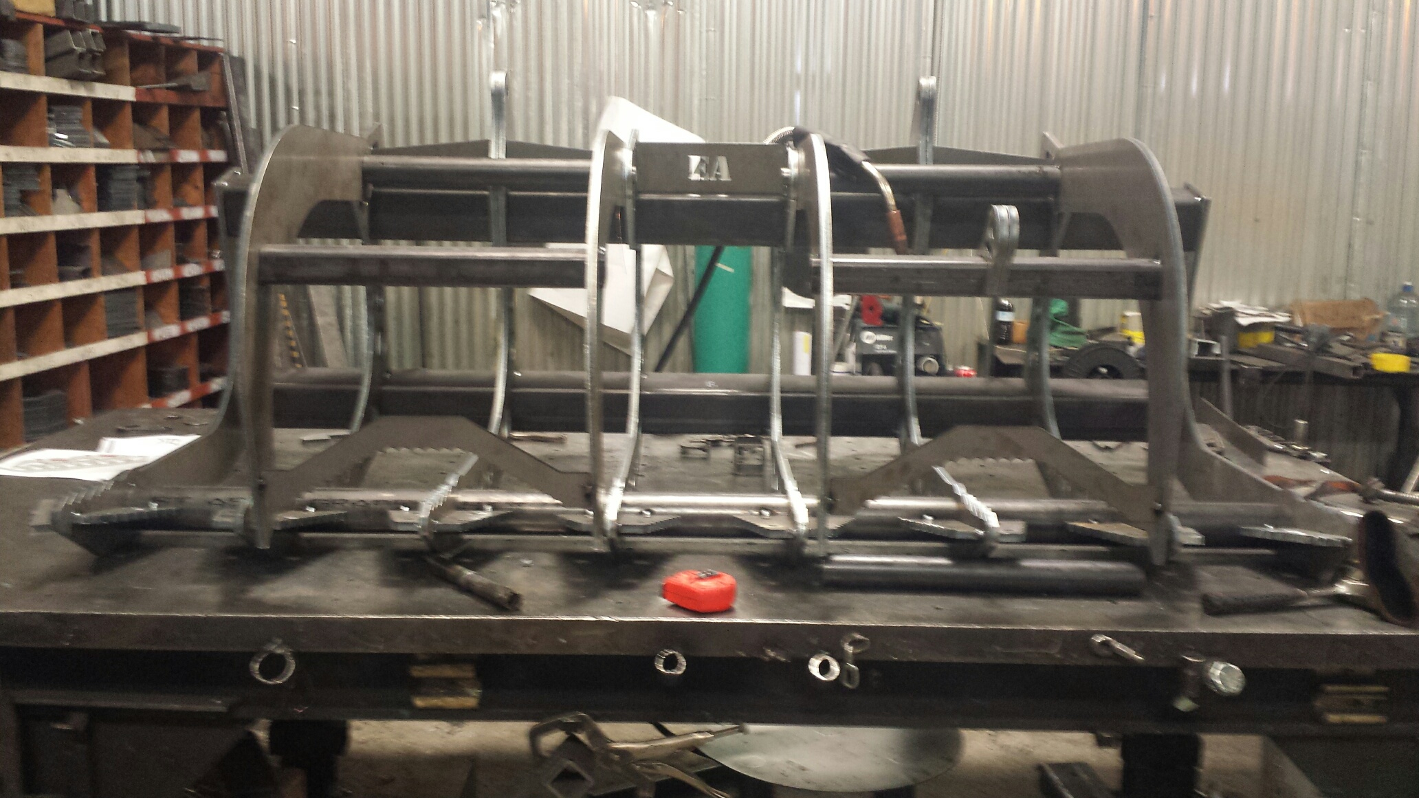

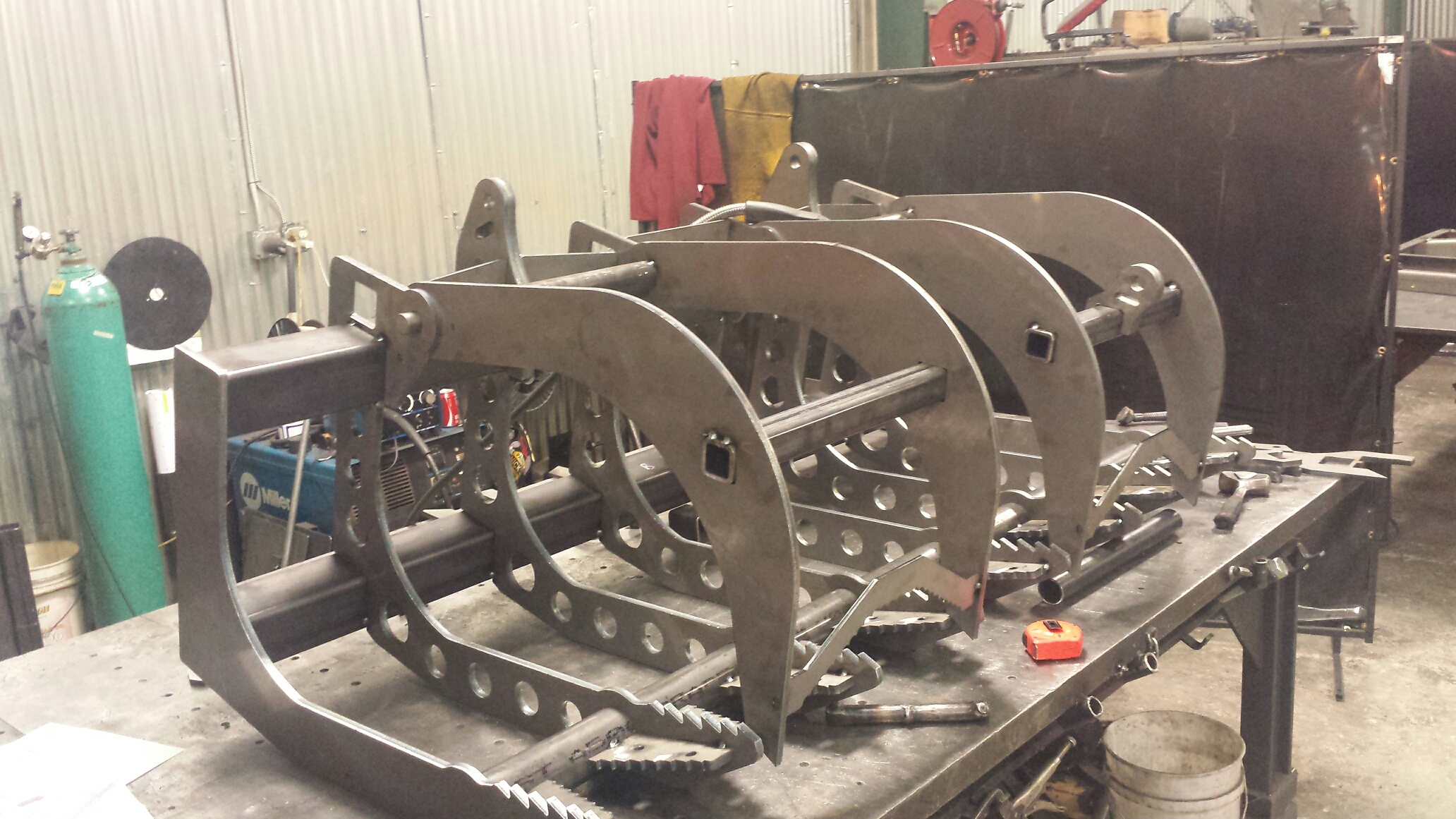

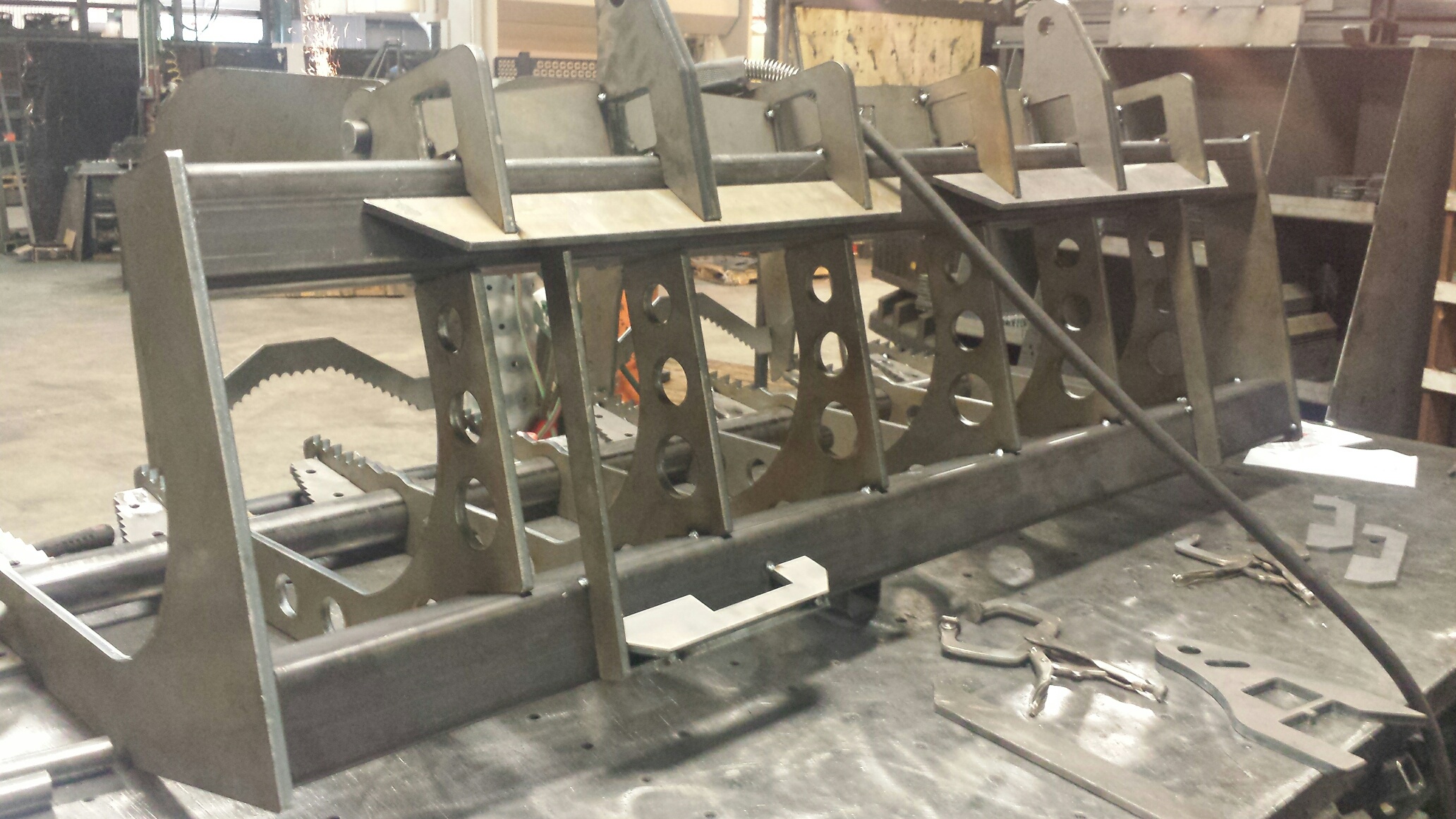

Here's how the week finished up as of about 3:45 today. The Wicked Utility Grapple is almost completely tacked, still lacking the lid guards and pipe supports.
Travis
20150814_145742_resized.jpg 20150814_145838_resized.jpg 20150814_153659_resized.jpg
20150814_154709_resized.jpg 20150814_154742_resized.jpg 20150814_154551_resized.jpg

Travis, did somebody run a material analysis or stress analysis on the lid ribs? The reason I ask is the top lid ribs look way, way too heavy for (what I presume) is the anticipated loading.
Only a concern if trying to keep weight down is a goal.
If you are referring to the cylinder mounts, those things take a lot of punishment so we will not skimp. I'm pretty sure that the vertically extended posts consist of (2) 1/2" plates....it may net a few extra pounds, but it's well worth it. You'll notice that, instead of really thick plate(s), your grapple has triangular gussets on either side of the rear cylinder mounts for strength.
We do shave the weight where it makes sense, but IMO, there are 3 spots where a grapple should be extra strong. The Hitch, The Hinges, and The Cylinder Mounts. You'll notice that those important areas are ready for a beating, because we know that there are EricTheOracles out there! :laughing:
Travis

Ted says you're talking about the actual skeleton of the lids....lid ribs...makes sense.
He is using what is pretty close to the same geometry lids as his brother's 1RG extreme grapple, which uses 3/4" lids. He's taking that grapple, which is over 1,200 pounds and transforming it into around 650 pounds of pure, useful Wickedness for Utility Tractors. Oh, and the reason for 1/2" lid ribs.....that's for said EricTheOracles of the world too!!
The extra strength/thickness is not so much for clamping....it's for those who abuse/misuse. Clamping and pulling back/down/sideways with the lids puts extra stress on the lids(of course) and on the hinges/cylinder mounts as previously stated.
Travis

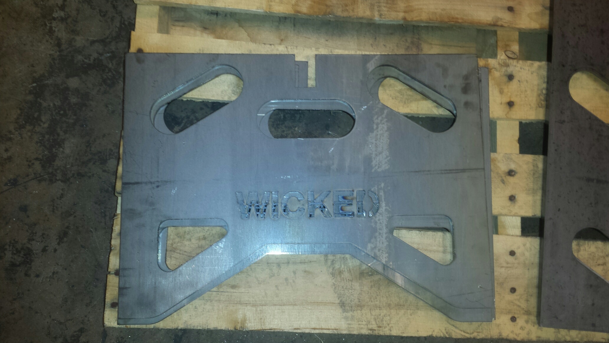

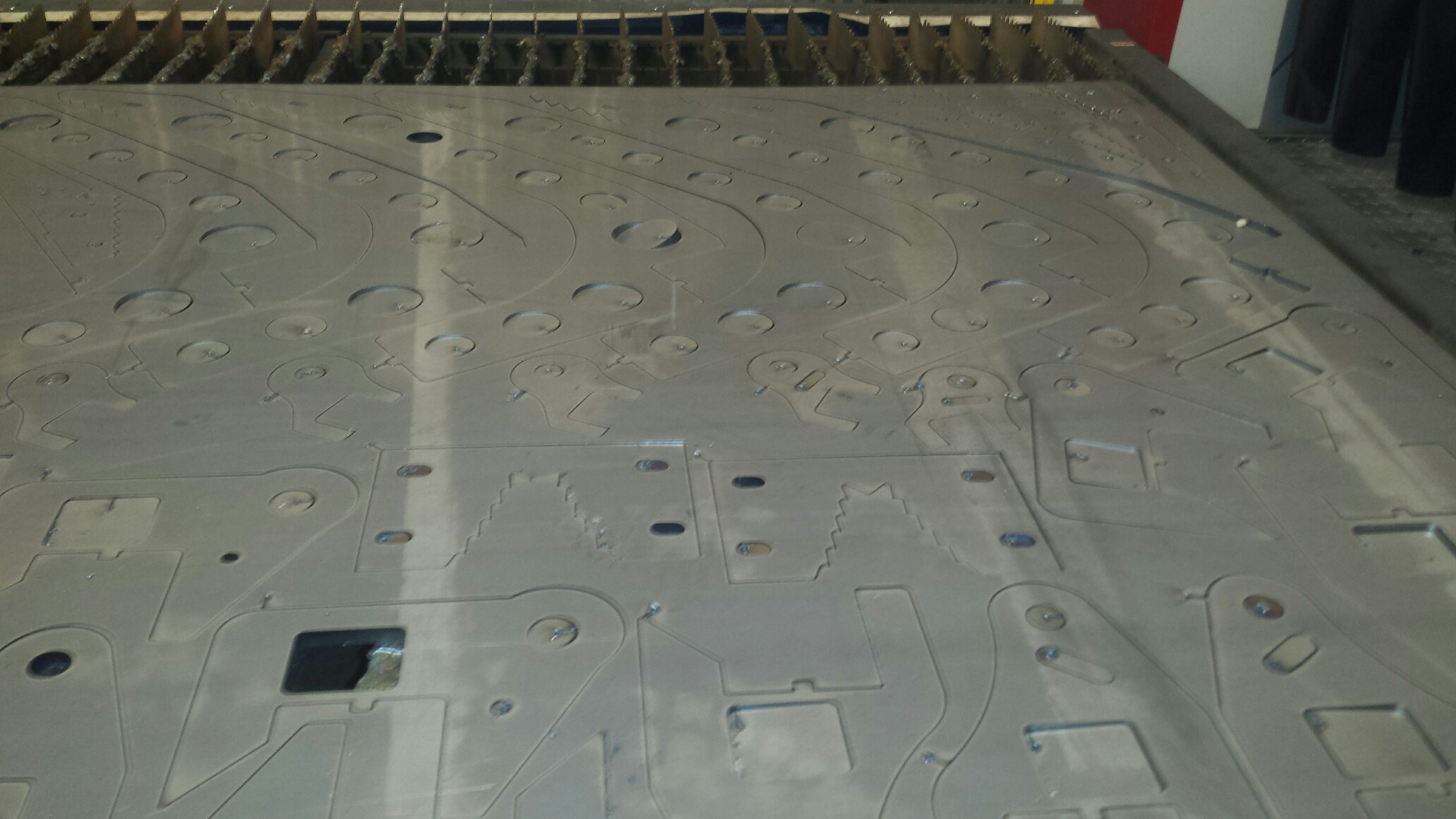

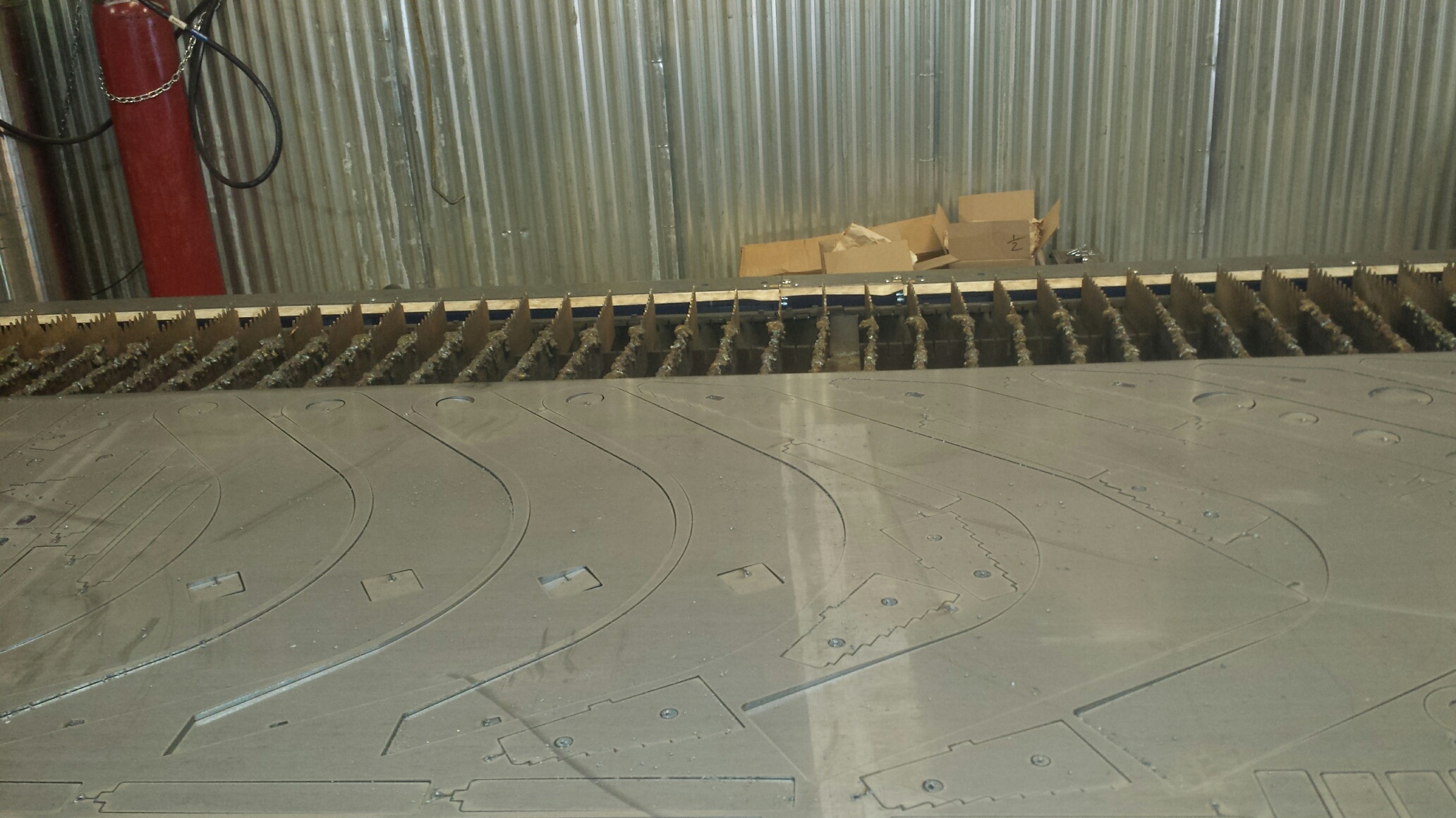

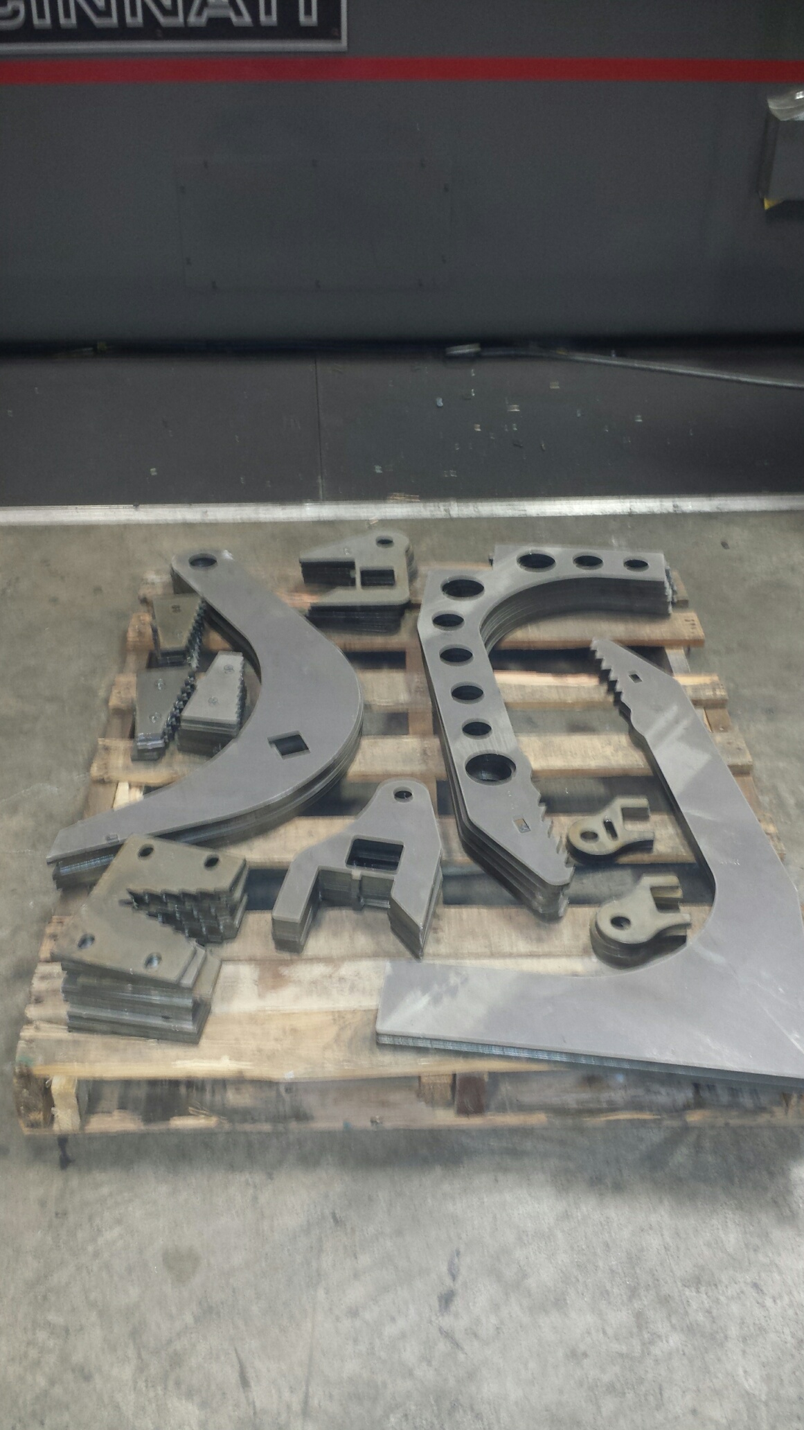

Wicked Grapple Lovers, I have news for you. It turns out that the new design is heavier than anticipated. It is strong and Wicked, but it just is not ideal for the targeted machine. We're all about ideal, you know!
The new grapple does hit the mark for larger utility tractors(80-90hp+) and skid steers, considering the 73" weighs over 800 pounds.
Now we are back to work on the Wicked Utility Grapple and will soon have two new grapples to test!!!
Travis
