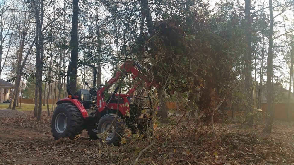

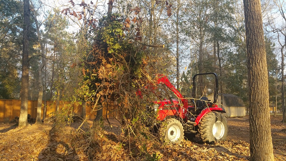

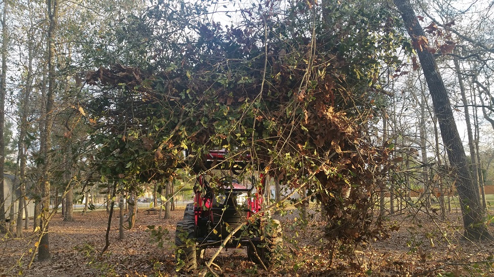

The 60" will grab just as much brush as a larger one. This is actually a 60" single on snowback's 2538 Mahindra, but who could tell? :laughing:
Large logs will not be an issue either. This is a 60" Dual Lid on a Kioti NX5510.

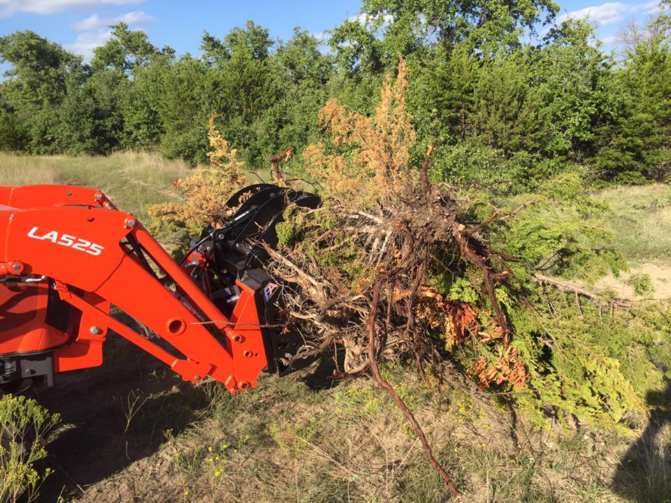

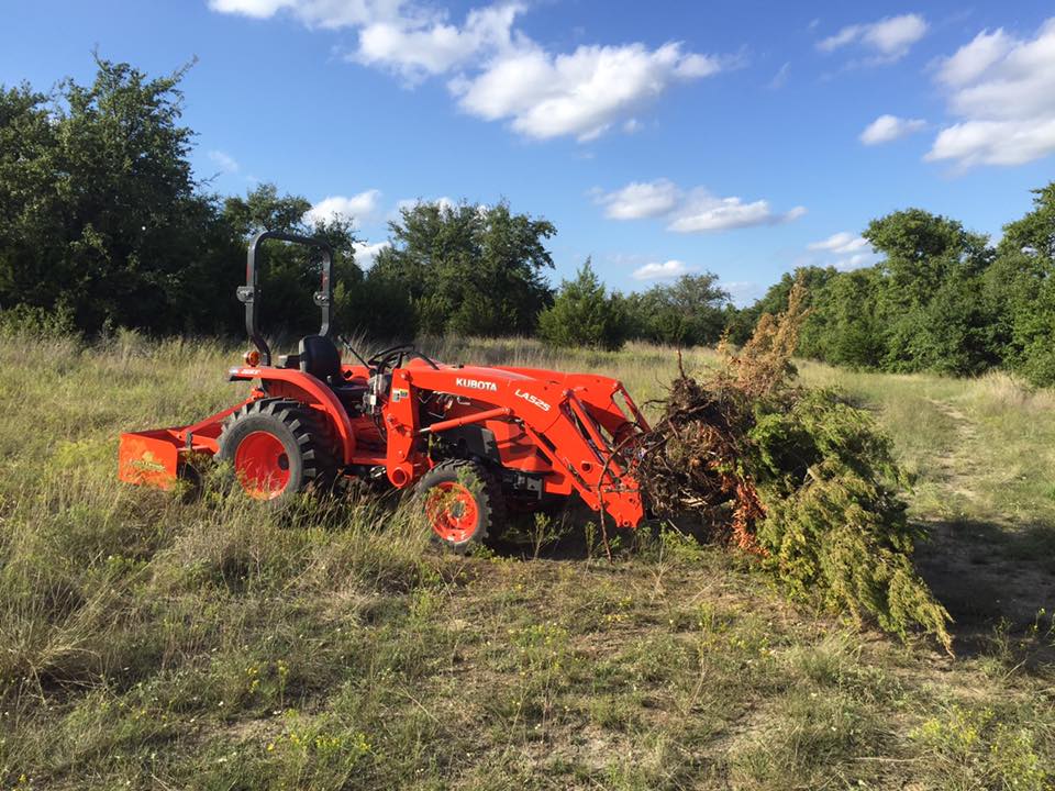

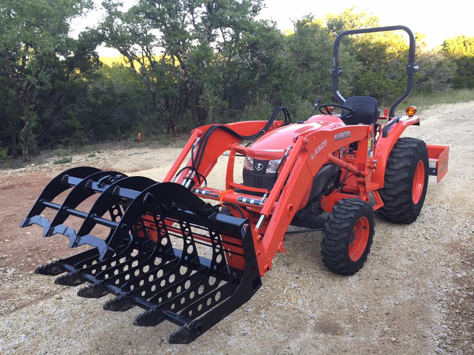

Oh, a couple of pics for comparison....because aren't pics great?
60" Dual Lid on a Kubota L4060
66" Dual Lid on a Kubota L3240

The 55 or 60 will be easier to maneuver and for brush and logs a single lid will do the same job but will cost and weigh less.
/ The WICKED Root & Debris GRAPPLE!!!!!!! #2,823
As far as brush goes, you won't see a difference in capability. The biggest advantage of a wider width is when picking up loose item like firewood, rounds, small stumps etc. Items like that. For brush, it won't matter.

The key words I heard were "pull up". More often than not, the corners of a grapple are used to get under and uproot stubborn brush and saplings. Used thusly, a wide grapple will twist the front end loader and even lift the opposite rear wheel off the ground on occasion. For tough uprooting, narrower will be more effective and easier on the equipment, in my opinion.
We have a 72-inch single lid which has performed valiantly on our 55 horse Mahindra. But if I had it to do over again, I would go no wider than the FEL. No matter what size you get however, you will be delighted.
