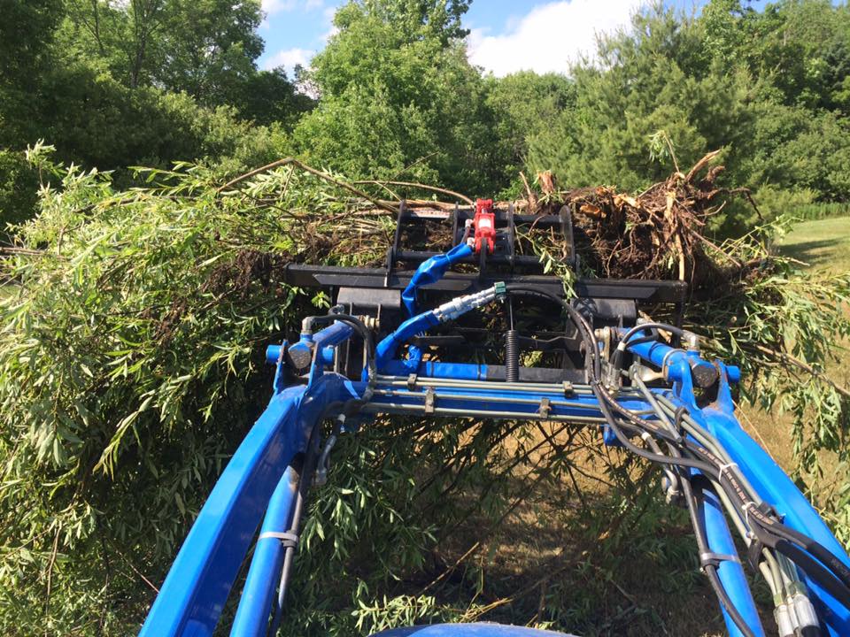

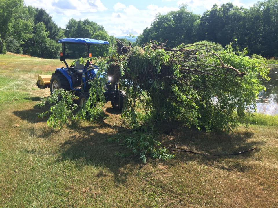

New Holland TC45 with a 60" Single Lid Wicked
