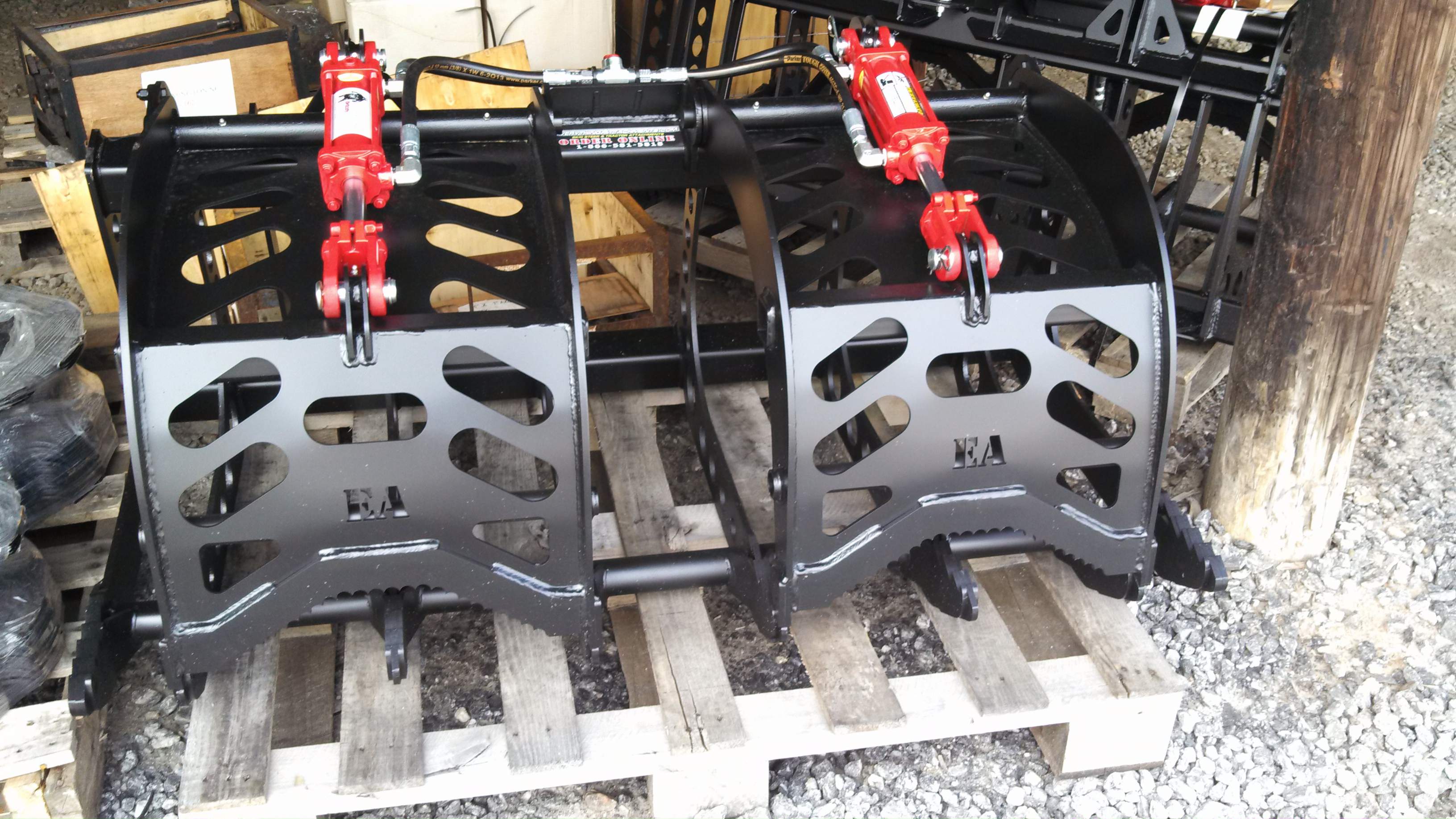

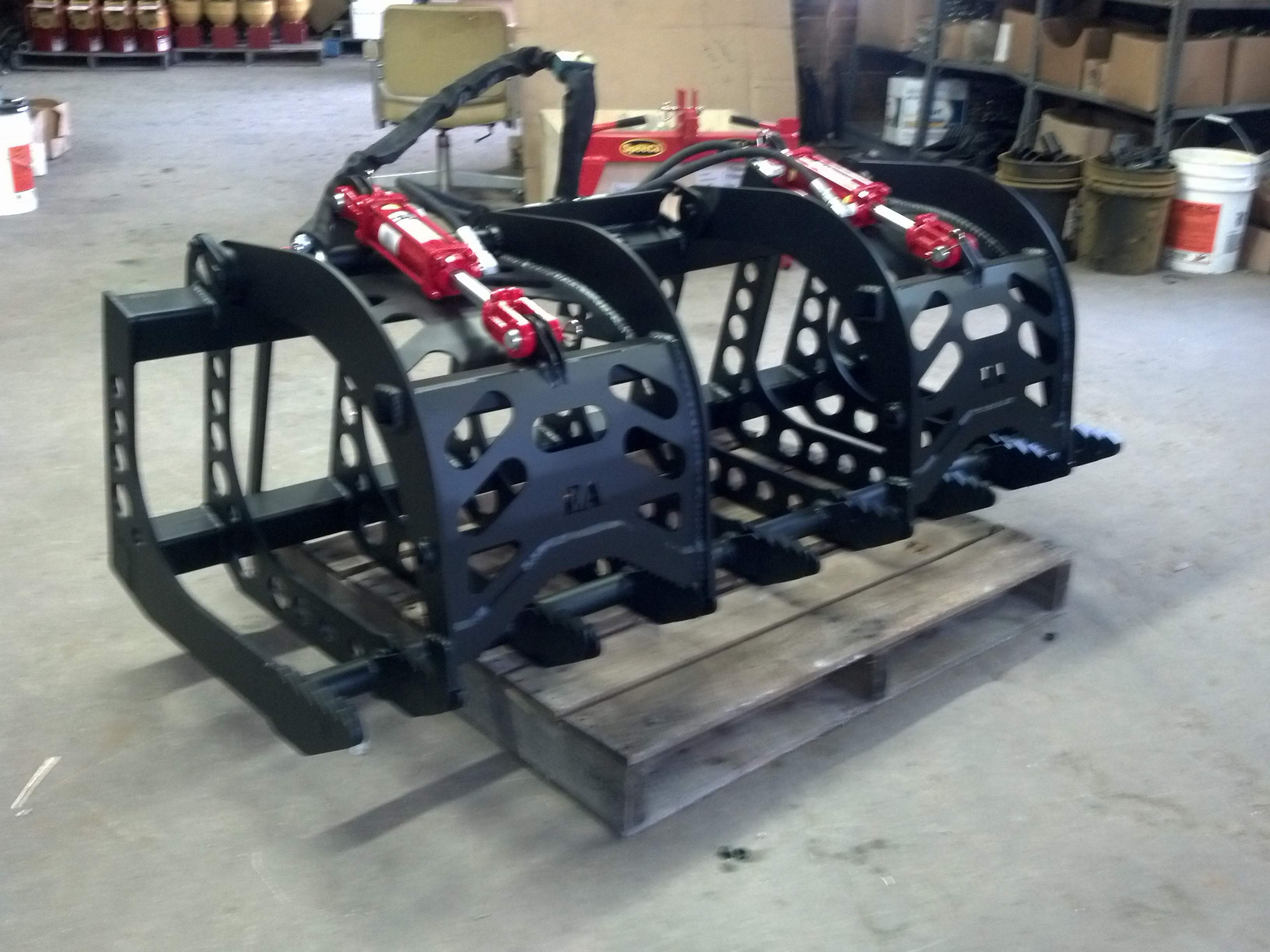

Is it hard on the double clamp versions to say grab a single big rock with the inside corner of each clamp?
Also are the clamps the same width on each of the sizes of double clamp?
Are the two clamps moved out on the bigger versions, or are there any pics comparing side by side different sizes in terms of clamp placement. Thanks, Bill

Logically, it will put more strain on the lids to grab something like that because it will put pressure on one side, but I don't think it would hurt the grapple to occasionally do this. Throughout the punishment that Ted dealt when testing the grapple, no damage was done. I think that it would be better to grab it with one side or the other if you're dealing with an extremely heavy rock, log etc.
I'll let Roger(94bullitt) chime in if he's watching. I think I saw a pic of a big stump in between the lids of his grapple.
The clamps are 18" wide on all sizes of the dual lid grapples.
On the 54" and 60", the lids are 8.5" apart and on the 66" and 72", they are 17.5" apart.
The pic on the left is of a 54" grapple and the right is a larger model so you can see the difference in spacing.
