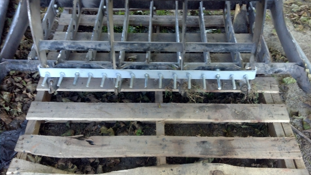

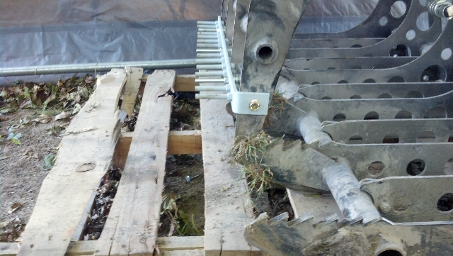

You forgot to add a rake for the small stuff, problem solved.
