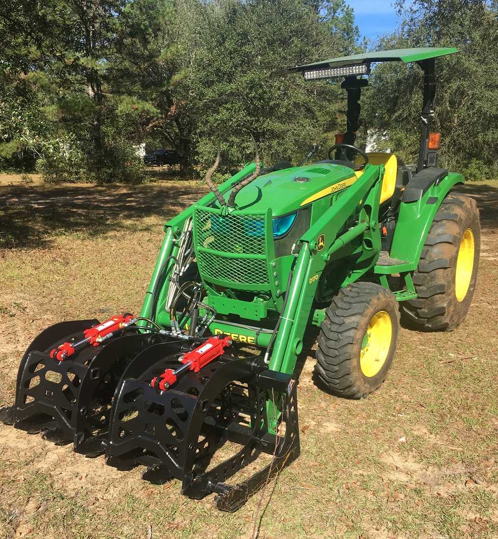

Mine is all 3/8” hose and my EA Wicked Grapple for Utility Tractors is single lid / single cylinder Bill.
The WR Long on my 100HP New Holland has 1/2” feed but rest of hose, including my 84” HD grapple is 3/8” which was my decision.
Both grapples open / close very smoothly.

I went with the 50” L shape grapple it kept the weight down, and I think will work best with my needs. Here is a link.

50" Single Lid Wicked Grapple
She's a sharp fanged beauty!
I know I've shared them before, but these pics of the Wicked 50 on my Father in law's Kubota L3301 were taken by yours truly!
Travis

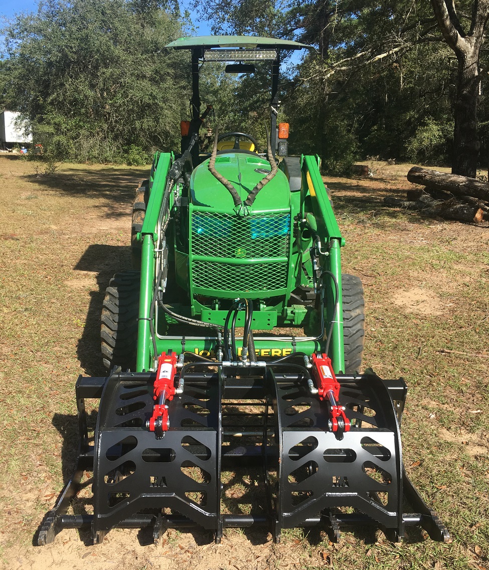

Why doesn't anyone that makes a single lid, make the lid go all the way across the top instead of in the middle of the bottom part. To go all the way across, you have to get double lid.

Rake grapples do.

IMO, a full top lid on a long bottom grapple would be more limiting.
I think a full top lid would actually result in a less efficient grip and cause way more load shifts due to uneven logs, rocks, stumps, etc.

And a lid gets in the way for some jobs such as getting under root balls and prying up saplings. The lid hits the trunk of the tree and prevents the bottom from getting as far under as you would like to. We use the corners of the bottom where there is no lid to get up close and personal with the roots.

After owning a wide clamshell style, I think the reason is the double lid works better than a wide single lid.
I have never experienced anything negative with the open gap between the double lids in seven years of using a 6' wide L bottom grapple. The gap works good to straddle a tree trunk when pushing brush up against it, then closing them on a full grapple.
