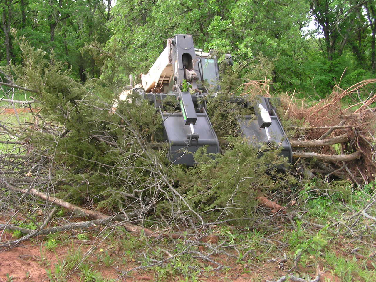

The style that works best depends on what tasks it will be used on the most.
I have had both styles and like the L bottom the best. The main difference is picking up small brush and tree limbs.
My first grapple ever, didn't hold much of this stuff:
Notice how much is left on the ground. :(

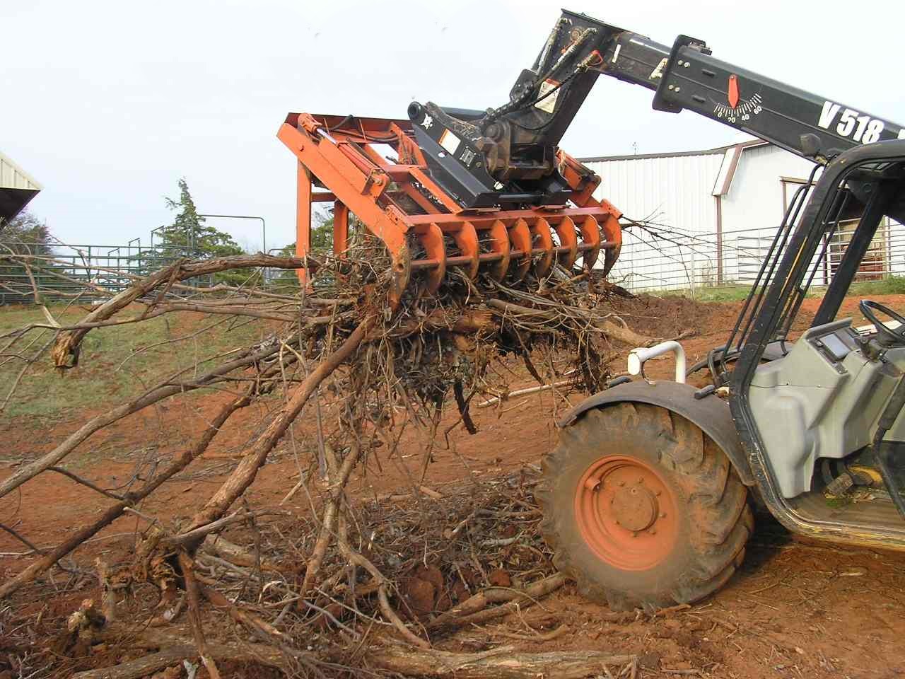

Works well on big single items: :thumbsup:

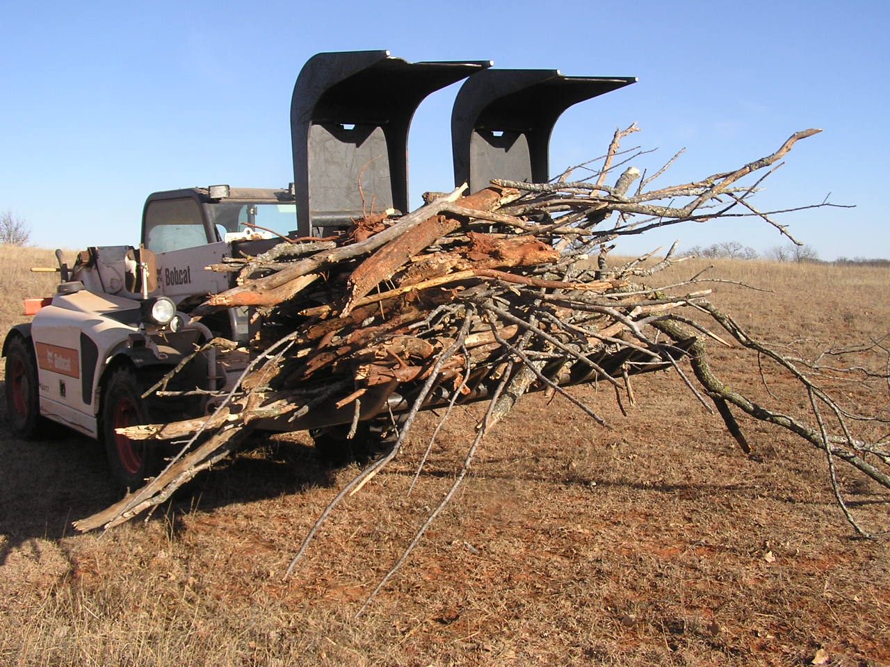

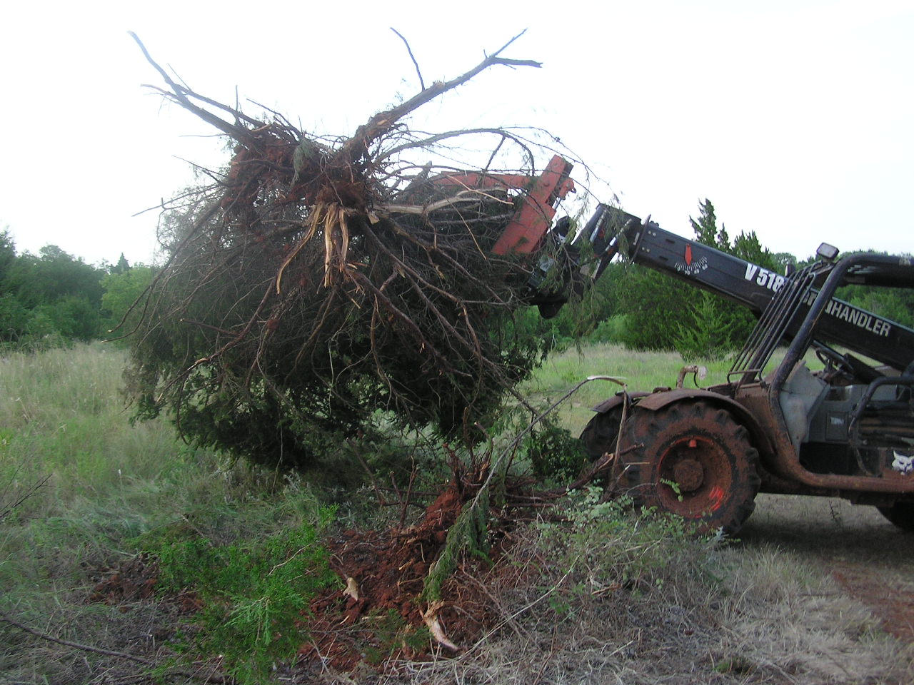

My favorite style L bottom, works better on small brush and trees:
Nothing left on the ground. :)

Thanks. Even though these are bigger grapples, the operational functional differences are the same as smaller size grapples.
The clamshell pictured above is bigger than the L bottom, but it won't pick up as much brush.
