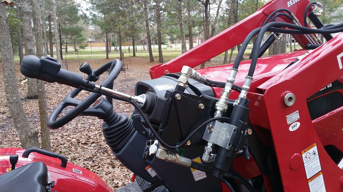

The replacement joystick knob has a rocker for opening/closing.
Travis

So it has an electric button you push on a joystick? If you can operate loader up/down, Dump and the grapple all at the same time you have a true 3rd function system. If you can only operate 2 of the 3 you have a diverter.
I bet it’s a true 3rd function. Sounds like it need a flow control device to slow down fluid flow to grapple cylinder. You may want to install such a device at the grapple so that you don’t limit hydraulic flow to other attachments.
Okay then I have a true third function. Yes I have an electric button. A flow restrictor fitting at the grapple makes sense, maybe I will try one. I suppose I would need 2, one for each line? open and close?
Do you have a single lid or dual? Mine is a dual lid and is surprisingly fast but not too fast. I imagine a single lid would be like a T-rex ready to eat something. 16.2 GPM baby!
Yes, I have a single lid! 16.2 GPM sure closes the lid violently, I would rather the option to feather it and close nice and smooth. Same for the hydraulic auger, I know that a sudden start/stop for the auger may not be the healthiest for the auger motor, so maybe there is also something I can do for that...But I don't know what that would be.
   / The WICKED Root & Debris GRAPPLE!!!!!!! #3,108
You only need one adjustable flow control valve per circuit, not two.

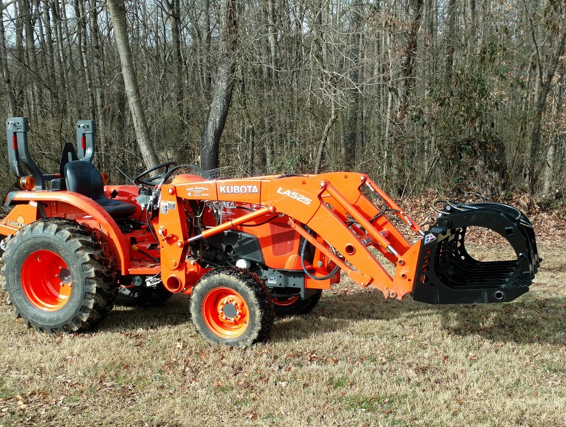

Randy from Tennessee simply sent this pic with a caption reading: "Love it!!!!!! Thanks again for your help."
He has a 50" Single Lid Wicked Grapple on his Kubota L3301 tractor with an LA525 loader.
