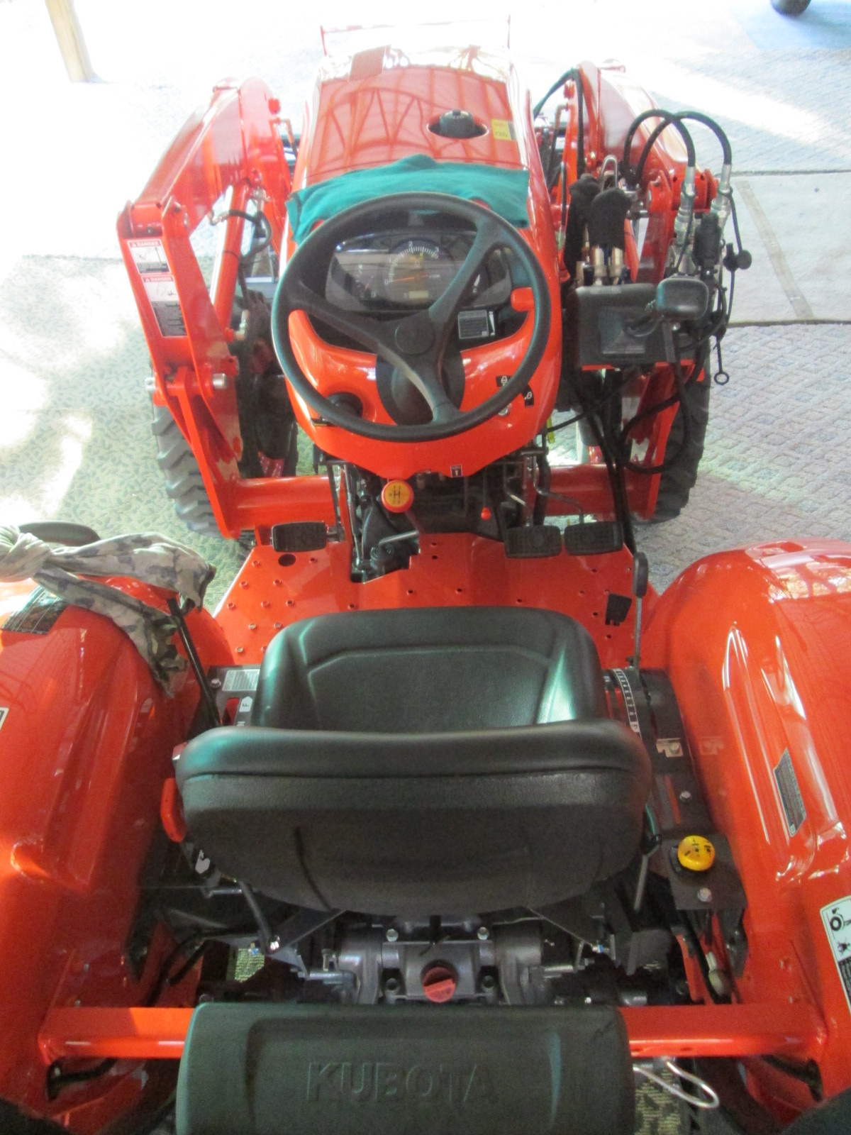

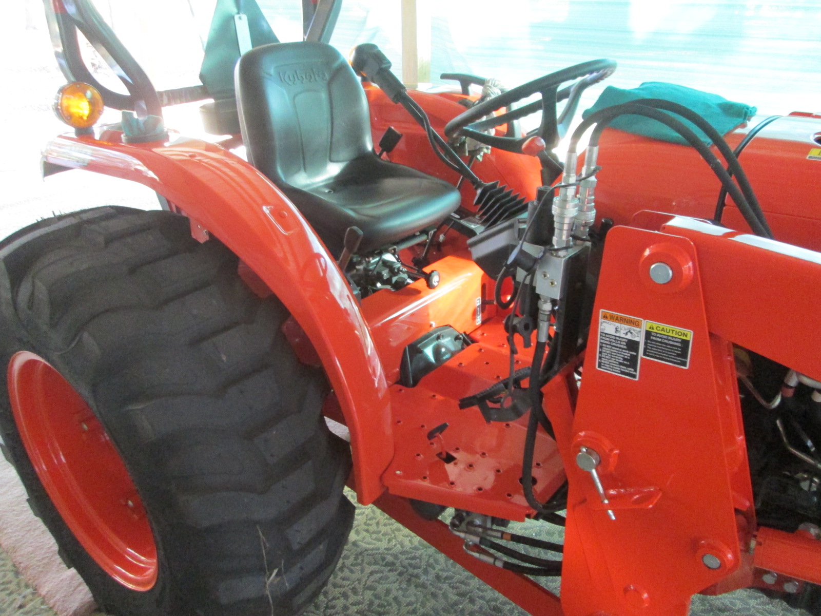

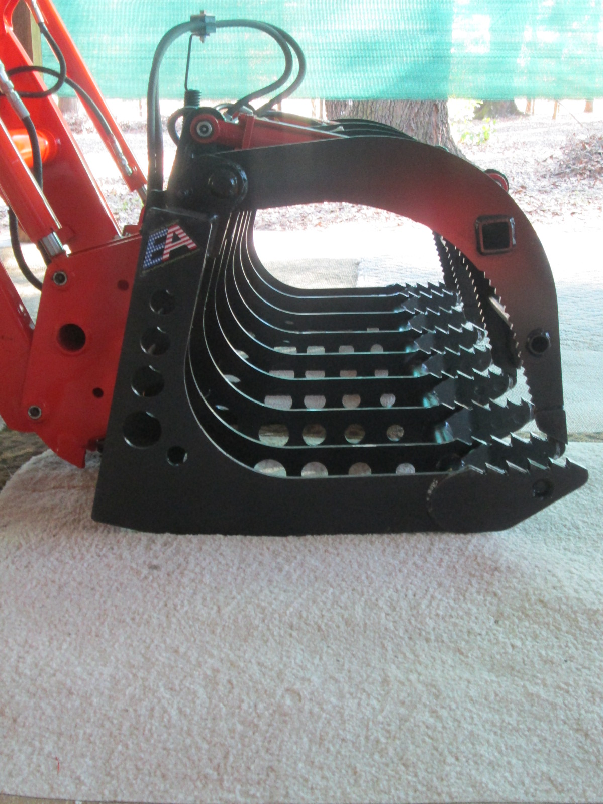

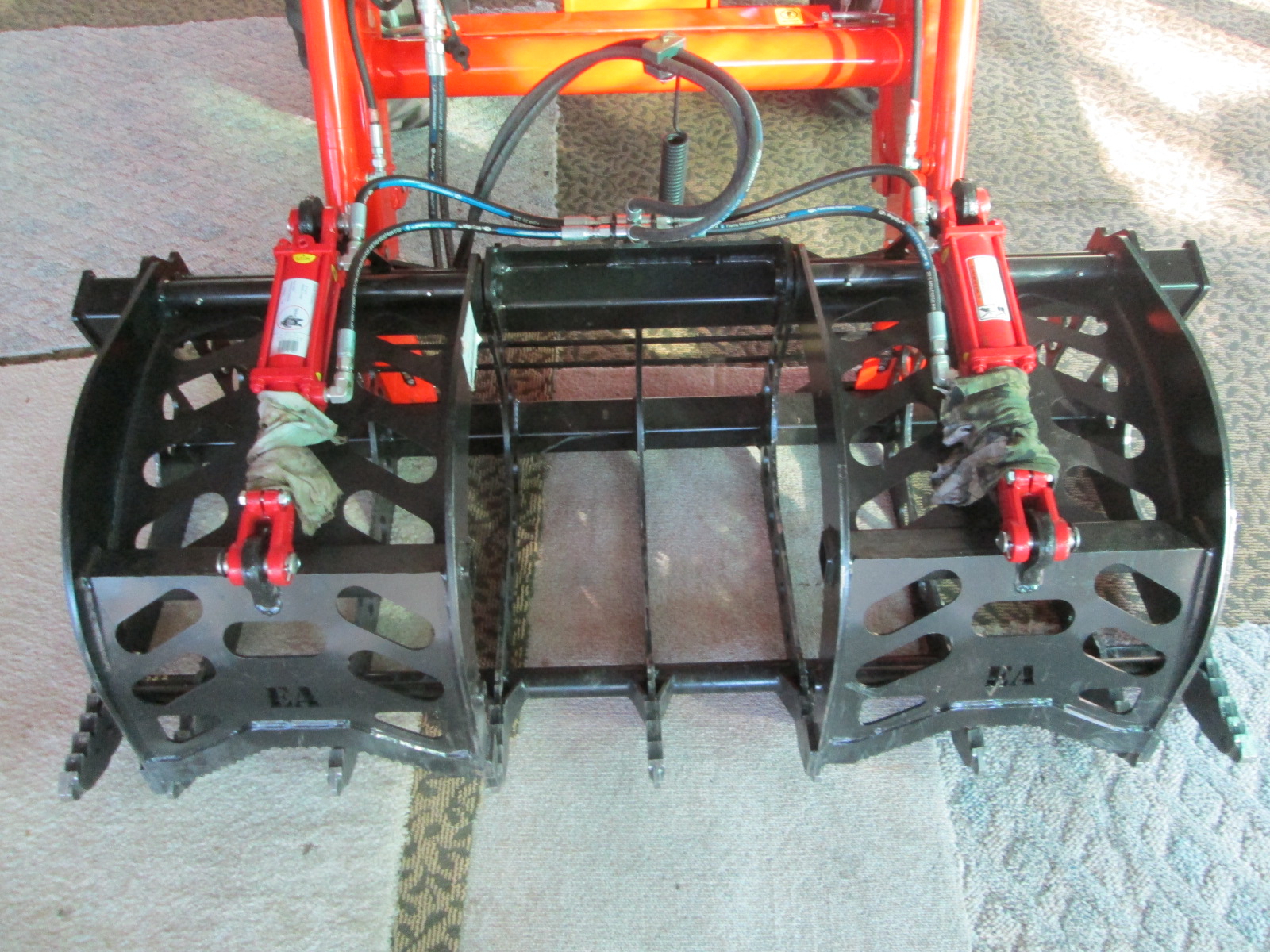

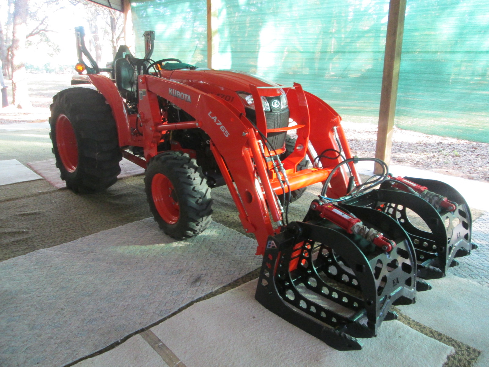

I have a new L4701DT with dealer-installed WR Long 3rd function and EA 66" dual-lid Wicked Grapple (see attached 5 pics)... The tractor has 1/2' feed and 3/8" distribution hydraulic lines and my grapple came fitted with 3/8" lines... But the WR Long 3rd function was installed/plumbed with 1/4" lines... It is my understanding "...the WR Long 3rd function valve came as a kit [to the dealer] with 1/4" lines..." and I questioned this but after 50 hours of grapple-operation I am very satisfied with the speed of the dual lids... I notice that I can easily control the speed and hence the strength of the lids and this is ESPECIALLY USEFUL when handling brush that is smaller/old/dry so that I don't crush it and have it break/fall-apart... The lids close at a medium speed allowing me to control the rate/strength while simultaneously curl the bucket in order to maximize my grab/load... If the lids were any faster I think it would be much more difficult to control/coordinate an EFFECIENT/EFFECTIVE/MAXIMUM pick... Don't be afraid to try the 1/4"...NewTractorPoleBarn (1).JPGNewTractorPoleBarn (4).JPGNewTractorPoleBarn (5).JPGNewTractorPoleBarn (6).JPGNewTractorPoleBarn (7).JPG
BTW, I would definitely NOT describe the lid closure a 'slow' with the 1/4" hoses... Moderate/medium/controllable/respectable/etc. perhaps but NOT slow and certainly not 'very slow' as some have pontificated/predicted... Again, I am very happy with the speed and I would be willing to try the 3/4" hoses but no need... All I am saying is that I have/use the 1/4" and they work fine if not desirable... I was pleasantly surprised... Try them for yourself... Good luck...
