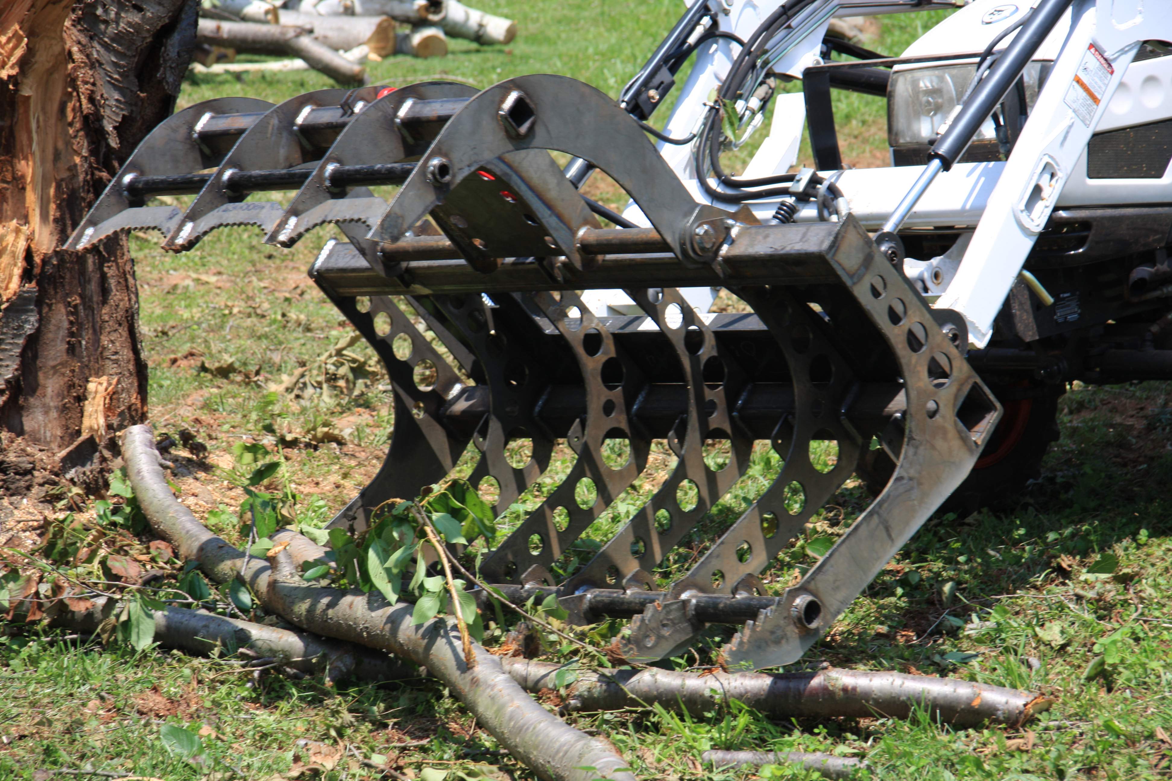

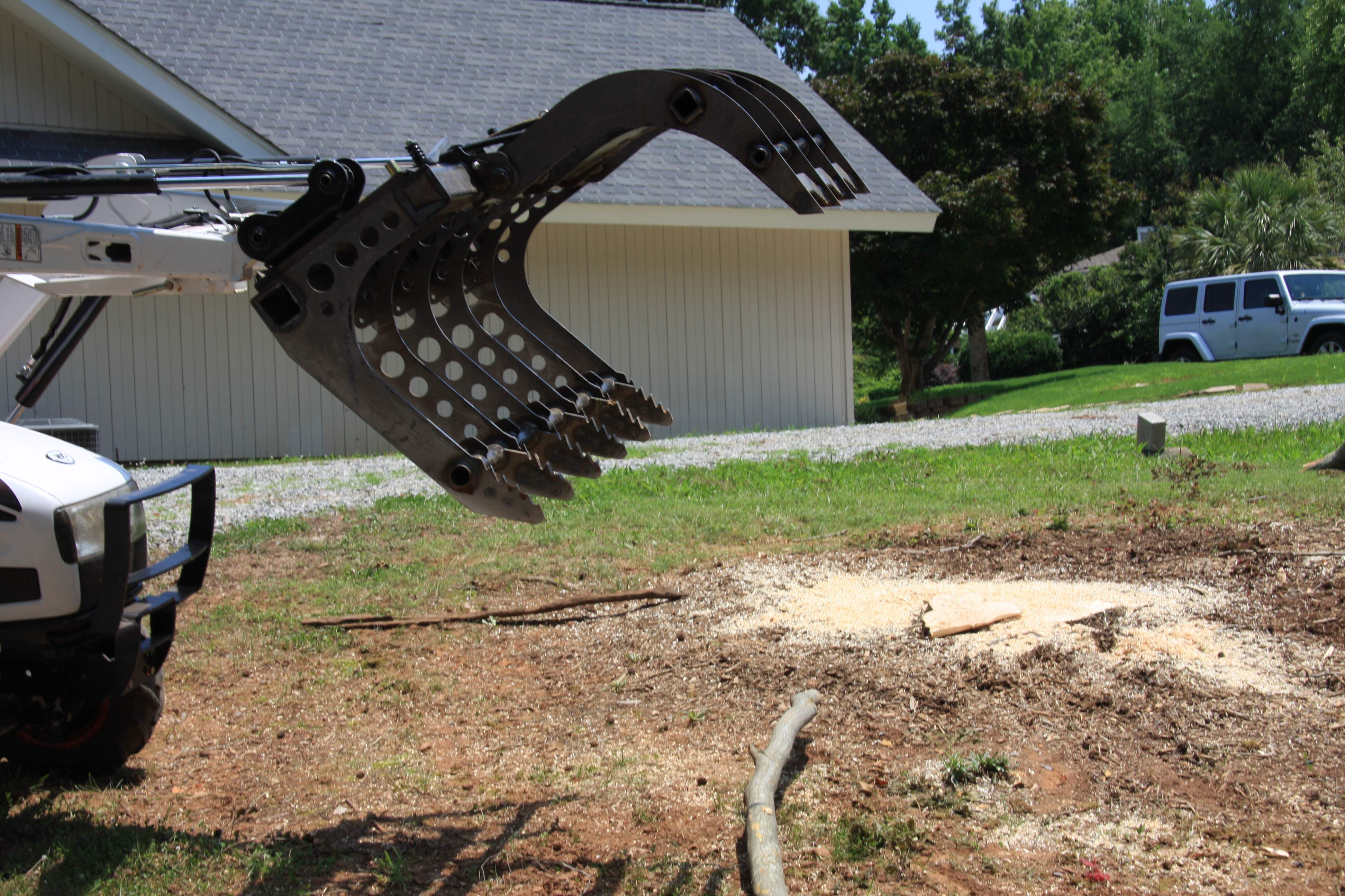

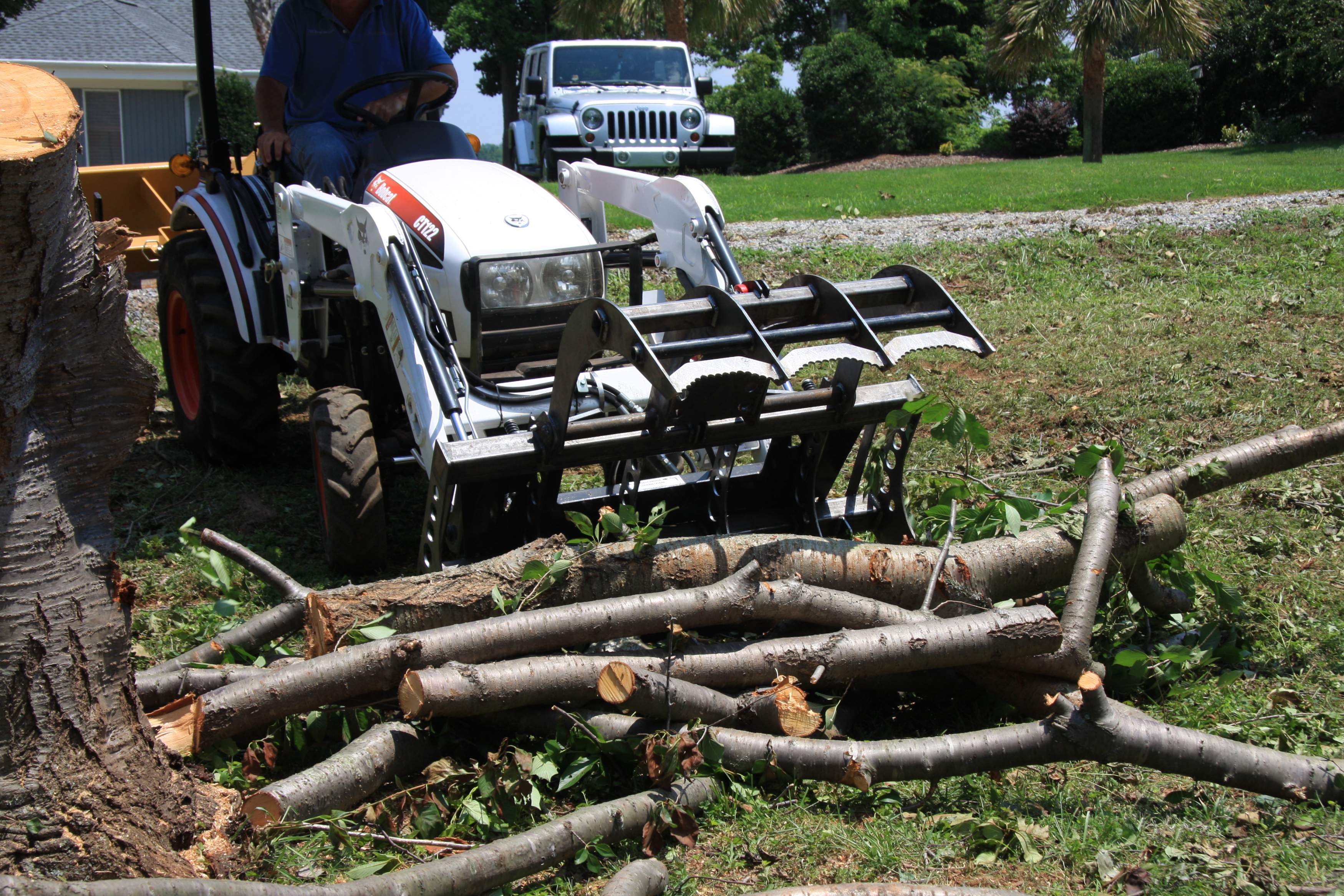

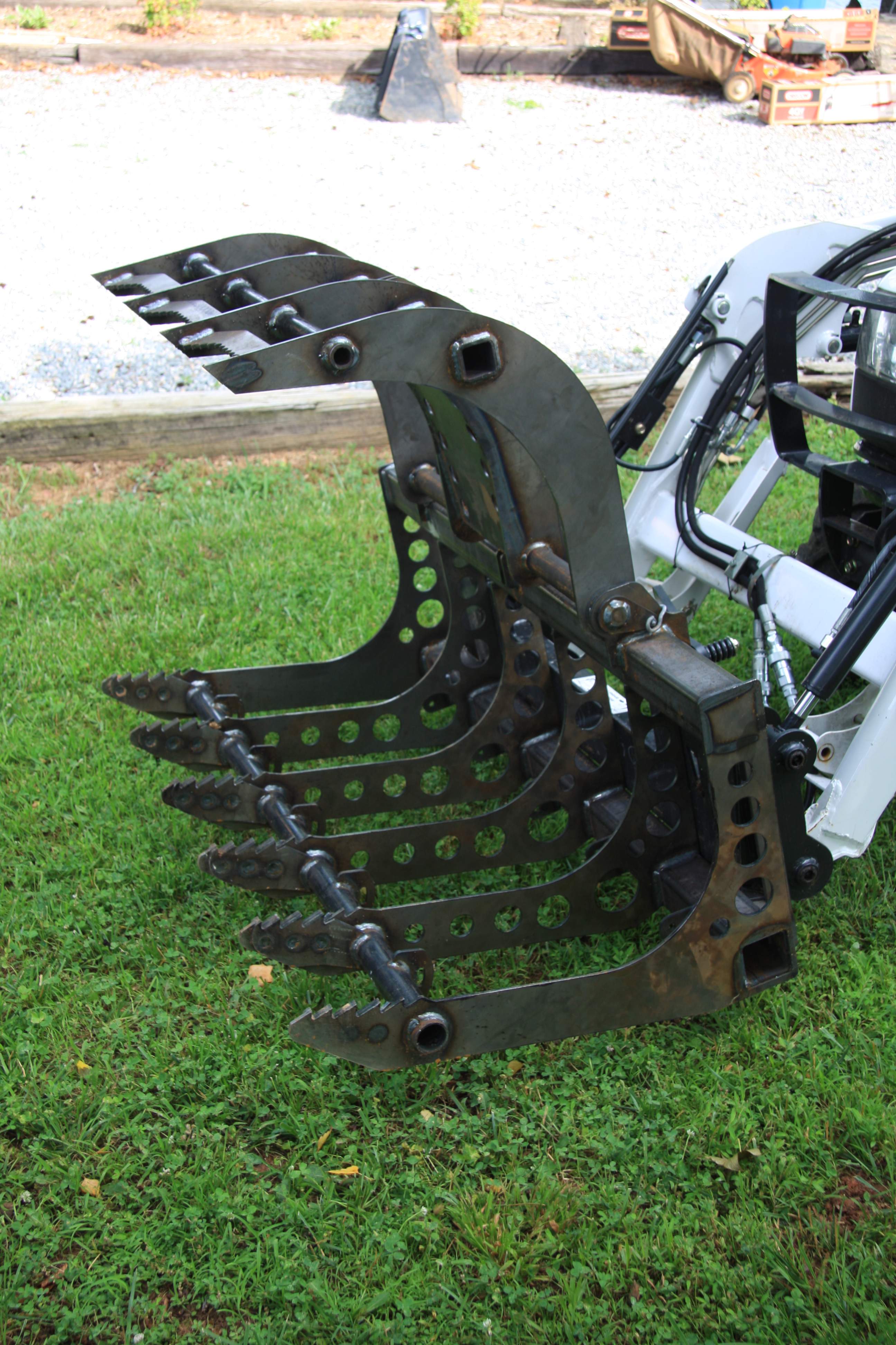

Ted. I just bought a 50inch single lid and used it today. My problem is that it doesn't open very far. I had a large wr long grapple on the larger tractor I owned and it would open 180 degrees or so. You could grab a ton of brush and do what you want with it. Is mine defective or is this how they work. I can post a pic of it wide open if you like.

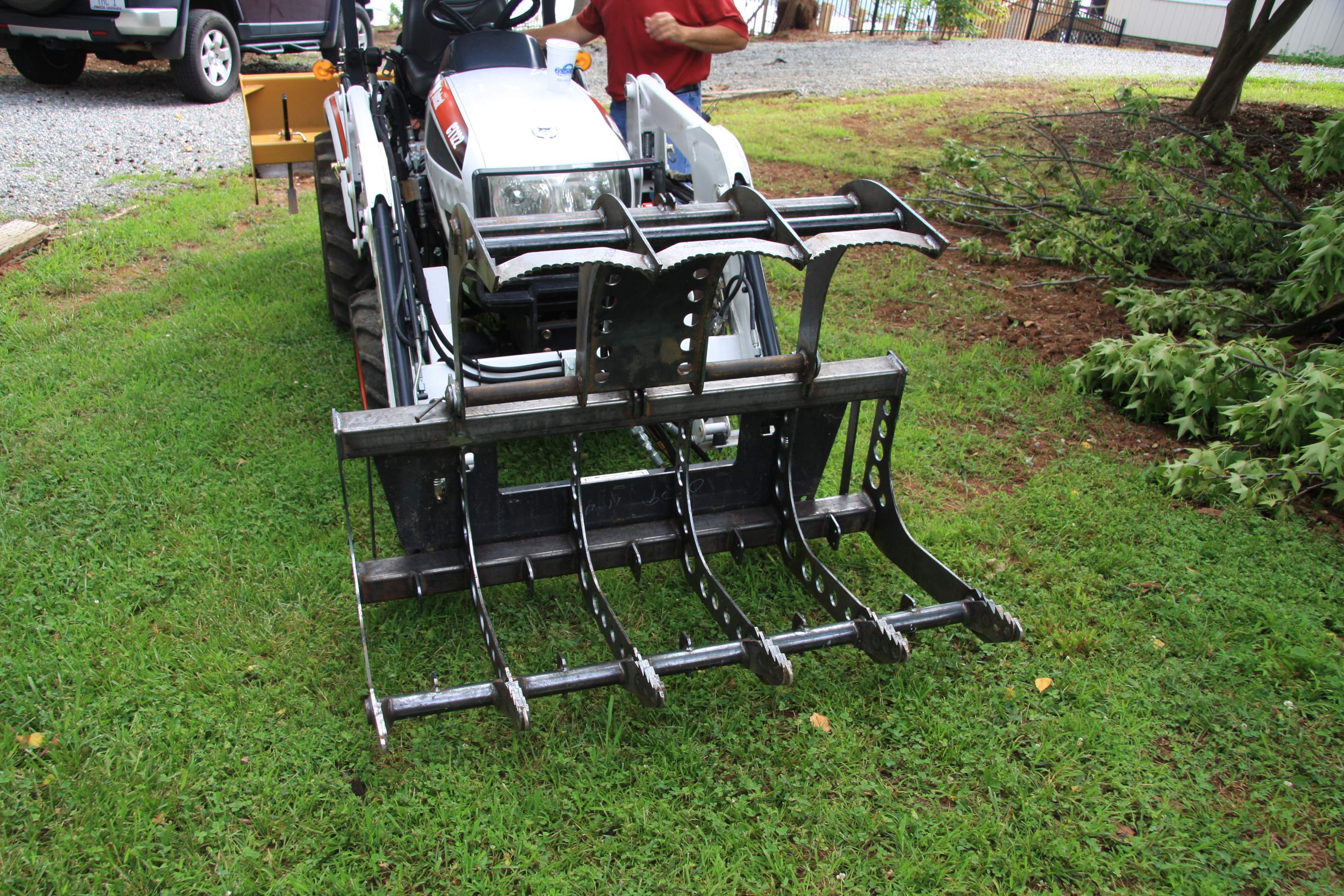

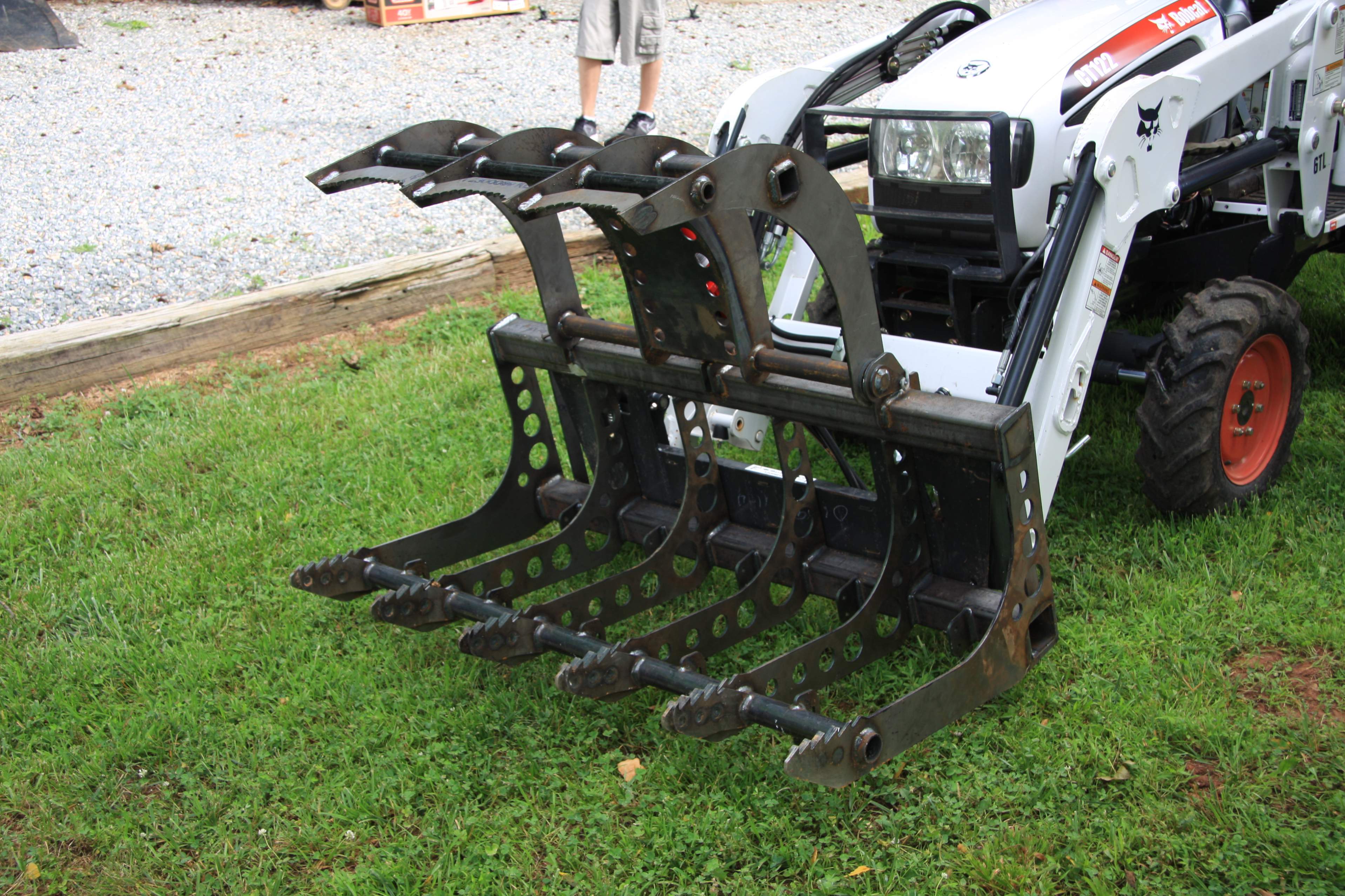

When fully open, it should look like this. If yours doesn't look like that, send me some pics to travis@everythingattachments.com and we'll figure out what's going on with it.

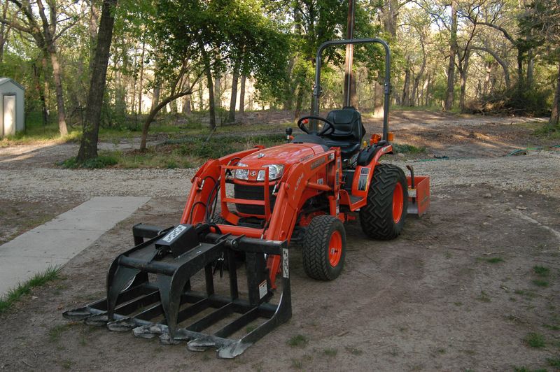

The lids already open to 90* or close to it. For it to have a larger opening the back of the grapple(upright portion that QA mounts to) would have to be taller or the tines would have to be longer. If the tines were made longer it would reduce break out force and lift capacity when trying to use them.
That is how I look at it as well. The WR Long OBG2 is a perfect example of a wide opening grapple.
Here it is on a B Series Kubota
Sure it opens wide and tall, but I don't think it would be ideal on a compact tractor if you wanted to grab/pinch something really heavy at the very end.

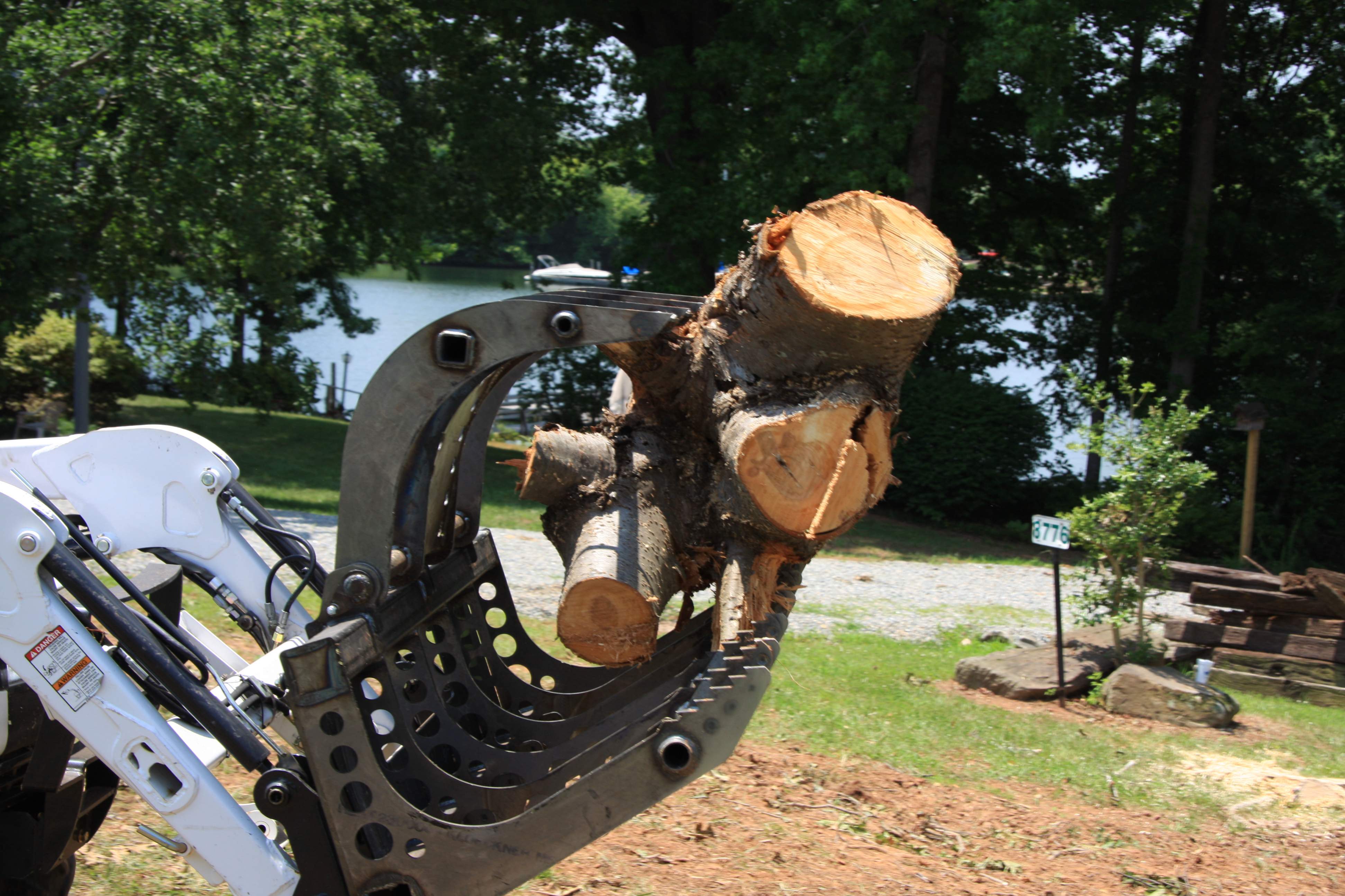

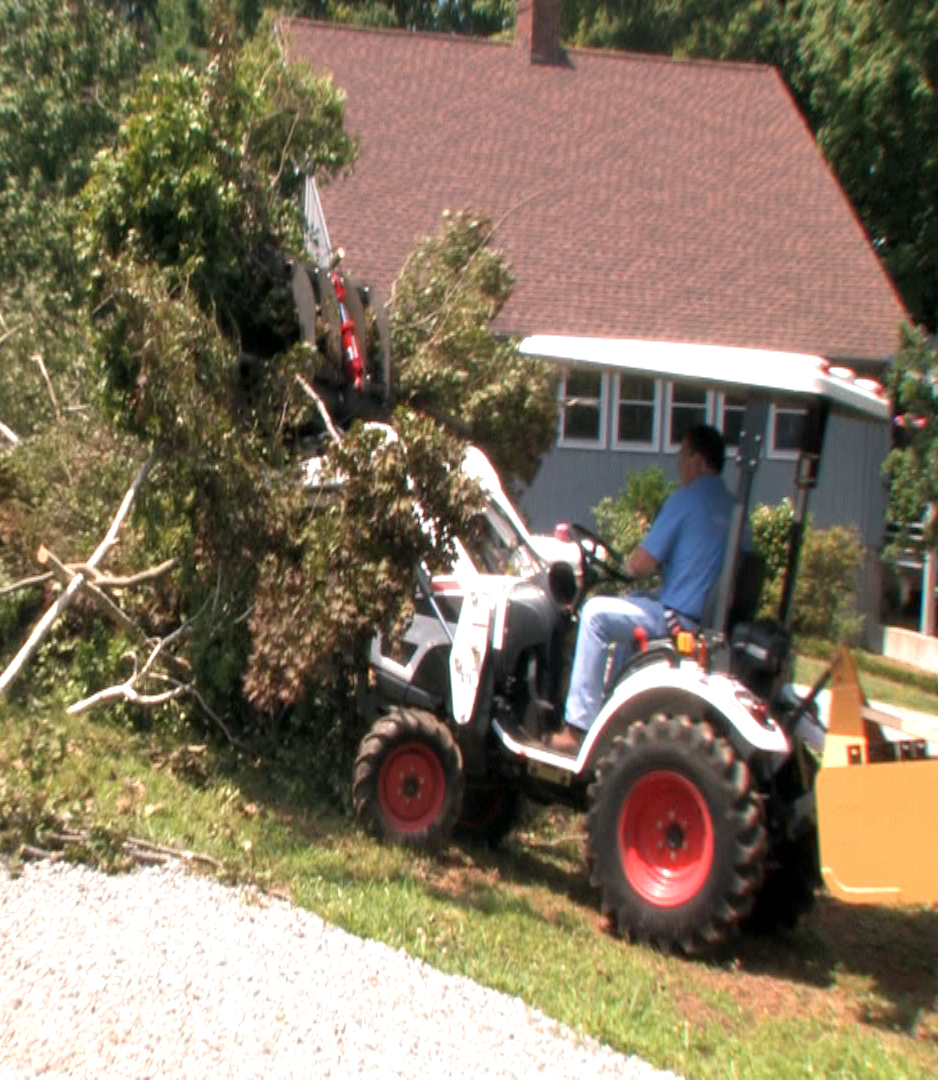

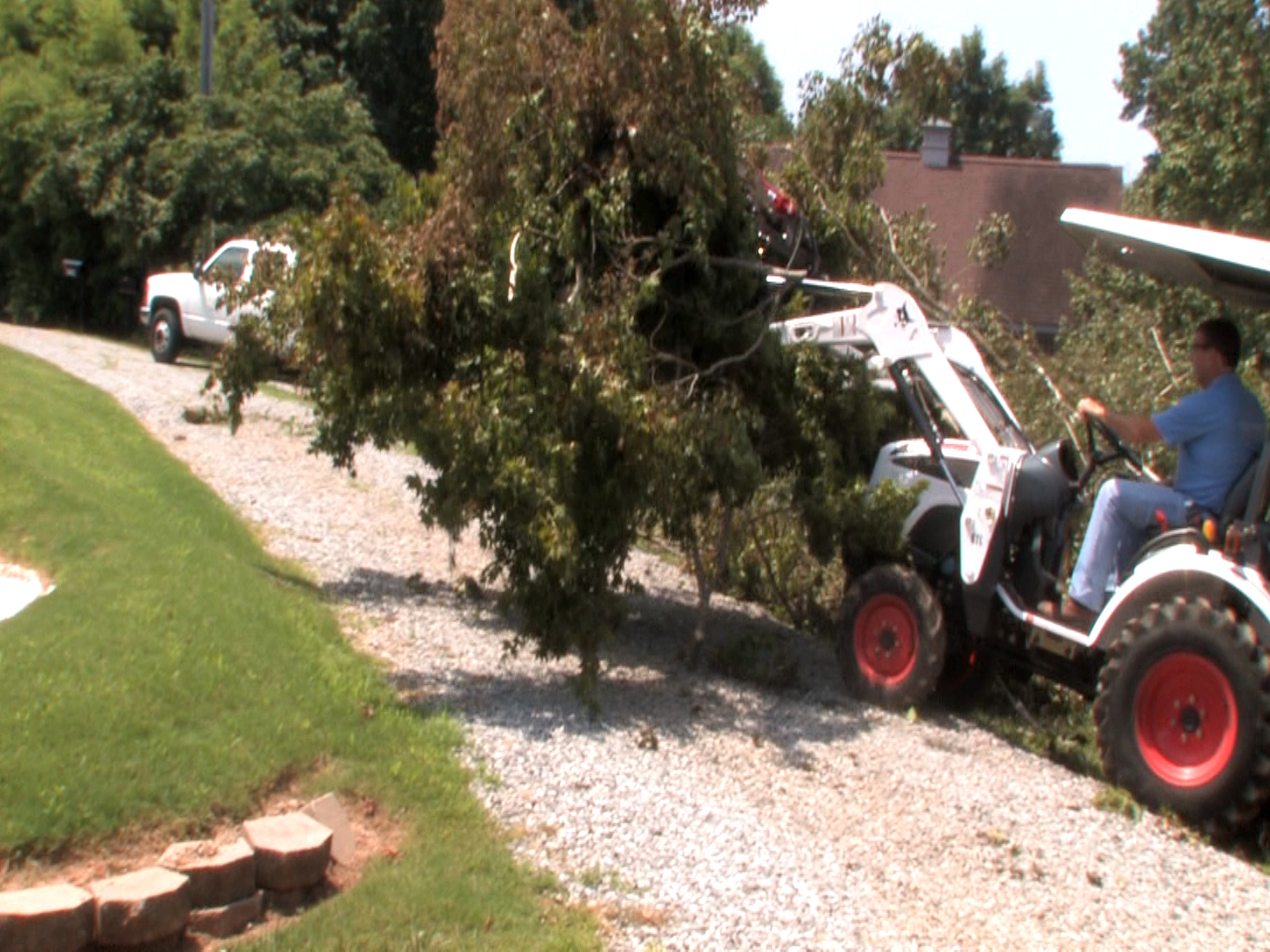

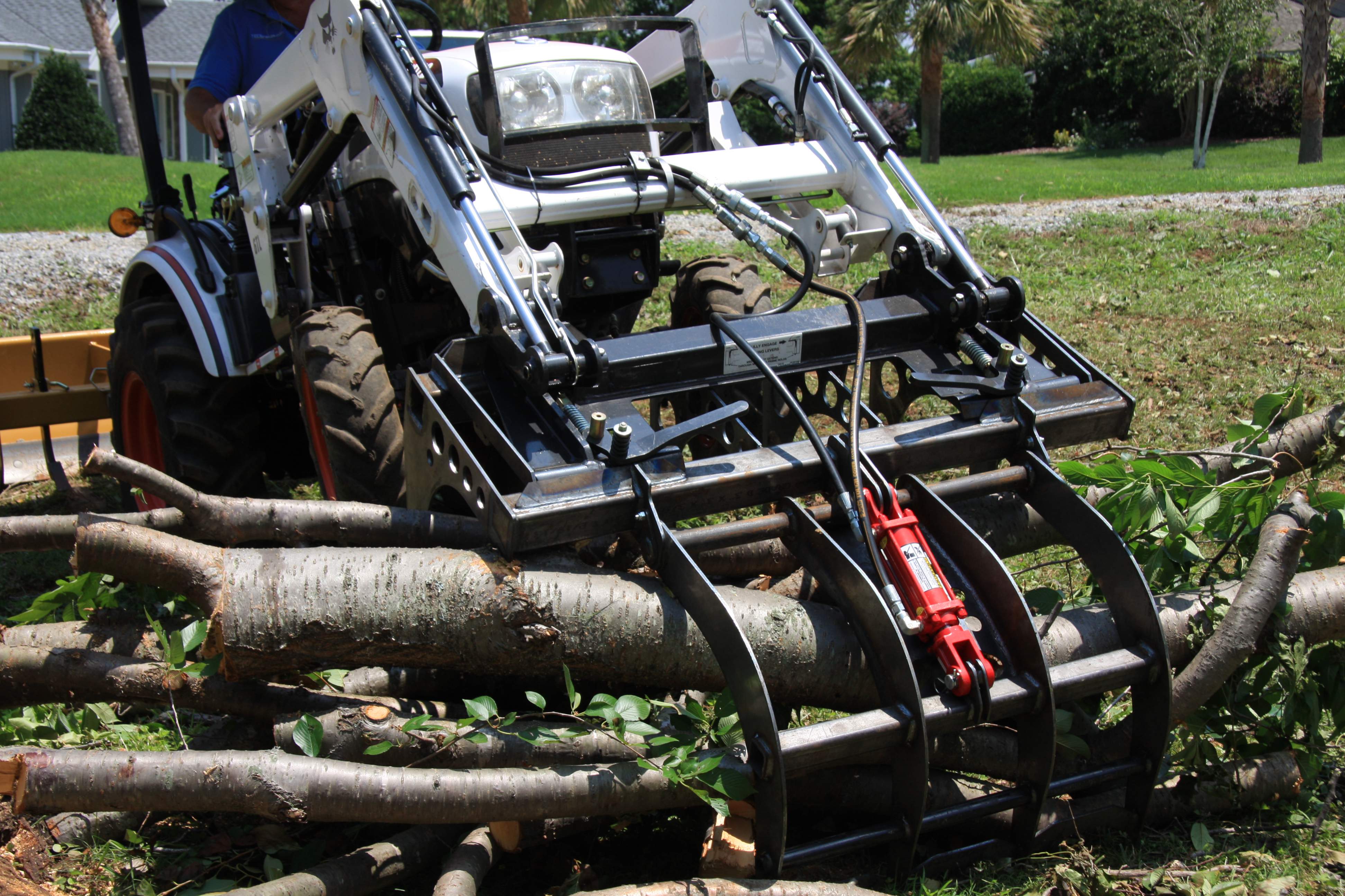

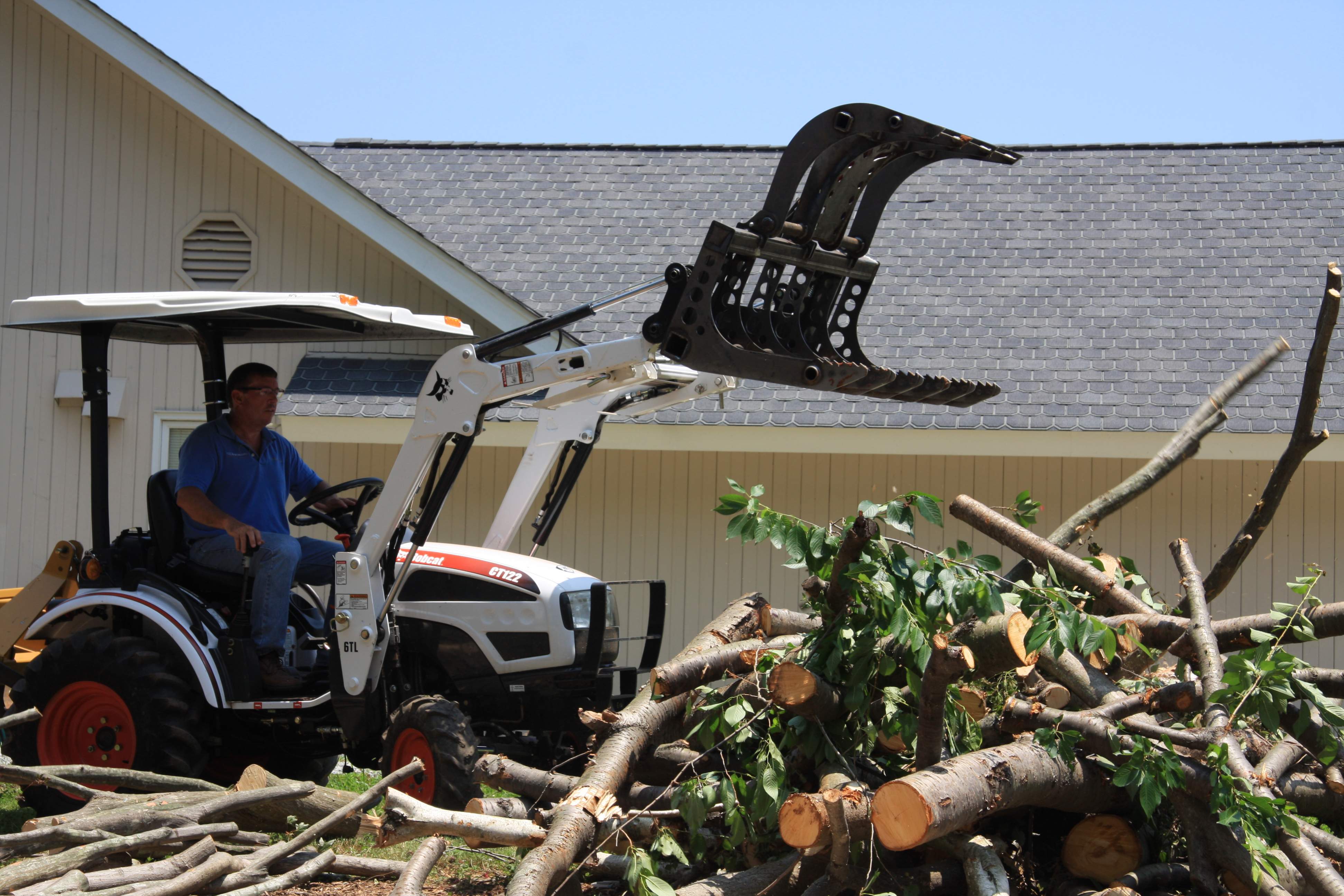

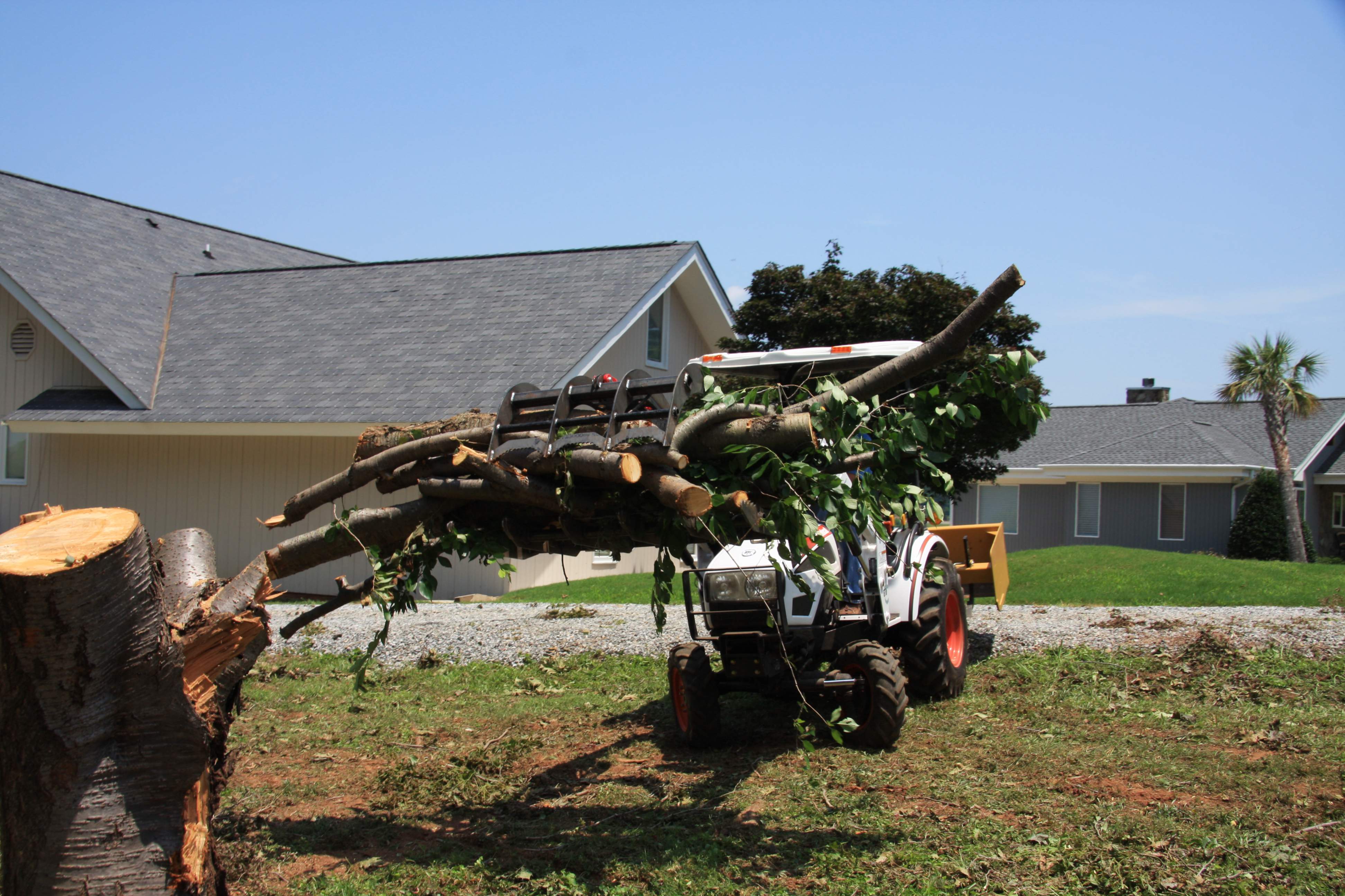

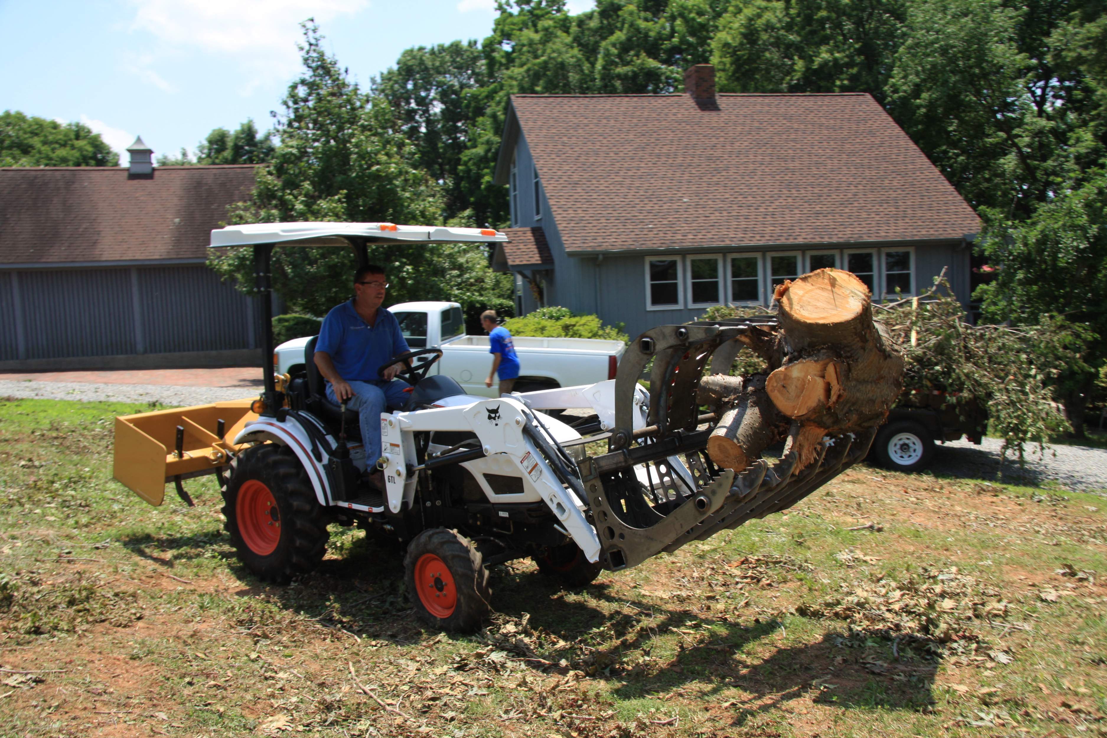

When operating properly, the Wicked Grapples should be able to move brush/logs/debris very efficiently.
Big Nasty Stump
No Problem
Brush Pile

Travis, I measured it and it was 30 inches. Then I went back to your site and found that was what it was supposed to do, right? As I said I had the clamshell (I guess) type that opened close to 180 degrees. You could grab a ton of brush with that thing. Oh well, it is what it is. I guess the good thing is that I've got most of my brush cleared :) I moves logs and other things quite well.
