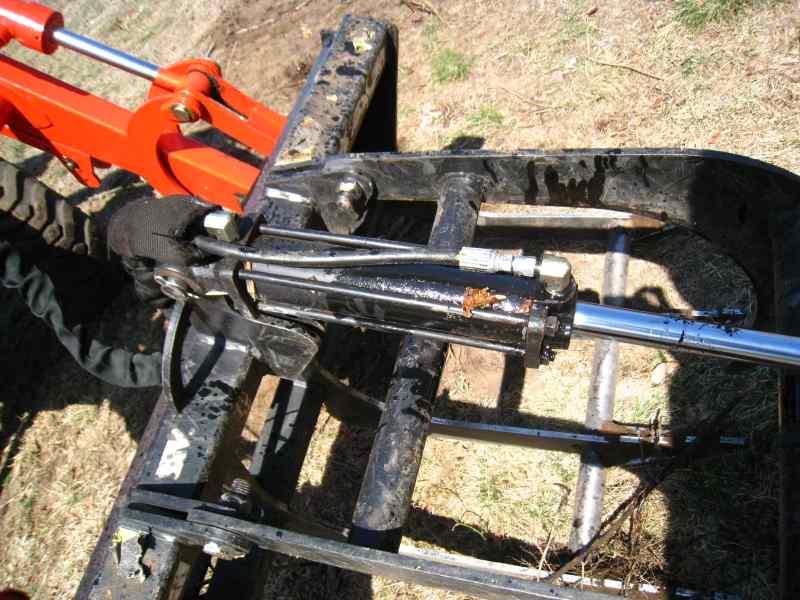

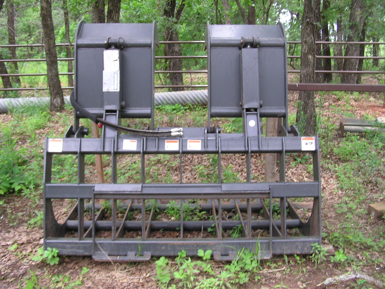

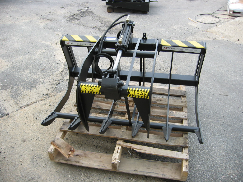

The bottom tines don't necessarily need to be much longer to increase the jaw opening. The upper jaw would need to be a bit longer in the tooth (the portion that comes down to contact the lower tines). If EA just mounted the upper jaw on some ears that stood up from the back of the grapple instead of mounting the hinges directly to the frame, the geometry would allow for a bigger opening. As there is relatively little stress on that mount as all it does is support closing of the grapple. My Millonzi grapple has, as I recall measuring, a 46" opening and it is also a simple 48" wide light duty grapple. The design is not exactly the same as the EA52 because the bottom tines on mine are in fact a bit longer but the elevated mounting of the upper jaw would still make a difference.
Right, the tines could left the same length, just raise the pivot point..
Notice how far above the top of the attachment plate the upper jaw hinges are.

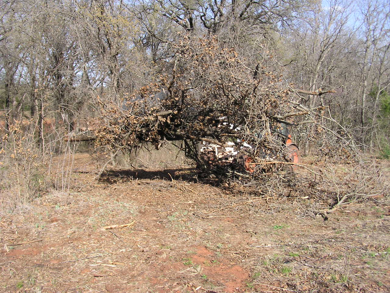

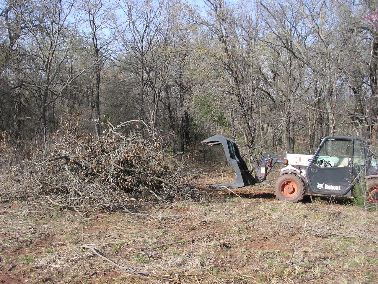

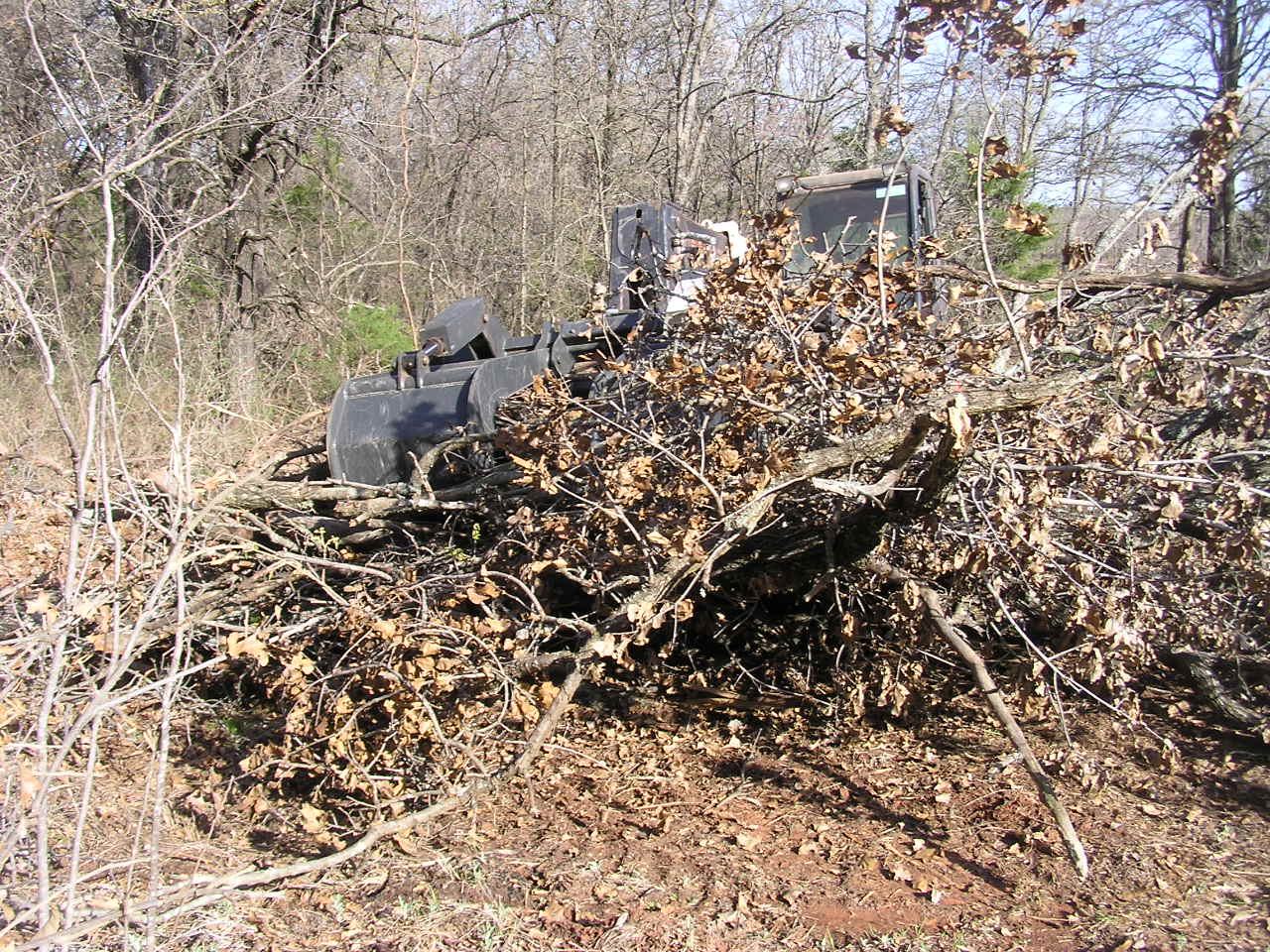

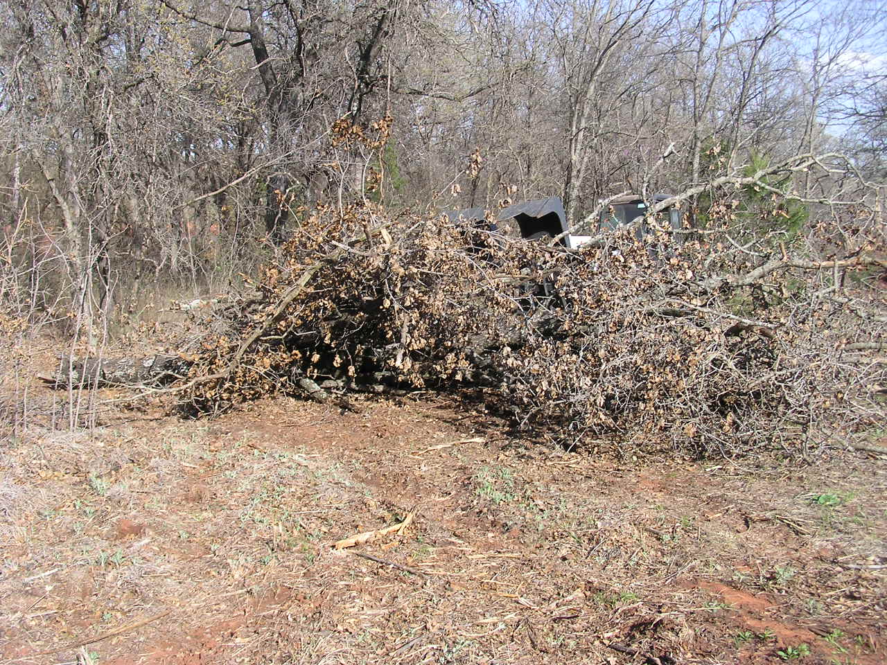

I piled some brush on a dead tree. Notice the size of the brush pile compared to the 51" opening of the grapple.
Looking back toward the grapple
Clamped down.
Picked up.
I could use a wider opening grapple ! :laughing:
The brushpile pictured here is a perfect example of "It's not the size of your equipment- It's how you use it."
When confronted with a seemingly oversized pile like this, the first thought is to flatten it with the grapple, get a good bite on the partially compacted pile, pick it up and see how much is securely captured and how much is going to fall out as you move it. Then try it again.
Usually, it's better to work the pile a bit before grabbing it. Push the pile forward with a little down pressure but no tines under the pile. The idea is to roll the pile up so the side branches break and all the brush becomes intertwined. Then back drag pile the same way. You get a much more compacted load that way, which also pays off if you are loading it in a vehicle.
Sorry if this technique was common knowledge.

See the pile of brush clamped down in the grapple of my tractor? That's how much I could get from the pile of brush in the foreground. Pretty disappointing. It was easier to open the jaws and manually load the grapple with material--which is how I've learned is the best way to get a decent load.
   / The WICKED Root & Debris GRAPPLE!!!!!!! #359
I have carried loads much larger than that with my little one. You need more practice of "rolling and smooshing":)
   / The WICKED Root & Debris GRAPPLE!!!!!!! #360
I'm familiar with the technique. It doesn't help on this twenty foot tall twiggy stuff that grows along my swap's waters edge on my road.
