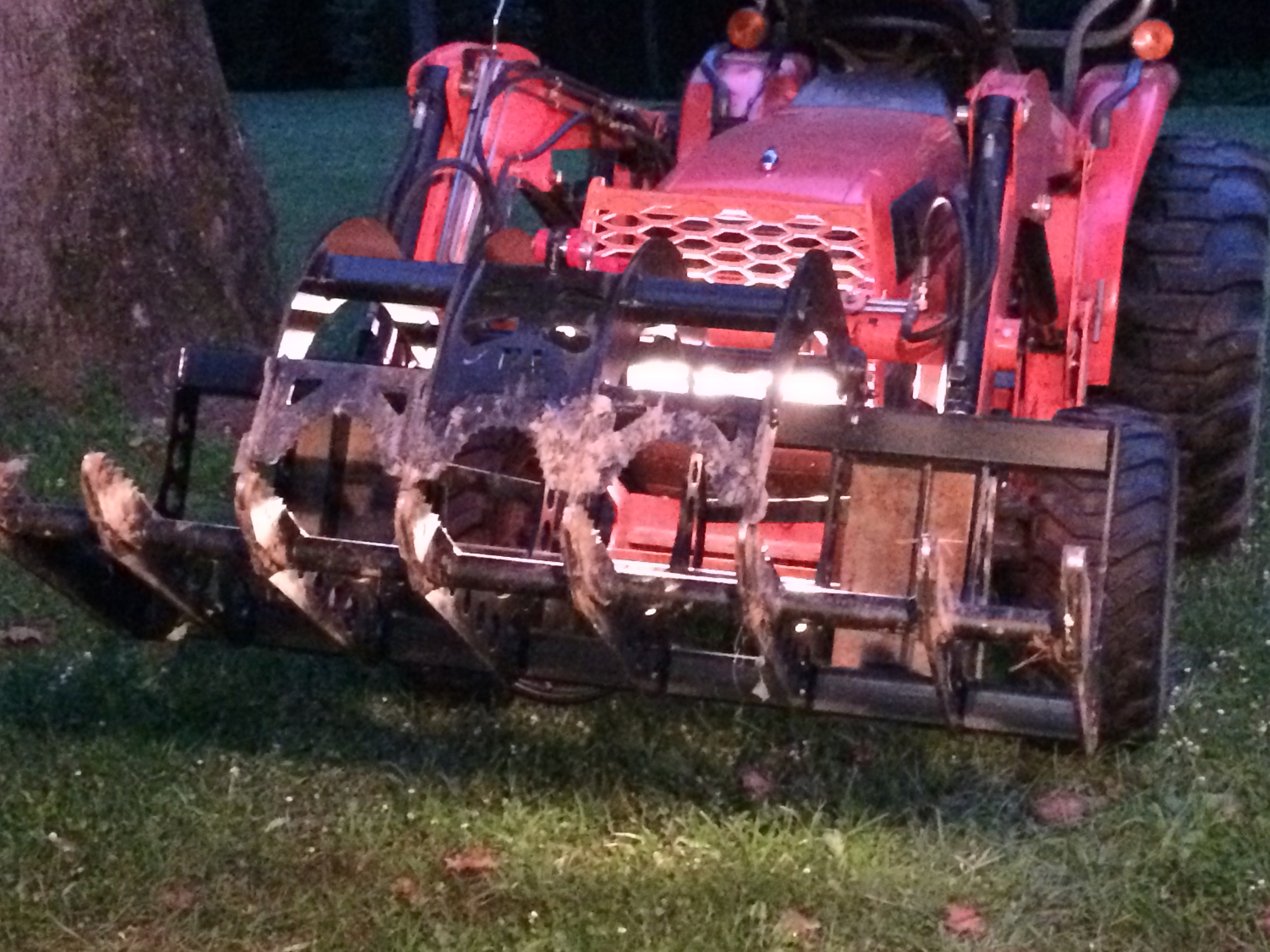

The Single Lid Wicked Grapple was recently developed and has always been 37".
The first version of the Dual Lid was 30" and the "Just Announced" new version is 37".

All grapples are awesome!!! And, it goes almost without saying that ANY grapple is better than no grapple. Even a grapple bucket attachment (why doesn't EA make one of those???). That said, it is often nice to think about how a particular job could be done more efficiently with a slightly different grapple. When rocks fall through I want a grapple with more bottom tines. When I need to lift a big stump, I want the lightest possible grapple. When picking up debris I want a wide grapple. When digging out stumps I want a narrow grapple. Somedays I would even like a clamshell. Bottom line is that just about ANY grapple can do the work if you learn your grapple.

At the time, I don't think we had decided to change the dual lid models, otherwise I definitely would have told you.
The 30" opening was on them for over 2 1/2 years and only a couple of customers said anything about it.
Before the Wicked Grapple, our best seller for YEARS was the Construction Attachments compact model, which has the same 30" opening.
