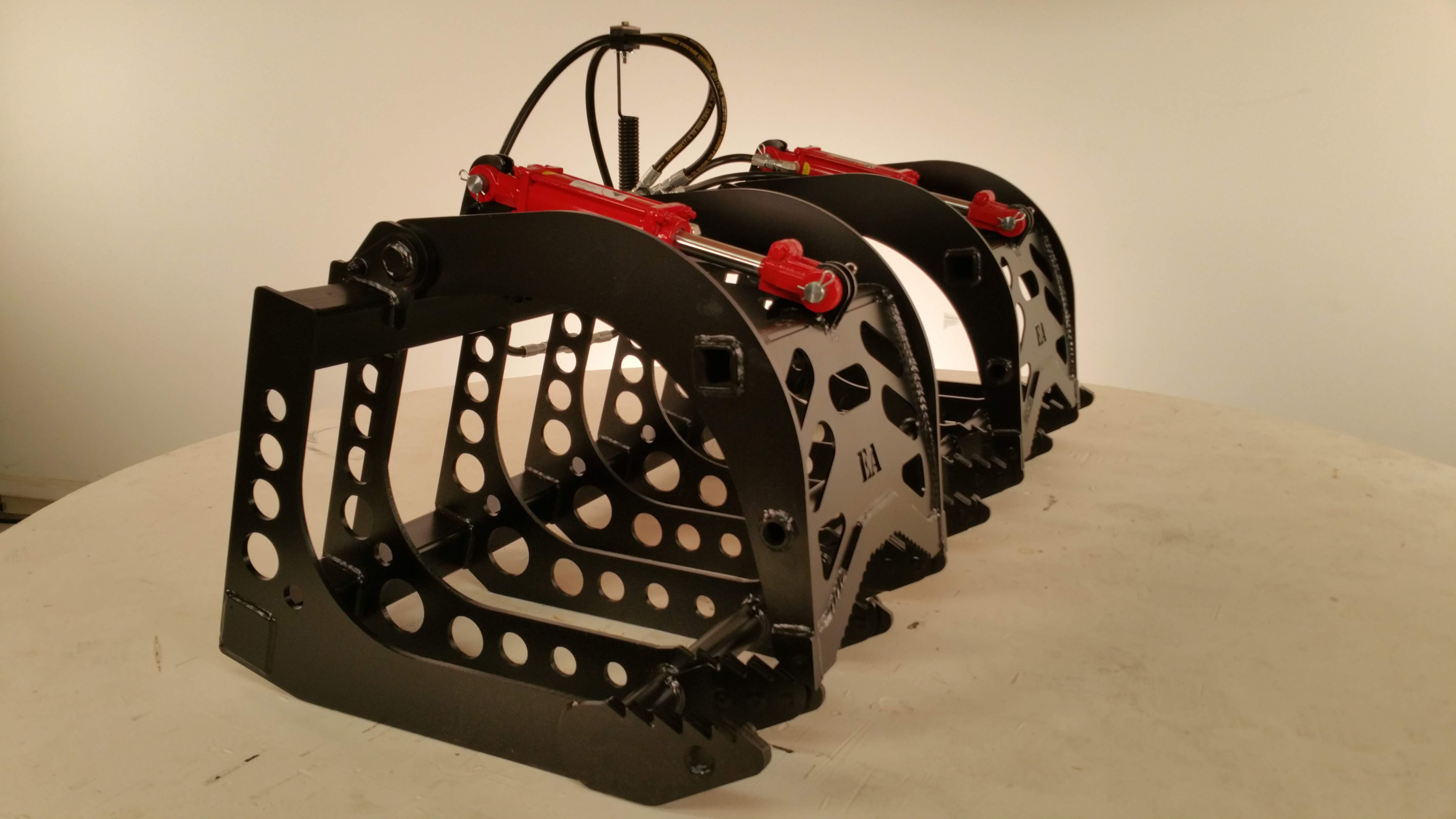

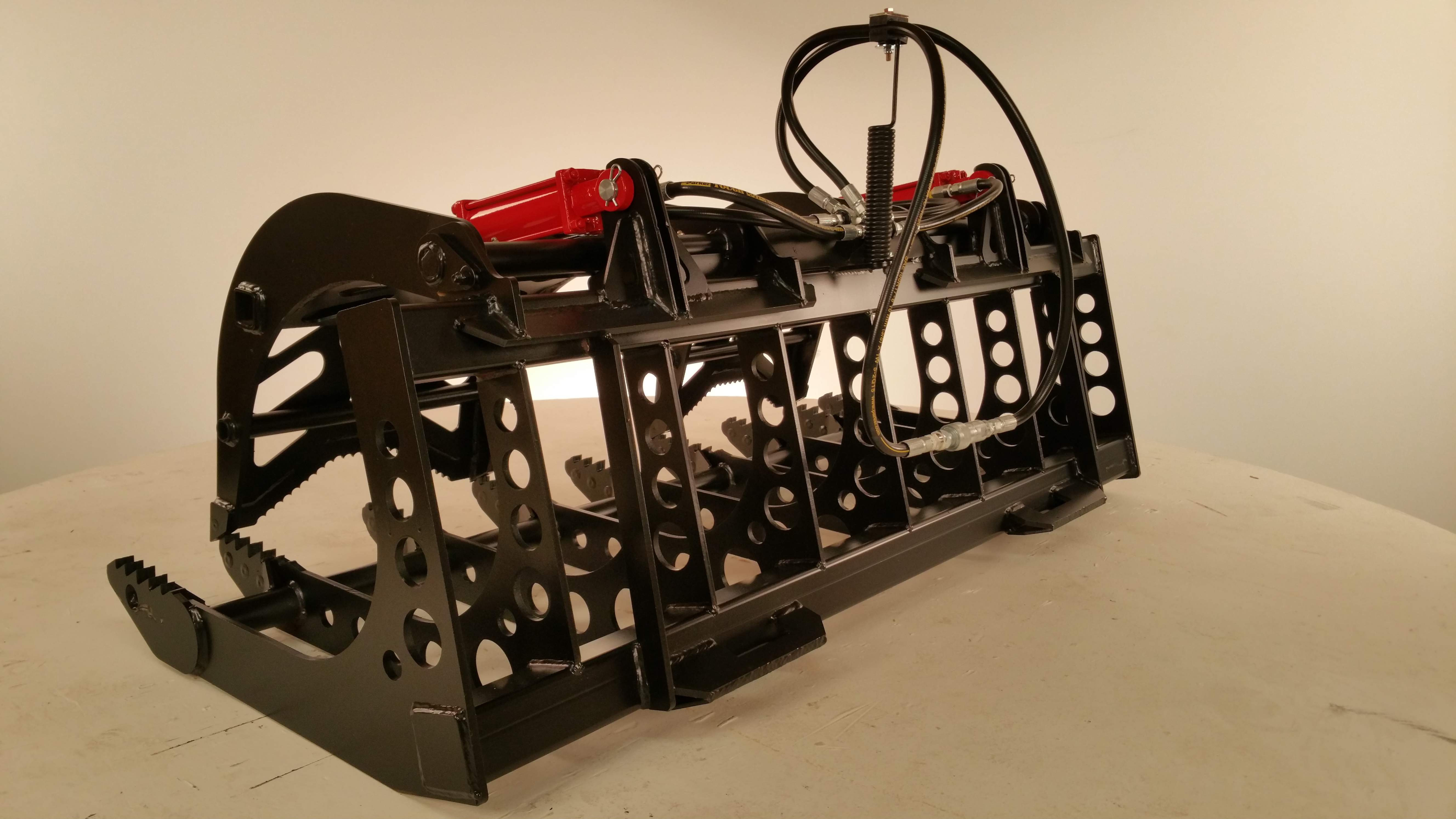

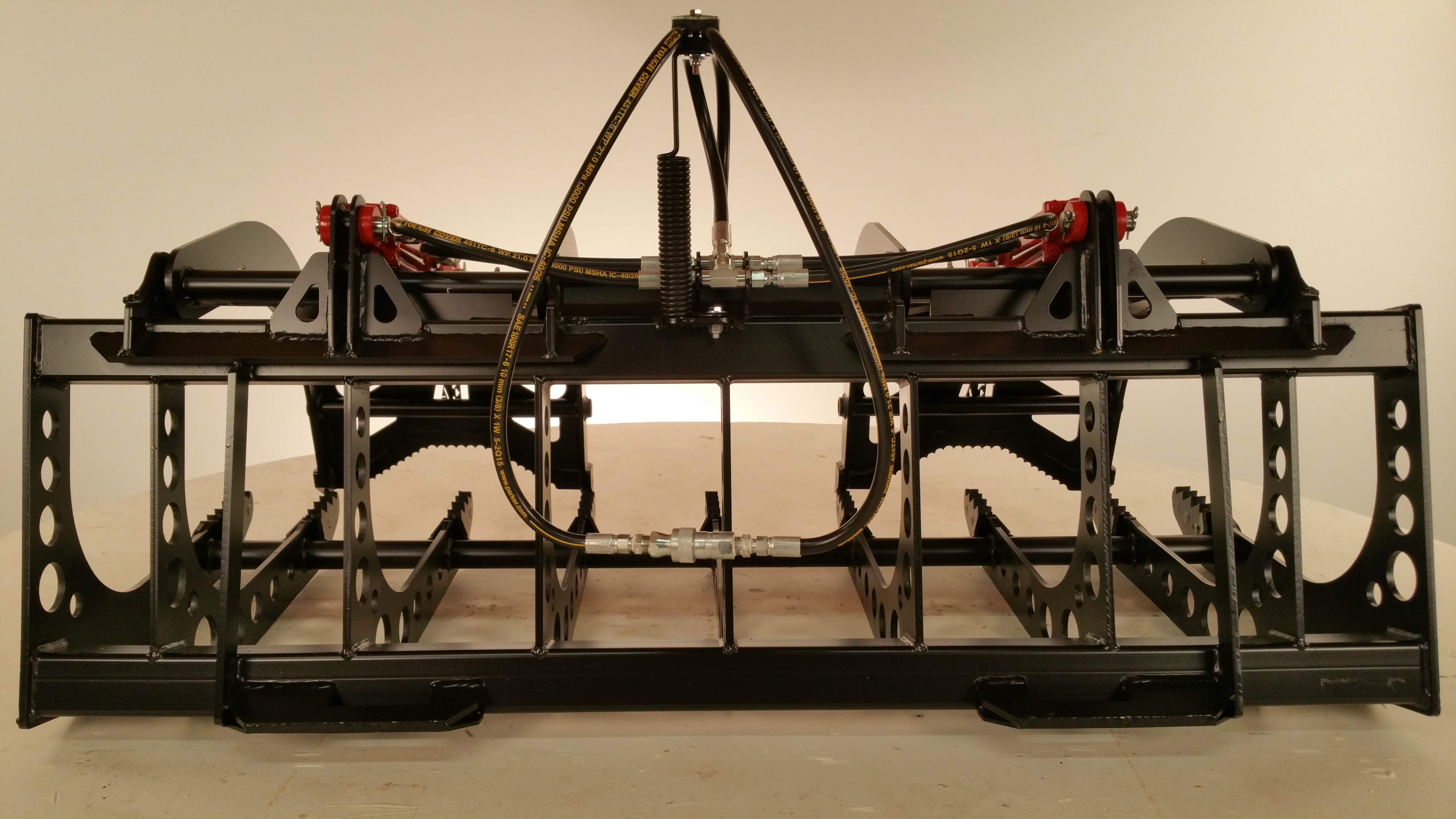

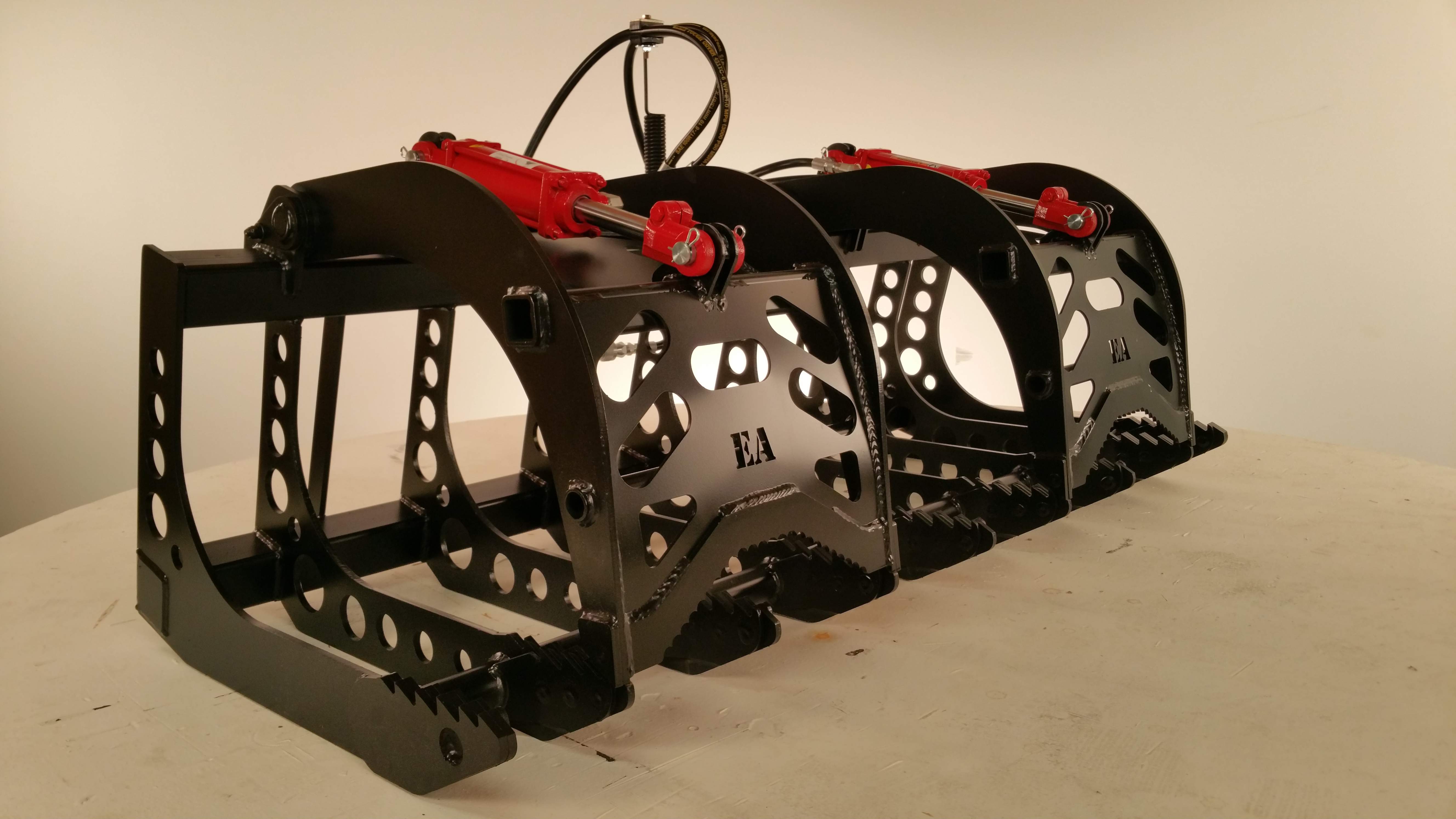

IT'S OFFICIAL!!!........The Dual Lid WICKED GRAPPLE just got WICKED.... ER !!!
It's been over 2 1/2 years since the first one rolled out of our factory. We've made hundreds of customers happy by offering the perfect grapple for compact tractors.
Extremely lightweight yet incredibly strong, the Wicked Grapple has exceeded the expectations of EverythingAttachments and many of our valued customers.
The reviews submitted on our website include phrases such as "I love this thing", "It's everything Ted claimed it to be and more", "remarkably well made", "I would rather lose my left arm than my EA wicked grapple", "built like a tank", "amazed at the quality of this product", "magnificent job of engineering and execution", "Flawless workmanship, Excellent material" and "built tougher than most and much lighter than all" just to name a few.
The Version 2.0 is now available. Full re-design and overhaul? Not Even Close, but we did listen to what some of the critics had to say and are delivering what they asked for!
The Wicked Grapple now features a larger 37" opening, larger 2.5" bore x 5" stroke cylinders and an estimated 20" increase in clamping force!!
We are looking forward to making a video featuring this new version. Ted's plan is to hook it to a new Kubota L6060 mega compact tractor with Ag tires and LET IT EAT!! The tractor is ordered and should be here soon.
