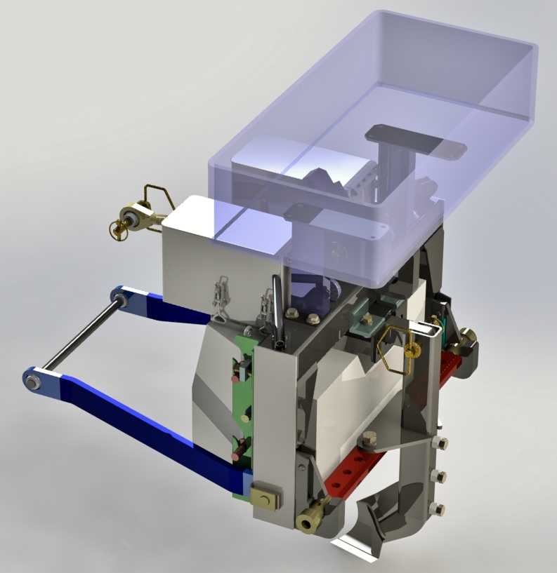

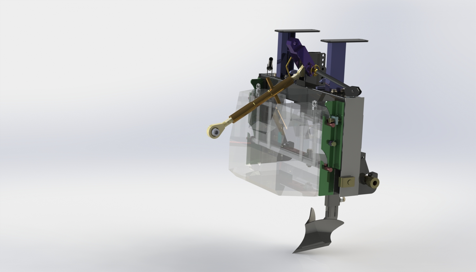

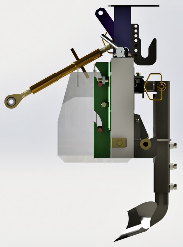

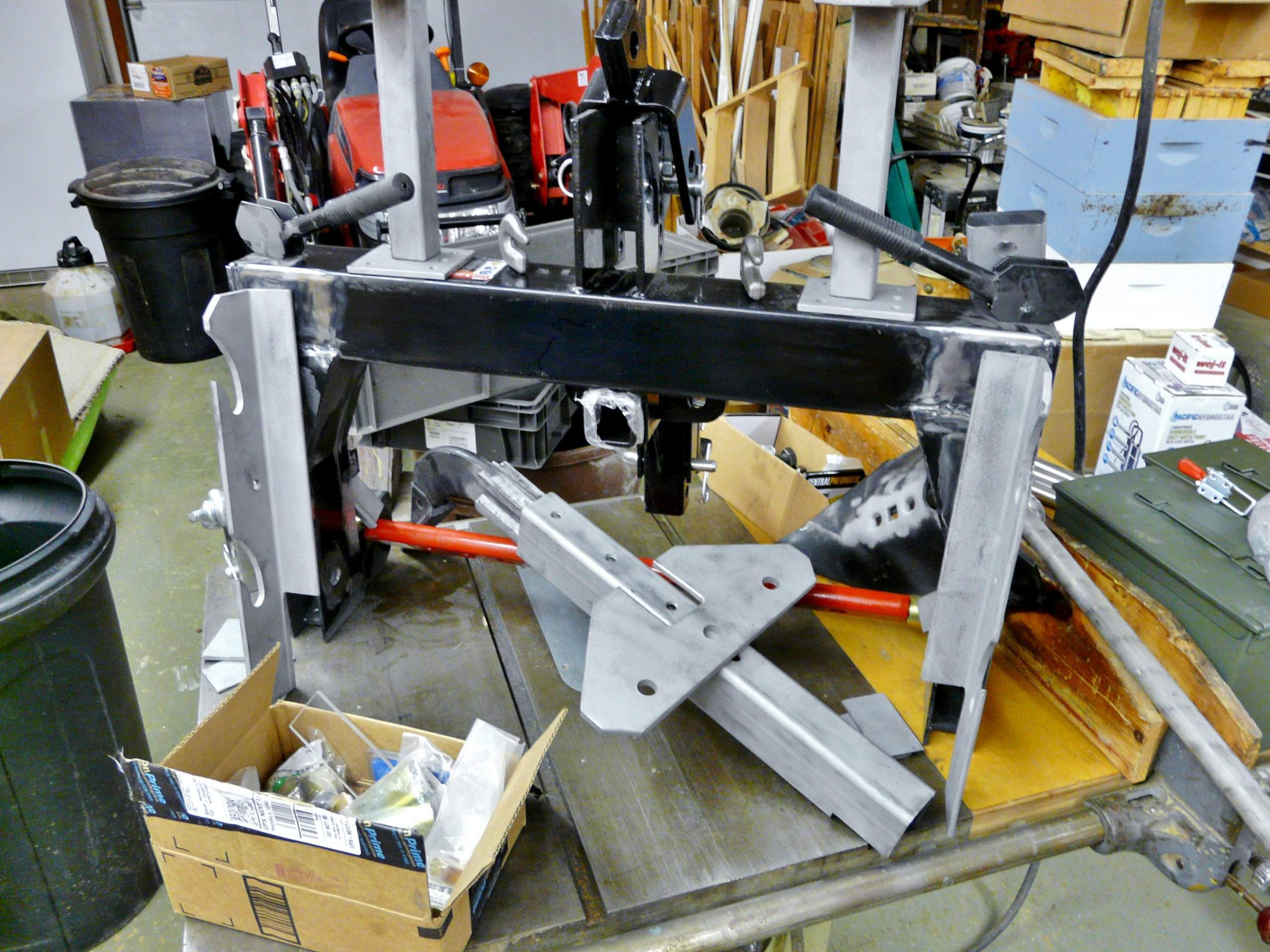

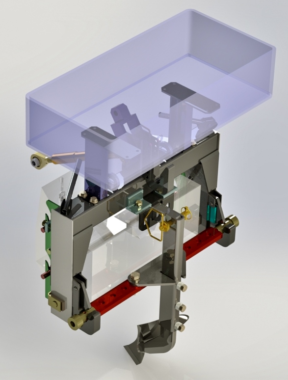

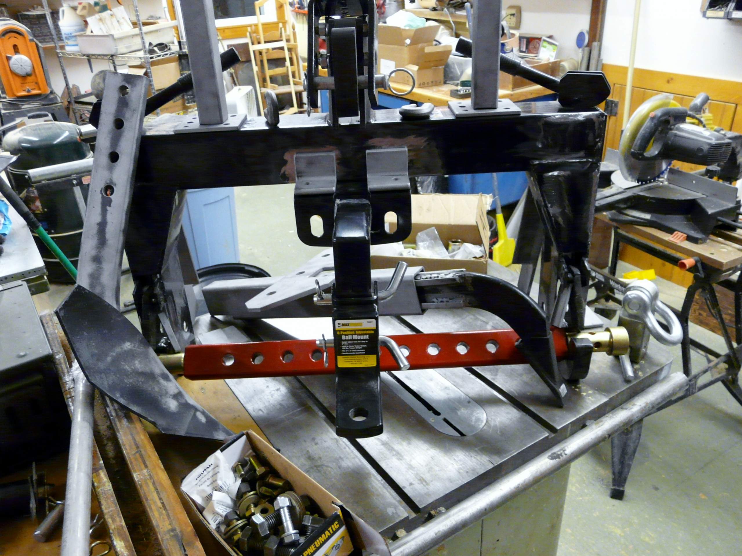

A QA Counterweight Piggybacked on a highly modified QA Hitch were the weight does not interfer with 3Pt use, except the weight must be removed to use the PTO. Who needs CW with Rotary Cutter anyways?

Re: Theory of rear ballast? My solution
Nice design :thumbsup:

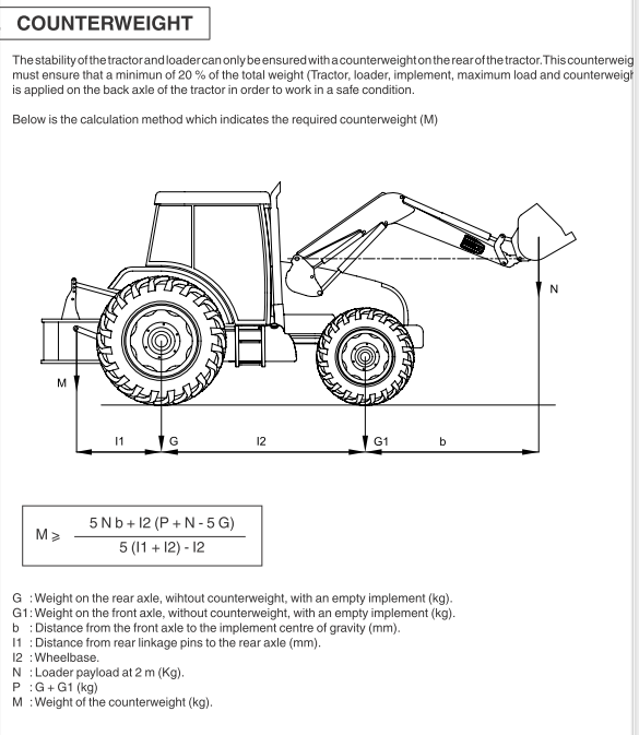

For anyone who likes to use a calculator, my loader manual has this equation to work out the minimum ballast required.

Lotta guess work in that since most dont know how much the front/rear weights are. I think that is for stability also. Since fluid in the tires or wheel weights (according to the formula) would lessen the required counterweight. But in practice, fluid adds stability, but dont unload the front axle. So you still want a good counterweight.
I ran my tractor through the formula. Took me awhile to brush up my math skills but it checks out to my owners manual's recommendations.
What did it tell you that you need? And what is the loader rated to lift?
   / Theory of rear ballast? #48
850 KG which is 1873 lbs And the loader lifts 4000 with a bucket that weighs 450.
   / Theory of rear ballast? #49
I had to do quite a bit of looking up to get the weights. I split the tractors weight 5040 lbs 60/40 rear/front. the loader frame is 370 (split 60/40) and the arms and bucket weigh 1350. (all on front axle.) The beet juice in the rears weighs 920. all converted to KG for the formula. I put the center of the 3ph load back at 1000 a bit behind the pins and the load in the bucket out at 1750 the pins are at 1200. the wheel base is 2050mm.
   / Theory of rear ballast? #50
I would not factor the liquid in the tires. Sure it adds stability and will increase the amount it takes to top the tractor forward. But does nothing to help unload the front axle.
And do you find that number to be accurate? May be different for larger tractors. But I would guess smaller CUT's are closer to 70/30 weight split.
