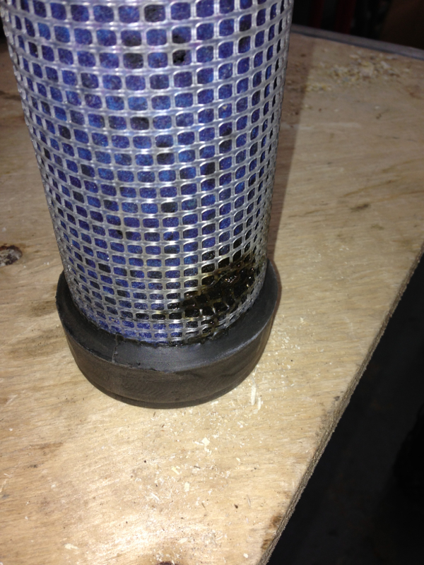

Here's what can happen if its held on to long or engine fails to start with flame burning.
This is a secondary filter for a 236 Perkins, the inner fabric is all melted.
