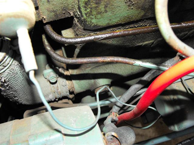

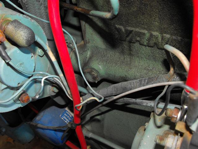

Your post made me go back and look at my block a little closer. It has a threaded plug just behind the lower radiator hose. I wonder if something could be rigged up to also use a block heater in it?

Gary,
I don't know about that its probably doubtful I have never seen that type in my line of work but it appears that that may be where you could drain the block at least. So there may be hope on some kind of setup maybe a heater hose inline I think I have seen them but may be wrong.
I cant answer maybe do a search like I did and specify "screw in (block) heater"?
Do you even have any freeze plugs visible I don't see one in the pics?
edit: Here ya go thanks to search hahaha- http://cgi.ebay.com/ebaymotors/ws/e...viewitem=&_trkparms=clkid=5325613042970375395 may not be exact but what the hey. hth

Gary,
edit: Here ya go thanks to search hahaha- 2001-2004 MAZDA B TRUCK KIT BLOCK ENGINE HEATER 2.3L - eBay (item 190281596158 end time Dec-11-10 16:21:02 PST) may not be exact but what the hey. hth
As far as I can tell, there aren't any freeze plugs in the block or the head. I would think there should be but this model doesn't seem to have them. The ones we used in northern Indiana during the winter had a pump and it circulated the water through the engine and the heater was outside of the engine block. I don't have room on this tractor to do that.
