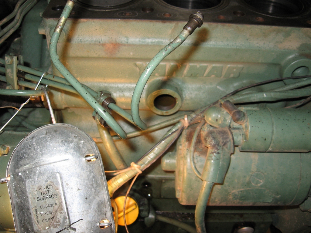

I checked and a freeze plug heater isnt available either for these engines that I have found.
I did order one that fits a v6 Saab that is 28mm (the only one even close) and I plan on experimenting with it if its properly designed. I don't expect it to work or me to find a way to make it work but its worth looking at and will give me something else to think about.
edit: Here is another one and its 30mm so I will get this one also. Kat's 10417 K4N K4NR K4NB frost plug engine block heater thanks to the internet.
Looks like it will fit just fine on mine I don't know what a 1900 block looks like but hopefully this will help someone.
