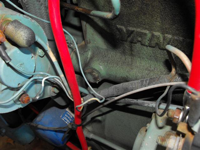

I just fired my engine up after installing the new Kat's 400w heater.
I ground the valves and seats and assembled it last night and once the heater showed up I was able to finish and see how she runs and its good.
I did have to take a small air die grinder with a 3/4" dremel cutoff wheel and do some minor grinding to the inside of the core hole to make room for the element but other than that it fit fine hope this helps someone in the future.

Is that heater made for a freeze plug hole or threaded? My block does not have any freeze plugs but it does have one hole that is threaded and currently has a plug in it.

Its a 30mm for a freeze plug hole.
Oh well, I'll have to see if the Mazda heater will work. I'll probably have to take the plug to a dealer and see if it matches up. I doubt I will get anywhere on the phone with them.
