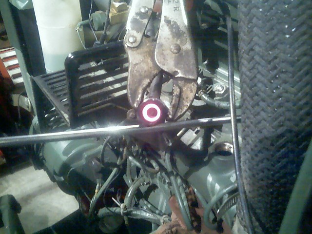

Here are a couple pics of a TS in action that I took last year when I wanted to see if mine worked or not.
Fact I even had to use it this morning in the shop it got down to 45 in here and my tractor doesn't want to start at that temp. I wont use the block heater until it really gets cold.

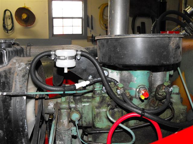

Here's the install of the TS I received yesterday. I will get the hose for the tank to the TS and a switch today and see if it works. The temperature is going to be around 30 degrees this weekend so it will be a good test. I also got the high output magnetic pan heater but I want to see if this works without it first. I am not sure how much current the TS pulls so I will go with 10 gauge wire and compatible push button switch.

Looks good Gary yup 30 degrees should test it!
I think my TS wiring is 12 or 14ga its not as big as you may think it has to be 10 may be overkill it wont hurt at all but whatever you feel comfortable doing do.
